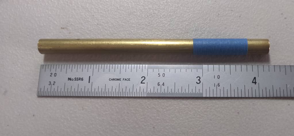

Well... AOA just tell me to crank on it if I want to adjust it. So I did.. moved from 3.1mm to 2.05 mm from flush. It required a lot of force... haven’t had time to shoot groups but the test shots are a bit calmer. Jsb Kings are going out at 900 max power.
still, cranking on that bolt doesn’t feel quite right. I hope they sell replacements!
Maybe there’s some locking compound on the threads? Heating with a hair dryer might help it turn easier.

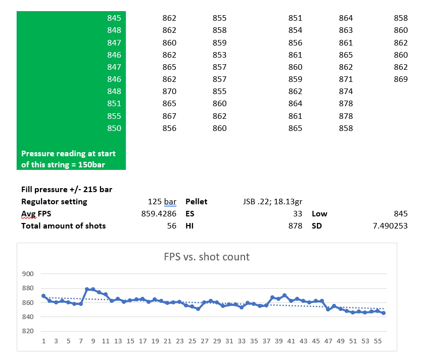

Below is a shot string – I believe the rifle is capable of better. What I find strange is the fact that the velocity decreases before regulator pressure is reached. The final 10 shot string was fired starting with a rifle pressure of 150 bar and ending above 130.
Any ideas?
Is this normal?
I have also noticed that flyers occur quite often. At 25m 4 out of 5 pellets will go through practically the same hole, followed by a flyer. Pellets were used straight from the tin (potential cause).
From previous posts, I believe the regulator pressure should be increased to about 140 bar.
For the sake of troubleshooting: Rifle has 750 pellets through it, barrel has been cleaned (twice) and no adjustment of the regulator has been attempted (anti-tamper sticker still intact). The regulator came set at 120 bar, but after around 300 shots settled at 125 bar and has not moved since.
The hammer spring adjustment hex screw was turned in (CW) to increase power for 21 gr H&N Baracuda Match, but then reset to the original setting.
Congrats on your new Sniper Barund. Maybe a more experienced forum member can answer your question on the FPS drop toward the end of your shot string. Although I have noticed shot stings for many other regulated guns that have been posted that show a similar pattern. Maybe this is typical???
I have the HP version, so lw polygonal barrel. Yours would have the standard lw barrel, so not sure accuracy comparisons are valid. Have you tried the JSB 15.89 pellets yet? I shoot them on power level 2 at 885fps. They are more accurate than the 18.1 at any velocity out of my gun, which would be 845, 935 or 985 at tp setting 2, 3 and 4.
Either way, enjoy your new gun.
Good morning Dreamweaver - thank you very much for your reply. Indeed, I have tried the 15.89gr JSB pellets. They proved to be very accurate at around 880-890 fps (power setting number 4). The reasoning behind the 18gr was to achieve a bit more oomph in terms of FPE. Since the 15.89gr gave more consistent results at 880-890 fps, I thought this to be the velocity needed for the 18gr. Unfortunately, with the current regulator setting I am unable to bump up the velocity to within this range by just using the hammer spring adjuster.
Xyon, thank you for the very interesting comment. I am going to investigate the current combination of regulator and hammer spring setting further using 3 different scenarios.
1. Current setting with 15.89gr
2. Decreased hammer spring (3-5%) with 15.89gr
3. Decreased hammer spring (3-5%) with 18gr
Kevin
