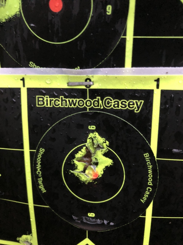

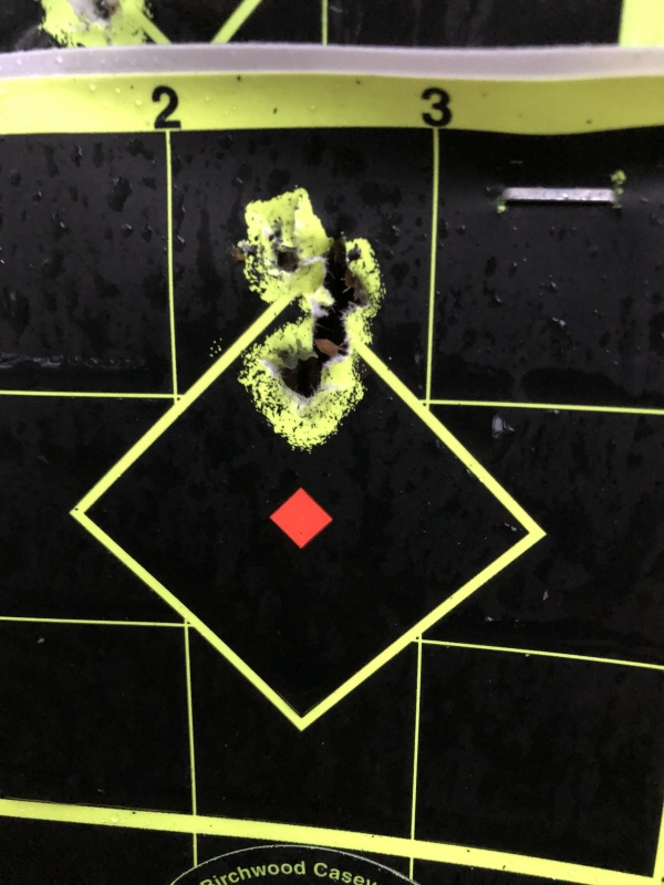

My Sniper shoots the 18.1 Exacts close to 900 FPS and the 14.3 CP’s @ 960. Both really accurate. Groups shown are these pellets @ 50 yards.
