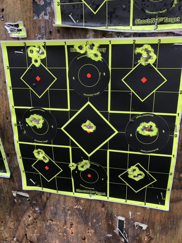

Shot these groups yesterday morning, reg pressure 145 Bar, hammer screw in .035”, 5 Shot groups @ 40 yards. Power 28-29 foot pounds. And no flyers.
Top are CP’s
Middle 18.1’s
Bottom 15.9’s
Top are CP’s
Middle 18.1’s
Bottom 15.9’s
Looks good my Compatto shoots comparable groups with those same pellets. I was plinking and pesting with the JSBs (15.89s and 18s). But the CPs have been shooting good to 60+ yards. For pesting and plinking they’re much cheaper than the JSBs. The Sniper did win the EBR 2018, 100 yard match. Awesome gun. Thanks for posting.
