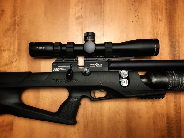

After shooting the Sniper with high Sportmatch rings and no rail I decided to give the rail a try. I ordered 30mm medium Seekins rings and mounted my scope in a few minutes. The Seekins rings really make the Sportmatch rings seem 2nd or 3rd rate. The rings simply "fit" everything! The scope is held snug, with no pinch. First class, all the way.
Though you cannot see it in the photo, due to the lighting, there is 1/4 " of clearance between the front and rear ends of the scope, and the rails.
