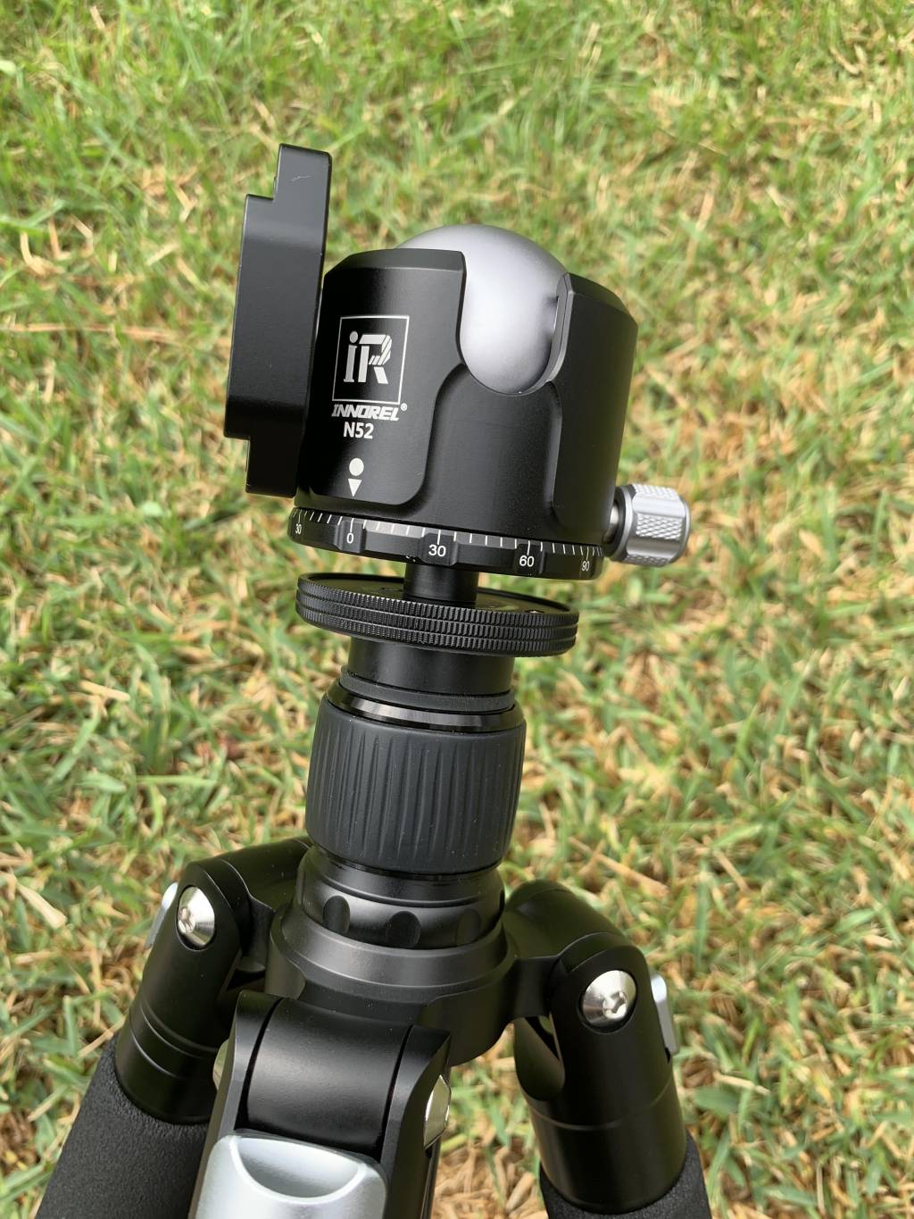

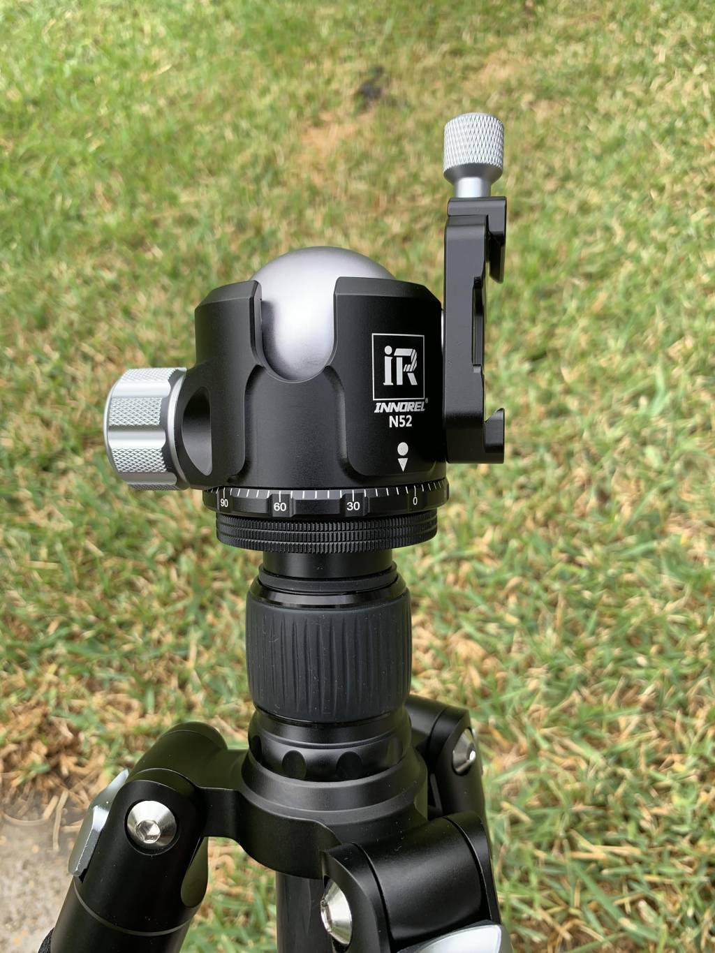

Changed heads to this Innorel N52.
This is a welcomed step up. One slight hitch to work out with it. The ball is hollow and has a large hole in the bottom of it. The mounting screw that the head is attached to extends into the hole and limits my range of motion, especially vertically. I tried to get my sights on some crows and was unable to tilt the head far enough to see them. I’ll have to explore other mounting options.

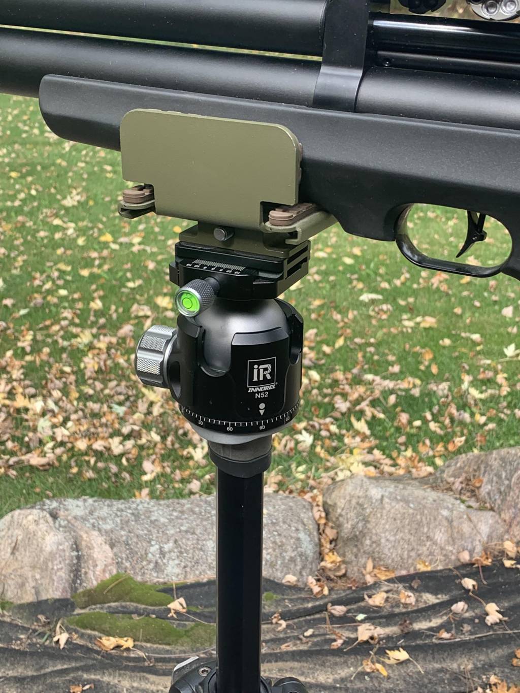

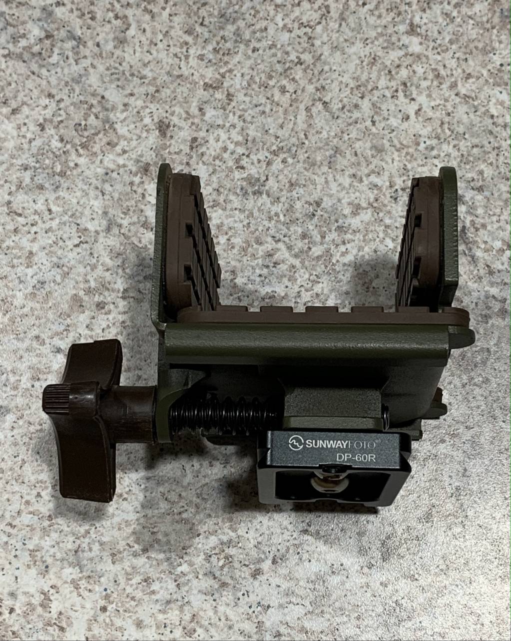

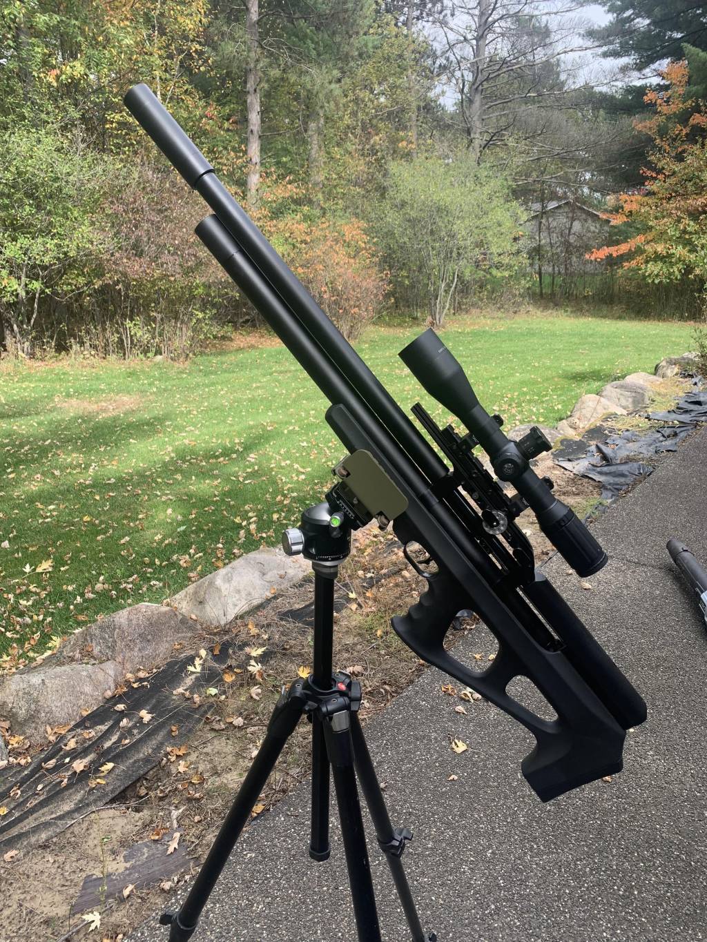

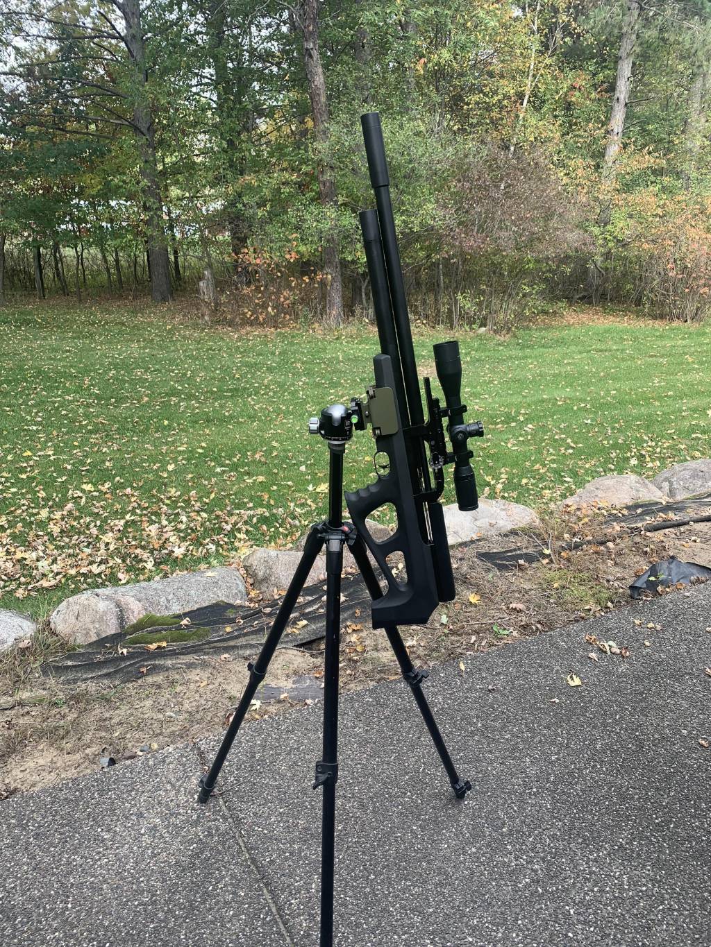

Here's how I have my N52 set up. Sunday DP-60R Arca adapter mates to my Pig Saddle. I can get plenty of vertical action on the ball head.
If you need more photos, let me know!

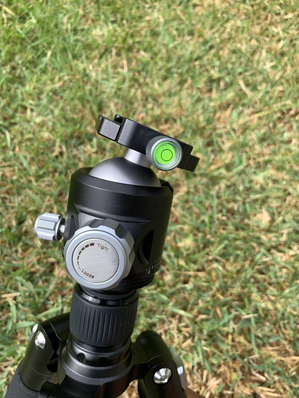

@Mr-H With the way that the N52 head is currently set-up to screw into the tripod’s center column the ball is limited in vertical tilt to this point.

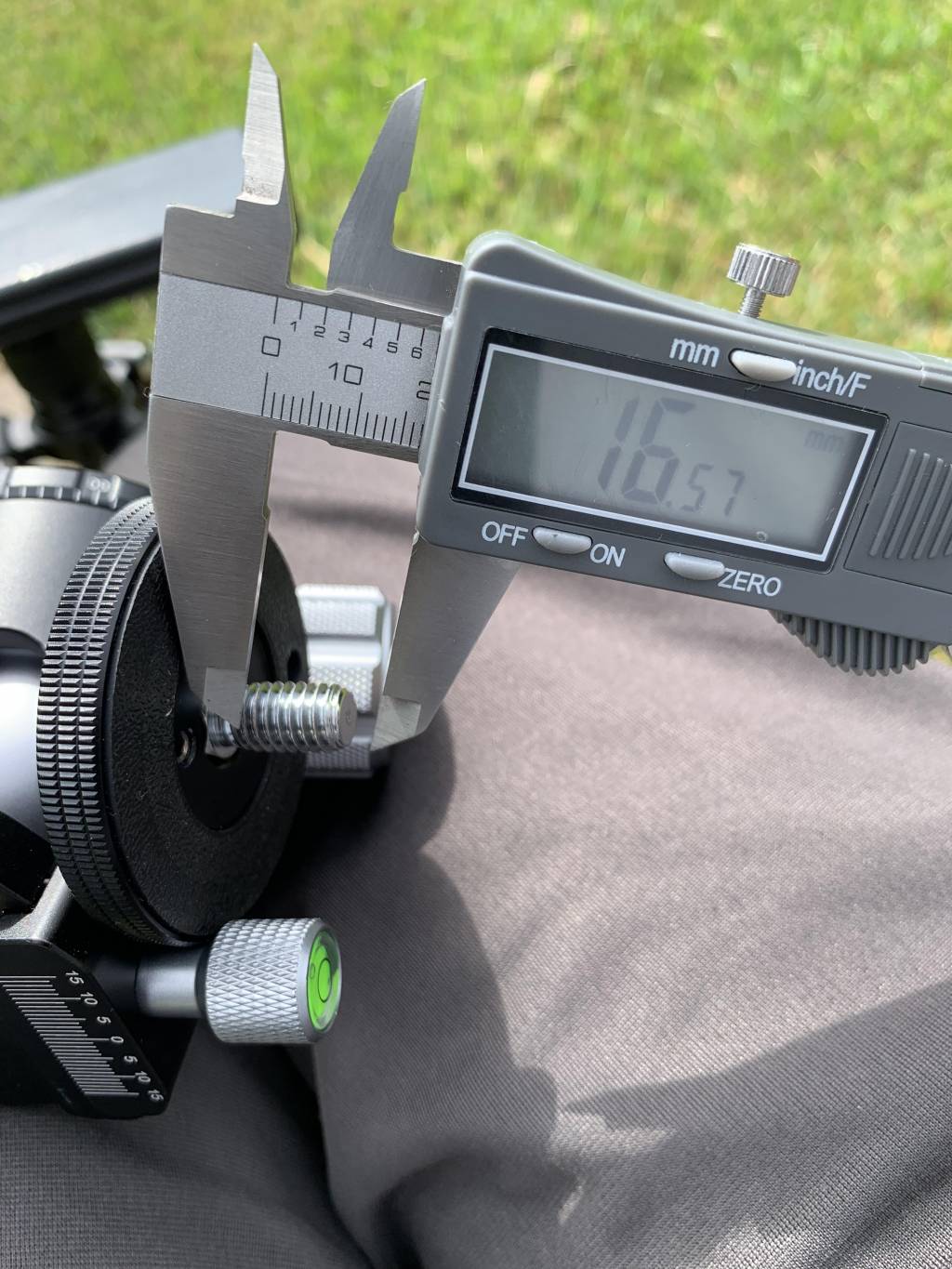

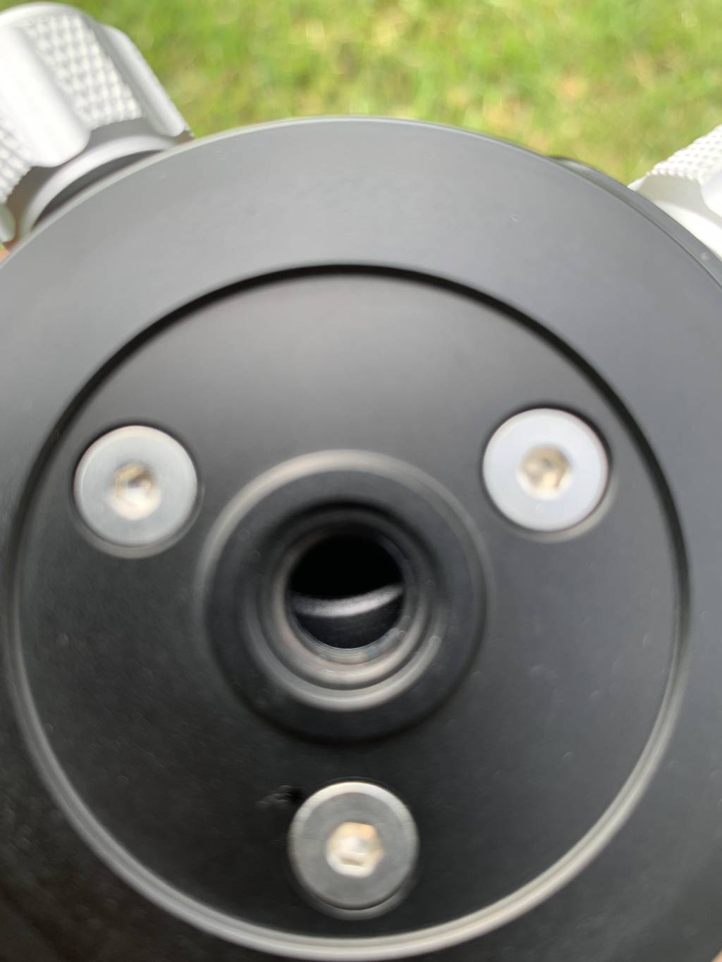

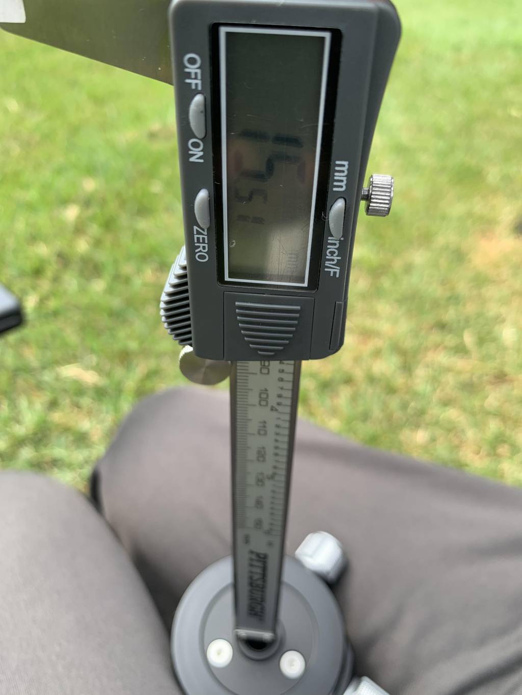

Here is a picture of the hole in the bottom of the ball. It is rotated so that you all can see where I will be taking a depth measurement from. When screwed down securely the mounting screw is entering this hole - the ball was rotated slightly to show part of the bottom of the ball. When aligned perfectly straight all that can be seen through the mounting plate(disc?) is the inside of the ball from the hole in the bottom of it.
The problem is that the length of the mounting screw is longer than the depth of the threads in the mounting plate/disc that the bolt screws into to affix the head to the tripod, thus protruding into the hole in the bottom of the ball and inhibiting its range of motion. This measurement was taken with the depth rod - I flipped the calipers to show the measurement as well as to show a closeup of what was measured.
Measurement of threads to bottom of ball/hole opening.

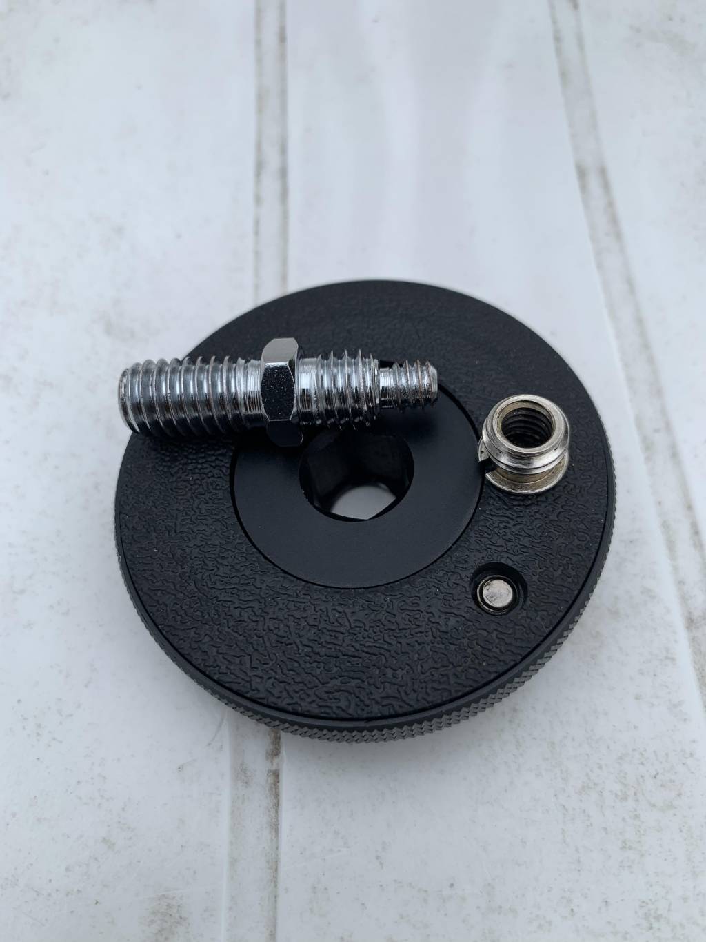

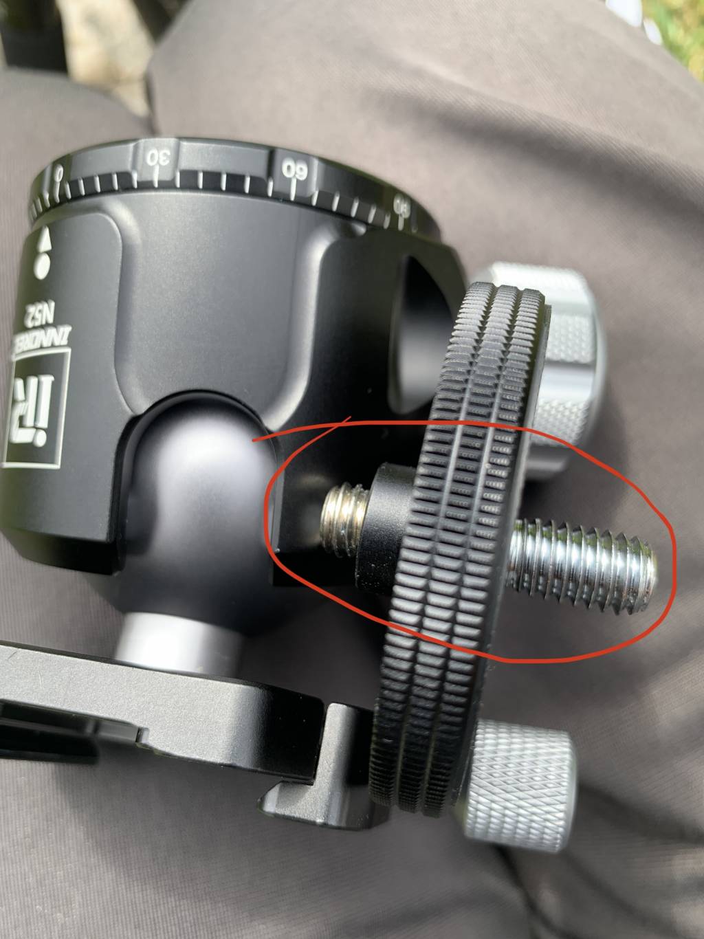

A solution I found was to remove the circled screw/double-sided bolt placing the long end through the disc and into the tripod. I don’t like it as a permanent solution because the threads on the shorter end are fitted with an adapter that screws over some skinnier threads, hence the color variation between the metals on both ends. The problem the adapter presents is the potential of unscrewing it from the bolt and dumping the head or the gun attached to the head. I’d like to find a bolt that is the proper length and won’t need an adapter. Hopefully this shouldn’t be too hard. I actually figured out a solution while putting this post together.
Simply flipping the mounting plate/disc didn’t secure the head well and left an undesirable gap between the head and tripod. The plate/disc is designed to fit the hex portion of the bolt (in the center of the bolt) so that it snugs down the mounting plate/disc and secures it to as it is screwed down into the tripod. When unscrewing the head for storage or to swap it out the mounting plate won’t fall off of the bolt and get lost. Flipping the entire mounting plate/disc negates this feature, so that won’t do.

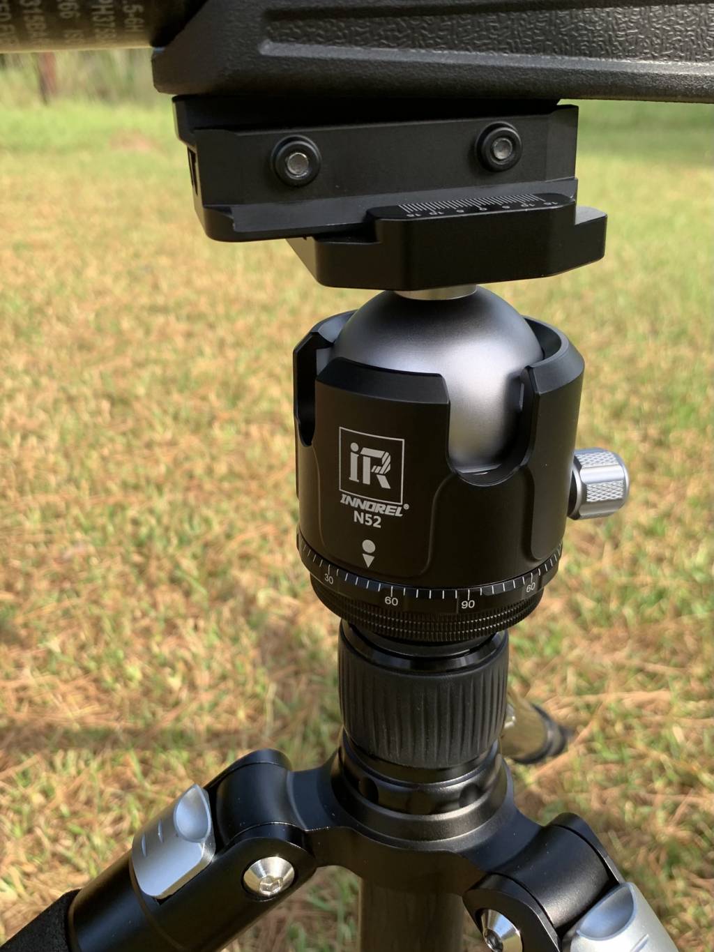

After making the change (flipping the bolt) this is the result. The gap is gone and I have the desired full range of motion with the ball.
If something I typed doesn’t make sense or needs more clarification please let me know.
Looks like you got it figured out!

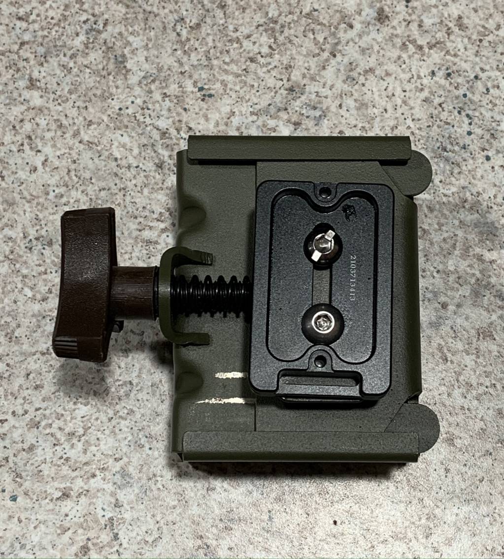

@Mr-H Thanks for the pig saddle link. When you have time can you take a picture of the hardware that secures your N52 to your tripod? It’s tough to tell trying to zoom in on the pictures you posted.
Here is the Arca plate that works with the saddle. It uses two different threaded bolts that attach to the saddle. I think I used blue loctite on the threads.

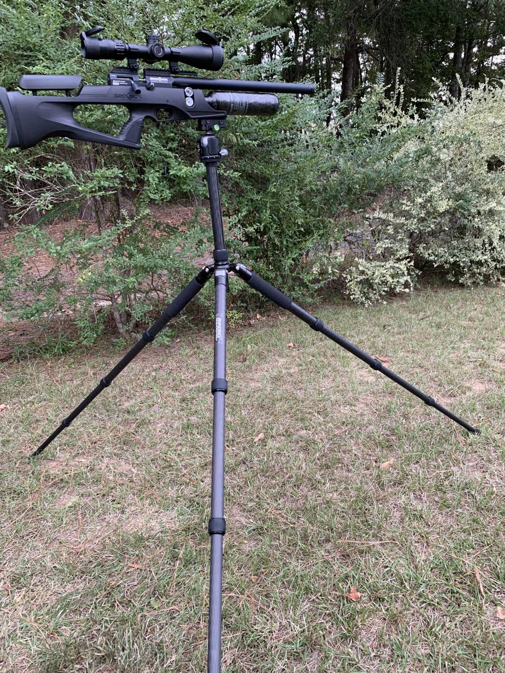

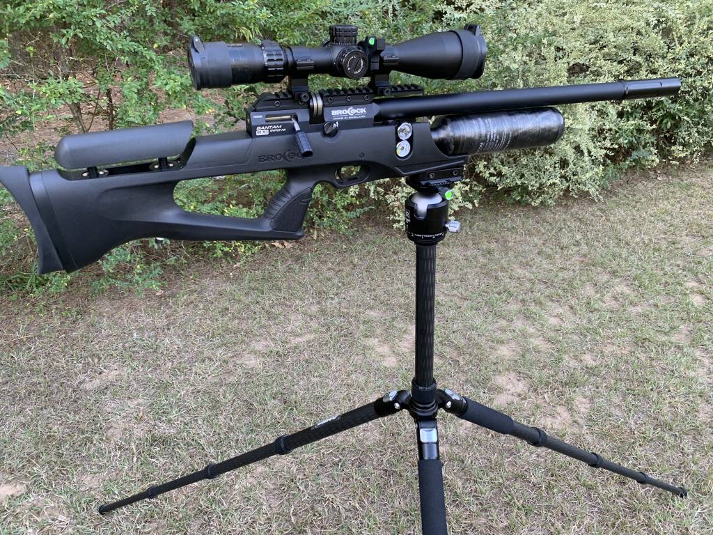

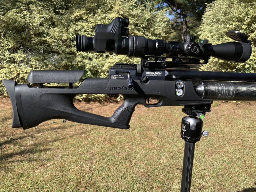

Today was my first day practicing shooting while standing with this tripod and head combo. It wasn’t bad, although the center column has a little play in it. If I don’t position my feet to carry my own weight to prevent leaning on or into the tripod too much it will wobble slightly. It would be nice to be able to shoot with the tripod’s legs closer together. When I position it that way it stands tall enough to shoot without the use of the center column, but if it’s bumped or kicked there’s nothing locking the legs in place and they can fold in and topple the tripod and gun. Eventually I’d like to try a tripod with a bowl in the future. I really like this Innorel N52 tripod head, great value for the money in my opinion. This set up suits me nicely.

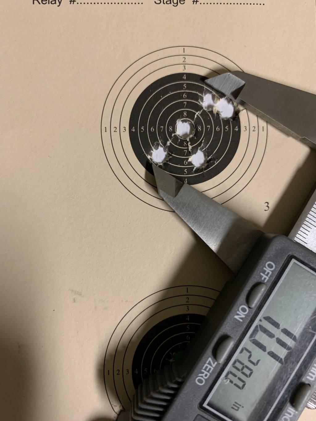

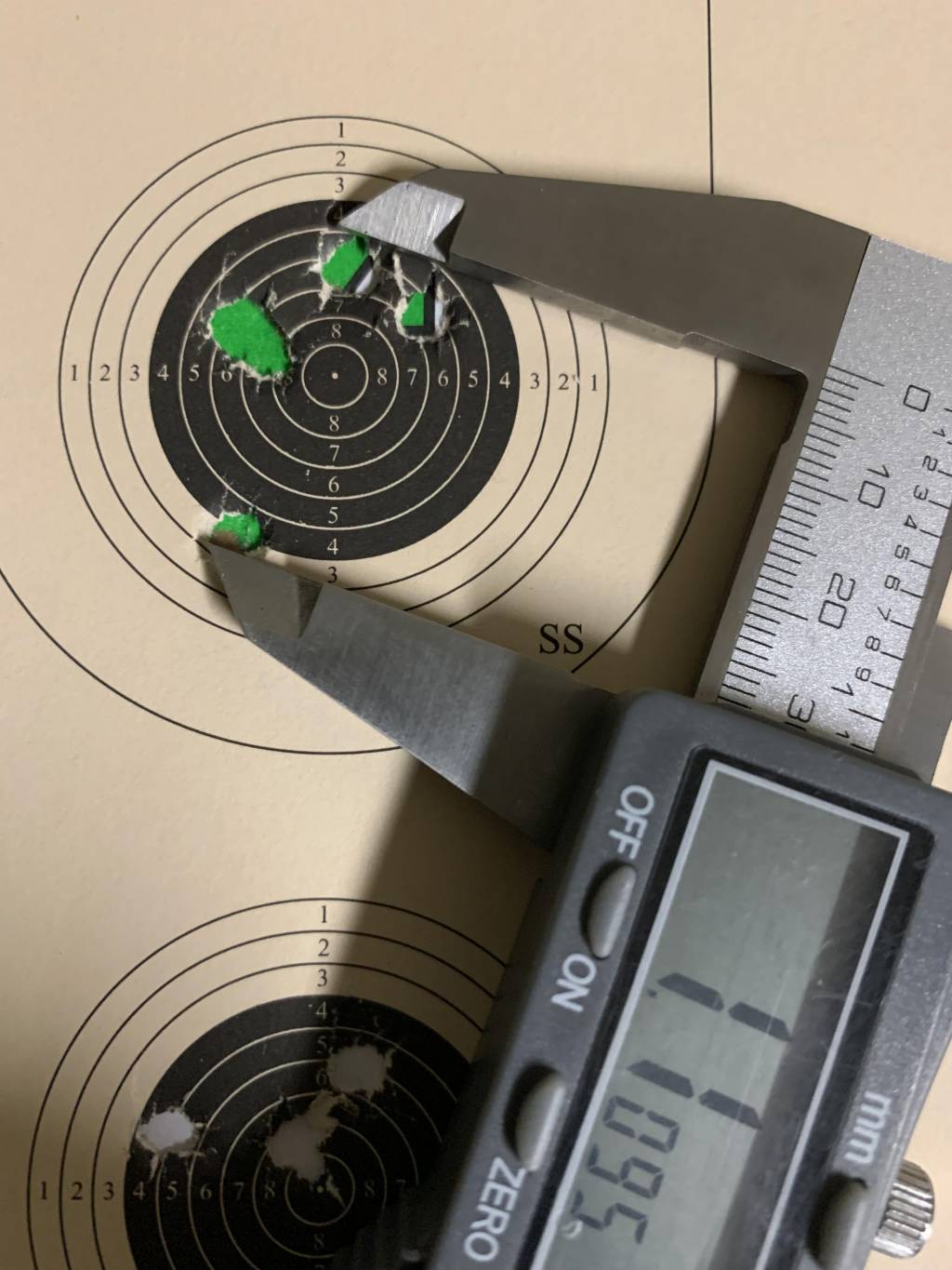

From 50 yards i shot a few 1” -1.1” groups. I know it’s not the best, but it’s an improvement for me. Hit a couple bulls too.
These are 5-shot groups:

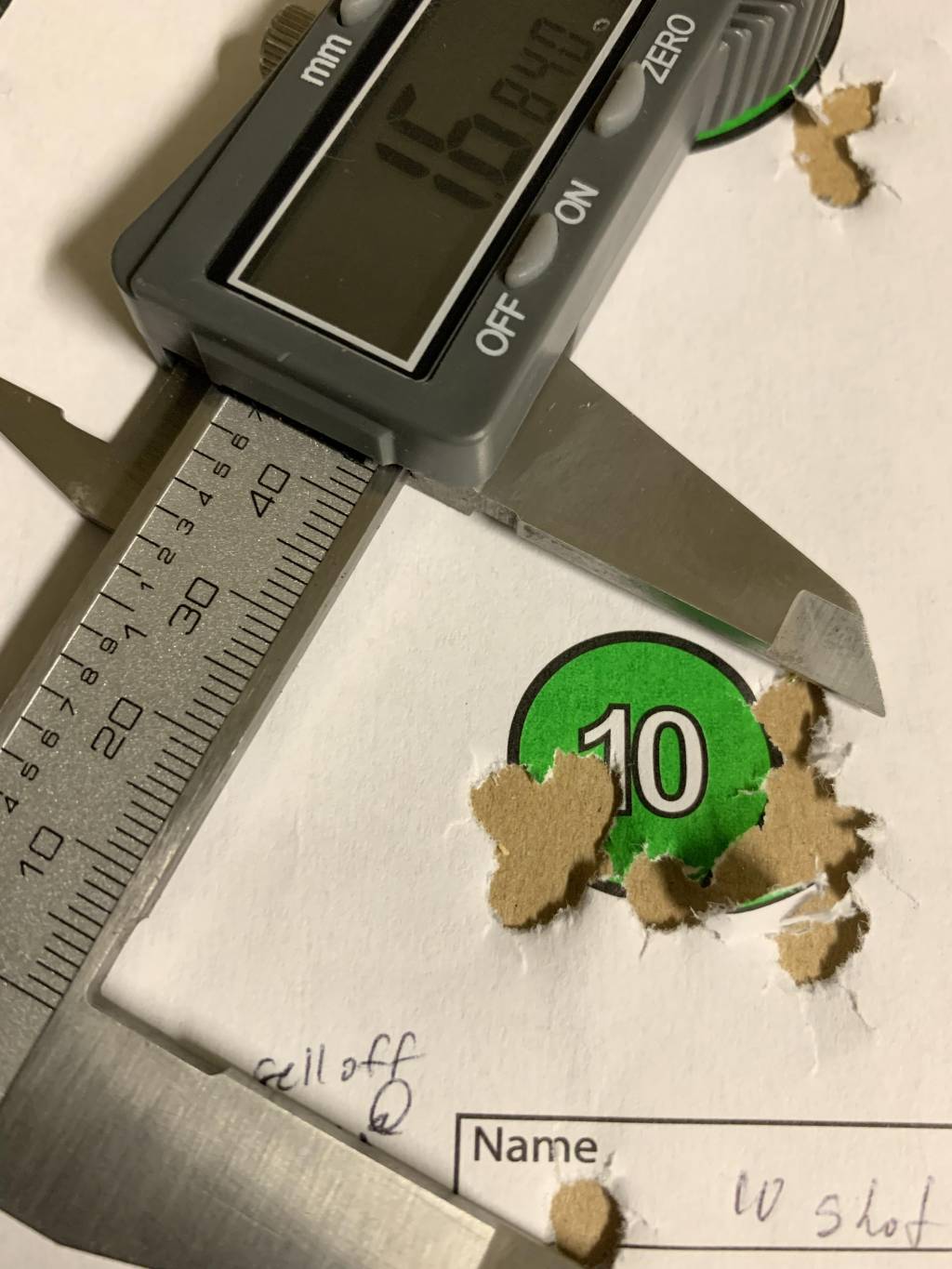

This is a 10-shot group. Shot #7 fell off the reg. I estimated my holdover to compensate based on where shot #7 fell and I took shots #8-10 off the reg.
I felt kinda good about this group. Minus shot #7, the group measured 1.18”

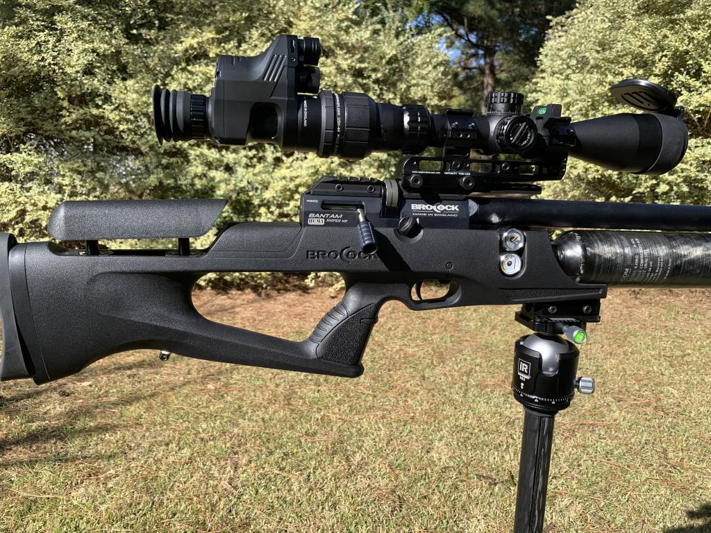

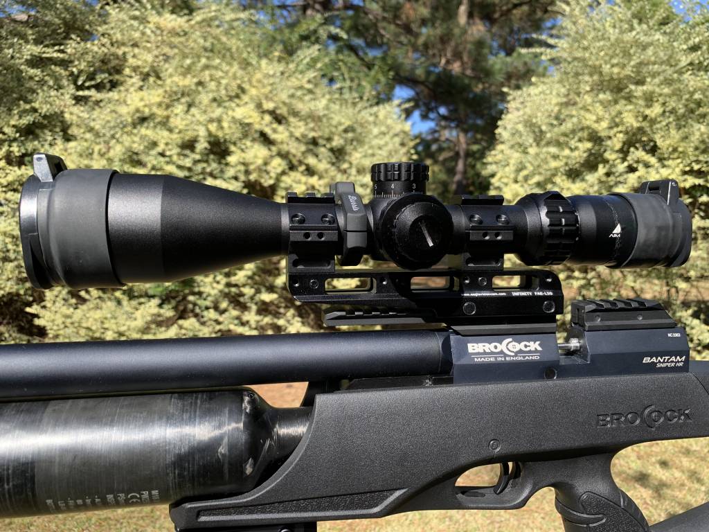

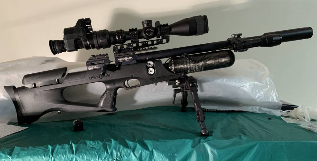

Added an Eaglevision one-piece Adjustable Infinity Mount for use with my Pard NV007a. This seems like it will be good to prevent me from having to remove my rings to mount the scope forward each time I attach the Pard unit. I’ll add a photo when the site allow me to.
This is the scope on the mount before affixing the Pard NV007a. Notice the position of the ocular lens in relation to the cheek rest.
After mounting the Pard. Look at the front of the mount on both pics. In this one you can see how it slides forward. Now note the position of the Pard eyecup in relation to the cheek rest.
The Pard mounted before the forward adjustment
After the forward adjustment

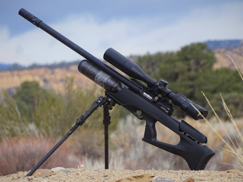

I was just shooting my Sniper Safari HP this morning on my Bog Deathgrip tripod. I have mine setup to shoot 25.89 grain at 905 fps in .22 caliber. Missed just 4 shots over 43 1 1/2" targets. I have them spaced out at 40, 50, 60, 70 and 80 yards with 1" targets at 65 yards. The Sniper s a great little gun and I love my tripod, not as stable as a bench but it's what I use when hunting squirrels so I practice how I hunt.
