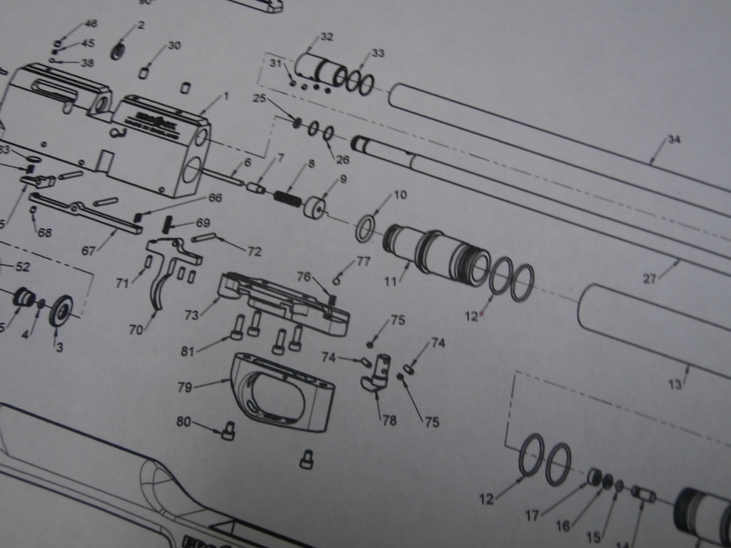

They are not difficult to work on. I have had mine apart on numerous occasions and have now done extensive modifications to it to add a new barrel system and a CF Bottle.
You likely have just picked up a bit of trash in the valve seat area. I am assuming you have tried filling it by cocking it first to remove any hammer pressure from the valve stem.
If you have the parts diagram from your manual look in the area of #7 and #9.

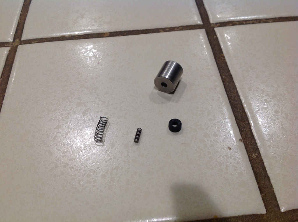

Im pretty sure I could probably repair it the problem is when I took it down to inspect it I ended up with these parts left on the bench
I know where the big aluminum spacer goes and I think the small spring goes in the bolt handle along with a tiny ball bearing which I think is missing The black spacer I have no idea where it came from the bigger spring goes over the end of the valve seat?? I think lol
i bought the rifle used on agn with no manual
