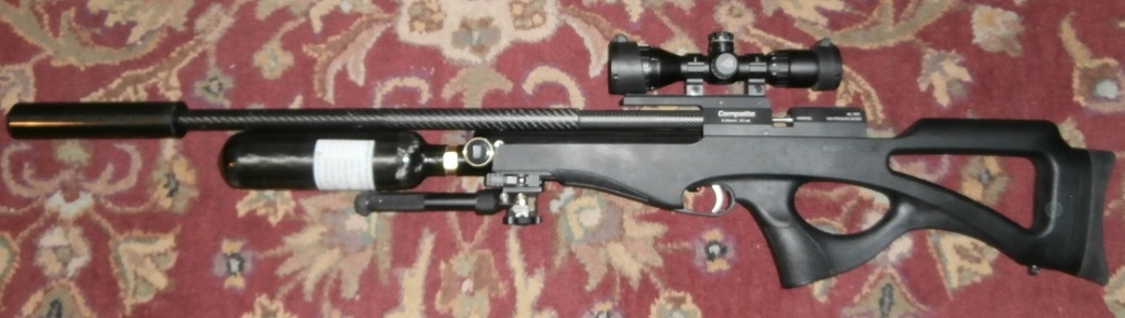

And another year has gone by. Best shot count with the original air tube and JSB 34 grain at 40 ft/lb was 1 magazine from 240 Bar to 100 Bar.
Great things are in store for this Compatto:
24" Heavy Lothar Walther .25 Polygonal Barrel machined for the Compatto and threaded 1/2-20 for a moderator (Original barrel is 17")
Shorten Tube and add a custom bottle adapter block with gauge and foster fill port.
Add a 500 cc Carbon fiber Bottle
Lane Regulator set for a 60 ft/lb gun (pressure and large plenum)
JSAR will be doing the machine work!
Hopefully it will be done in a month or two and I can begin tweeking and testing once again.
Edit: My Compatto arrived at JSAR Monday the 19th of March. They tell me about 4 to 5 weeks depending on workload. They have to design and produce the bottle block with foster and gauge ports, machine the barrel blank (lead, breech seal, transfer port) and thread the muzzle end for a moderator, shorten the existing tube, machine the tube for the bottle block attachment and mount it. Can't wait to see the results. They usually turn out some very special items. I wish Travis would come up with a balanced valve for it as well. ;)
Edit Update: In two days it has been at JSAR for 2 months and no date of completion in sight since it is waiting on an unchoked LW Poly Barrel (no ETA). I don't think it is very high on their priority list (if it is even there at all) since they are busy bringing the Raptor to market. Possibly it "might" be done in another couple of months (I HOPE)! Surely before Christmas 2019! lol
At this point I am kind of starting to lose interest in the project due to delays.

Just to provide closure for this thread: JSAR made me a new bottle block that fit very well and it has now been leak free for over 4 months. The gun shoots very well ... much better than I expected from the stock valve setup. Hole in Hole at 66 yards. The regulator I used is an Altaros from an older AirForce gun that I converted to non regulated. The regulated pressure is about 1800 PSI and I get a LOT of shots from the 350 cc bottle filled to 4350 PSI!
I have been waiting for FX to ship me a Chrony for several months now so I can do some chrony work on the gun. Still has not been shipped though so I am still waiting to finish the characterization of the gun. The gun is shooting very flat though so I am estimating based on flight time to target that the velocity for 34 grain slugs is around 875 fps or so from the 24" poly unchoked barrel!
All in all I am pleased with the conversion!
