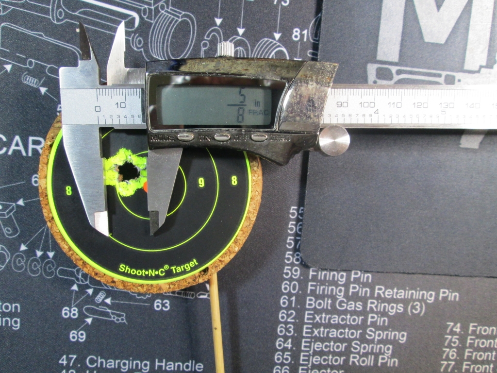

Regarding accuracy, I'll let the photo speak for itself, 18.5 yards, ranged on my accurate range finder, all ten rounds one ragged hole, from a bi-pod...
I can only add this, I am a decent shooter, 237 out of 250 on the KDQC with iron sights and an M-16, I can't max the offhand because I am too tall and thin (the wind blows me around)... I have zero experience tuning an air rifle, I came from the PB world... Ok, a lil better than decent... One ragged hole, ten shots...
Ken
EDIT: I looked closer at the target, it might be nine in one ragged hole, I cannot determine if the one at 9 o'clock wide left is a flyer or not...

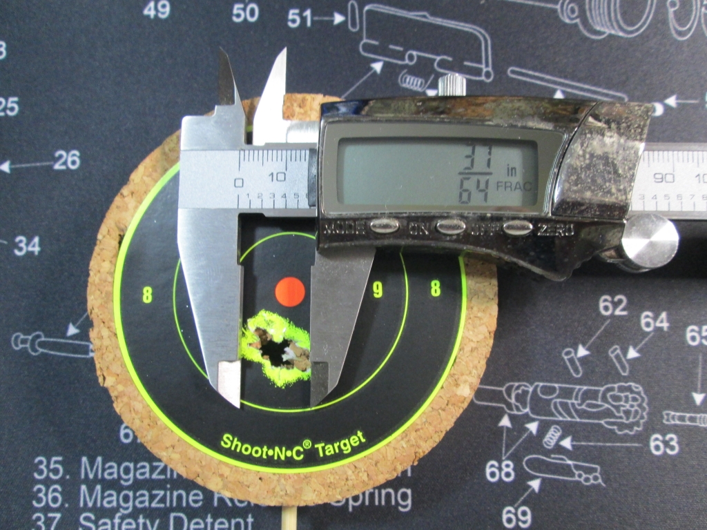

Ok, shot another string at 18.5 yards, ten shots on power setting 3, one ragged hole, JSB 15.89gr, Jumbo Exacts...

Ten shots, 18.5 yards, Power Setting 3, from a bi-pod, JSB 15.89gr Jumbo Exacts
From a bi-pod on my mattress (bed)… Ken

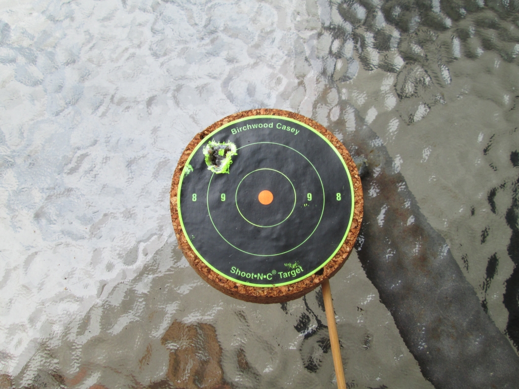

Here's another ten shots put through the chronograph on the lowest setting, using JSB Exact Jumbo 15.89gr, again, ten shots, one ragged hole...

Group Size (in): SEE PHOTO
My group opened up a lil bit, my fault, my breathing and heart were not in control... Just ate lunch...

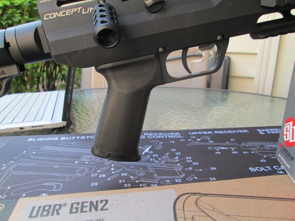

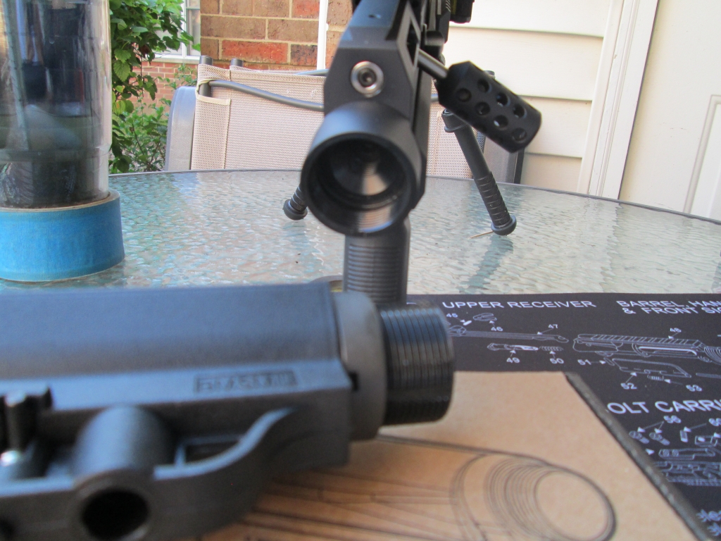

The rifle is 32.5 inches long with the stock collapsed, I'm about to make it a whole lot shorter... About to install some new goodies on my Concept Lite...

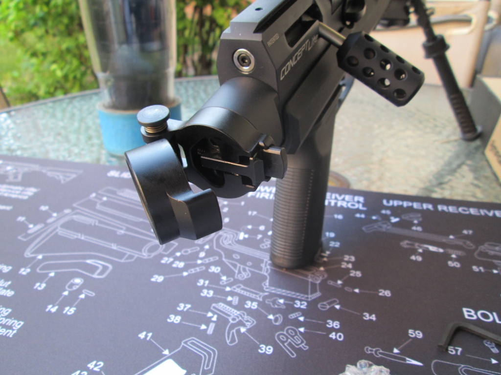

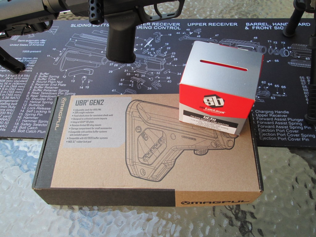

In the first photo you can see the MagPul MOE AK+ Grip (Rubber)

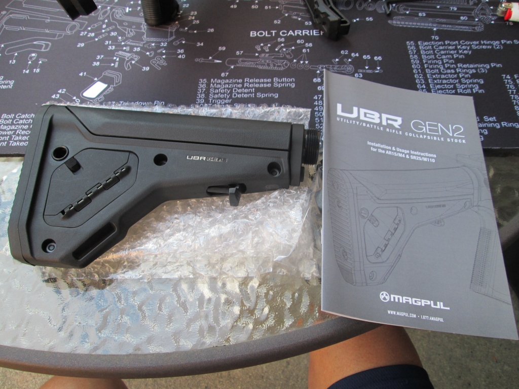

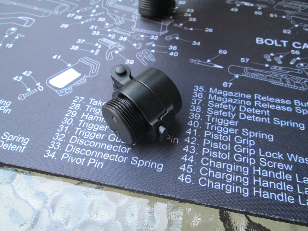

The second photo shows the parts I am using to convert to a Magpul folding UBR stock...
EDIT: Ooops sorry, the 32.5" is with the LDC removed... With my 0db LDC on, the folding adapter installed and UBR stock collapsed (not folded) 39.75"...
Ken

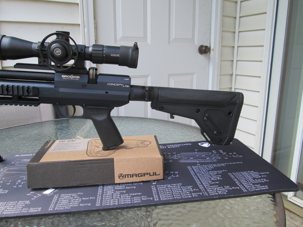

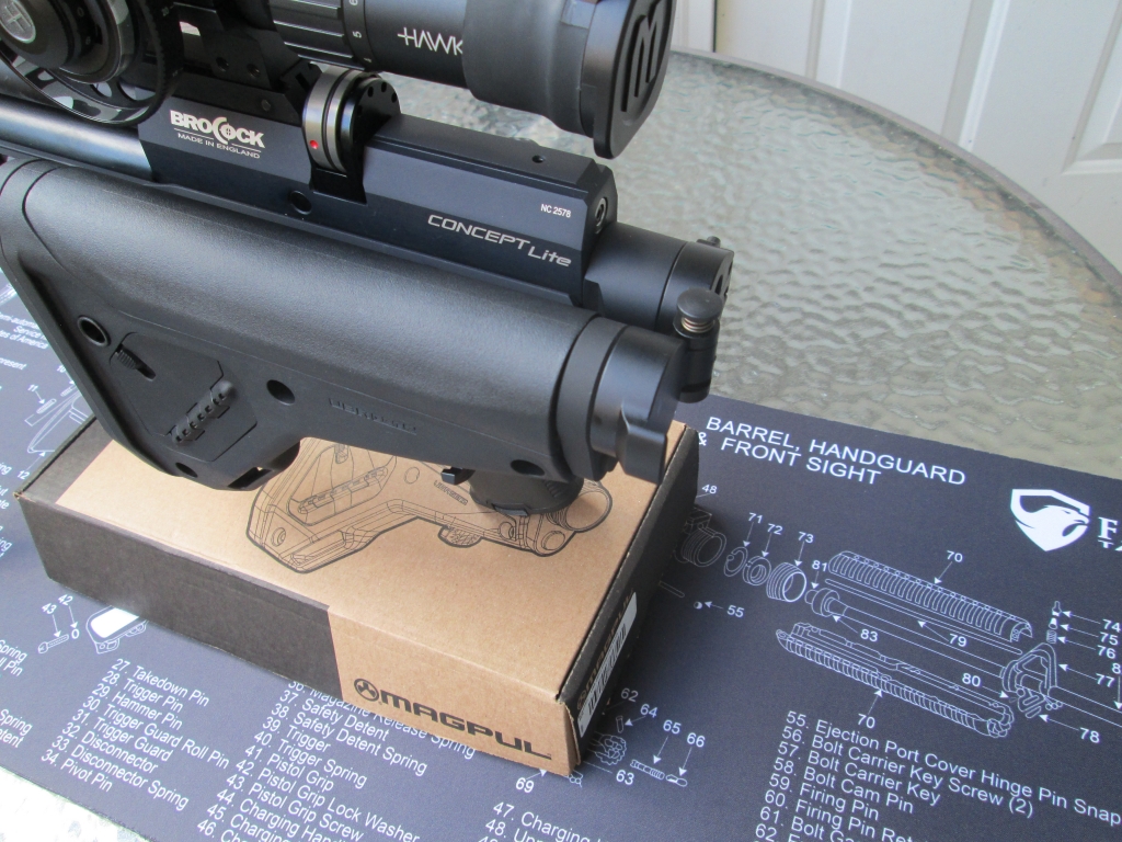

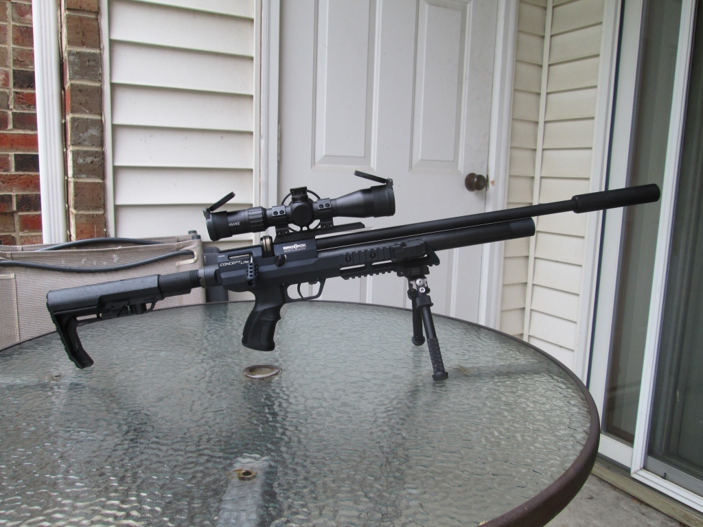

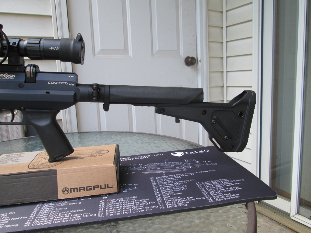

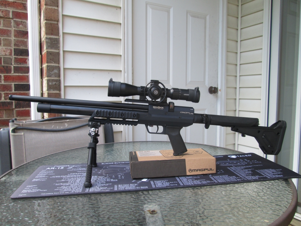

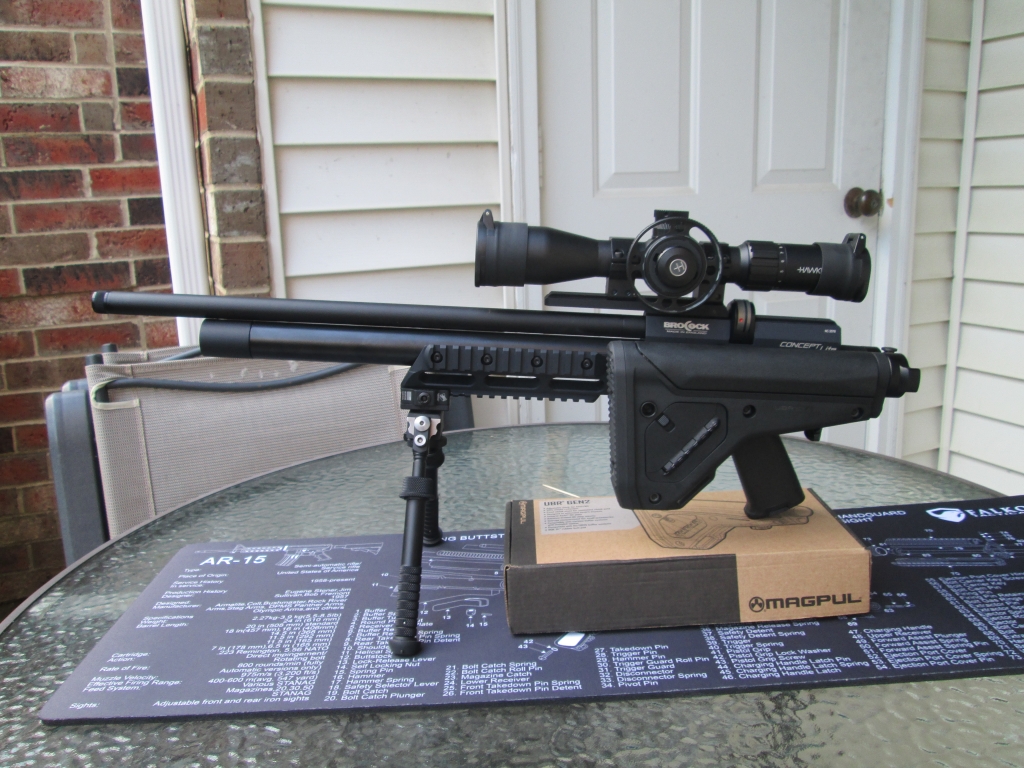

I chose a Magpul UBR stock, there's a storage compartment in the stock, can hold one extra magazine for this rifle, or …??? And a little room to spare, not quit enough space for two magazines...
There are many AR style stocks, some other adjustable AR stocks will work with the stock Brocock buffer tube, some AR stocks require special buffer tubes, follow the directions for the stock you're installing... Here's some more photos showing my installed folding stock...

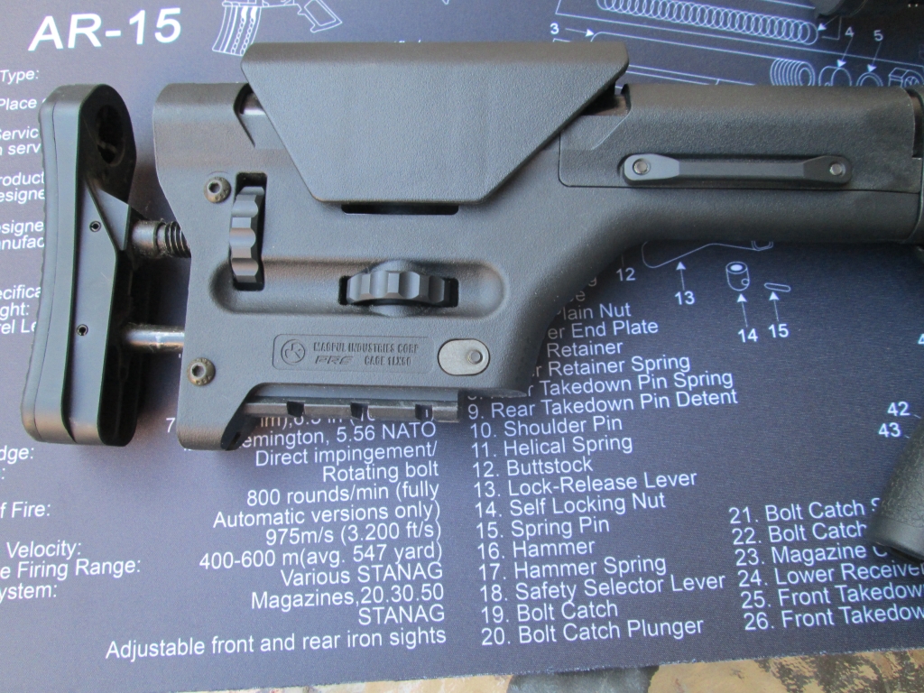

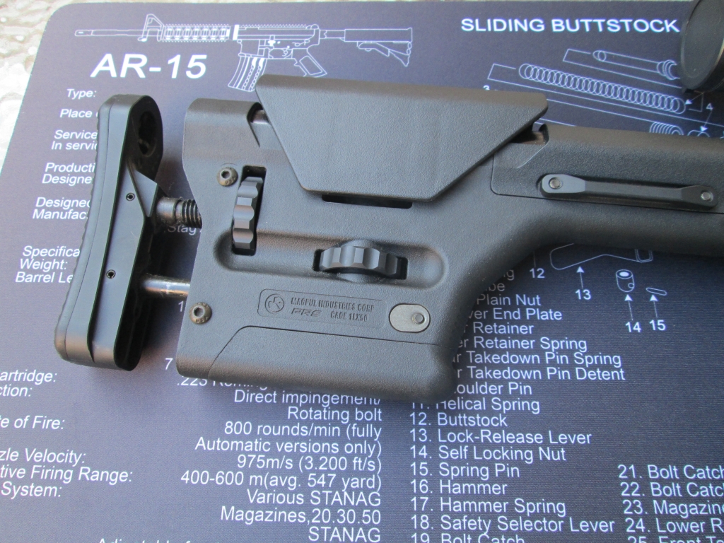

I may try my Magpul PRS (Precision Rifle/Sniper) stock on the Concept Lite, it allows for adjustment of the cheek weld and pull, it also has a picatinny rail on the bottom of the butt end for a monopod, handy for bench shooting... It's a bit more complicated of an install and the rifle will need a correct MILSPEC buffer tube to mount on the Concept Lite, it can be used with the folding adapter I am using, I may pull it from my other rifle to see how it feels on the Concept Lite, I'll take some photos...
If you have an AR style rifle and it's front heavy, try a PRS it's heavier than most AR style stocks and can help balance out a longer front heavy rifle (bull barrels etc)
Just my .02 from experience...
