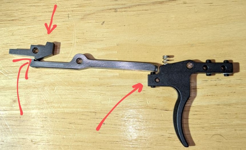

There are really three main areas that need polished to make the Concept's trigger feel much better, basically the three points of contact between the various trigger components.

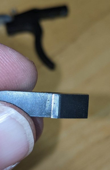

The parts come with some machining marks in them, and I personally think those machining marks not smoothly sliding past each other is where some of "scratchy" feel comes from. Here's an example of the contact point right next to screw "D" before I did any polishing...
Those machining lines can't be doing anything good towards a smooth trigger with a clean break, especially b/c they're parallel on each part, so they can nest inside each other to create a skipping/catchy sensation.

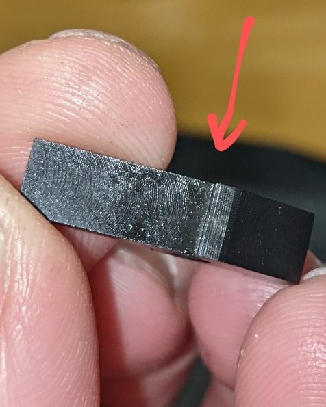

Here's a photo about halfway through polishing them out....
The bluing is leaving, as are the ridges. Eventually I arrived at a smooth surface on this and the other contact points.
