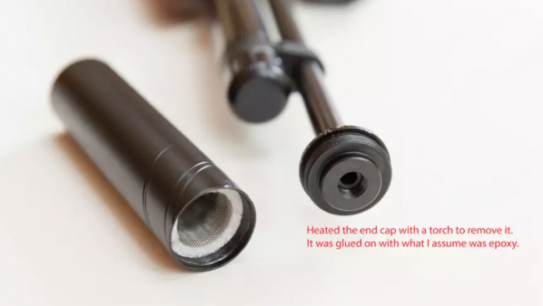

The back end just unscrews. It may have some thread locker on it so a little heat from a heat gun. Don't think a hair dryer is enough. Mine came right off when I removed the Huggett from the gun. However I have made an interesting discovery. The sound deadening from the Huggett is almost as good as the Tanto. The Huggett has a fine pieceof screen wrapped with a thin piece of foam. Nothing more. I also shot it with no silencer and it is very loud. Like a .22 pistol loud. By the way the thread size on the end of your barrel is 10mm x1. An unusual size we normally do not encounter here. I had to use a slip joint pliers with a thick piece of leather to protect the silencer. Good luck. Nick

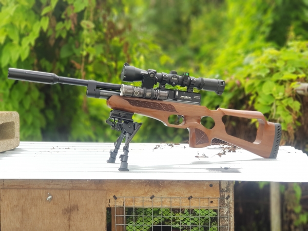

I remember someone posting awhile back that they put plastic bottle caps inside the factory Hugget moderator and it really reduced the decibel level. Something to experiment with I guess. My Contour Elite S6 did not come with a moderator so I just bought a DonnyFL Tanto moderator and it works really well and keeps the length short. I also have a Neil Clague LDC which is 8 inches in length and also works great but too long.
