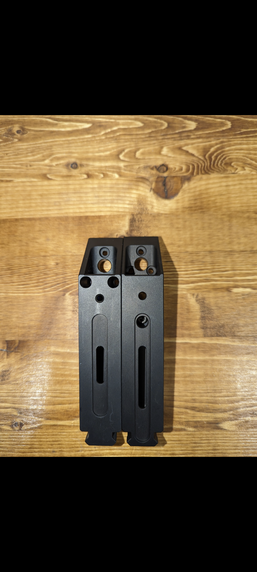

The current production version is the one on the right.
Remove the four bolts holding this shoulder piece to the gun. (Three in the triangle pattern up top and one down lower, in the slot for the plastic buttpad).
Shoulder piece drop down and hammer spring tension wheel will detach from the gun. That will allow the hammer spring to be removed and replaced.
Replace the drop down, the four bolts, and then the plastic shoulder piece.
