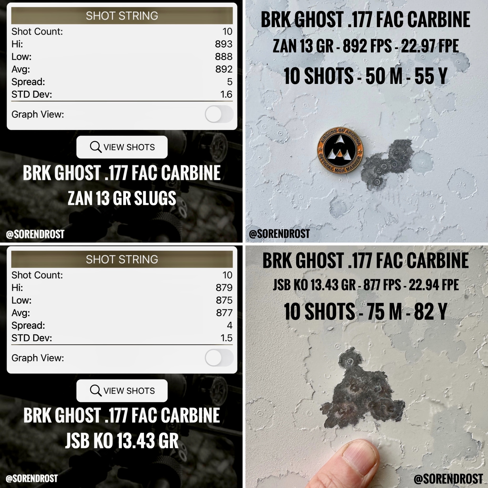

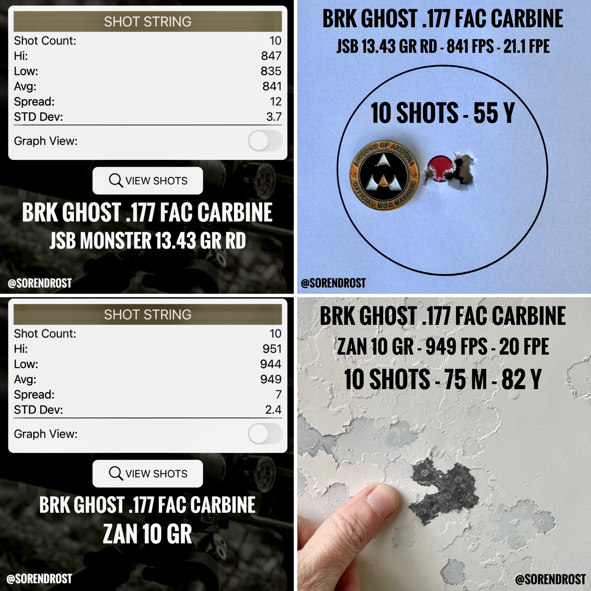

What kinda shot count with the testing you have done
I did a full shot string this afternoon shooting the JSB 13.43 gr RD at 870 FPS - I got 90 shots from a fill (y) :)
