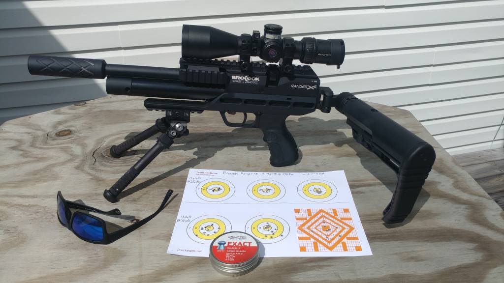

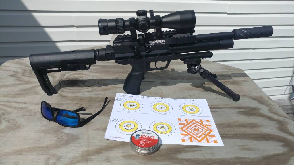

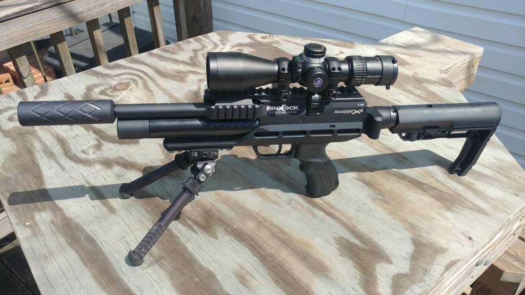

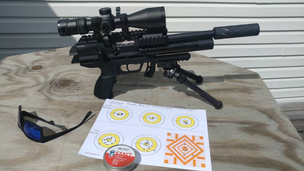

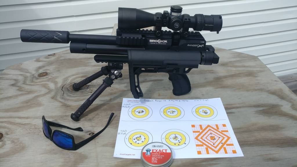

I was in the market for a new "low power" truck gun and I have to thank my buddy Mike B. (Team Centercut) and the good folks at AoA for all their help getting this to me. While it was on the way, I watched Steve's(AEAC youtube channel) video on the .22 Brocock Atomic again, so I would be familiar with how the gun works. Upon arrival, I ran 3 Patchworms thru it(pretty clean from factory), mounted a scope and bipod, put the FX Chrony on it, and started shooting JSB 8.44g. The .177 magazine is the new "Daystate style"(front flip door) magazine and holds 13 pellets. The short 0 db does a descent job, but the longer one(or a DonnyFL Tanto, or Huggett Astille, or...) makes it REALLY quiet.
It was shooting the 8.4g @ 758 fps, so I tightened on the hammerspring to bring it up to almost 800 fps, which is about all this small sub 12 ft lb .177 was designed to do. I got 3 mags(39 shots) before I had to refill. They include a male threaded probe, as well as, a barrel endcap(in case you don't want to use the moderator)with the gun.
The trigger was pulling heavy(2.5 lbs) with a long 1st stage out of the box, so I adjusted the creep out of the 1st stage and the break to 1.5 lbs.
I tried JSB Heavy 10.34g which did well out to about 30-40 yards where I could see them start spiraling and getting blown by wind. JSB 13.4g Monsters(and RDs) were even worse. H&N Barracuda Match and Extremes showed promise, but I don't have too many of those(I will get more and revist later). The best results of what I tried were the JSB 8.4g:

The way you have to fold the collapsible stock- OH MY FRIGGIN GOD!!!! You have to twist it(like a doorknob) WHILE lifting up on the stock and pushing down on the receiver. If you don't do it just right, it binds. The same way in reverse to unfold it(it locks in the folded position). Why can't I just push a button??

Here's some more pics:

The Differences are the Ranger has pic scope rail, pic side rails(for mounting lights, lasers, etc..), 0 db moderator included, as well as, the folding stock. Also, just looks and feels "beefier".
The Atomic MAY be a better value for some. The Atomic wouldn't stay put where I wanted on the front seat of my truck without that folding stock. THAT is what I needed, so I bought the Ranger. With the stock folded, it will sit on top the front seat, my center console, or even fit up on the dash fine. For a quick close shot, I don't even need to unfold it. It may be a "niche" thing. To be fair, price wasn't a big factor in my decision to buy it. I'm having a blast learning it and looking forward to pesting with it.
