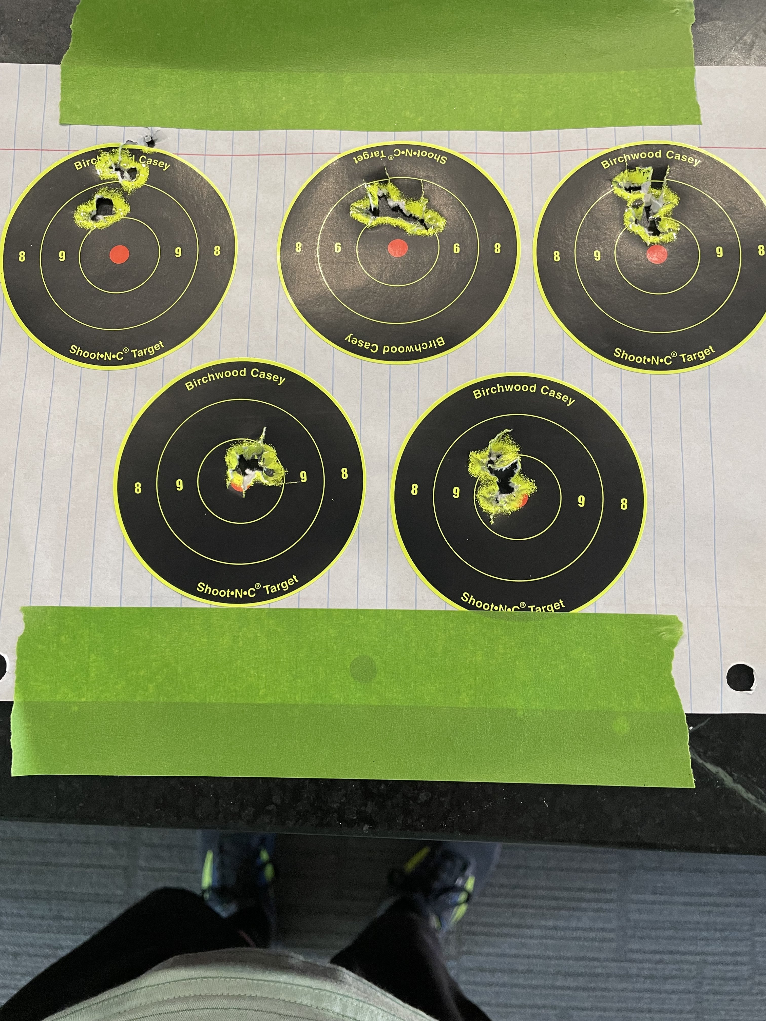

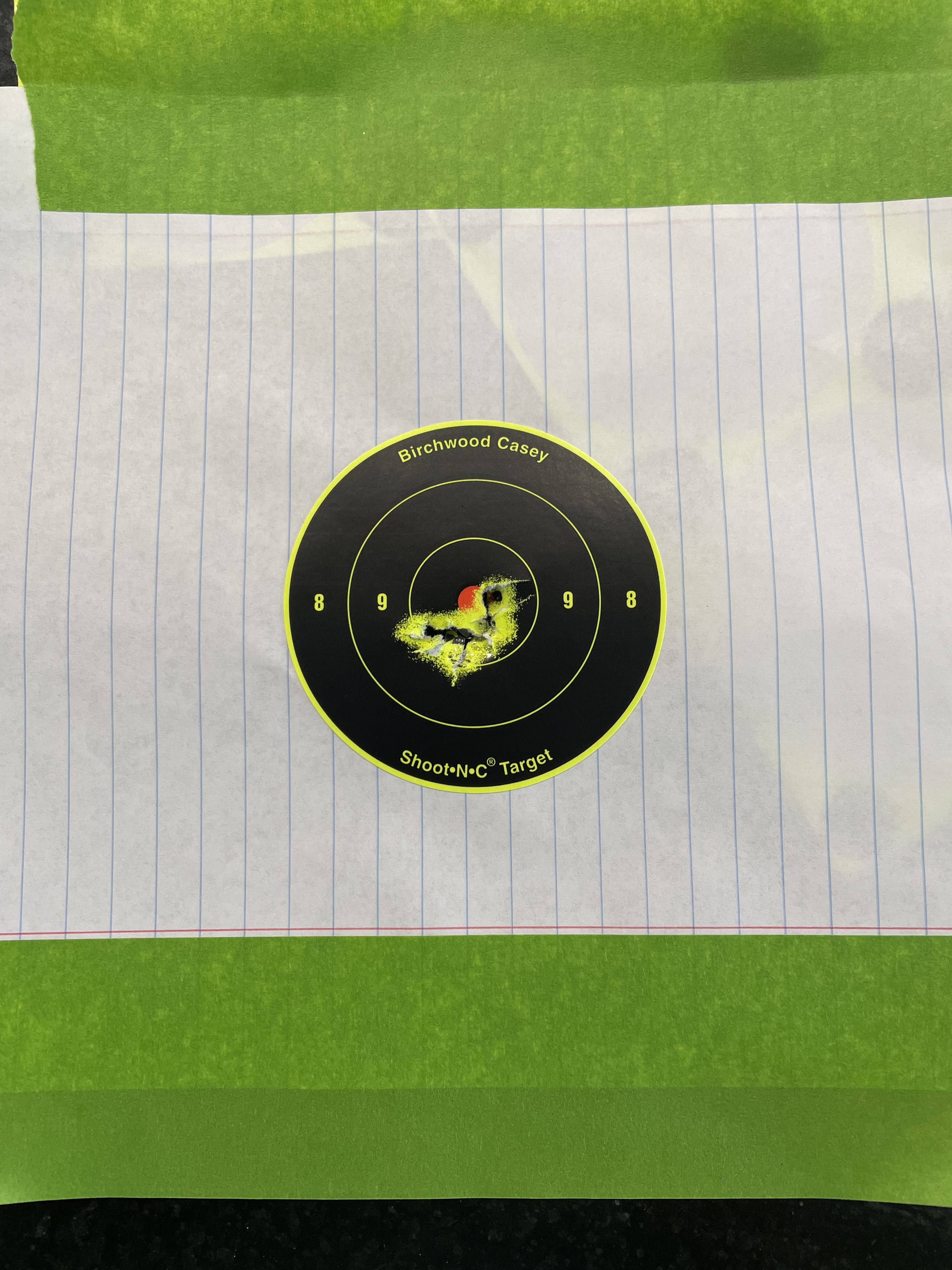

So my first shoot after sighting it in. I got a JSB .22 sampler with 13.4 gr Jumbo RS, 15.9 gr. Straton, 18.1 gr heavies, 25.4 gr. Monsters and I wanted to try out a lead free pellet so I also got a tin of Predator GTO’s, 11.75 gr.
I started with the lightest and worked up. From 30 yards, slight breeze. First target on the top left was the GTO’s full power. The next to the right was the GTO’s medium power, I thought as light as the GTO’s were they might do better on medium. I think they did, the vertical spread was less and the horizontal may have been wind aided as it was a cross breeze.
The next to the right is the RS’s. Looks a little better than the GTO’s. The bottom left is the Straton’s. These were the surprise for me. That is pretty near a single hole. Next over is the Heavies. Not bad, but not as good as the Straton’s. The second picture is the Monsters. They did about like the Heavies, but either way I wouldn’t intend to use them with this gun as the Ranger is specifically my low power gun. I am very happy with those Straton’s so that will be my go to pellet. Unless our Walmart has the Crossman Premiere’s and they prove to be as good as in L.Leon’s experience. I will at least give the Premiers a try if they are available local.

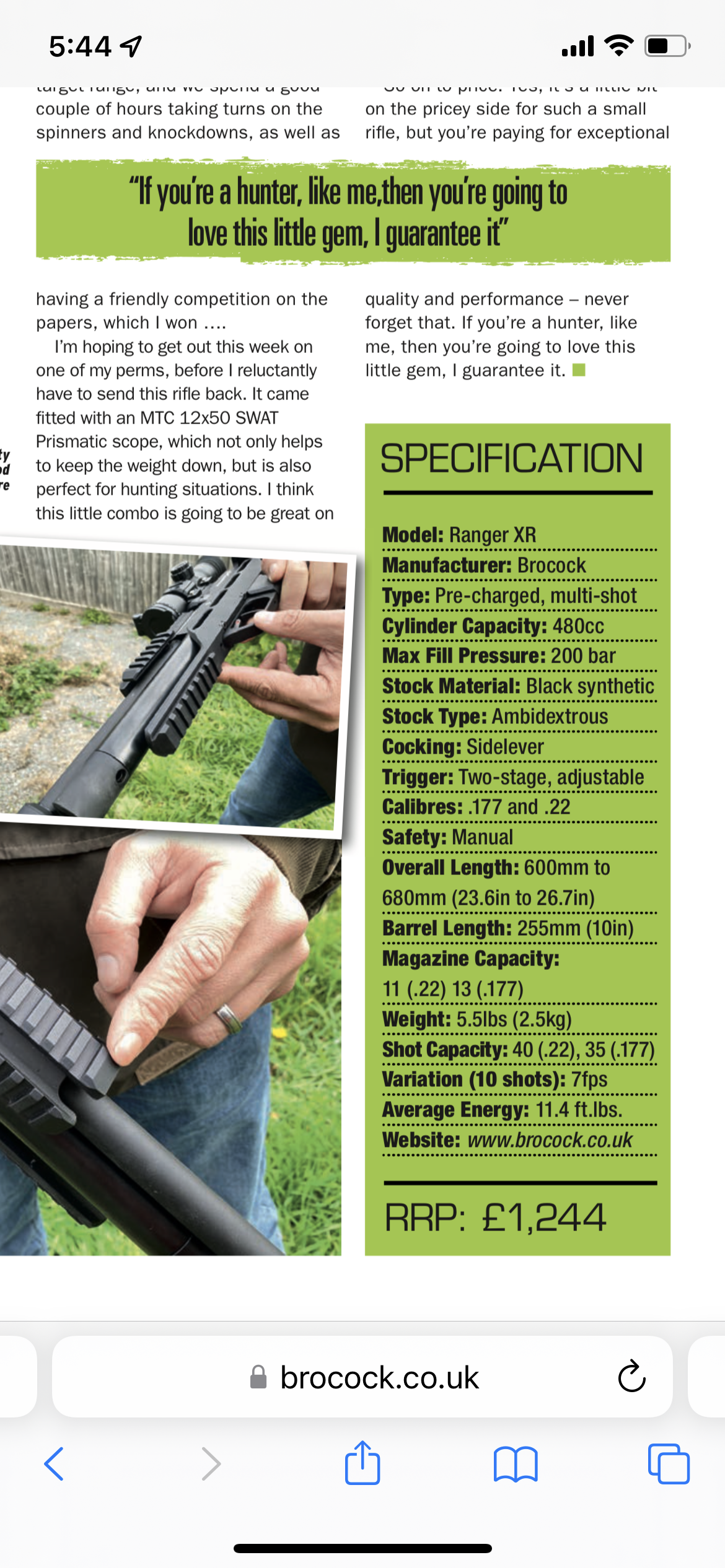

How sure are we that the Ranger/Atomic can be filled to 250bar? I watched Steve’s (AEAC) review and he was certainly filling to 250, but the handbook, which is not Ranger/Atomic specific and doesn’t actually mention either by name, seems to suggest that the carbon bottle guns fill to 250 and the tube guns to 200 bar. In addition on the Brocock website there is a link to a review that states a 200 bar fill.
Yes, I read that article, that 200 BAR limit for the the UK version. You can contact AOA and see what they tell you. I've been filling mine from 240-250 BAR as my SCBAs allow. Haven't had any issues. When I purchased my Compatto way back, there was the same sort of confusion. In the UK they filled to 200 BAR, in the USA, the suggested full fill is 240 BAR. I didn't simply pull these numbers out of a hat. Call AOA.
