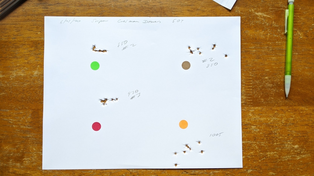

I have been chasing down my accuracy again after turning down the reg and playing at lower velocities. I have brought it back up to about 155-160 bar (hammer spring was about 2 turns in) and wanted to run some crosman pellets through it to see if leading the barrel might make any difference. Much to my surprise they shot OK at 50 yards at 850 fpe and 930 fps. Not surprisingly, they did not group at anything higher.
I was playing with hold-overs here so the points of impact for the different velocities won't make sense ;-)
The left two groups really surprised me. The bottom right was at power setting #4 (1005 fps). Top right was all over the place as the wind picked up.

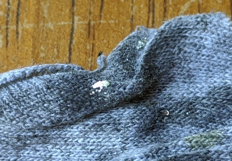

Well today i had more "meh" accuracy. Based on the vendor's (SPAW) suggestion, I gave the barrel ANOTHER good cleaning (just with my crown saver and ballistol patches). In doing so, I did pull out a bunch of lead from the barrel from shooting some H&N and Crosman pellets - I had been using these to see if leading the barrel more might help with accuracy.

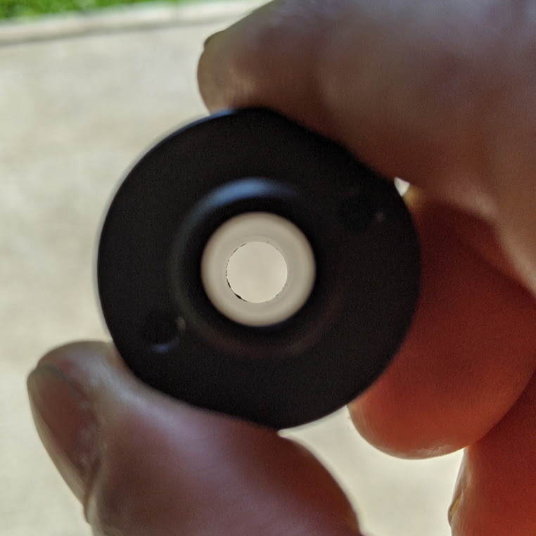

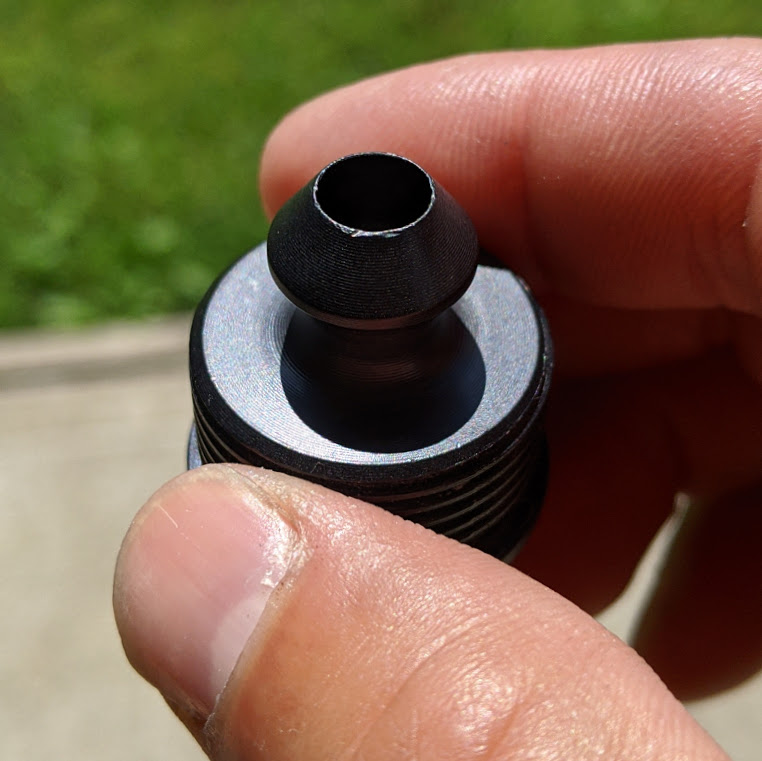

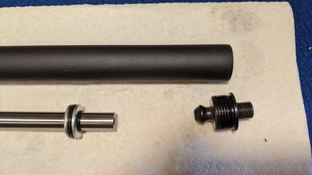

Anyhow, I also decided to pull the barrel's end cap and well looky here... There might be some touches from pellets going on.:
I measured the inner diameter of the end cap and it's about 7.25mm. That seems like it would be big enough for a 5.5mm (.22) caliber pellet... This works out to be 0.875mm on any side of the pellet as it passes through this area. And here's the rough spacing between the end of the barrel and end cap:

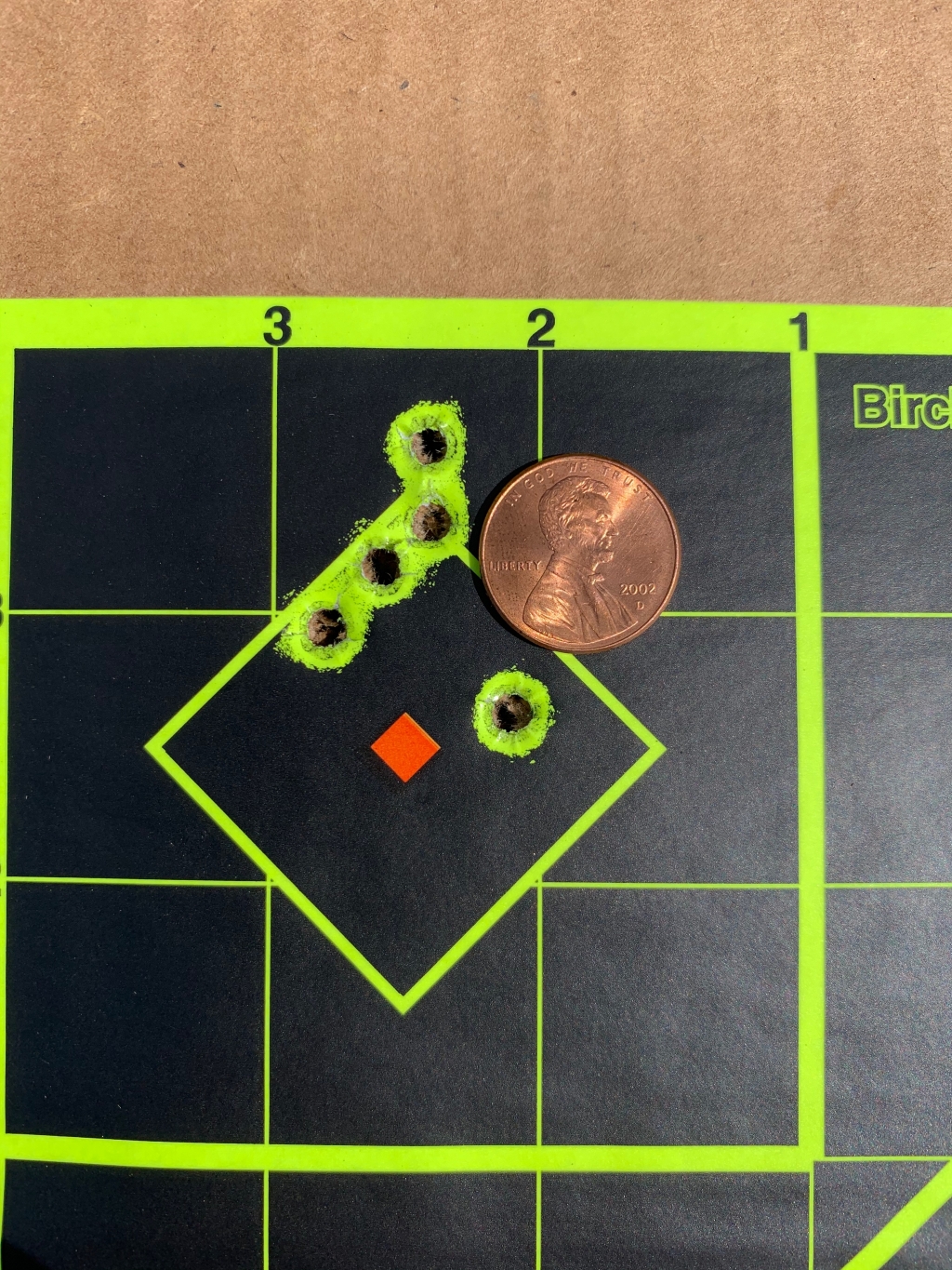

And here are a couple of groups. One with the shroud but NOT the end cap. The other group was shot with NEITHER the shroud NOR the end cap. JSB Monster (880-890 fps) redesigned at 62 yards. Some difference, huh?

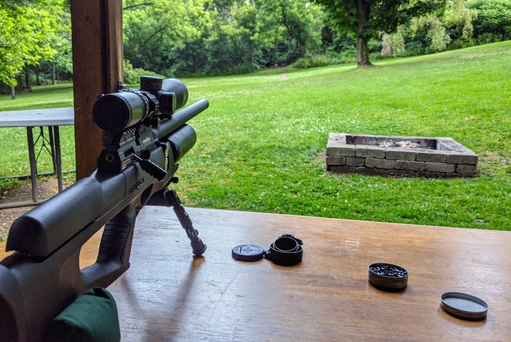

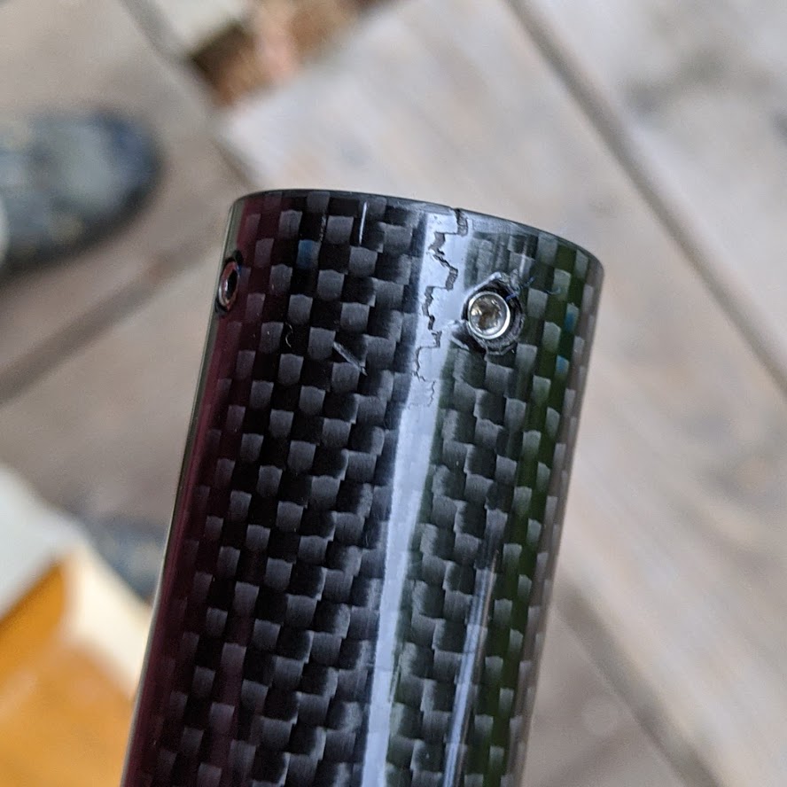

Hi @5DPatrick, which moderator did you end up selecting? I actually did have one that has been damaged due to the clipping. So i really need to think through and diagnose the root cause here so I don't damage another one. The issue is that the gun is decently quiet and while it would be nice for the gun to be a bit more quiet, it's not necessary for where I shoot. However, I do see value if using one helps with accuracy.
FYI - Here's what I noticed at the end of my moderator 😱. And the clipping I saw was bad enough that I had pellet entirely miss my bullet box. This definitely never happened with this moderator on my previous gun (Kral Big Max .22).

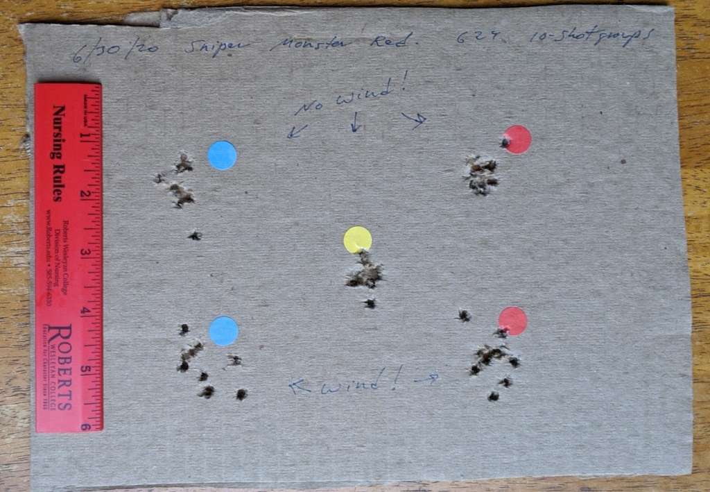

I had a short period of time this evening when the winds were perfectly still and shot some quick groups. These are 10-shot groups at 62 yards (JSB Monster Redesigned). The stickers I use for aim points are 1/2 inch.
It seems like the gun takes 4-5 shots to settle in (top left) but the next two (center, top right) were great. As noted on the target, the wind did pick up a bit for the bottom two groups. I'm actually glad the wind did pick up, it gave me some good perspective on how these larger .22 handle the wind when the gun was shooting well.

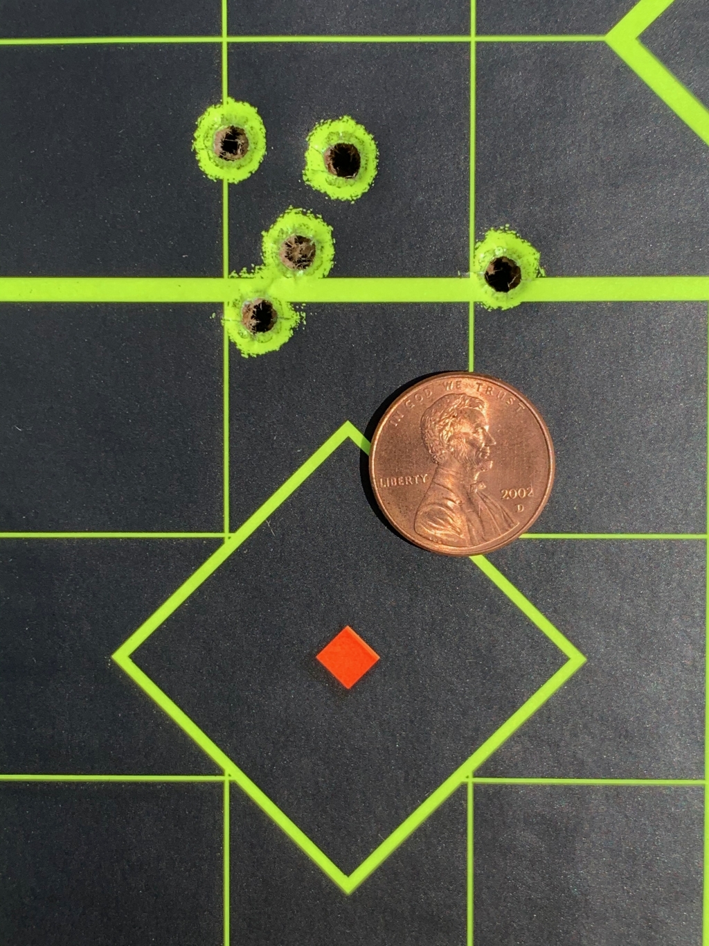

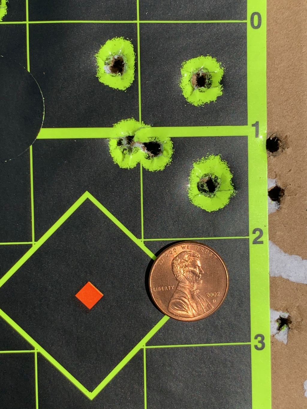

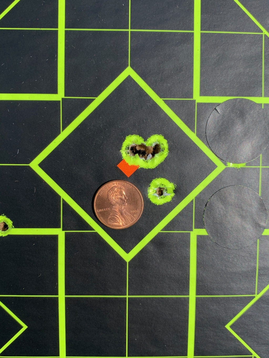

Ok, here are some targets shot today. All at 50 yards. I shot 2 types of ammo, FX Hybrids @940FPS, and JSB Heavy MarkII 34gn. All are 5 shot groups. I shot 5 FX and 5 JSB with the Shogun on, Then the same with the Shogun off. I did a follow up group of 5 with the JSB and the Shogun in the final pic just to show its effectiveness. from behind the gun in the open field, I did not notice any difference in sound.
FX Hybrids with Shogun
JSB With Shogun
FX Barrel nut, no Shogun
JSB with Barrel Nut, No Shogun
JSB with Shogun reinstalled
Hope this helps. Hope your results are similar.
All shots were aimed for the red dot. The POI change with the Moderator removed was high, as expected. Pic 4, the 5 shots on target were the ones shot in this test. The other holes, off the paper were from a previous outing. The JSB Mark II's were @875FPS. I am in Colorado @5,000+ ft elevation and it was over 100 degrees during this shoot. I think the thin dry air here works to my advantage.

I received confirmation from AoA that the gun is on its way home. They fixed the leak, did a full re-seal, and swapped out the barrel for me. It'll be interesting to see if this barrel behaves differently. The original barrel needed extremely frequent cleaning and when being cleaned would spit out some pretty significant chunks of lead.
Pulling out several of these in any cleaning (with just patches and ballistol) was not uncommon.

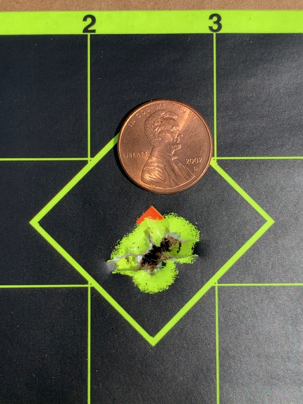

So in the few minutes I had to test, I threw my scope back on and set out target at 50 yards. My first group (left most below) hit a couple inches to the left but dead on in elevation. In these first four groups of 5-shots I'm already seeing accuracy better than my original barrel (and these shots were rushed and in moderately windy conditions).
I'm probably going to make my small adjustment to the trigger and shoot the heck out of it just the way it is. In my pellet / adjustment testing with the original barrel, I pretty much came to the conclusion that this gun is likely a one-trick pony when it comes to how it likes to shoot (45 fpe with JSB Monster Redesigns).

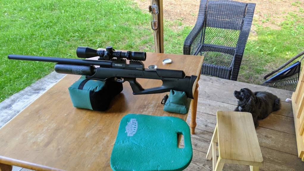

I shot my Cricket .25 quite a bit while the Brocock was being repaired. Within a few shots after going back to the Cricket, it became immediately evident that it was much more stable as it was being shot. (The Cricket is about 54 fpe and the Brocock is about 45 fpe.) It was simply harder to keep a good follow-through on the target after pulling the trigger on the Brocock. And this is was the case regardless of the reg or hammer spring setting i tried. My initial thought was that sure, the Cricket is a heavy feeling gun. (The synthetic stock makes it quite the tank!) But now that I have both guns back, I weighed them and they're actually the same. According to my highly accurate bathroom scale anyway!
So getting back to the shots I took on the above target, the left two groups were shot from the bag in the pic and the right two groups were shot with rather beat up and wobbly UTG 360 bipod. I can honestly say that the gun now as a different feel with each method of support. My view of the target while shooting the Brocock is now much more stable. How or why this is, I simply cannot explain. Now I really wish I had the ability to capture some scope cam footage to demonstrate.
