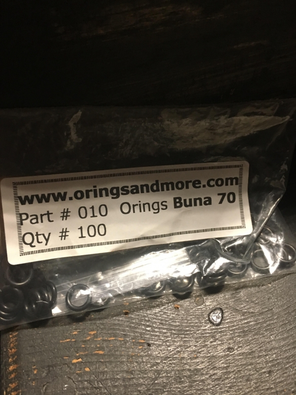

Was filling the Sniper this morning and apparently didn't have the foster fitting on all the way. Loud pop and the fill probe and hose left the rifle. That's happened before but this time after doing this it seemed to have hatched out a tiny oring on the floor right below the fill port. I have no idea if that oring fits in the Brocock special fill probe or if it was attached the the fill probe on the rifle. I haven't found a good exploded diagram yet.

This is the oring I found that fits the female foster fitting
