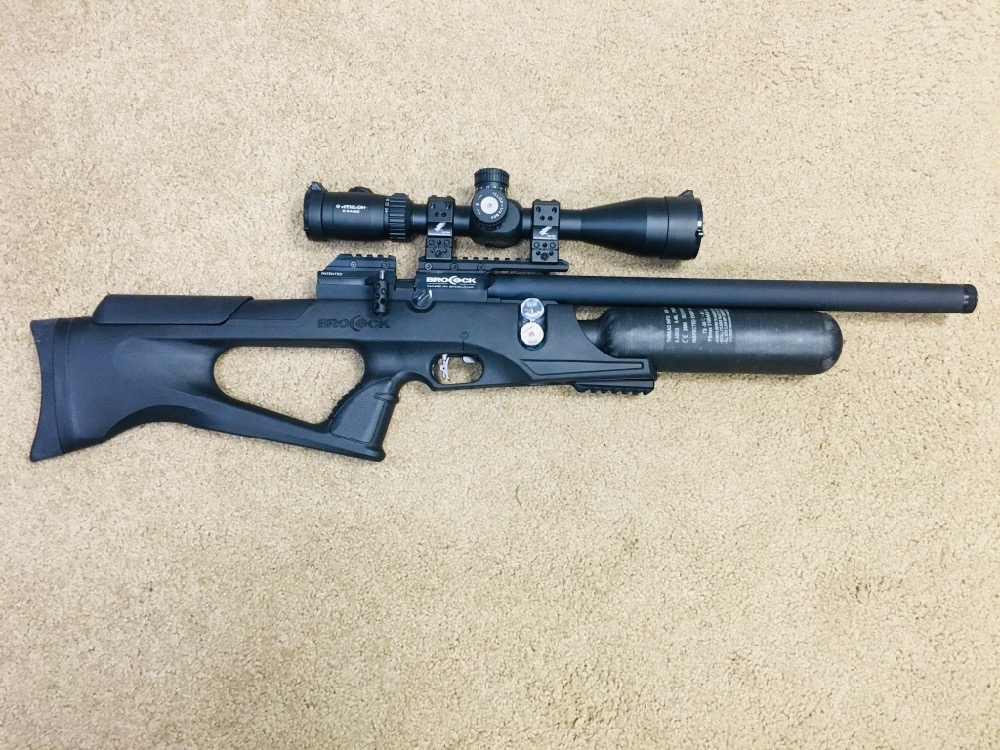

I have been using a Sniper XR .177 for HFT for about a year now and have come to really like the gun, it is very accurate, has a great shot count, and feels very comfortable to me. Another guy in our club had one and I was able to try it a few times and really thought it was nice. I had narrowed my choice down to the Brocock XR or Daystate Hunstman, and a used Brocock XR came available and I went with it.
I currently shoot AA 10.34s at 880 fps for around 18 fpe. After those run out I have their cousins the FX 10.34s sitting in the wings! Both these jsb manufactured pellets shoot fine from my gun. I did add a Donny Tanto moderator to it, as it does have a little bark without it but it is super quiet with it. The trigger would be the weakest point on the gun, but not terrible by any means. Previously I shot HFT with a Marauder with the trigger lawyer spring removed and I will say I liked the Marauder trigger better. Franklink above just posted a how-to video a few weeks ago here on AGN on improving the Brocock trigger, I am considering that but I am feeling pretty comfortable with it now, so not sure I want to change things!
I only have about 2 years experience in shooting FT now, and often have days I just suck in my shooting lol, but I seem to be improving lately and I often stay competitive in scores in our club’s weekly FT meet with the higher dollar rigs like the Redwolfs and Thomases. Of course there is a lot more to doing well in FT than the gun such as experience, ranging, dope, reading the wind, how much coffee you drink before the meet…
