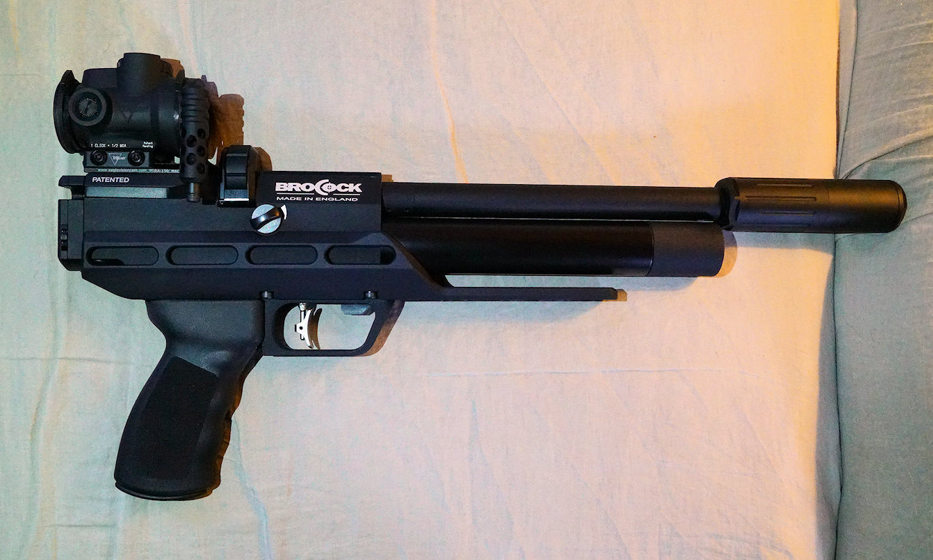

Anyway, my thought is to do the..."opposite"...as many do with pistols. Rather than add a full length stock to a pistol, I'm thinking of cutting the barrel to the same end length as the 300cc cylinder.
Not attempting to try to make it into a "bullpup". just making a...short rifle. And yes, I understand that overall power will drop with the short barrel.
Thanks for your thoughts (on the gun...or...my hairbrained thought !).
Mike

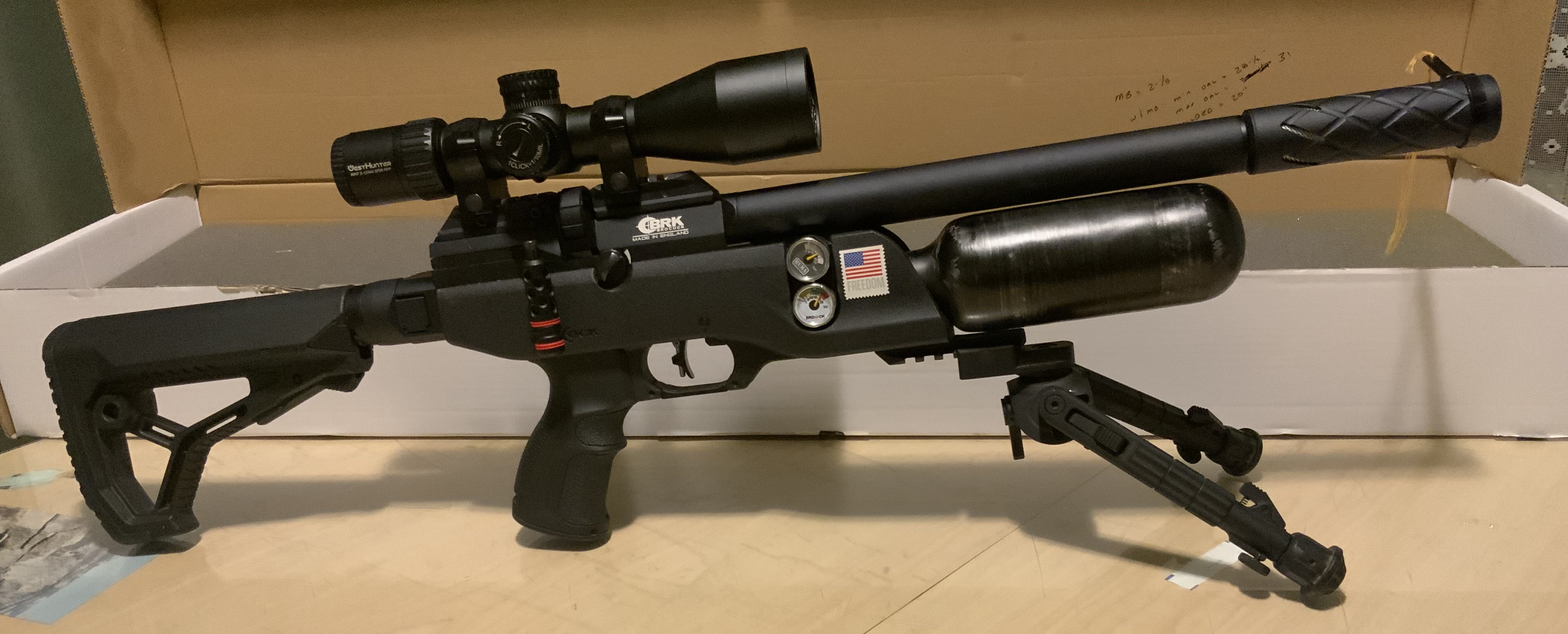

I owned a Bantam Sniper HR, the predecessor to the Sniper XR. It was and is still an awesome platform. What you are describing is already achieved in the Pathfinder XR. Only difference is the folding stock. As you can see, without the moderator the bottle and shroud are almost equal at the front of the gun.
Edited to add if you do a search you’ll find my posts praising the Sniper…🙏

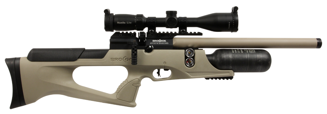

Bought one 2 years ago? It's so accurate it's crazy. If I used a FFP scope it would be even easier to shoot(I guess I like a challenge, lol).
I was surprised by how heavy it is. That stock is a tank and very wide feeling(I know it has a bottle but it's still kind of a cow). And the way the grip expands at the bottom is uncomfortable to me.
Knowing what I know now, I would get the Pathfinder, especially if it's lighter. AFAIK, they are the same gun but different wrapper and barrel length. And the folding stock of the Pathfinder would make it way easier to transport.

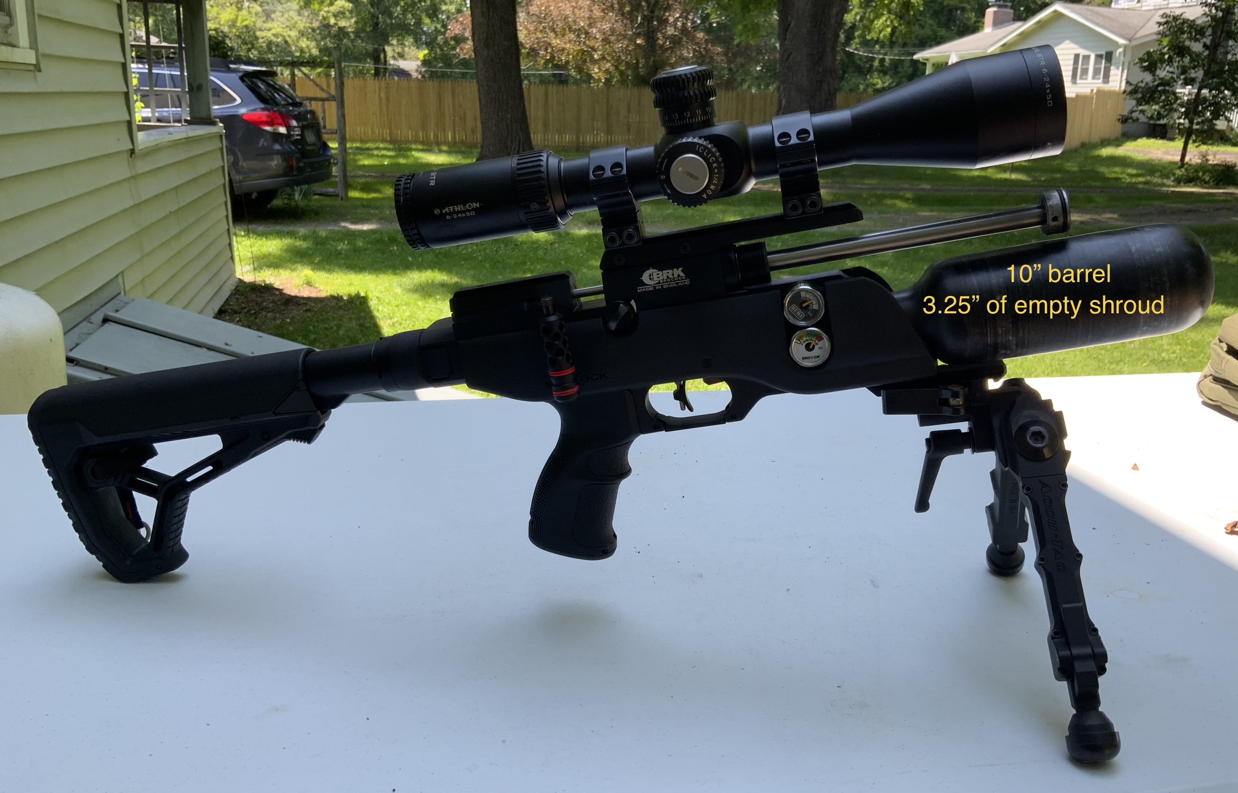

@MikeVV , this is the actual barrel length on the Pathfinder. A shorter shroud would achieve what you want… Then there’s the matter of the stock…
Perfect,
Thanks much for the dimensions on the Pathfinder barrel, much appreciated.
Not exactly sure how to work the barrel, shroud, and some sort of add-on muffler, but this gives me a good reference.
