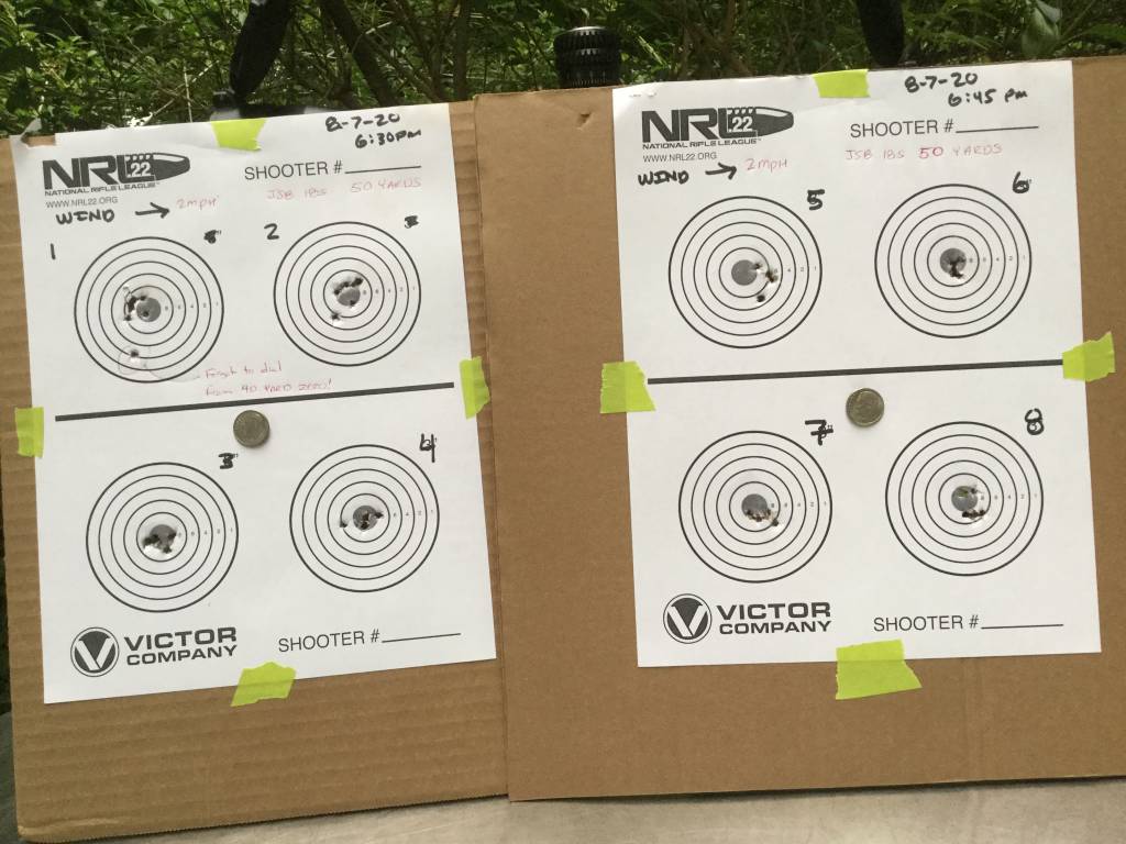

What did you do to lighten your trigger and do you think the results contributed to better or more consistent accuracy?
I just turned the rear most screw clockwise until the gun would cock anymore. Then back until I could safely cock the bolt. Nothing on the scale of what you did. I have been getting as good accuracy before, but do feel the trigger pull is much lighter and will definitely make a difference going forward. At the end of the evening I decided to send some AAs 16s at 50 yards. First two groups I still had my forty yard zero, group 1 is easily 1/4”. I fell apart on group 2, poor technique. I dialed 1 MOA of elevation for groups 3 and 4. All groups but #2 covered by a dime. As you already know the gun shoots good.
