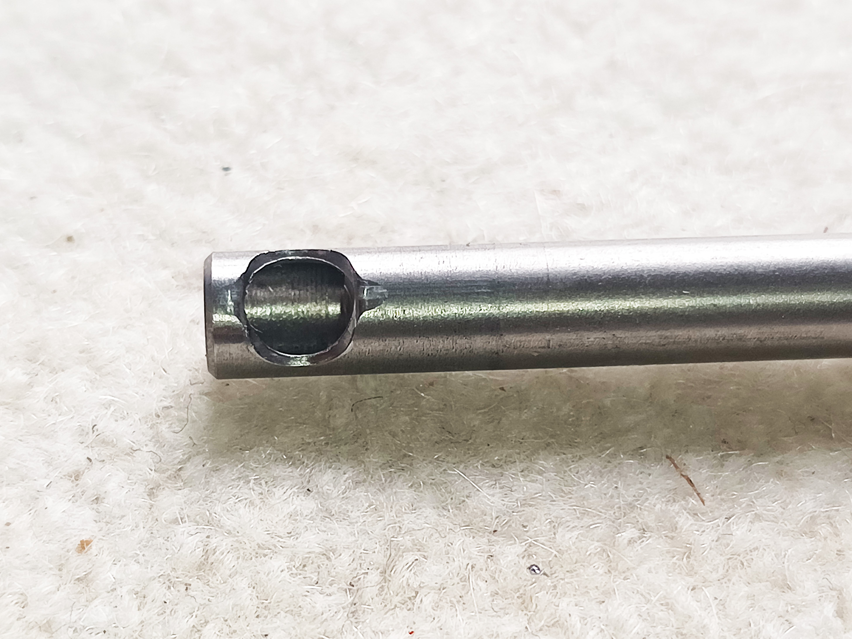

B.t.w. - does not neccessarily have to be related to the same problem, but upon removing the original probe, I was quite surprised to see the worn down surfaces, front & back of the transfer port; look at the attached picture - does not look normal, does it??

In a maverick the only thing that can cause that damage on the probe is it being out of alignment on install and rubbing on the housing as it’s pulled and pushed forward with the lever or it’s bent and skipping off the bottom of the transfer port as it pushes the pellet/slug forward. The design is extremely simple so there is not other mechanical reason that I can think of.

Did you verify the probe is aligned properly with the port. I don‘t know if the 30 probe is the same length as the 22 probe is. That may be worth checking out too.
Also if you removed the cocking rod and the threaded fitting at the end that the probe attaches to gets accidentally threaded one direction or the other it will throw off the port alignment. Don’t ask me how I know. Just another lesson learned.

The wear on your probe could be caused by your cheek rest. I know you probably think I'm crazy, but hear me out. FX made a crap load of BAD cheek rests for the maverick. They probably still do. What I mean by a bad cheek rest is one that keeps the magazine from being fully seated into position. The magazine of an FX Maverick should NEVER be touching the cheek rest -- ever, not even the slighest bit. A cheek rest that is touching the magazine has the magazine out of alignment between the probe and the breech. So the magazine would be forcing the probe to be out of line with the breech. This causes wear on the probe, wear on the magazine, slugs/pellets to start into the breech from an off angle, causes slugs to jam or snag on there way into the breech, wears the breech, wears the breech o-ring, and the list of ruined parts goes on. This does not explain why your gun would have gone off without having to pull the trigger, but might explain the wear on the probe and other bad things.
I'd suggest this to anyone with an FX Maverick: take the cheek rest off the gun, cock the gun, put the safety on and repeatedly and slowly put the magazine in and take it out -- paying very close attention to the way the magazine feels when it finds it's home position. Watch, feel, observe, and learn where that magazine is happily at home. If the cheek rest is getting in the way of that, you then need to look at which cheek rest you have. You might have a hollow cheek rest that has ribs in it -- not a solid piece. If that's the case, then insist that FX service center send you a solid piece cheek rest at their expense -- it's their screw up. IF you have a solid-piece cheek rest, you won't get a better one from FX, but you will still have to sand away any part of it that is touching the magazine.
