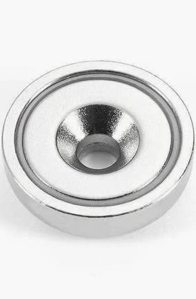

or find a neodymium magnet with a hole and just secure it with a counter sunk bolt.
