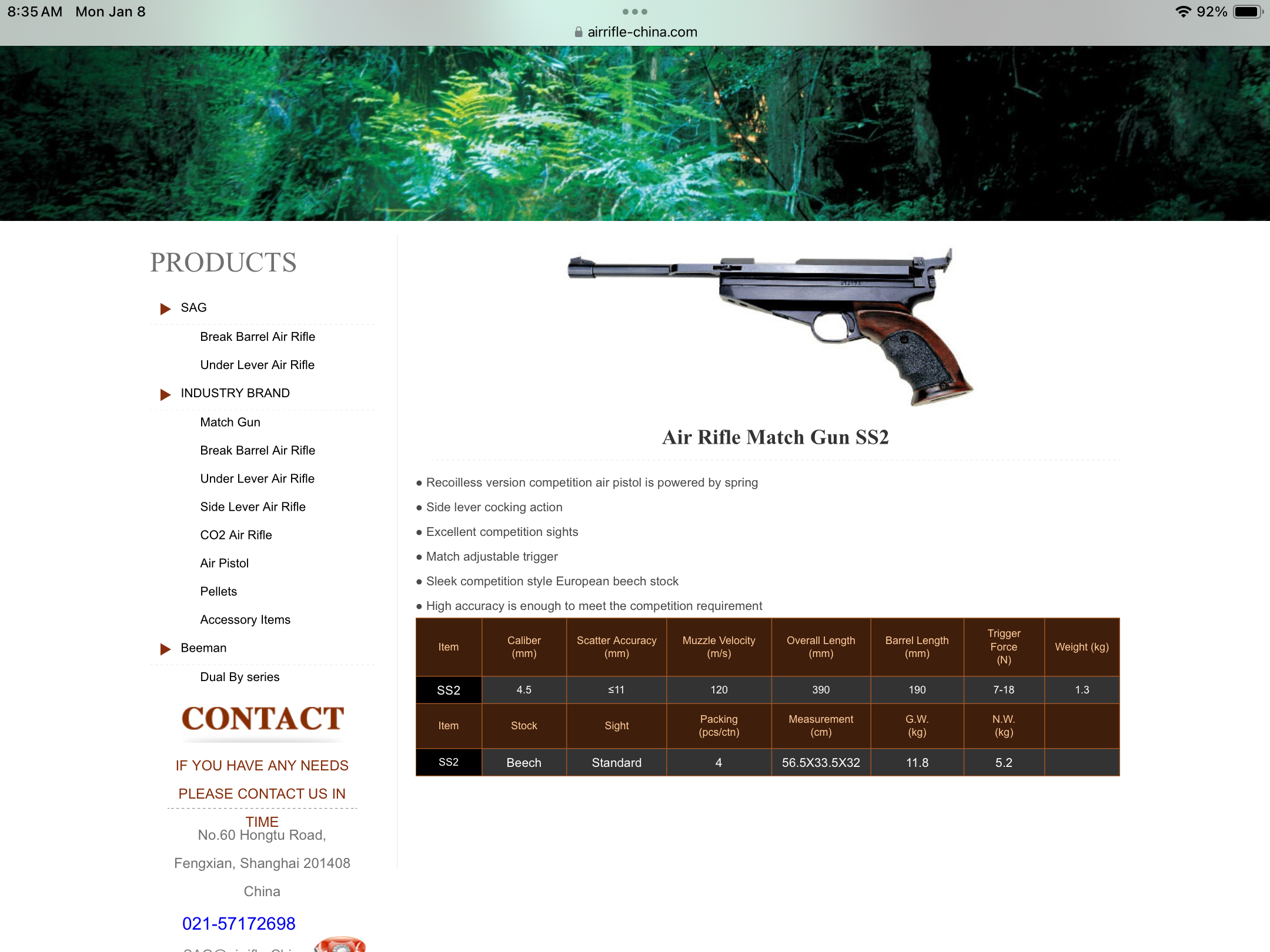

Believe it or not it’s still on the industry brand website. Though no one has seen a new one in years. I have messaged them a couple of times about purchasing one. They of course do not answer. I have to wonder if a dealer was to order a few cases they would build another run. I just now messaged Mike Melick at Fying Dragon he will know what goes on with them.
