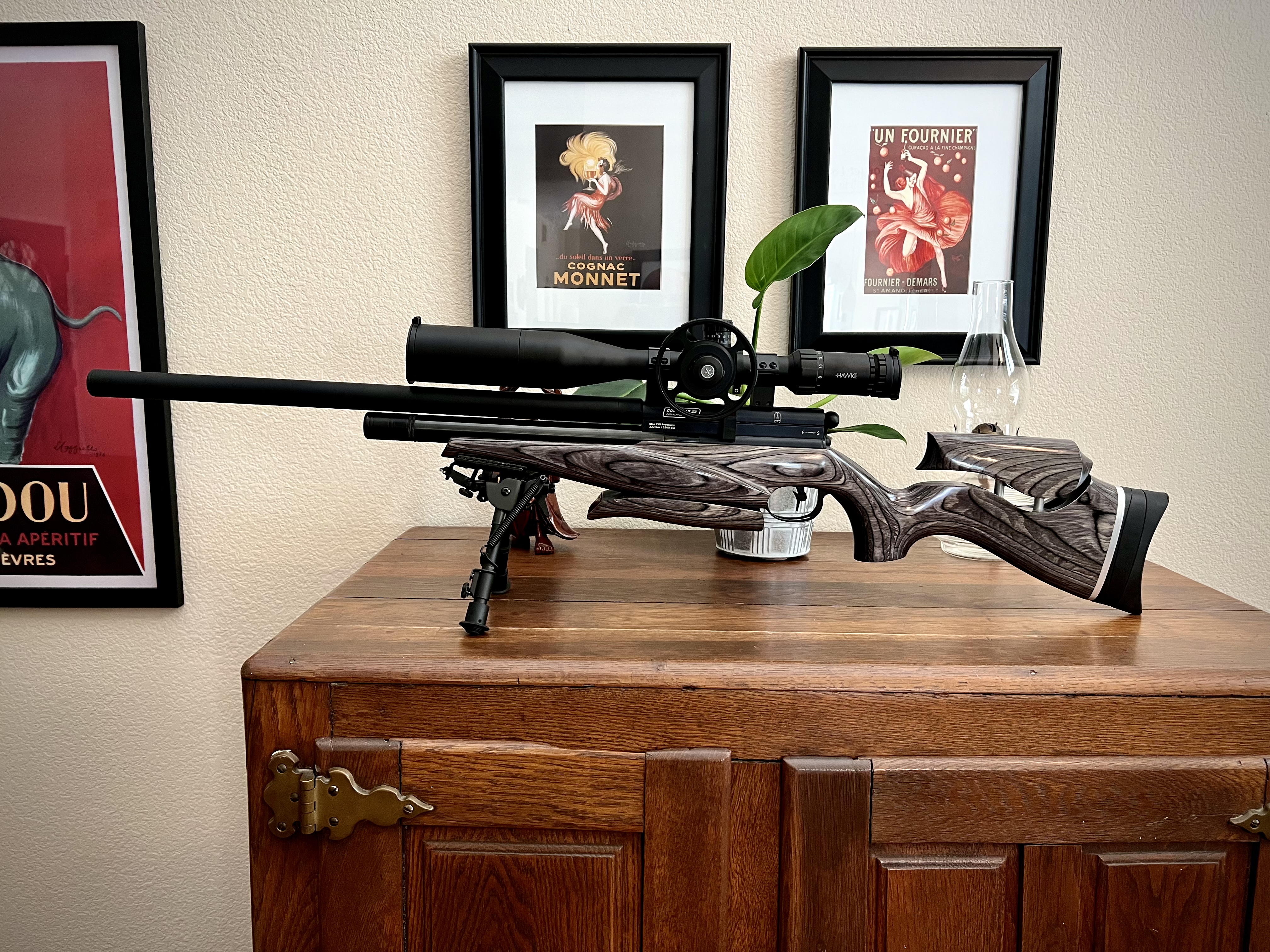

I was after a used Steyr 110 or an Air Arms HFT 500, no luck. I’m impatient so… Then I almost had a BSA gold star Union Jack edition - but it was lost in the mail 😩 any of these platforms would be a nice way to get started in HFT. Two days ago I caught wind of a website called Ransony. They had one BSA gold star edition FT model in black pepper laminate available at <$300 less than anywhere else; $980. They are also a seller on Amazon. I Took a chance and less than 48 hours later I have a beautiful new BSA HFT platform to begin my HFT journey with. It arrived without damage and It charged right up and held air. I cycled a magazine through it without even putting a scope on it. All good. Now I have to wait on some dovetail to picitinny adapters so I can scope it properly with my FT specific scope. Does anyone know if I need to add some elevation to the scope mounts for FT?
Although only.177 and <20 FPE, It does bark. I tried to put a 0DB moderator on it’s pre threaded barrel but the moderator is a millimeter or two, too fat and unless I remove the charging port cover the moderator causes the barrel to deflect upwards ever so slightly - I’m wondering if the barrel is slightly tweaked downward or ??? It comes with an air stripper but it’s not a quiet thing. Any sage advice welcome!

This looks like it'll fit a couple of the BSA guns that I think have the same receiver. Hopefully somebody else can chime in and verify it'll work.
That air stripper actually makes it louder than bare barrel. But, yes, it's got some bark without a moderator.
Is the 0db that you're putting on it a large diameter? The moderator I put on it was 30mm and didn't have any interference with the fill cap.
It may in fact be a larger diameter moderator? It is a 0DB for a .30 cal 😣
I might have to break out my calipers. Definitely not a rifle to use a Donny Fl on.
