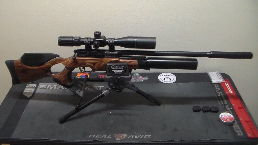

Here she is! Just picked it up today and spent some time with it after the kids went to bed. I have yet to shoot a pellet, mostly just was getting familiar with it, scoped and stock adjusted to my liking. So, this will mostly be a photo dump, with a few initial thoughts.
Disclaimer: this gun is on loan from Airguns of Arizona. I would like the thank them, publicly, for allowing me the chance to review and spend some time with this gun.

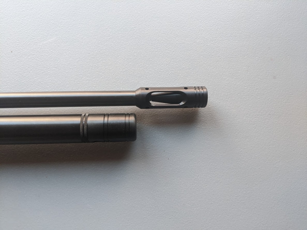

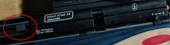

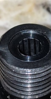

The air stripper has me intrigued. It has some set screws that allow the cone to be moved in and out to optimize accuracy. That could lead to some interesting testing, if it is quiet enough for my yard without a moderator. The whole thing unscrews to reveal standard 1/2-20 threads otherwise.

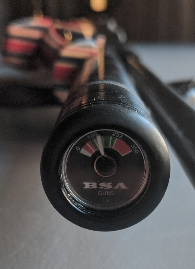

 I like that the gauge is gun-specific. The manual said the gun is to be filled to 232 bar, and the gauge matches, anything over 232 is RED. Convenient. (a little styrofoam dust on the top of the tube here)

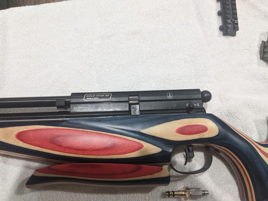

The breech seems pretty solid. The section of dovetail that bridges the gap for the magazine has got to help with stability. There is also 3.125 inches of barrel in that thick, beefy breech, and the barrel diameter is decent. All of those details should help with consistency in POI from day to day. There is a small cut-out on the top of the breech in the front half where I can see the barrel nestled securely inside. While I prefer a picatinny rail, it's not too hard to simply attach a conversion rail.

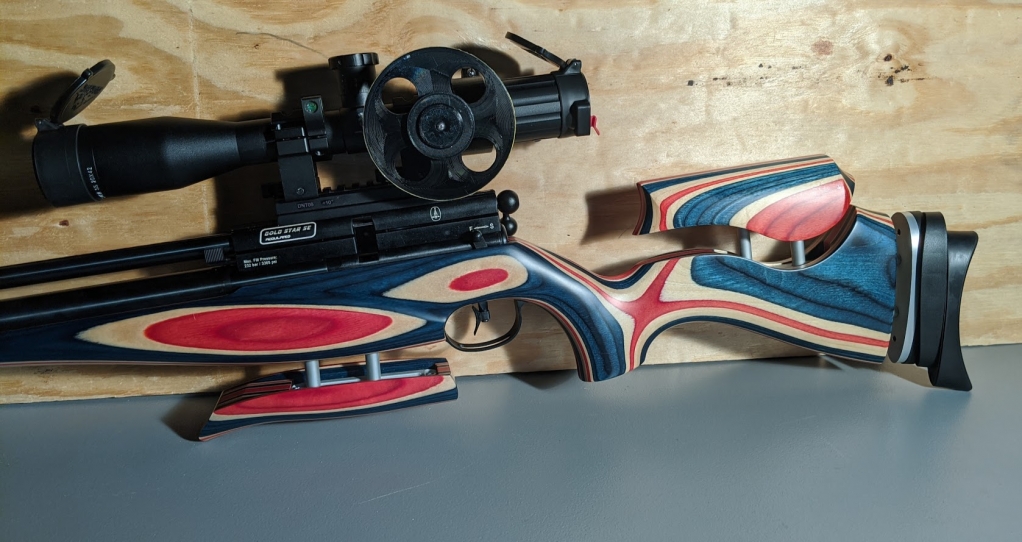

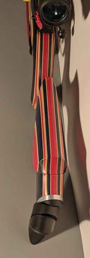

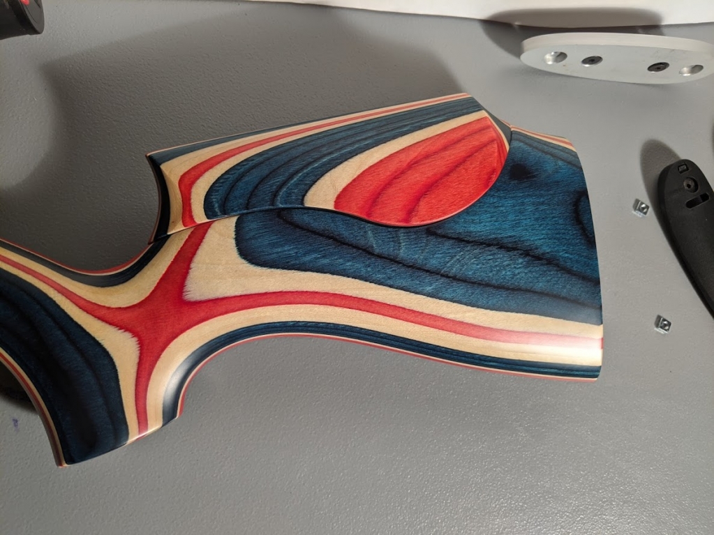

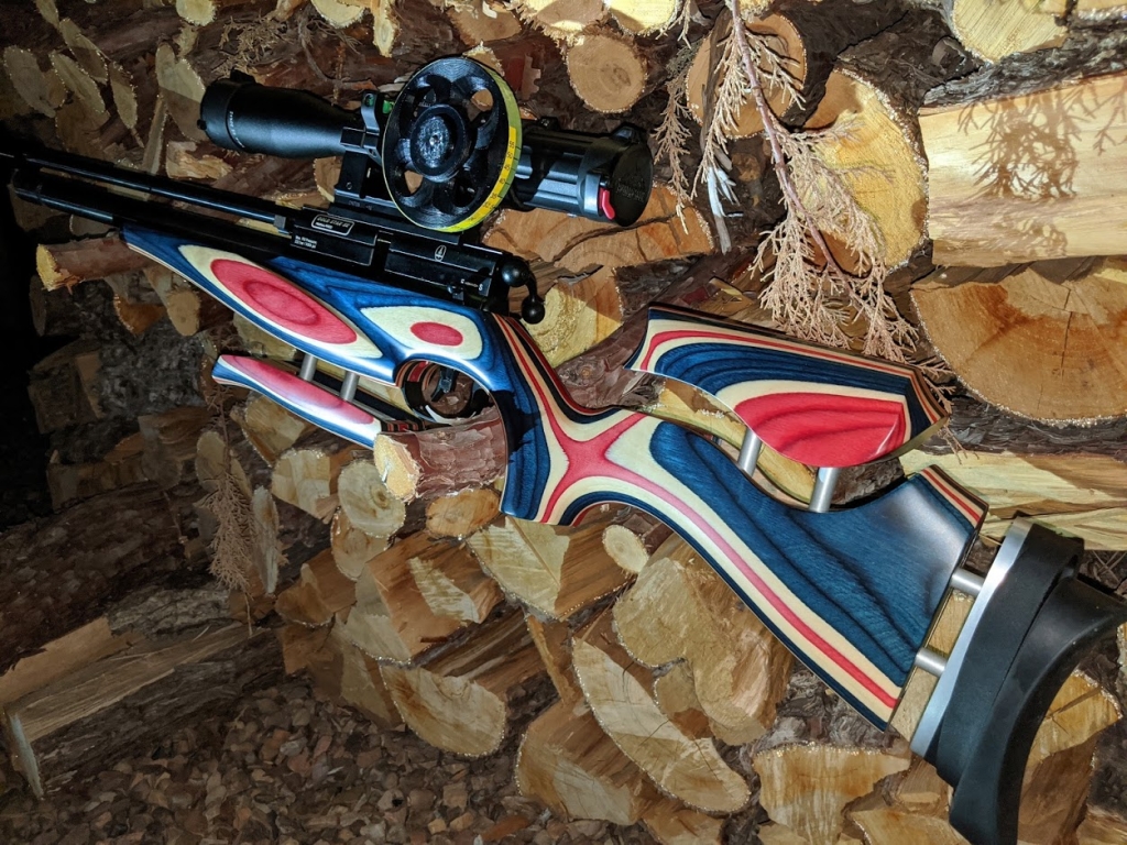

The stock is just a thing of beauty. I'm a sucker for laminate stocks. The colors on this one are quite vibrant. Yes, scope height is pretty high. I've been noticing a kinked neck the day after a lot of shooting, and also read somewhere recently that really high scope height can help with the amount of holdover needed for really close shots. Either way, fun to experiment.
Check out the depth in the dark blue in this pic.
I read somewhere once that a good initial indicator of the quality of a gun is how the metal and wood come together. Gaps, and either the wood or metal being "proud" indicate low quality, supposedly. I'm not seeing either of that here. Take a look at the inletting for the stock adjustments, dang precise.

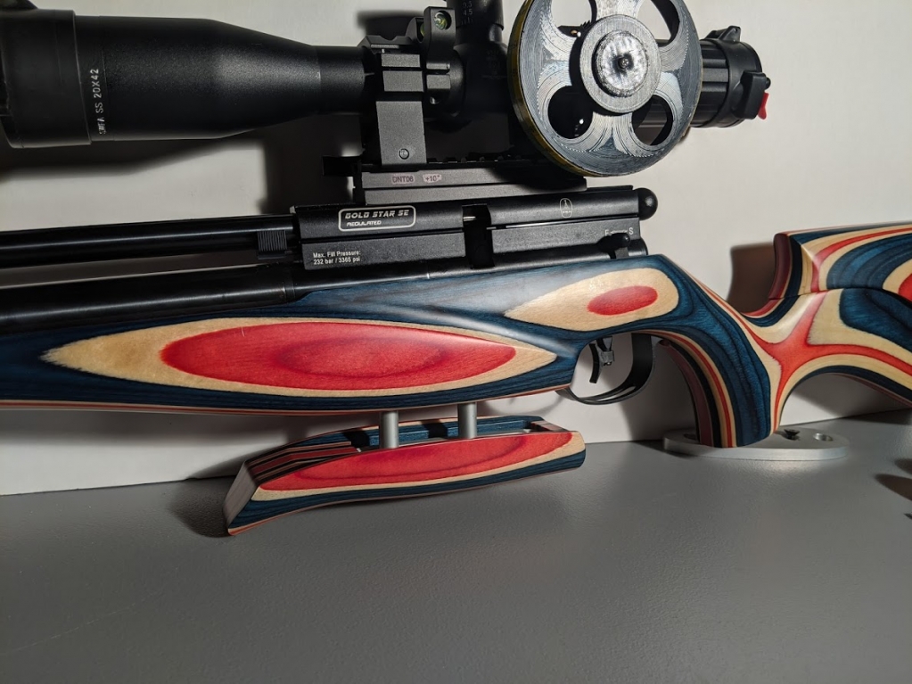

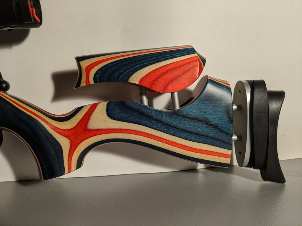

Hamster/knee riser can be removed for full-on sporter configuration.
Gotta love a Minelli stock.

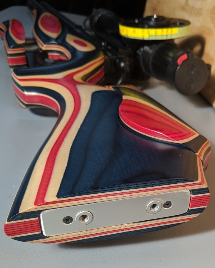

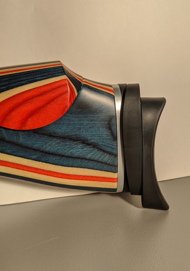

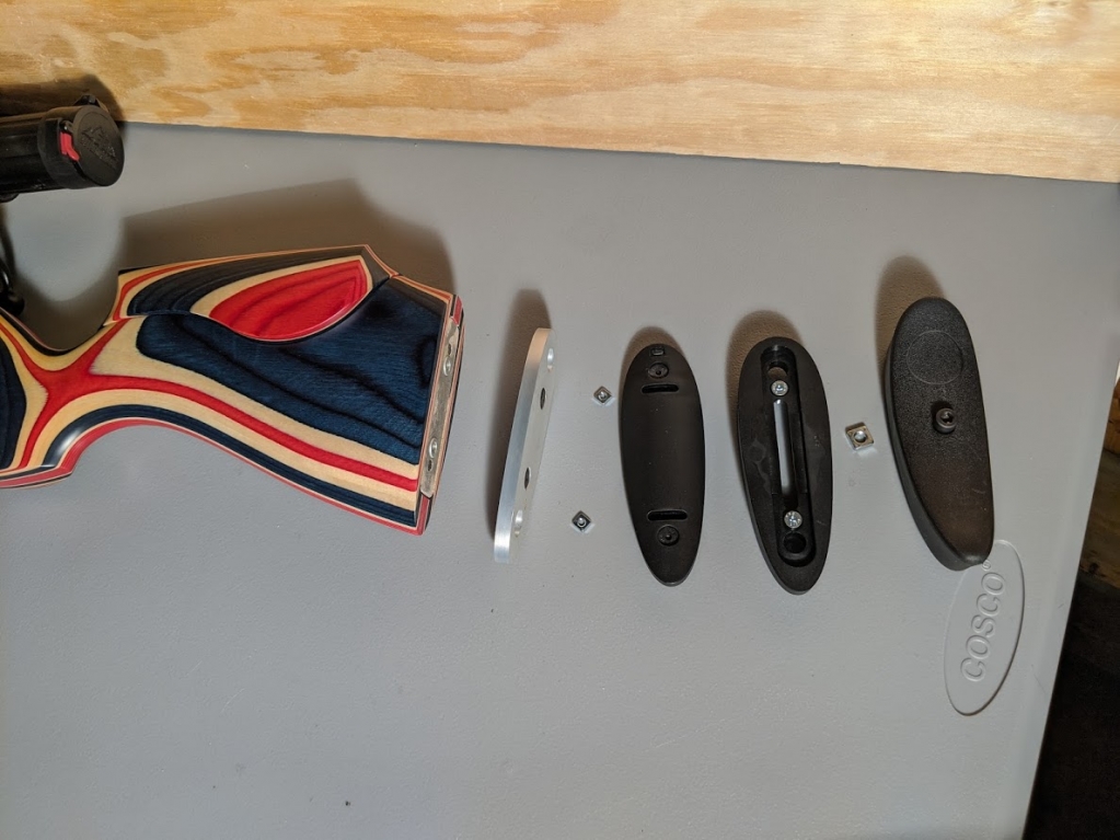

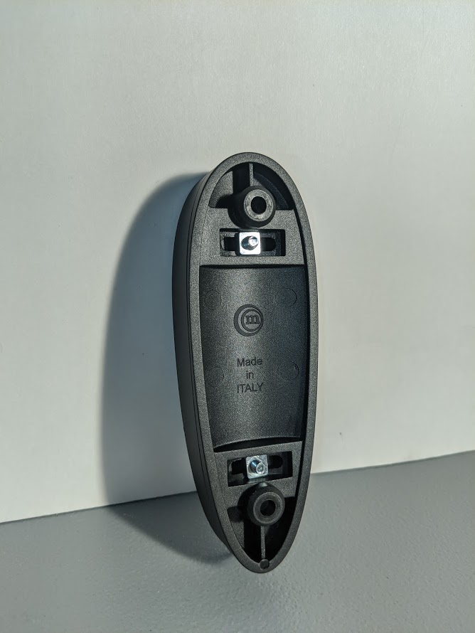

I'm pretty impressed with the buttplate, and the adjustment that can be made. Length of pull, cant, height, are all available to adjust.
This configuration feels pretty nice and will be my starting point.
Oh yeah, pretty gun!

  • I'm very happy with how adjustable the stock is. From shooting quite a few guns, I know how a gun needs to feel to be able to shoot well off-hand and off a bumbag. At this point, the gun feels pretty dang good from both of those positions.

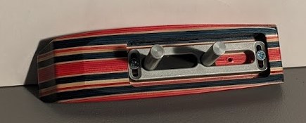

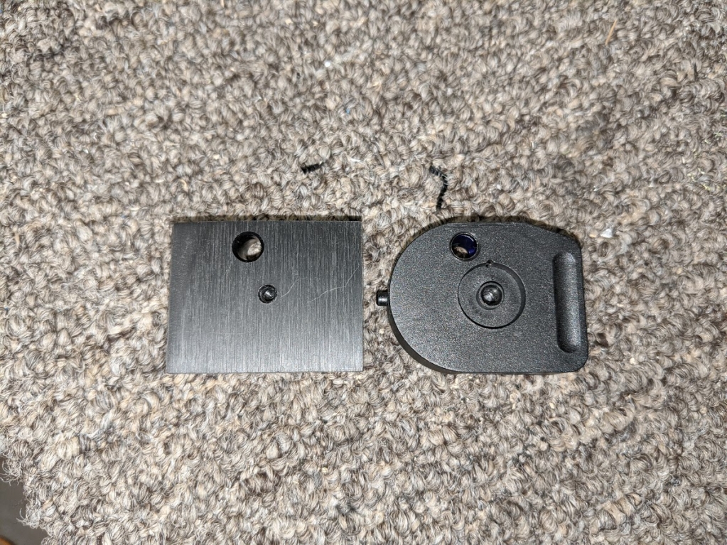

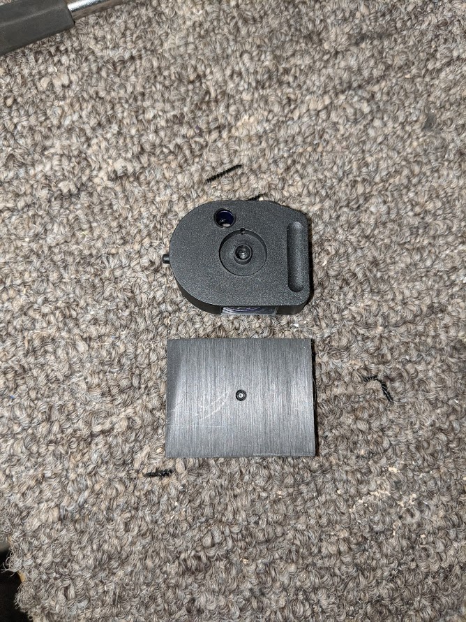

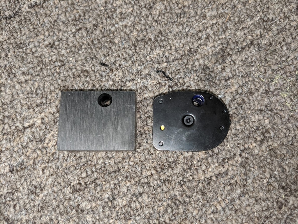

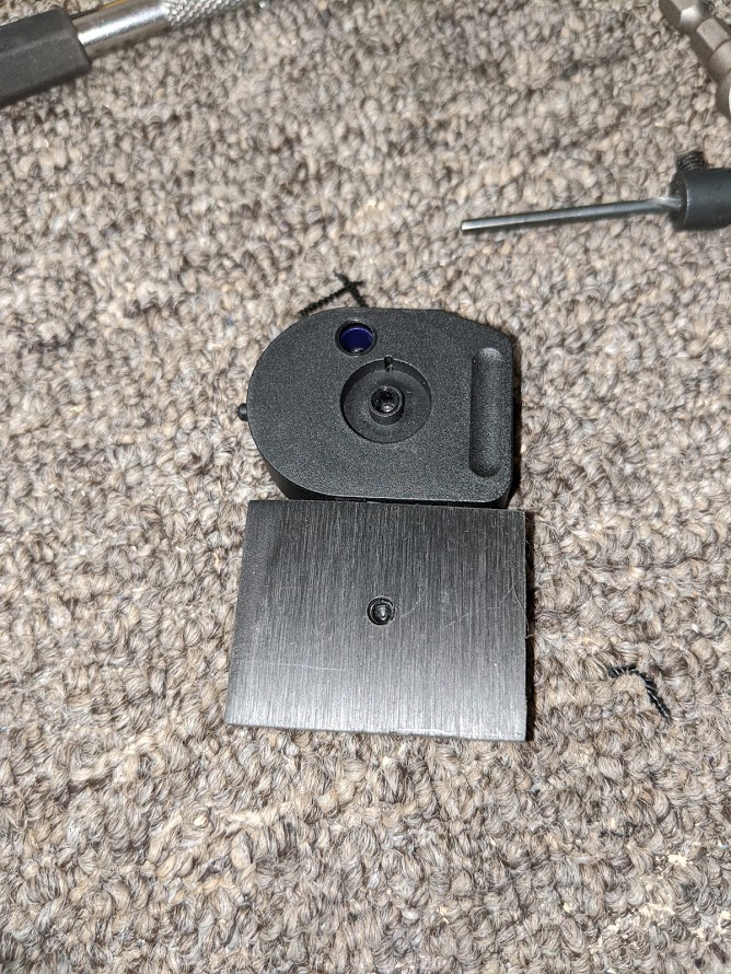

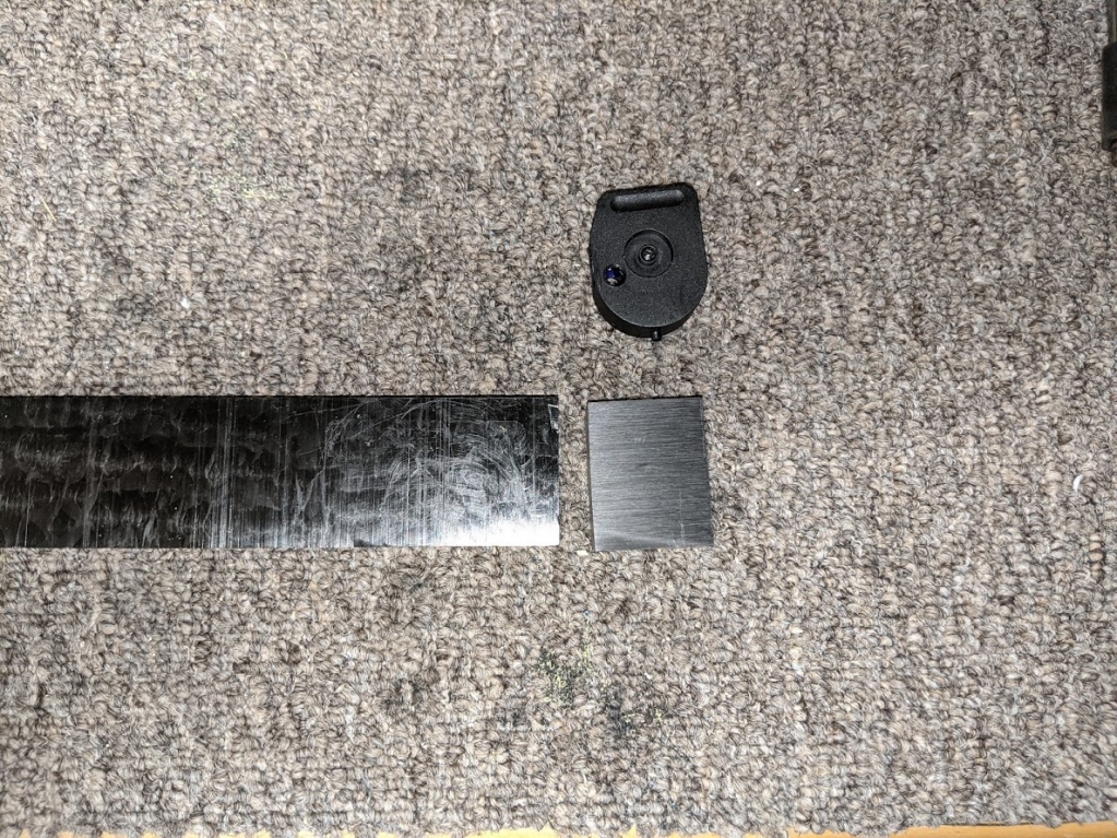

I made a single shot "tray" for the gun this evening. I recently purchased a bar of acetal to make a single shot tray for a different gun, and that bar happened to be just right for what I needed for the Gold Star.
Rough shape cut off bar.....
Locating pin.....
Beveled the edges of the hole for the pin to seat easier.....
Front......
Back......
The edges of the hole where the pellet goes were also beveled. I may eventually round the edges off and/or streamline the sharp 90 angles, at least the ones not inside the magazine slot in the breech.
I wanted the option of single load. Accuracy and consistency will be tested with both the factory mag, and the single shot contraption I made.

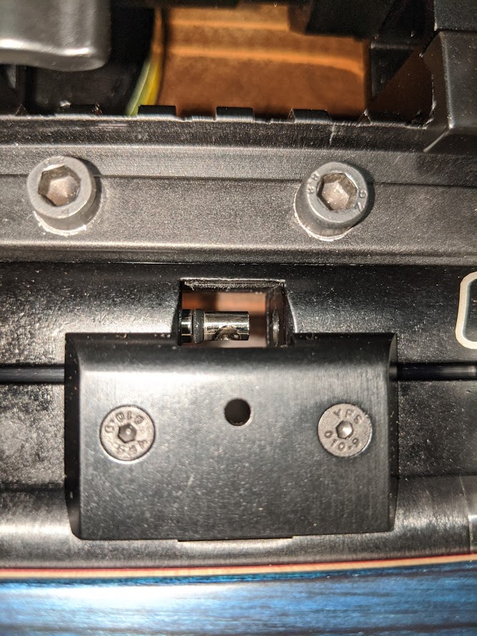

While I was up close and personal with the slot for the mag, I noticed the pellet probe is a flow-through design. Interesting. You can just make out the hole on the bottom of the probe in this picture.

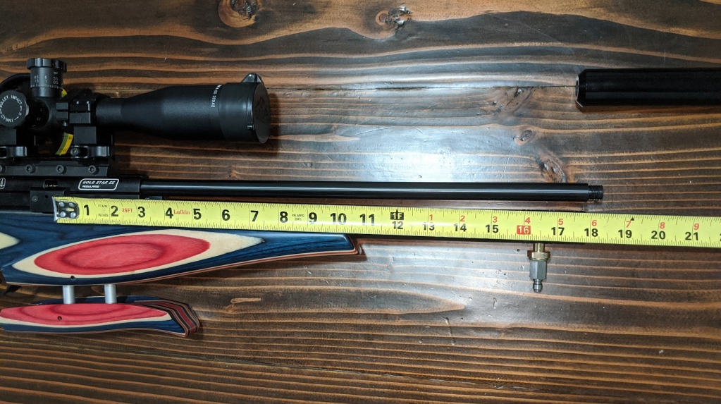

One of the UK guys with experience with this gun was wondering about the barrel length. Apparently they come in both 12 and 18.5 inches. This one is 18.5inches long.
The overall length of the gun, without the air stripper or a moderator is 37 inches. Really a cute little gun.
A close up of the crown....
The barrel diameter is 0.615 inches, or about 15.6mm.
The needle on the gauge is exactly where I left it 24hrs ago, so it looks like either no leak, or such a small one that it's not noticeable in a 24hr period. With these PCPs, I always cross my fingers that they won't leak from the get-go. Nice to see that's the apparent situation with this one.

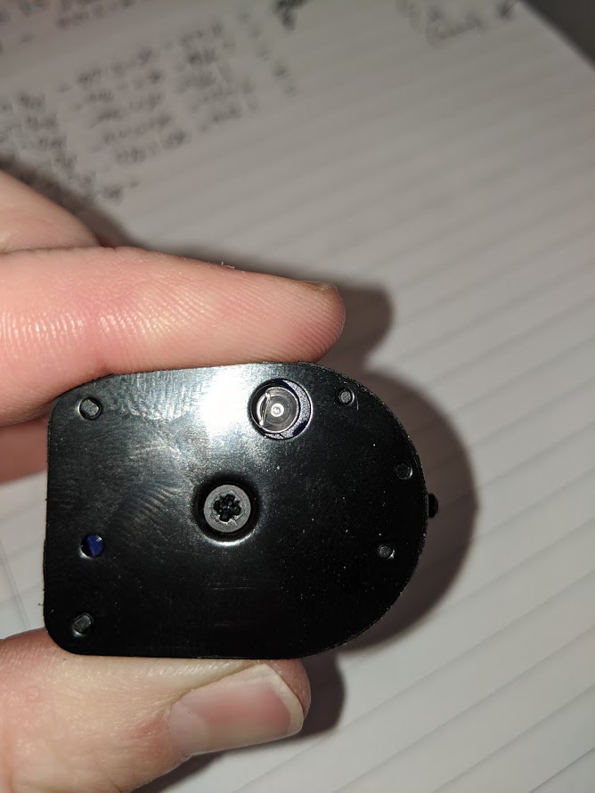

Like most magazines, it is primarily made from some sort of polymer (plastic), but has a metal plate on the flat side that the probe would first see during it's travel for each cycling of the gun. I like that. I'm not a huge magazine fan so haven't run enough pellets to see any mag wear on any of my personal guns, but the idea of a METAL probe going through a plastic magazine, repeatedly, many thousands of times through the life of a gun, makes me think wear. This metal face plate should help in that regard.

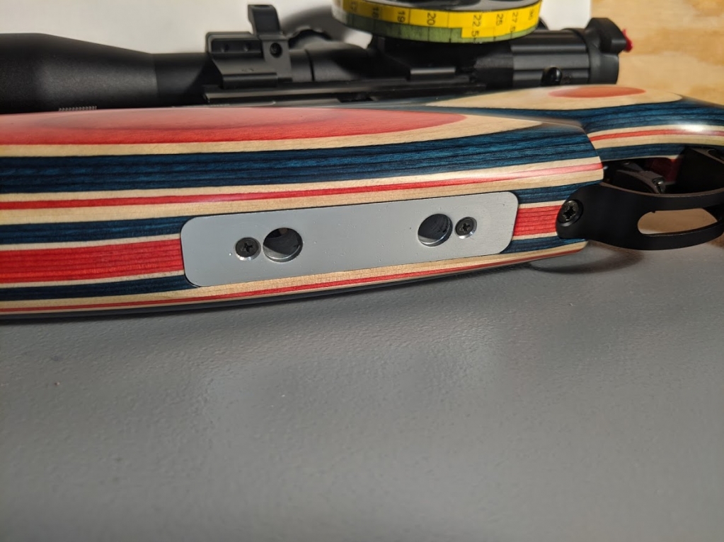

The mag engineering has two locating pins. A fixed pin on the right side in the above pic, that mates with this hole in the gun (on the right side of gun when held in shooting position).....
The other pin is actually a slider that extends from the gun into the mag slot to a hole milled into the front of the mag. The control for that sliding pin is here, on the left side of the gun.
That pin slides into these holes in the dead center of the mag and single shot adapter I made:
These two alignment pins equates to a pretty repeatable lock-up. I own and have shot magazine guns that require a little jiggle or a nudge or some other sort of assistance to get rounds to feed, none of that bull here. As long as that sliding pin is seated, pellets feed perfectly.
There is a pellet retaining oring that encircles the rotating cylinder in which the pellets are placed, I didn't have any fall-throughs.

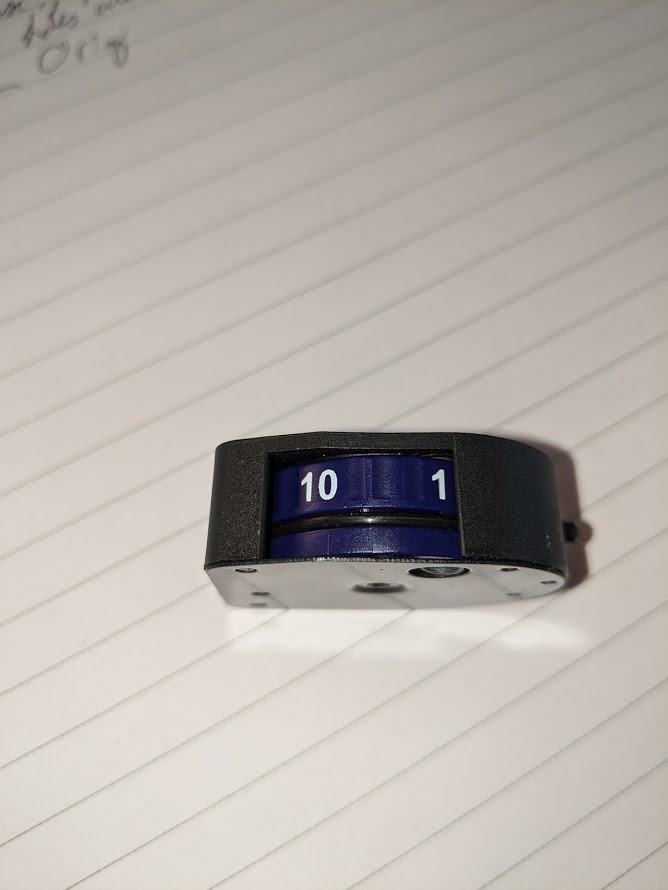

Each of the slots is numbered, 10 shot magazine.
Probably the coolest feature, last shot indicator. Upon feeding the last pellet, a little yellow indicator pops into view. The lighting is bad in this video, it is much more visible when not poorly filmed. When if flashed yellow on that first mag, I wasn't ready for it or even knew about it, but thought to myself, "dang, that's neat!"

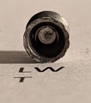

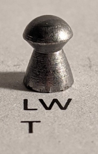

While loading, it is possible to crush a skirt. If the pellet isn't pushed deep enough to be held by the oring, this happens when rotated to the next slot (mashed skirt on the left side of the pellet:
This wasn't a common occurrence, happened twice in all the shooting today, and it was my own fault for not pushing the pellet deep enough.

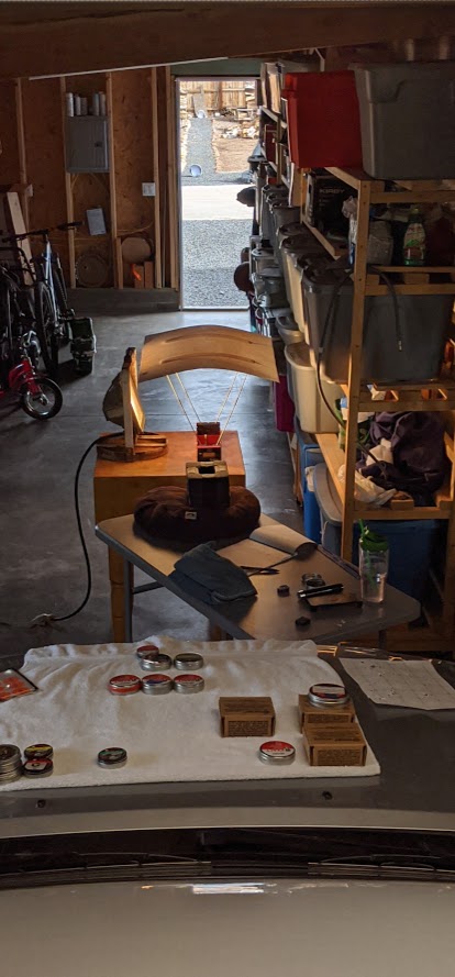

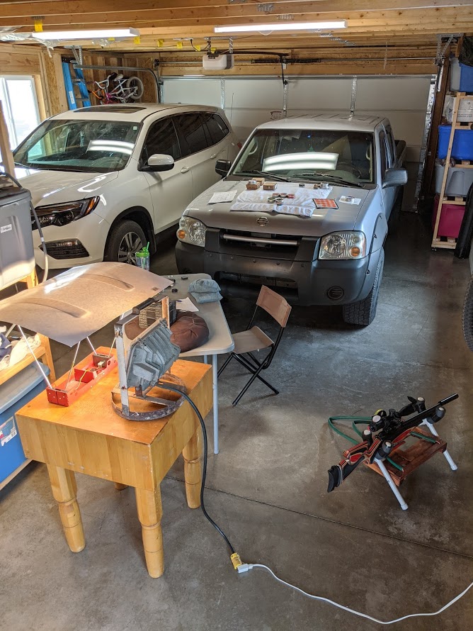

Before the chrono data, some pics of my humble shooting area. When we added on the garage, I had it built to sort of wrap around the front corner of our house. So, it's a normal two bay garage, with a third car bay in front of one of the vehicles in the front bay. 45 feet long on the long side. That gives me 15 yards for indoor shooting and a nice place to get out of the weather to shoot out to 55 yards, out the back door of the single, third bay.
Yeah, nothing fancy, but it does the job. Pellet catching buckets at 30 and 55 yards. The 30 was used just to get on paper when initially sighting in the gun.

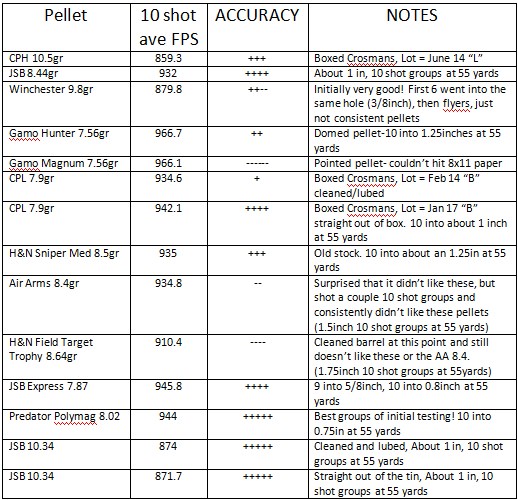

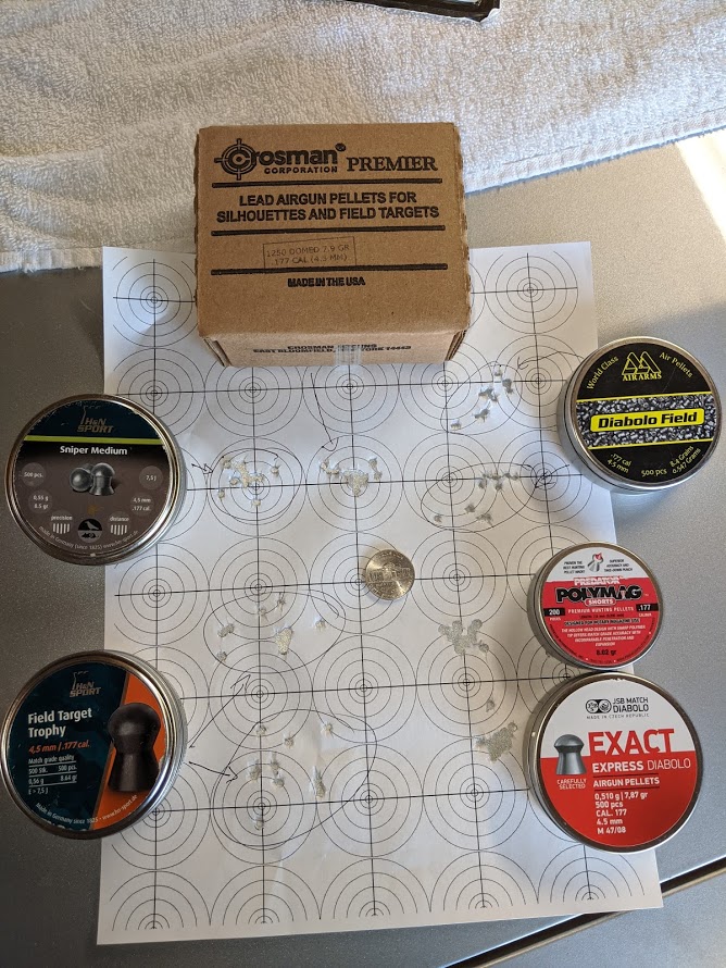

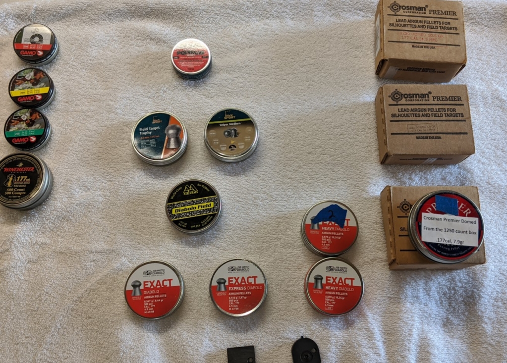

I dug out every variety of .177 pellets I could find. There are some real dogs in this bunch, but wanted to give them all a fair shake, just in case. Most of them are mid-weight .177, pretty much what the gun should like, being in the 16-18 FPE area. The blue tape is my way of marking that particular tin as washed and lubed (the only lube I've experimented with is the Slick 50, One Lube, so that's what's on all the blue taped tins).
The general procedure was to shoot a ten shot group at 55 yards with each pellet, over the chrono. These are all shot from a bench, with a combination of stuff crunched under the gun to get it to the right height to clear the chrono eyes. It wasn't horribly stable, but it's not too hard to tell if an errant POI is from biological input (jerked the trigger left so shot went left) vs, "hey, that pellet didn't hit anywhere near where it should have." The mag was used for this initial round of pellet testing.

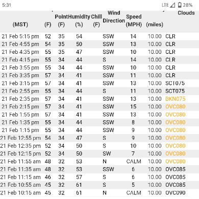

Here's the weather for the day. The National Weather Service has a link when looking at your local weather that shows readings taken from the nearest weather station, every 15 minutes, for the last 72hrs. The nearest one to me is about 25 miles away and up in the tall Ponderosa pines area, so, I'd guess that the wind is typically a little more here at my house where we don't have the forest.
Initial testing was done from about 10am to 12pm, so not much wind.

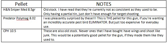

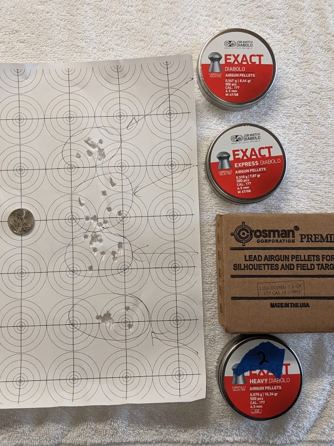

Round 1
With a couple of exceptions (the really junky pellets) even the “bad”culled pellets, are still doing 10 shot, 1.75-2 inch groups at 55 yards. Definitely has it’s preferred pellet, but does ok with most mid-weight pellets.
Some of the Round 1 groups.
Check out how it did with the Polymags!!! Backyard pest killing machine. PRECISION.
Honorable mention from Round 1
Round 2

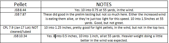

The 4 pellets that made it this far, and my thoughts on how they did. I also switched to the single shot adapter at this point. These were shot from about 2pm to 5pm so 10-15mph winds here. I just held on the aim point for each group, no adjustment for wind or trying to time shots between gusts. The right to left push is evident in where the pellets grouped in relation to my aim point. Scope is a few clicks high for these shots.
Final Round
Two pellets now. Still shooting ten shot groups at 55 yards.

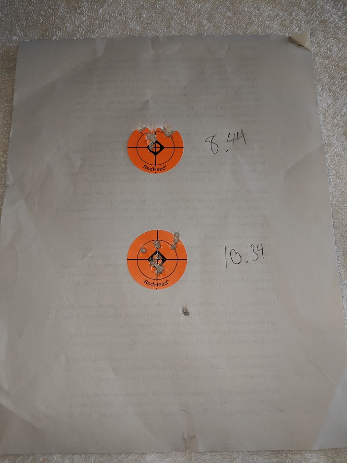

I'm not sure why, but the 10.34 just throws a flyer occasionally. These are a known good batch of pellets too, they do great and I've won matches with this batch out of my primary FT rig, so I'd like to think it's not the pellets. The gun just prefers 8.44 JSB as it's favorite.
These groups are not all that was shot out of the gun during testing, just a few of the more data rich pages I shot at. They are not the best, nor the worst, and a general approximation of what the gun did with each pellet. I am pretty excited that it likes the 8.44s and can shoot them this fast accurately, like a said before, FLAT trajectory.
Overall, the gun will do better than average accuracy ( consistently 10 shots into 1.5inches at 55 yards, in the wind) for precision shooting with most mid-weight pellets of decent quality. It does have it's favorites, like all airguns, and will do 0.5-0.75inch, 10 shot groups at 55 yards, in the wind. I'm sure it will do tighter 5 shot groups, and tighter still 5 shot groups when the wind isn't blowing. I'm a BIG supporter of the 10 shot group, so my groups are going to be bigger than every one of the 5 shot group guys groups. I'm more interested in how the gun shoots, on a consistent basis, than showing off a handful of the best 5 shot groups, cherry-picked. Mathematically (law of averages/statistics/etc) the group size will grow with the number of shots taken. Ten shot, 0.5-0.75 inch honest and consistent groups in the wind at 55 yards impresses me and I'm humble and realistic enough to admit that.

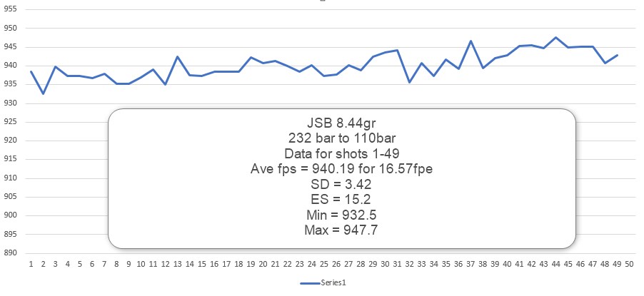

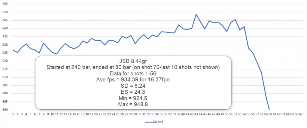

End of the day chronograph string.
As I mentioned in the last post, I'm very curious to SEE this regulator breaking-in concept.
This was shot at the end of the day, I'd guess about 600 pellets through the new gun.
1582409486_4052962785e51a70e2aa9b9.47719076_end of pellet testing string.jpg
Really liking the SD and ES here. At first glance one would say that it's now more consistent than it was at the beginning of the day. I'll do this again a few more times over the next few weeks and see if there's any trends. There were some comments either here or GTA that the regulators in these BSA guns weren't the greatest at one point. I'd kinda have to disagree after shooting these strings. A lot of us obsess over single digit ES but that isn't necessary for very precise shooting. A 15fps spread is tighter than the gun that I usually shoot for Field Target, and I occasionally win matches with that gun.
So, 48-50 shots at about 16.5fpe with it's favorite pellet. Exceptional when considering how small the air tube is. Which leads us into the next topic......

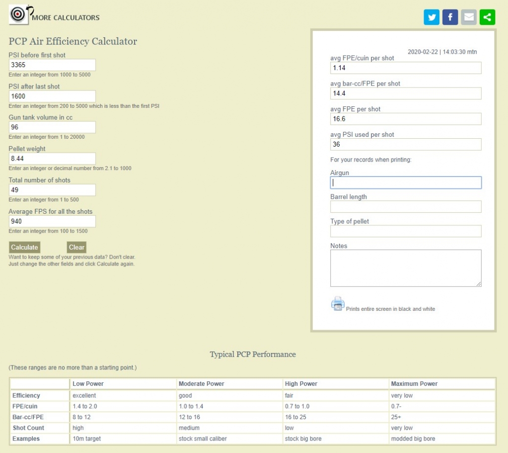

Efficiency
I had a hard time tracking down an air volume for this gun. I finally found 96 cc's listed for a different BSA gun that looks to have the same airtube (I think it was a Scorpion). Some of the UK guys are saying the reg in this gun's tube further reduces the volume. Either way, it's small.
This is what I'm getting, using the above, end-of-day string.
Not too shabby.
I'm finding a shot count north of 75 for the 12fpe version, from the BSA website, and from the UK forums. With what I saw today, north of 75 is completely believable for this gun in it's 12fpe version, I'd hazard a guess that even 85 or so might be pretty reasonable. That's lot's of shots from not much air.

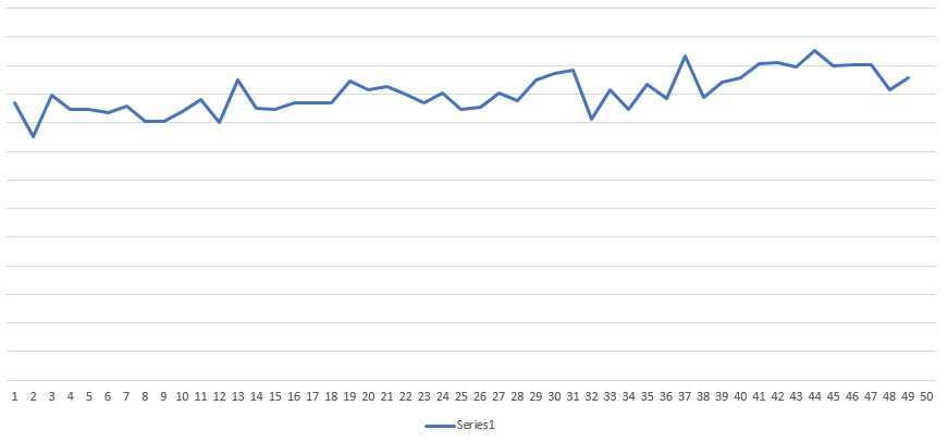

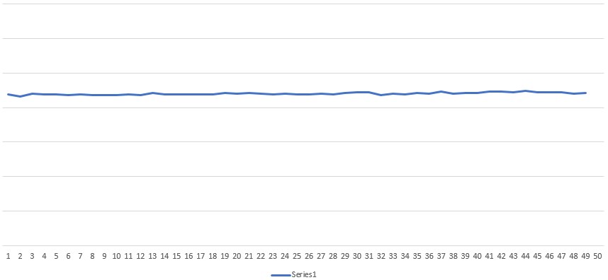

This is an image of the 49 shot string posted yesterday (ES of 15.2, SD of 3.42), with the points plotted in the same way they originally were.
First impression of this line is that it's pretty jagged, so our brain thinks, "ah, that's no good, those shots must be erratic in fps."
This is the exact same data, with some manipulation of the y axis (vertical).
First impression here, "wow, what a flat shot string, that regulator is awesome!"
So, how can the exact same shot string look so different? Because I manipulated it. The overall bounds, and the way I told Excel to divide the Y axis changes how the line is plotted. The jagged line plot y axis is divided into 5fps increments and the flat line plot y axis is divided into 100 fps increment. Yes, still the same data, but our perception of that data is very much different.
It's all about perception.

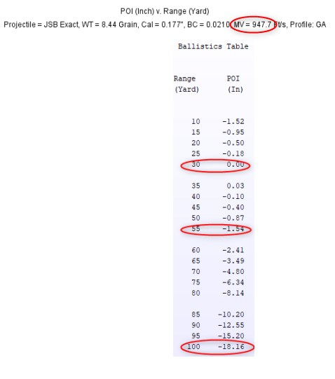

Pursuit of perfection
Not as much back story here. But again looking at the same shot string. High of 947.7fps and a low of 932.5 for an ES of 15.2 fps. I just want to show the real world (as calculated by a ballistics program) variation in impact points from a 15.2fps variation.

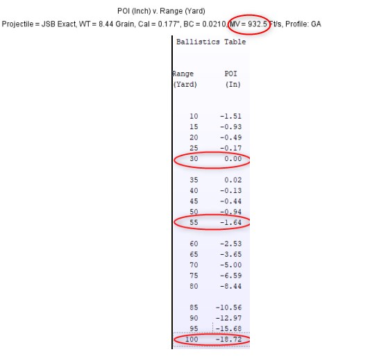

First off, I'm not sure about the literature value of the BC (might test that at some later point actually). What I was hoping to illustrate here, is that at 55 yards, that ES means the slowest moving pellet of all 49 shots, will hit 0.1 inches lower than the fastest moving one. Stretch that out to 100 yards and the slowest moving pellet, again, of all 49 shots, will only hit 0.56 inches lower than the fastest moving one.
I know that I am personally not a stable enough shot to notice a difference in impact point of 0.1inches, that is a tenth of an inch guys! So, an ES of 15, equates to a more consistent POI than most (perhaps all) of us are capable of.

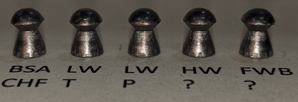

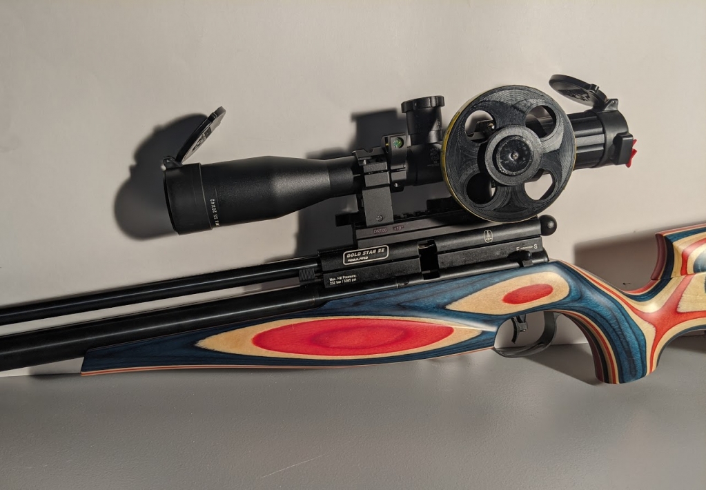

I spent some time online, digging up the history of BSA and this particular gun. I knew that the Birmingham Small Arms company had a long history, but was surprised to learn that it went all the way back to 1861. At various points in their history, they have made metal goods for just about every industry imaginable, and of course, their economic high points seemed to be the World Wars. I won't clog up the forum much about that, but really a worthwhile Google search, if history even slightly interests you.
More germane for us, the following is what I could find on the history of the Gold Star, "Union Jack."
My best guess, going from UK airgun forum discussions, is that this version of the gun was first released in 2015.
The Union Jack came about from a collaboration between BSA and a UK Hunter Field Target (HFT) shooter by the name of Roger Lait(y?). He says he, "used to shoot for BSA and was Captain of their Team for a good few years." We have been communicating through PM and he provided (and granted me permission to share) some cool tidbits of info about the gun.
First off, the laminate stock.
Rog says that he had been working on the gun with BSA when he got a picture from Simon Moore, who was the BSA CEO at the time. This picture was of the red, white, and blue laminate, sent by Simon, who was visiting the Minelli factory. Here is how Rog recounted the story to me, "He sent me a pic and I said " GET THAT LAMINATE !!! " Thank goodness we did. I loved it to be honest."

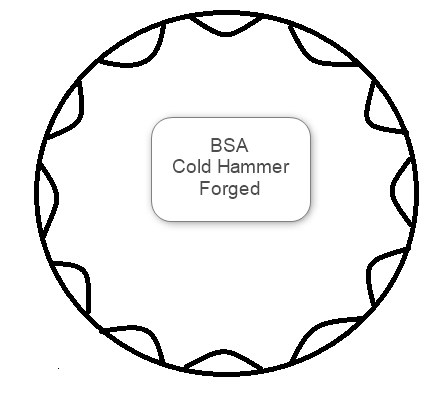

Next, the barrel.

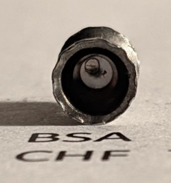

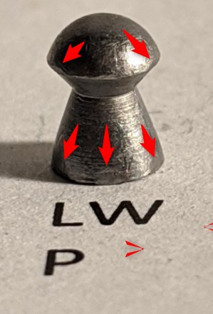

It is made using BSA's proprietary cold hammer forging process. I first saw this video when it was mentioned in AOA's video review of the black pepper laminate version a few months ago. I thought the video was informative, illustrating the process, so here is a link.
https://www.youtube.com/watch?v=qFzyNm9Unp4
Rog says that the Gold Star barrels are even more special than a regular BSA barrel. Per him, "The barrel is made LOTS slower than a normal barrel. Instead of working the machine full blast , when they make the Goldstar barrels , they slow the machine right down to make sure the barrel is made perfectly. In 12 FPE, it made shooting HFT easier by miles." His claim is that the slowed hammer forging process makes the barrels "take less wind." That was a term I was unfamiliar with, but I came across it used pretty extensively when the UK FT shooters discuss a barrel/pellet's inherent ability to resist being deflected by the wind. Apparently, "taking less wind" is a good thing, similar to the phrase, "buck the wind" that I've seen used here in the US.
Some UK forum digging provided the following barrel-related comments, made by various individuals.

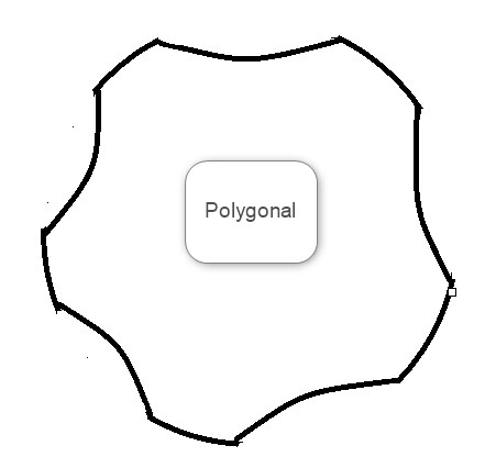

  • "The choke feels reasonably tight, but most interesting is that the lands appear to have soft edges, so instead of getting little rectangular 'bites' in the pellet, the marks are almost a lozenge shape."
  • "Yes I have measured the twist rate in the GS barrel, it is the same twist rate as other BSA .177 barrels I have measured @ 19" twist."
  • "There's a chance (and probably quite a good chance actually) that the new cold hammer forged BSA barrel results in a more stable pellet in flight and a better ballistic coefficient. A more stable and more efficient pellet will spend less time in the air, and as a result will drift less with the wind."
There was also someone who measured and reported a BC of 0.0267 with JSB 8.44 from a Gold Star in the 12fpe version. Chairgun supplies a default BC value of 0.021 for this pellet. I hope to eventually get around to verifying the BC with this one that I am shooting.
In that UK forum discussion, there was a fair amount of skepticism regarding the claims that the Gold Star "takes less wind." From personal experience, I lean towards the thought that a particular barrel/pellet combo CAN indeed reduce the effects of wind deflection. I would guess that it's a combination of factors, but give the most weight to the idea that a pellet that deforms less as it passes through the barrel has less severe "teeth" for the wind to catch and push.
So, at some point, I intend to do a head-to-head comparison in the wind with two of my own guns, against the Union Jack. All three will be .177, doing high teens for fpe. One is a LW polygonal barrel, another a traditional cut rifled LW, and the third, the more slowly hammer forged, "takes less wind" BSA barrel. I'll shoot groups with enough pellets to be somewhat statistically significant and try to structure the whole comparison to not favor any one gun.

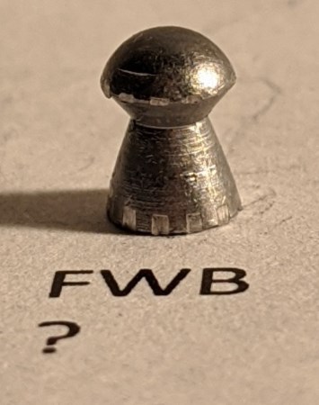

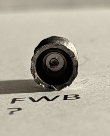

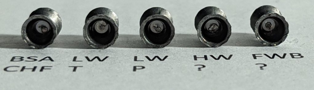

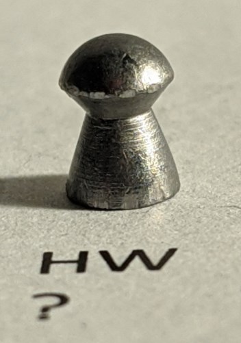

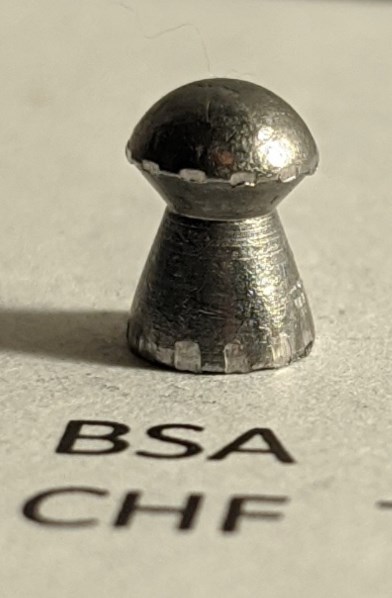

I got curious about this BSA cold hammer forged barrel's rifling profile so devised a little comparison.
I pushed JSB 8.44 grain pellets through each of five different barrels, and then did the best I could to take decent close-ups. Some of these guns are capable of going breech to crown, but I carefully went from the crown to the breech with all five (for the sake of consistency in the comparison), using a coated, one-piece rod. Less than ideal but three of the guns would need some pretty serious disassembly to go the other direction.
The five barrels:
  • BSA CHF= BSA cold hammer forged
  • LW T = Lothar Walther traditional rifling
  • LW P = Lothar Walther polygonal
  • HW ? = Weirhrauch (broach vs button vs cut vs?)
  • FWB = Feinwerkbau (broach vs button vs cut?)
I couldn't quite get the detail I wanted in the above pics so took the following as well.

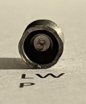

 (added some arrows here because it's just so hard to see the engravings with the poly)

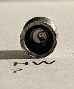

Perhaps I'm imagining it, but it sure seems like the BSA barrel has rounded lands, like this:
The other odd-ball is the poly. I'm seeing this, with the poly:
And finally, the other three look like a 12 land and groove situation, but with rectangular lands, like this:
The FWB felt like it has the tightest choke, based on the fact that the engravings start further up the slope of the skirt, and even smeared enough lead that you can see little tails of lead hanging off the head. It also seems to have the overall sharpest, most aggressive rifling, The base of the pellet also has the most distortion with the FWB barrel.
The next tightest choke would probably be the BSA, based again on how high up the slope of the skirt the engravings begin, but also just with how it felt at the choke.
I personally feel that an overall smoother post-barrel projectile has the best chance as resisting wind deflection. It seems like the less protruding lead from the basic shape the pellet began as, would offer less total surface area for the atmospheric molecules to interact with as the pellet flies downrange. Only taking the visual effect of the engraved pellet into account, the winner by a landslide out of these five particular barrels is the poly. (It's my main FT rifle barrel, and it DOES indeed shoot well in the wind).
I can't really say that the hammer forged has less overall protruding lead, or even less sharp edges. But, itt's not any worse than the 3 barrels that are 12 land and groove and have rectangular lands. Actually, the BSA pellet looks much better than what's coming out of the FWB barrel, if "smoothness" is even an aerodynamic advantage.
Ultimately, actual accuracy results (and BC?) would be all that matters, the above was just to satisfy my curiosity of how the pellets look after passing through each of the barrels.
(really tough to get decent up-close pics, best i could do guys)

I don't want to jack your thread but I just got the R10TH Nutmeg in .177 about the same time you got the Union Jack, basically the same guns.
I worked with it in stock form for a week or so and decided to replace the regulator with the Huma, I also have an R10MKII in .22 that is just bitchin' and it has the Huma as well..
Since replacing the stock reg I have found some interesting results that you might try.
I left the Huma as it came from the factory and shot damn near every pellet you did with about the same mixed results until I tried the Redesigned JSB 13.43's , man I have to say I hit it right on the money with those, current set up is shooting consistently between 875 and 877 fps with an occasional 880 in there ..
It took a little time over the chrony and playing with hammer spring adjustment to really zero in on it to get those consistent numbers , I am Very happy with the accuracy and I am still getting 40 + good shots per fill..
You might give the 13.43's a try and see what you get ..
Here is my gun
Bfloyd,
You're not hijacking at all. Very relevant comments. Thank you.
I do see a some similarities between your R10 and the Gold Star (breech/bolt/trigger/trigger guard/and maybe the buttpad?). I really like that nutmeg laminate.
I'd like to hear more about the hammer spring adjustments you mentioned. I didn't think these guns could be adjusted. Did you swap a different spring in there or is there an adjustment that I'm unaware of?
I don't have any of the JSB 13.43s on hand, might need to track some down. Some of the FT competitors at the matches I go to seem to have switched over to those, although in our club it seems to mostly be the Hunter Class guys. Although, if the Gold Star is a set power of 16-18fpe, those might be a little heavy for it's power output.
Please tell us more about those hammer spring adjustments.
Thanks for sharing.
