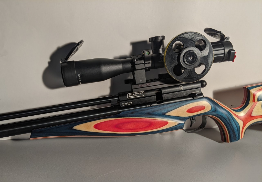

BSA Gold Star "Union Jack" in .177, ongoing review

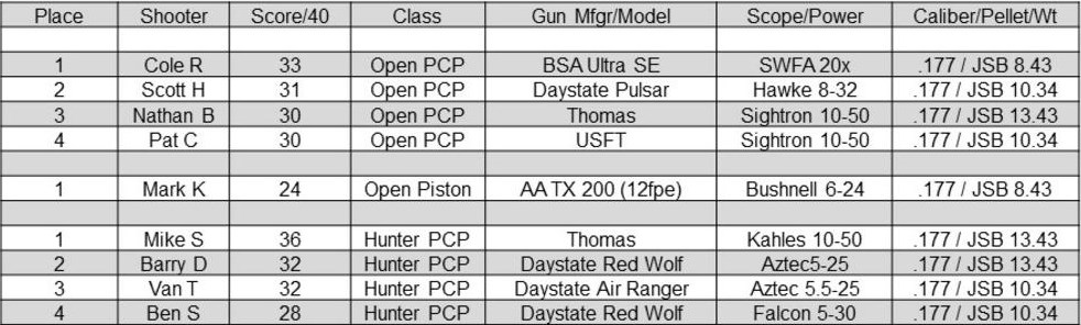

Here's Mark's scoreboard from the match:
I'm not sure what I was thinking when I filled out the equipment section at sign-up. I shot the GOLD STAR that I've been reviewing for 5 weeks, and used 8.44gr pellets. Dunno how I came up with "Ultra SE," but it probably had something to do with lack of sleep.
So, I shot a 33/40. For a course with the hardest shot being a Troyer 50 and the easiest being a 30, on a windy day, using light pellets.....82.5% knockdown percentage. Looking at that equipment list, the little Union Jack BSA held it's own against some very nice, very high-end PCPs.

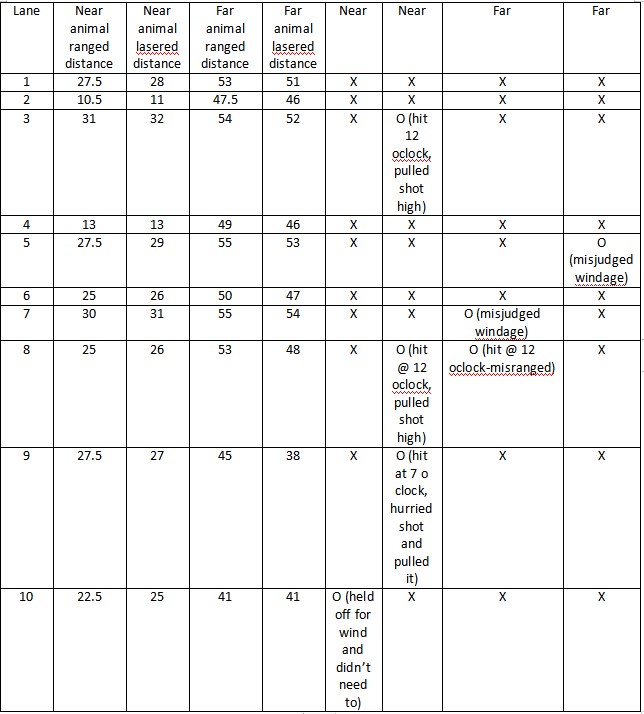

As far as the seven misses, I took pretty extensive notes during the match, knowing full-well that I was going to do a write-up on the gun's performance. Being in a shooters squad of 3 gave me enough time to take notes.
The notes are summarized in the following table. Using the 20x SWFA, I knew I was handicapping myself, and that sort of played into the game plan of using the lighter/flatter shooting 8.44 pellets. This scope ranges quite well out to about 30 yards but doesn't do so well further out. With how I set this rig up, the critical distances are the close ones. If you go back and look at my trajectory map, there are only 5 clicks on the scope between 30 and 55 yards. That allows much less accurate ranging on the further shots.
X's are hits, O's are misses.
There are columns for scope-ranged target distances AND lasered distances. Before I get called out as a cheater, the laser rangefinder was in my vehicle until AFTER I took my last shot. I okay'ed it with the match director, and he said since I had already finished the course, it would be fine to laser them to see if misses were due to errors in scope-ranging. Only one of the misses was due to a ranging error, the first far shot on lane 8. I ranged it a little further than actual so my pellet struck high. I got a little lucky on the misranged far target on lane 9-I was off by 7 yards. Click values for 38 yards = 0 and click value for 45 yards = 2 clicks. This is where that flat shooting light 8.44 bought me some wiggle room with ranging errors. The kill zone on the far target on 9 was big enough to account for a 2/10mil vertical variance.
3 of the misses (lanes 5, 7 and 10) were due to misreading the wind. The misses on lanes 5 and 7 were because I didn't hold off far enough. These were the lanes in the middle of the berms. The wind was much stronger in the middle than near the berms on the sides. It was crazy to see how much the wind was grabbing those pellets. There were shots on the middle lanes that I needed to hold completely off the faceplate of the target, roughly 5-6 inches worth of windage. Watching those pellets curve into the kill zone (when I read it right) was really cool. The miss on lane 10 was also due to misreading the wind, I held off about 1/2 inch upwind of the edge of the killzone, and proceeded to watch the pellet make a nice clean lead splatter right where my crosshairs were-wind died right then and that shot didn't need any hold-off.
The last three misses were operator error. On 3 and 8 I pulled the shots high. I knew what I had done on both of those shots right as the trigger broke, before the pellets even struck. The miss on 9 was during a momentary lull in the wind. I got excited that the wind had died for me and I tried to get the shot off too quick, effectively yanking down and to the left (pellet strike at 7 o clock on the table). The frustrating thing about these three misses is that they were on the second shot of each of their targets. That means I had already ranged correctly and knocked down each of the three targets once. This is simply human error, nothing to blame but myself, and the most frustrating of field target mistakes.

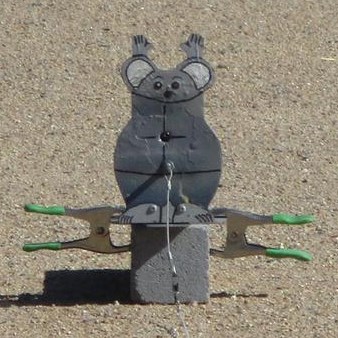

This was one of the two close targets of the day, 1/2 inch kill zone at 13 yards. I always get a laugh from the "don't shoot" mouse with his hands in the air. Mark was zoomed in pretty good when he took this pic. That kill zone still looks pretty small though (it's where the marker crosshairs were drawn in, about the chest of the mouse).
This armadillo was the 11 yard, also half inch kill zone. I think I took this pic, no zooming, can just barely see the kill zone with the bare eye.

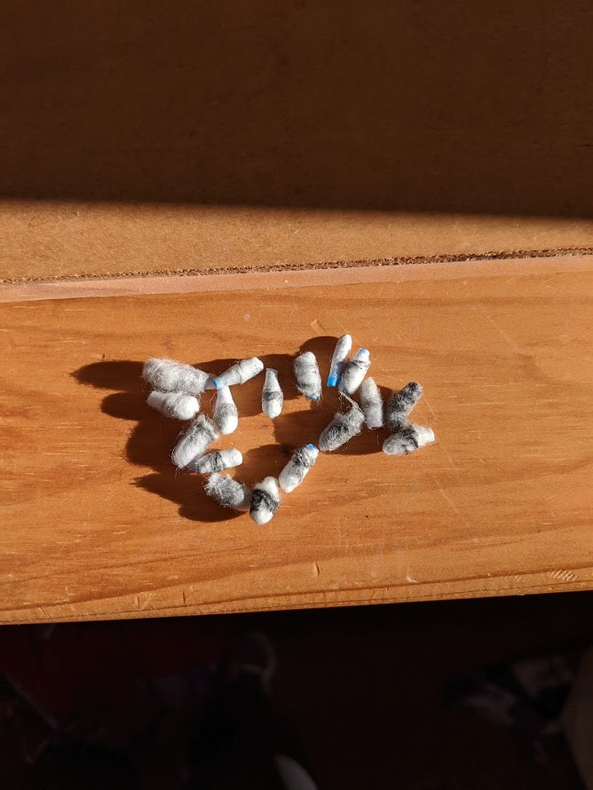

  • I'll still do a short write up on barrel cleaning and what I've found with lubed pellets in the gun.

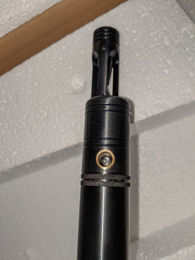

  • Also, a short one on the fill port/gauges and I'll likely point out the oring in this write-up (from the schematics) that needed replaced the night before the match.

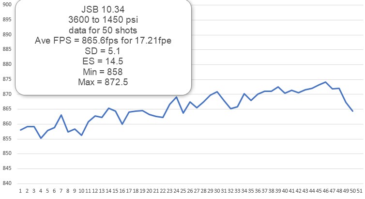

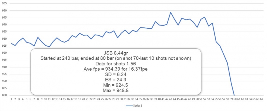

  • I want to do a final shot string over the chronograph, to see what the reg is doing after that many shots.

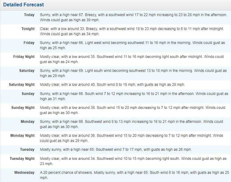

Windy time of year
My airgun mentality is firmly entrenched in the Townsend Whelen cliche about what makes them interesting. With that in mind, we're about two weeks into one of Northern Arizona's windy seasons. The current one runs from mid March into late July. The other one is from early August and ends around mid December (nope, no typos in that description). Wind and .177 pellets make the accuracy part of Colonel Whelen's famous saying a little difficult to assess. On a brighter note, the only way to get good at shooting in the wind, is to shoot in the wind.
Here's our forecast:
Tues night looks promising, with gusts of 23mph.
Seriously though, I need a few more windless sessions to do some of the last couple accuracy testing sessions with the Gold Star.

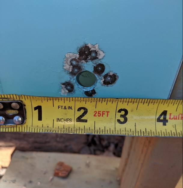

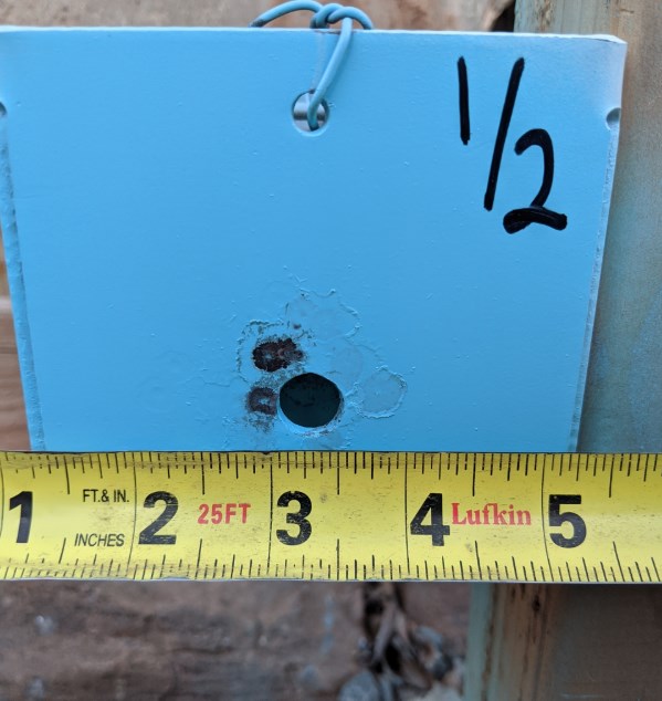

I purchased one of the "small" ABC bell targets 8 or 10 months ago. It has four KZs: 3/8″, 1/2″, 3/4″, and 1″. With how they are mounted, one of the KZs is not shootable. I mounted mine with the 3/8 against the board. They make a nice TING when kz is shot, vs a SMACK when the pellet misses the hole.
The challenge
54 yards at the bell targets 1" and 1/2 inch KZs with the BSA Gold Star from a bumbag (Open class FT position) IN. THE. WIND.

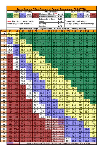

Troyer factor = (target distance/kz size) x ( 1 + difficulty factors)
1 inch at 54 yards in the wind = 74.25T !!!
1/2 inch at 54 yards in the wind = 148.5T!!!!!!!!!!!!!!!!!!!!!!!!!!!!!!!!!!!!!!!!!!!!!!!!!!!!!!!!!!!!!!!!!!!!!!!!!!!!!!!!!!!!!!!!!!!!!!!!!!!!!!!!!!!!!!!!!!!!!!!!!!!!!!!!!!!!!!!!!!!!!!!!!!!!!!!!!!!!!!!!!!!!!!!!!!!!!!
For perspective, a 50T and above is ILLEGAL to have in a FT match, at least a Grand Prix (that's not to stop a deviant match director from having fun at a monthly match though)
A Troyer above 40 in a match makes the piston shooters whine (I'm one of them occasionally, both a whiner and a piston shooter, sometimes at the same time), and the WFTF shooters cry like babies(can't blame em-wind deflection is a B at 12fpe)

Round 2
10 shots at the 1/2 inch KZ with JSB 8.44 (yep, still at 54 yards)
This one's at regular speed. HEART. RATE. You can see the wind flag shadow blowing around a little.
https://www.youtube.com/watch?v=NqHHGiVZ05o
Pic of the carnage-not much to be proud of here, although I think a couple did go in, just cant tell from the angle. Typical light pellet in wind situation, hold for the wind and have it not do anything to the pellet vs not holding enough.

5 shots at the 1/2inch KZ with JSB 10.34 (still at 54)
With how I zoomed, I think my heart rate is the most apparent on this one.
https://www.youtube.com/watch?v=hGh0LsGjq8M
I think I managed to thread 2 of the 5 in the KZ.

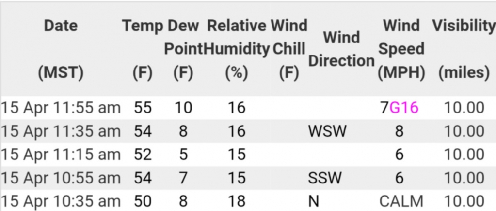

This report covers shooting done between 730 and 940ish, AM. Upon arriving home from my last night shift, I realized the wind was sorta decent for pellet shooting, so that's when this comparison was shot.

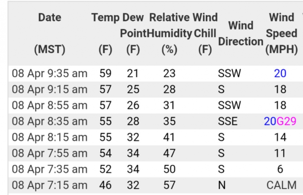

Weather summary:
Basically the wind started out pretty calm, but kicked up shortly after I started shooting and got worse throughout the shooting session. Remember my home range shoots due east, so wind was mostly from right to left on targets.
30 second clip of the wind taken at 830, after the wind had come up. There's no shooting, so it'll be a boring video for many of you, especially if you don't ever spend time watching the wind (via wind flags or otherwise) in attempts to outsmart it with your relatively low BC pellets. If you would like to see what kind of wind these groups were shot in, the near wind flag is at 35 yards, the far one is at 51 yards, both along the left side of the frame. No fancy wind flags here either, just something that helps me to have an idea of what it's doing.

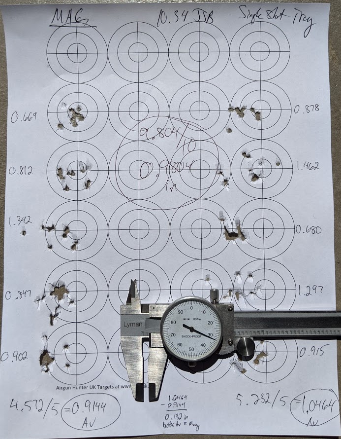

The comparison design
10 shot groups from 53 yards, off bags from a table ("bench-rested"), rotating between magazine and sst for each group, shot in sequence like reading a page (top left group=mag, top right group=sst, second to top left group=mag, second to top right group=sst, and so forth).
All shots taken with cross-hairs dead on center of target, or at least as close as I could muster (no hold-off for wind, gusts or otherwise). There was also no effort to break the shots at low-wind moments.
This resulted in all the groups from the mags in the left column, and all the groups from the sst on the right column.
We all know that it's easier to shoot more shots in a given amount of time, or to shoot the same amount of shots quicker, when a mag is being used. For this reason, I consciously waited the couple extra seconds after cycling the bolt (on the mag groups), that loading the sst takes.
I also cleaned the barrel right before testing, with a few "fouling" shots taken prior to these groups. I'll get into more on that in a different report.
JSB 8.44
I shot the lighter pellets first, expecting the wind to pick up. So this page was all shot from 730-830.
(I penciled in "8.64 JSB" but they're just regular 8.44, must have been my night-shift brain on the typo).
The wind was very calm for the top two groups and the pellets were hitting just a hair to the left of bullseye, so I did give it two clicks to the right after shooting those top two 10 shot groups. The scope was not touched for the rest of this page.
The numbers down the far left and far right are the size of that group, measured center to center of the two farthest apart pellet holes. The average group size is circled at the bottom of each column. The difference in group size is in the middle/bottom and the calipers are representing that difference in average group size. It happens to be 0.0364, which, in my opinion, is minimal and likely not statistically significant enough to conclusively say the gun does better with the mag or the sst, at least not with these pellet and in these condition.
The overall group size for all 10 (mag and sst), 10 shot groups is circled, about dead-center in the page. The average 10 shot group size for all 10 group with the 8.44gr JSB was 1.2806 inches.
A surprising trend was that 2-3 shots out of the last four 10 shot mag group were border-line "flyers" to the low and right of where I was aiming. Although these seeming "flyers" didn't worsen the overall group size to the point of making them bigger than the sst.
JSB 10.34
All ten groups here were taken from 830-940. Go back and check out the wind towards the end of these targets. 💨
The results are all reported on this page in the same manner as they were for the 8.44. The size of the 10 shot groups from the mag was 0.132 inches better than the sst. That's a big enough difference to start to make a difference.
The overall group size for all 10 (mag and sst), 10 shot groups is circled, about dead-center in the page. The average 10 shot group size for all 10 group with the 10.34gr JSB was 0.9804 inches.
Conclusions
The Gold Star printed smaller groups with the magazine than it did with the sst I fashioned, with both weights of pellets that were tested. This goes against the generally accepted, single-fed is better concept. The possible limitations here are that I fashioned the single shot tray myself, it is not a BSA/OEM item. So there's a possibility that there's a minor misalignment there. I've got to admit that I "felt" like the sst was shooting better, even during the shooting of these groups. The difference for the 8.44 is inconsequential, but a little more than a tenth of an inch difference with the 10.34gr starts to equate to a few splits (missed points) in an FT match, or a head-shot but not a brain shot on a pest bird.
So, the mag shot a smaller average group than my sst. Feel free to make your own conclusions based on the info that I've given. After this test, I for one, don't think that using a magazine with the Gold Star equates to less accurate shooting.

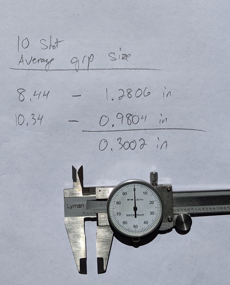

Did you notice the average group size for the 10.34gr vs the 8.44 pellets? Here:
I worded it poorly in my handwriting on this page, but these are the 10 shot average group sized for ALL ten of the 8.44gr (mag and sst) and all ten of the 10.34gr (mag and sst) shots. First off, in regards to the 10.34gr pellets, for a gun to be able to shoot 100 shots, in 15-20mph winds, without any windage given and have the average 10 shot group size be under an inch.........well, I'm just further impressed with it. I've said it a couple times already, but the gun SERIOUSLY shoots at a level much higher than it's price point.
The elephant in the room here is that the 10.34gr pellets shot quite a bit better than the 8.44gr. I had previously decided that the 8.44s were better. This could have been the wind that I was dealing with, or maybe the barrel is more broken-in now than it was when I did the comparisons before, or maybe I was biased into the 8.44's because I was excited about the prospect of that flat trajectory. Regardless of the why, I'm going to start shooting the 10.34s out of the gun, with the hopes of being able to map out the trajectory with that pellet for an FT match in the next month or two (COVID is making that seem unlikely though).

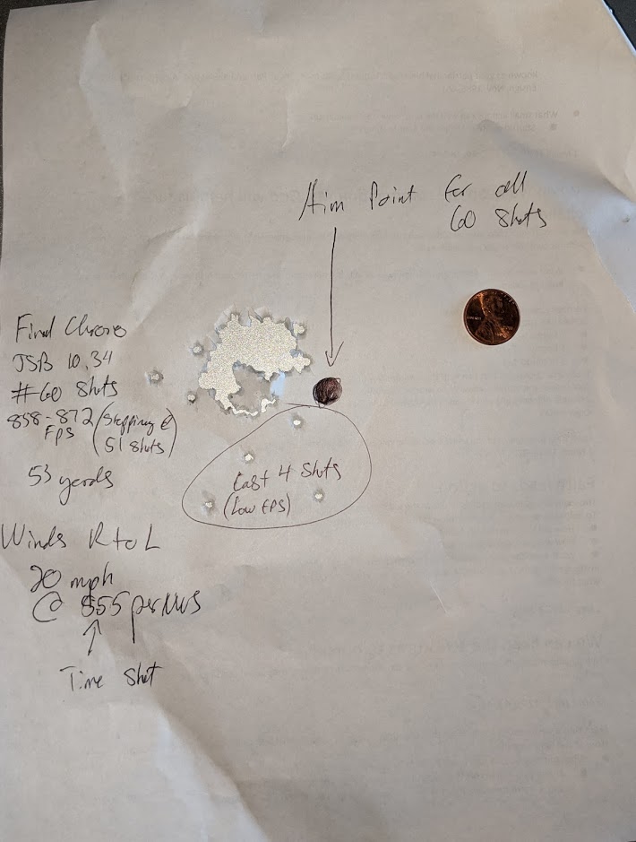

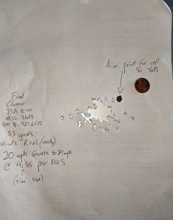

  • Final opinion and thoughts.

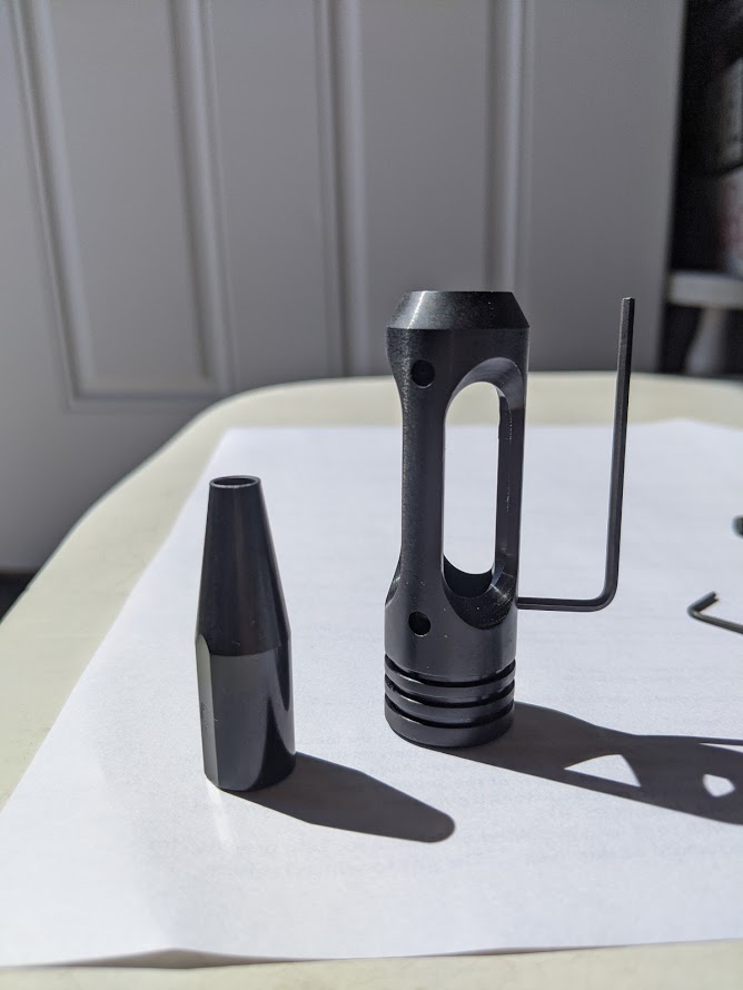

Stripper Testing

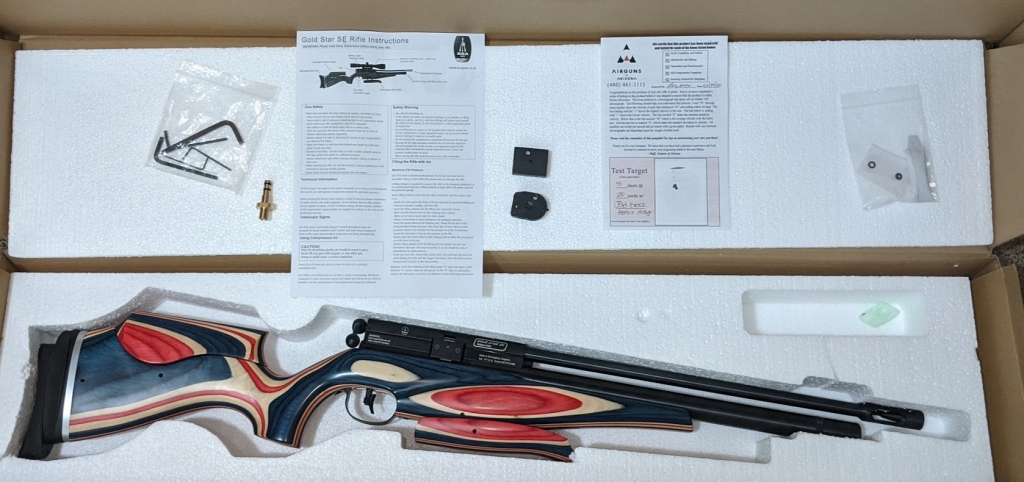

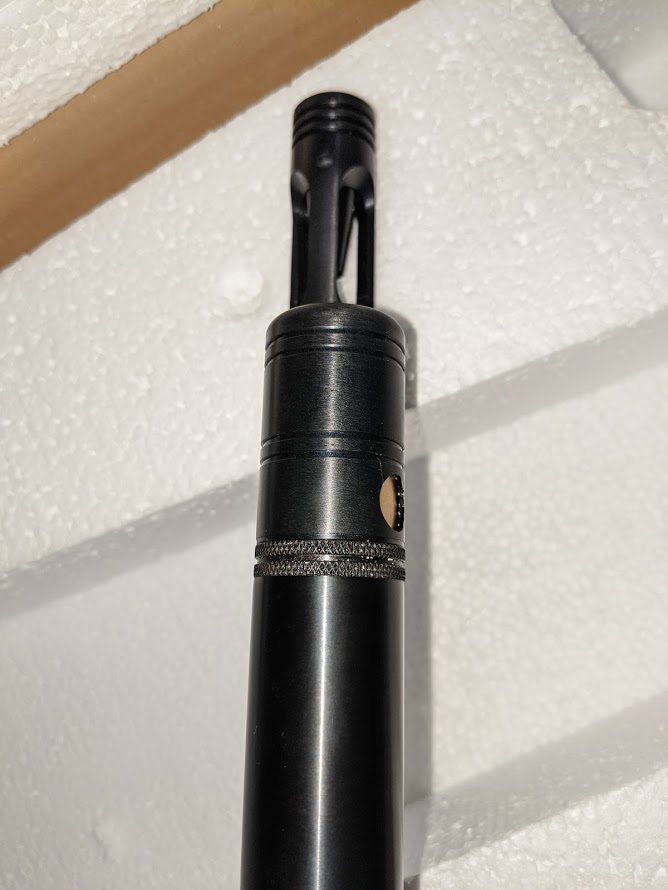

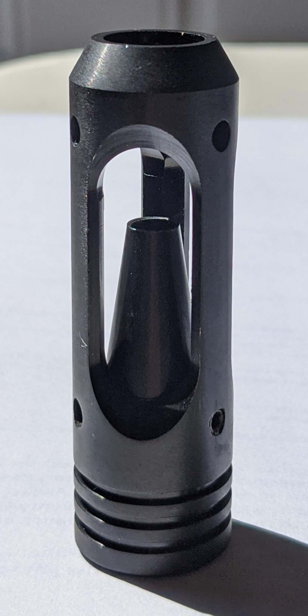

One of my first thoughts upon taking this gun out of the box was that I needed to investigate accuracy with that stripper. And I did, but first a quick description. So, it's what comes on the gun, standard 1/2-20 female threads on the stripper, male on the barrel. That allows an easy swap from the OEM stripper to a moderator, which is mostly how I have shot the gun. I sure thought that it was machined steel but no magnetism so I'm guessing anodized aluminum, even though the finish really looks like blued steel. In case it wasn't apparent in the teaser pics on the last post, the cone has an adjustable depth/spacing from the end of the barrel. There is a flat on the cone to which a little allen set screw grabs. Although it would appear that there would be more adjustment, there is realistically only about 5/8 of an inch of cone travel. It'll adjust down so close that the stripper can't thread onto the barrel, and it'll adjust out only so far before you run out of the flat. So, 5/8in is the "doable" adjustment range.
My preconceived notions expected to either see no difference in accuracy, or the best accuracy with it pretty close to the end of the barrel.

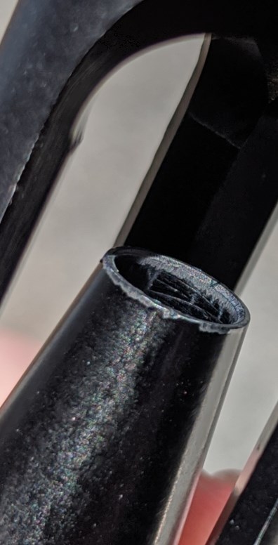

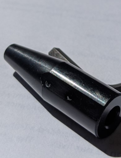

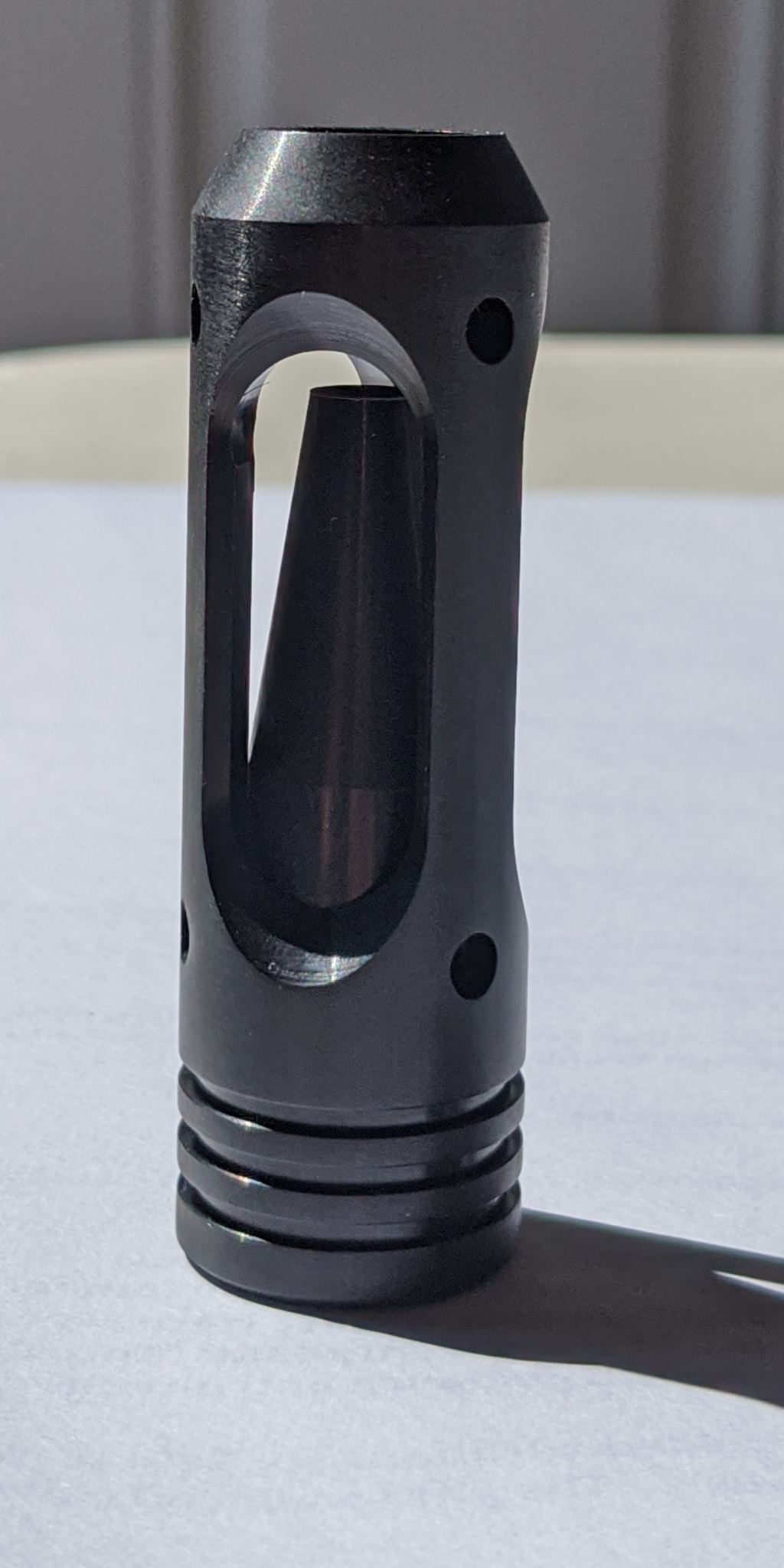

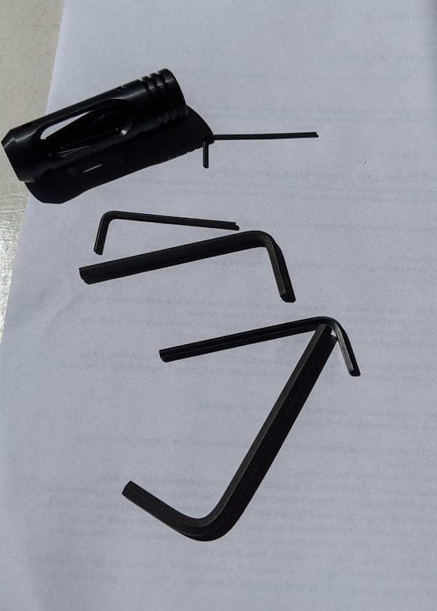

The stripper is really a smartly little machined unit, neat to inspect and see all the steps that seem like they would have needed to have gone into making it, even if it was done with a CNC machine.
Here's some visual's for the above description. Set screw marks on the cone (and pics on the previous teaser post) show the two depths I tested at, basically max and min of available cone travel.
My couple of sets of gunsmithing bits were in my tool room on the opposite end of the house, it was sure nice to have the BSA-supplied allen keys right there by my gun cabinet. They're really a cheap thing for a gun manufacturer to throw in the box, but it's a very nice gesture that suggests the company is thinking of the end-user. Super convenient for a gun to come with all the sizes necessary to make any adjustments. Not a make or break deal on a gun, but a nice touch on the part of BSA in this case.

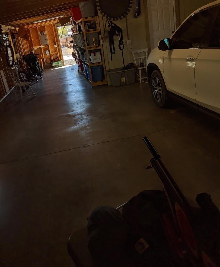

Scenario
I just decided to go for it at my house, despite previously finding out that it is LOUD with the stripper. I did, however, decide to back my truck out of the garage rather than shoot from right in front of it like normal. I kinda talked myself into the theory that maybe the bigger volume of the front end of the garage could act like a really large first baffle on a moderator and keep the neighbors from freaking out. Here's how that looks...
It equated to a lasered 60 yards.
Shooting from my bum bag and a home-made bag. It was actually pretty stable with the tube resting on the shooting bag, and the knee rest sitting on the bum bag, sort of a stepped shooting bag.
And oh yes I used ear plugs! (Man o man it was loud in my garage like this).
Conditions and Design
Wind right to left
10 shot groups (mostly-I got into a little bit of a plinking mode with the moderator back on at the end of the testing) from 60 yards, using only the JSB 10.34 lubed (but not sorted or weighed). Shot control groups with the moderator (left side of each paper) and then shot groups with a shallow cone depth and then repeated all of that with the cone spaced out as far as possible from the barrel.
I expected varying points of impact so had another pellet trap right next to the one holding these targets, so that I could verify poi before shooting groups. Both bucket pellet traps can just barely be seen in the above pic out the back door of the garage.
All shots taken with crosshairs on center of bullseye (once poi was verified and clicked into scope using the other pellet trap).

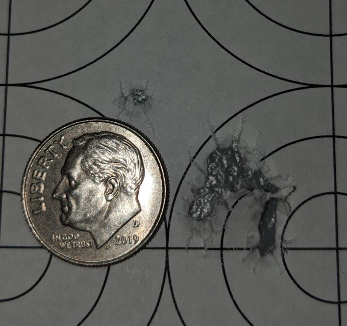

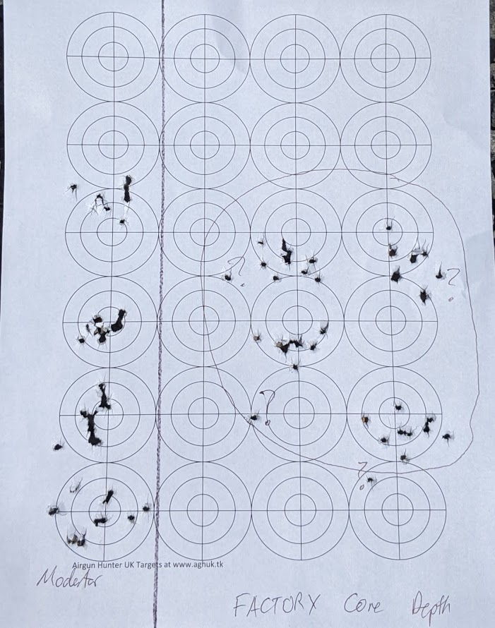

Factory Cone Depth
Note-the way it came to me really had the cone set about as close as possible to the barrel, again see the pics on the previous post of the review.
Left of the marker line = moderator groups
Right of the marker line = stripper groups with factory (close) cone depth
This cone depth on the stripper was complete and utter junk. There were flyers galore, you can see question marks that I penciled in, those were the flyers. There also seemed to be some sort of back-pressure effect happening as the pellet went through the stripper. Whatever this phenomenon actually was, it was causing less than smooth shooting, almost like it was inducing recoil. The pellets were also going much slower, I could follow them with my eyes, and they were not flying straight (curveballs, spirals, all manner of airgun evil). I really thought all the pellets were clipping, to the point that I inspected the stripper after these groups. I found some lube on the tip of the cone, but otherwise it didn't seem to be clipping like I had presumed.
This stripper setting required 8 mils more elevation than with the moderator (the "control").
Conclusion from this cone setting and the stripper. BIG. FAT. NOPE.

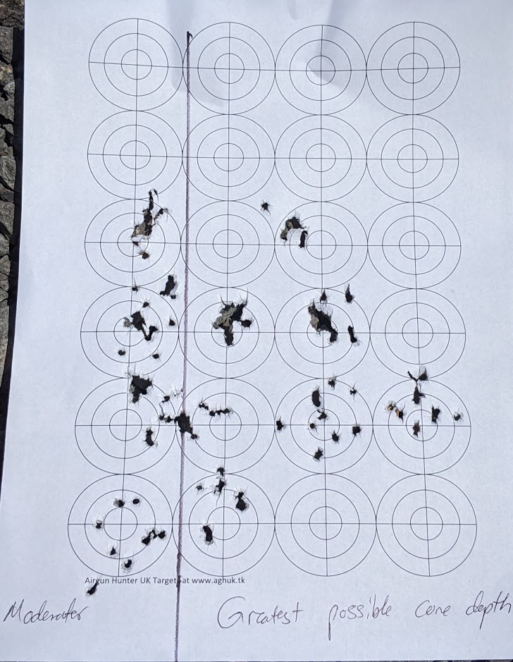

Deepest Possible Cone Depth
Same thing here, ten shot groups with the stripper on the right of the marker line, and mostly ten shot groups with the moderator on the left of the marker line. They blurred a little bit on the third row down.
WOW. Those first three groups with the stripper were just dropping into nearly the same hole. At 18ish FPE, at 60 yards!!! Here's a close up of the top stripper group.
9 under a dime. EASILY under a dime. Really wild thing is that I pulled the one shot that's not in the group. The next two groups with this cone setting were not too bad either.
The next four stripper groups were not quite as impressive (hey I'm human).
Nearly the same POI as the moderator.
No flyers with this cone depth setting.
Conclusion (and impressions)
Cone near the muzzle = pure crap (didn't take many groups for me to decide to stay far away from this configuration)
Cone far from muzzle = surprised the heck out of me (so much that I shot more groups here cuz it was unexpected, shoulda stopped with those first couple though)
Here's the poi verification page. There's other stuff going on, but here are some just informal shots taken from the close cone vs further cone settings. Close cone in the top circle and further cone in the bottom circle. It was at this point (four or five into the same hole) that I was raising an eyebrow in disbelief at the further cone, and being pretty disgusted with close cone results.
I have shot lots and lots and lots of 10 shot groups from this gun, in various conditions, most around 50-55 yards. I have kept all those pages of groups. I was really curious about the frequency of that size of groups (the one I zoomed in on with the dime) so I laid all the pages out. There were only a couple of groups that were about as good as this best group from the stripper with the cone all the way out. There's a concept of probability there:lots of groups with the moderator and only a few similar sized groups vs not many groups with the stripper and a couple of really good groups (with one exceptional group, and at another 5 yards than the good ones from the moderator). I think that there is really something to this stripper with the cone spaced out this way. For anybody that owns, or is going to own this gun, it is worth testing (if the loudness factor isn't a deal-breaker).
I was discussing this with an airgun friend that does a lot of pest bird shooting at dairies. A. LOT. And he actually is a believer in high power .177, so does quite a bit of shooting in that realm of fpe. He is the only airgunner I've ever heard of who shot enough pellets through one gun that he wore down some part of the bolt on some such gun. I believe he told me over 100,000 pellets through that gun to make it wear that way. No, I don't remember the make and model. But, he told me he has seen the same thing with improved accuracy with a stripper vs a moderator to the point that he takes off his moderator when at the dairy and taking 60 plus yard shots on pest birds. He was specific in saying that he's only see this with .177 pellets though and hasn't confirmed it with larger calibers.
So, the stripper effect on accuracy really seems to be something worth investigating, if the shooter lives in a situation where noise isn't a concern. (Personally, I'll take the slightly reduced accuracy with a moderator as a trade-off for the nice, quiet shooting experience. I took the ear plugs out for ONE shot during the above stripper testing, and they went STRAIGHT back in cuz it was painfully loud).
The gun is so nice and compact without 7 inches of moderator hanging off the front. Very nice to handle.
It was a welceom return to quiet and no ear plugs to put the moderator back on at the end though.

Barrel Cleaning
My rough estimate of shots through the BSA is around 2500. I cleaned it three times. Really, three times. And my "cleaning" was simply spraying some cut off qtip ends with Slick 50 for moisture and pushing them through the barrel (for .177 it really works quite well). No brushes, or solvents, or JB bore paste, or recrowns, or any of those typical hoops that we jump through for good accuracy. The accuracy never dropped off from a dirty barrel, it is very tolerant of being dirty or clean.
This was after most of two tins...
The barrel would come clean very quickly, suggestive of a polished finish. If a BSA Gold Star barrel blank ever comes up for sale in your airgunning hobby activities, buy it-you won't be disappointed.
It was very nice to not need to deal with a shroud or baffles when cleaning. No straw, no vacuum, no baffles to fight or end of barrel vs end of shroud gap to fight. I would simply take the moderator off and have unrestricted access straight to the barrel. Convenient.

The BSA fills via a probe. I tend to simply leave the probes in guns that require them, as I've found the constant replacing leads to cut orings. But, it does have a neat little dust cover for the hole if that's an individual's preferred process.

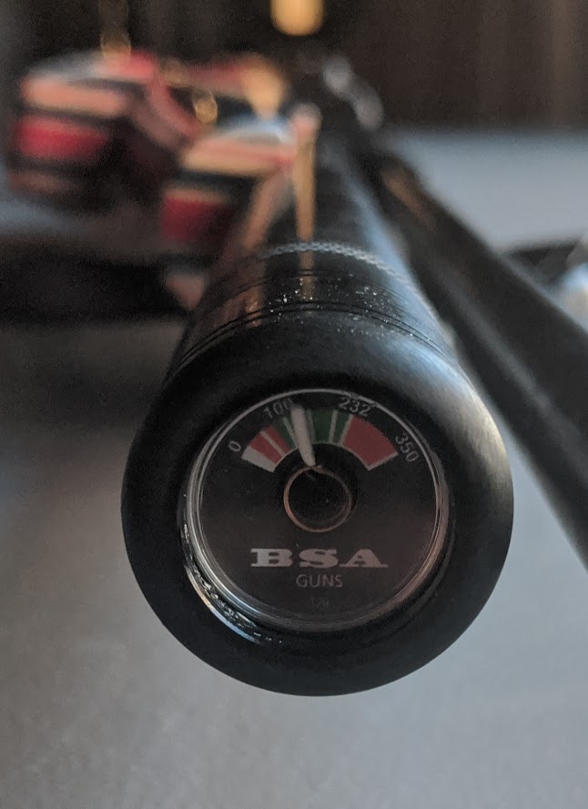

The gauge on the gun matched all three of my fill stations, and the gauge on my Hill pump (the one time I filled it with the pump). It would scream when filled. I always envisioned a dog's chew toy sound when filling the gun. And it didn't seem to matter if it was fast or slow, ssssssssscccccccccccrreeaaaaaaaaaaaaammmmmmmmmmmmmmmmm. Every time it was filled. Minor annoyance.
The best I can tell, the leak I had the night before the FT match was oring #34 in this diagram. It was replaced with a 016 Buna 90 durometer, if I remember correctly. It has held air just fine since that evening, no leak, slow or otherwise. (For reference, I think part #31 is the manometer, with 32 being the small but fat cross-sectioned oring that seals the manometer and 33 being a non-sealing oring, just the one that the dust cover rides on).

Final Chronograph Results

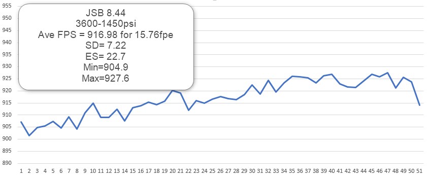

Really early in the review I noted that I wanted to do final chronograph results. Here they are. These are taken from the regulator pretty broken in, about 2500 pellets through the gun now.
Remember that I've got the graduations on the vertical axis split into 5fps segments. That results in a jagged line that seems to be less consistent than it really it.
Since the JSB 10.34 turned out to be a really good pellet in the gun, I decided to run a string with them. I don't have an initial full chrono string with these pellets.
Since I was shooting the pellets anyway, I thought it would be a fun experiment to hold on the same POI at 53 yards for the whole string. As normal, I had some wind, but this is the above string, plus the extra shots that were taken when the gun was off the reg.
I also did a full string with the JSB 8.44, and I've got new gun vs broken in gun chrono strings. This first one is from when the gun was new, it's also back in the beginning of the review but it's easier to compare when they're both on the same page.
New gun:
Now (2500 pellets through it):
There were 4 error-reading shots here, sprinkled throughout the string,
I also shot the whole string of this final chrono at the same aim point at 53 yards. Here is what that looks like.
Thoughts:
The SD and ES are really about the same. If I was to get crazy with the stats and figure out P values and use the common alpha of 0.05, it would calculate out to be NOT statistically significant. In other words, the difference's seen in the SD and ES are more than likely due to factors other than the regulator (a couple low or high weight pellets in the group is just as likely to have bumped the SD slightly higher this time around).
So, the reg is pretty much performing like it did when new.
There is lot of discussion online about the BSA guns and the collective opinion about the NECESSITY of replacing the OEM reg with an aftermarket one. I disagree. For FT competition, the OEM reg is plenty consistent to win matches. That's good enough for me. If I owned this gun I would not replace the reg and I would not feel like I was at a disadvantage of any sort for leaving the OEM reg in there. The numbers don't lie, the OEM regulator produces sufficiently consistent fps when the gun is refilled right before dropping off the regulator (just a hair under 100 bar with this particular specimen.
The gun is generating a little less energy now than when it did when it was new. Possibly the hammer spring has gotten weaker, or the reg just settled into this fps output. Who knows, but interesting to see that that happened.
The little exercise of putting all the shots into one group was kinda cool. I think it is a great representation of what the gun can do, over an entire shot string. For the 10.34, throwing out the last couple off-the-reg shots, there are only 2 shots that the wind got a hold of enough to make the group not just a big 1.25ish inch group. Note the severity of the wind. Not bad at all. For the 8.44, the wind obviously took more of them for a ride than it did the 10.34. Really, this is an awesome visual of why you see more shooters using 10.34gr pellets for FT competition than the 8.44 (less wind drift), at least in the 20fpe classes.

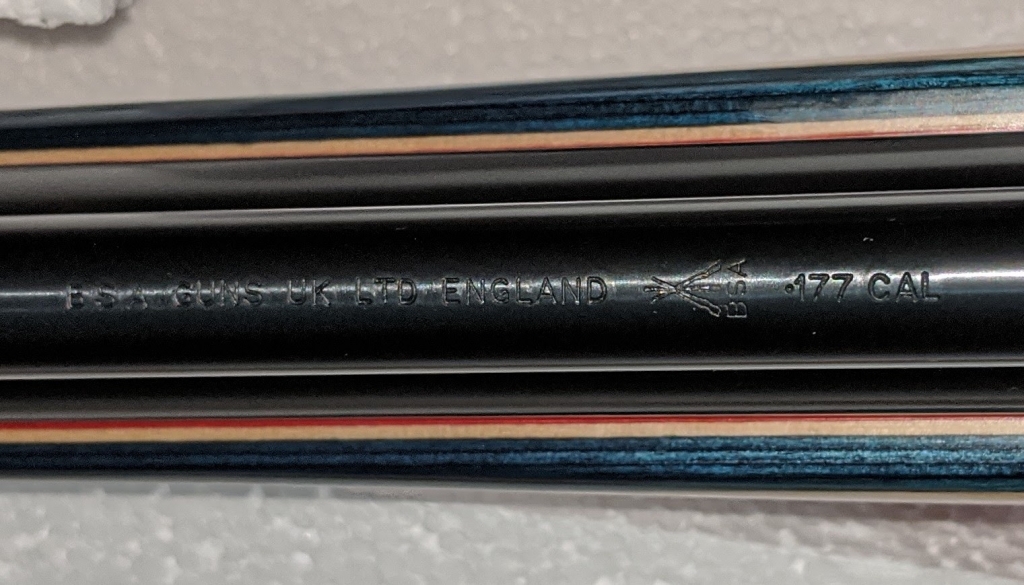

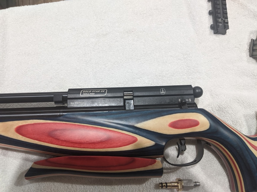

Here she is! Just picked it up today and spent some time with it after the kids went to bed. I have yet to shoot a pellet, mostly just was getting familiar with it, scoped and stock adjusted to my liking. So, this will mostly be a photo dump, with a few initial thoughts.
Disclaimer: this gun is on loan from Airguns of Arizona. I would like the thank them, publicly, for allowing me the chance to review and spend some time with this gun.

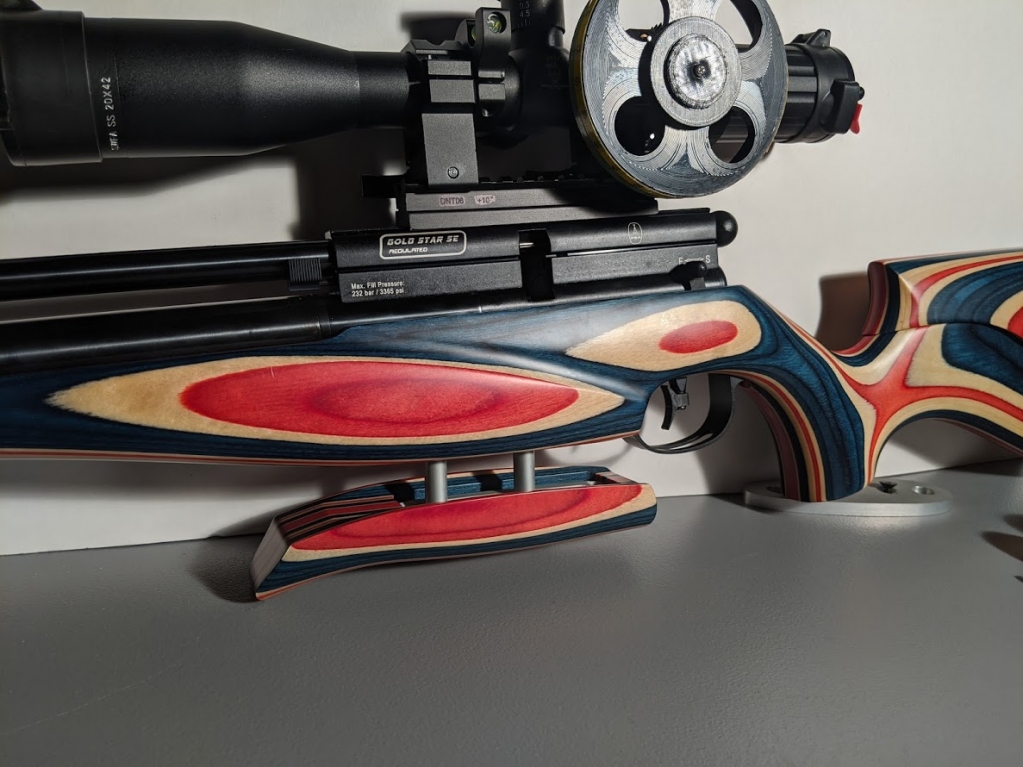

The air stripper has me intrigued. It has some set screws that allow the cone to be moved in and out to optimize accuracy. That could lead to some interesting testing, if it is quiet enough for my yard without a moderator. The whole thing unscrews to reveal standard 1/2-20 threads otherwise.View attachment 84290View attachment 84294 I like that the gauge is gun-specific. The manual said the gun is to be filled to 232 bar, and the gauge matches, anything over 232 is RED. Convenient. (a little styrofoam dust on the top of the tube here)
The breech seems pretty solid. The section of dovetail that bridges the gap for the magazine has got to help with stability. There is also 3.125 inches of barrel in that thick, beefy breech, and the barrel diameter is decent. All of those details should help with consistency in POI from day to day. There is a small cut-out on the top of the breech in the front half where I can see the barrel nestled securely inside. While I prefer a picatinny rail, it's not too hard to simply attach a conversion rail.

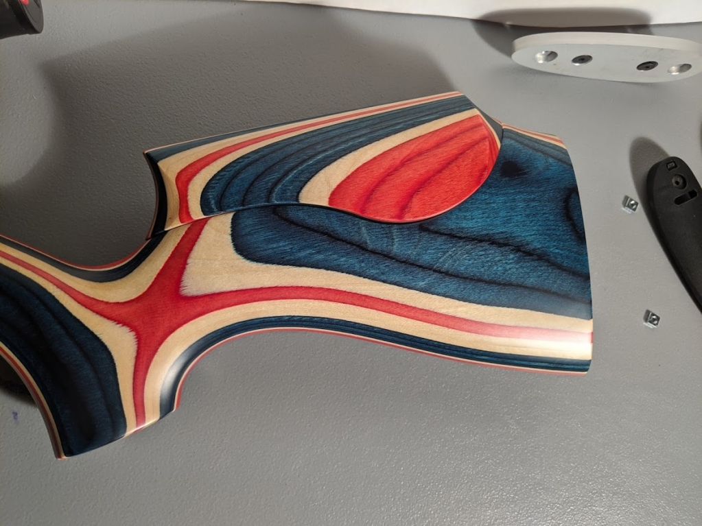

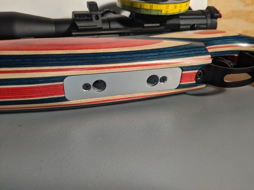

The stock is just a thing of beauty. I'm a sucker for laminate stocks. The colors on this one are quite vibrant. Yes, scope height is pretty high. I've been noticing a kinked neck the day after a lot of shooting, and also read somewhere recently that really high scope height can help with the amount of holdover needed for really close shots. Either way, fun to experiment.
Check out the depth in the dark blue in this pic.View attachment 84319

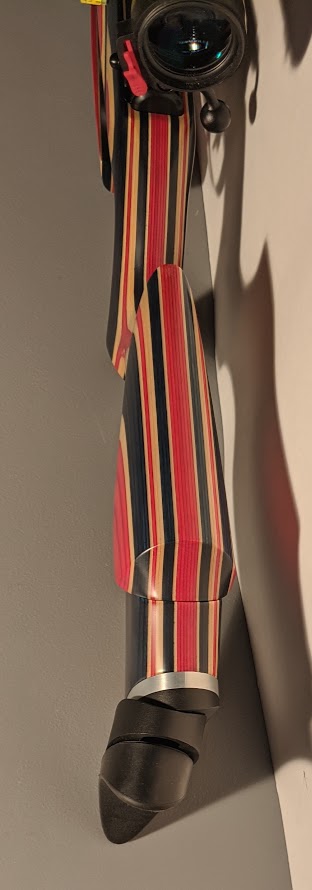

I read somewhere once that a good initial indicator of the quality of a gun is how the metal and wood come together. Gaps, and either the wood or metal being "proud" indicate low quality, supposedly. I'm not seeing either of that here. Take a look at the inletting for the stock adjustments, dang precise.
View attachment 84321View attachment 84327View attachment 84335

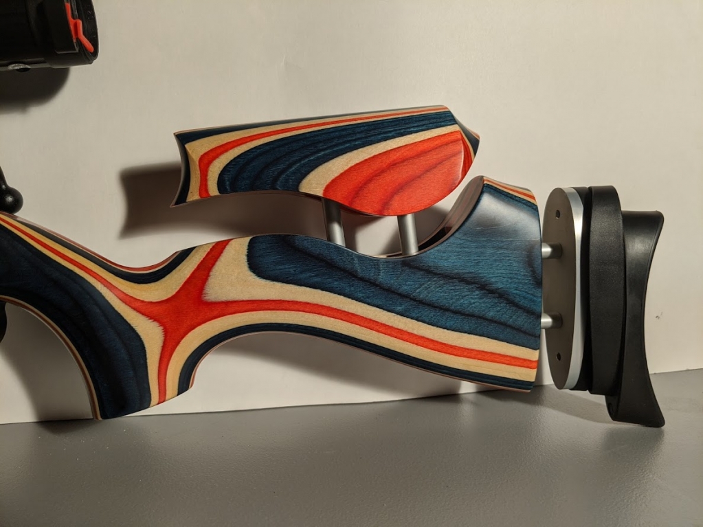

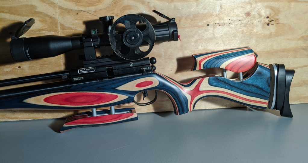

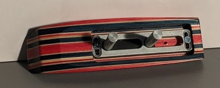

Hamster/knee riser can be removed for full-on sporter configuration. View attachment 84338
Gotta love a Minelli stock. View attachment 84344

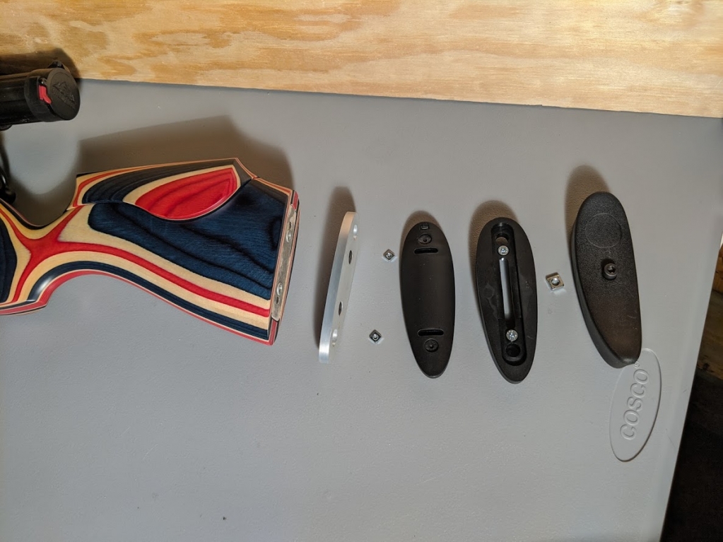

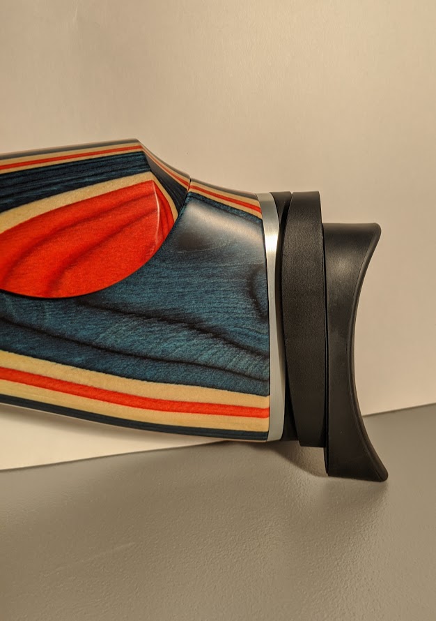

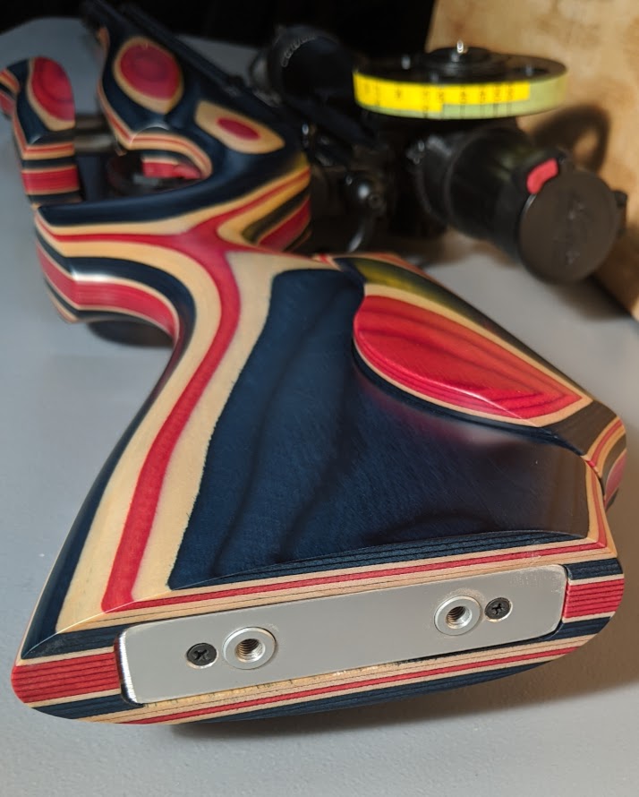

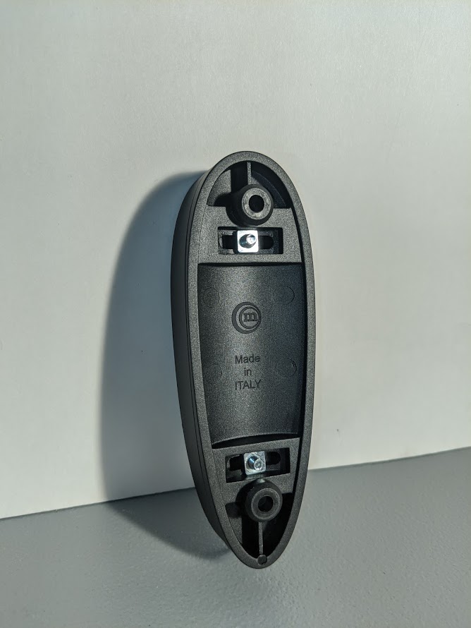

I'm pretty impressed with the buttplate, and the adjustment that can be made. Length of pull, cant, height, are all available to adjust.View attachment 84351View attachment 84358View attachment 84362View attachment 84369
This configuration feels pretty nice and will be my starting point. View attachment 84375

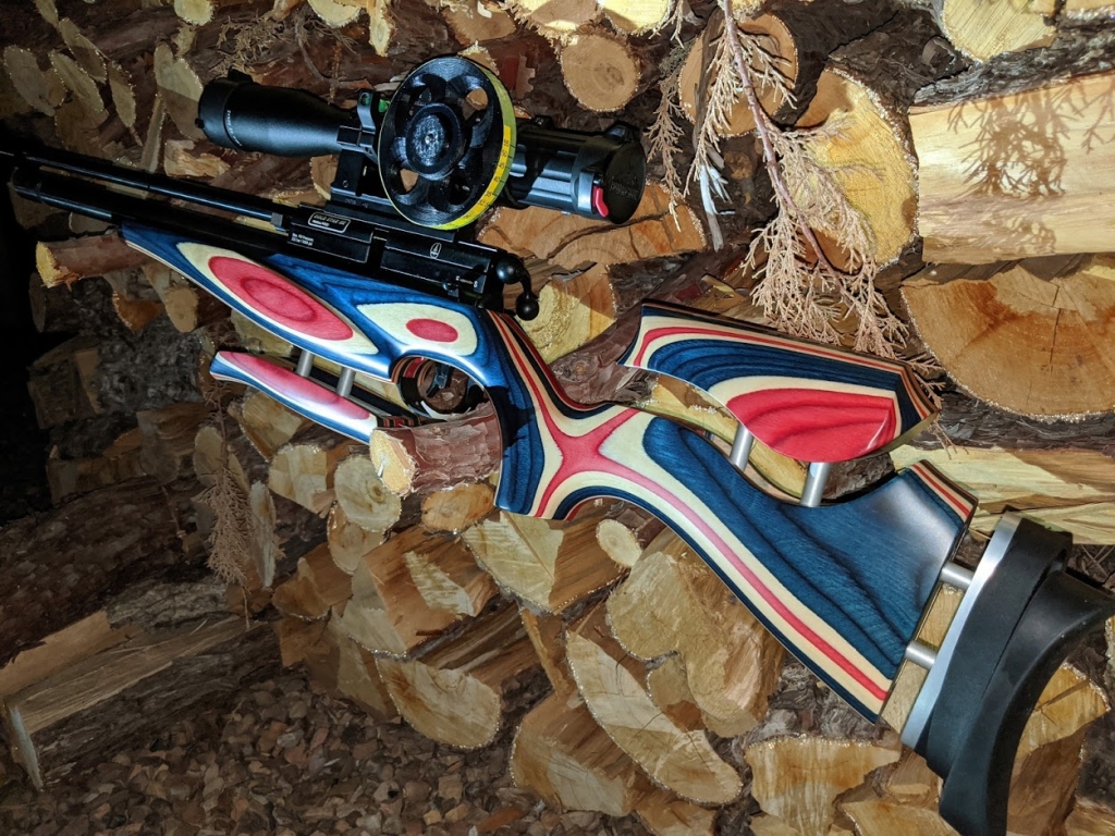

Oh yeah, pretty gun!View attachment 84386

I mounted a new hawke 4-16x50 with eagle vision sidemount infinity rings on it today and it zeroed in 2 shots at 25 yards so you may be right! It’s been tuned with jsb 10.34’s and has a huma reg in it and the huma shroud.
It’s a shooter for sure!!! The Hawke wheel was small enough to accommodate the left side single shot loader.
