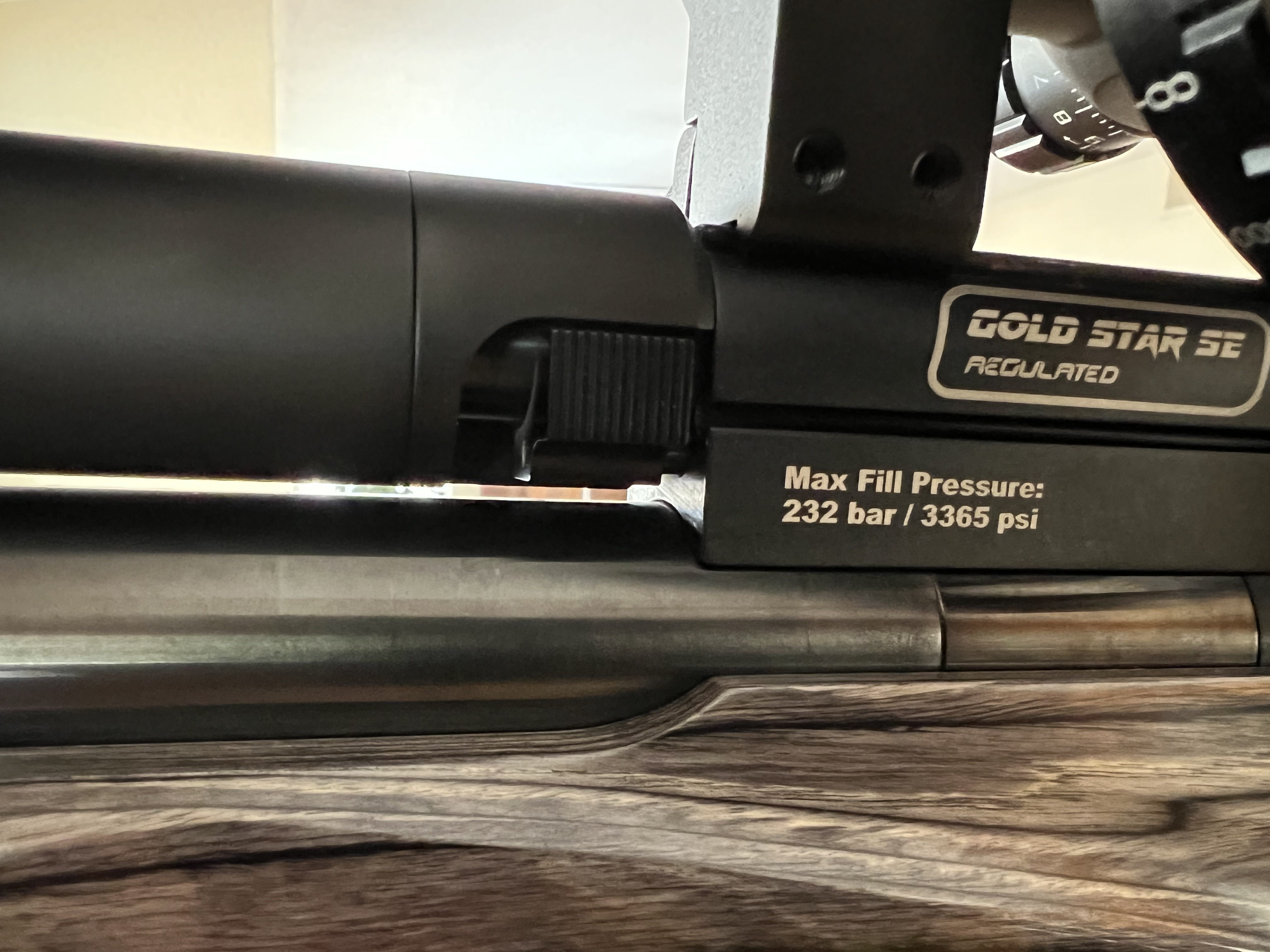

Not sure if there's a reg on those. The typical SE or Ultra has no reg. They are not easy to work on IMO and I've done a ton of work on them.

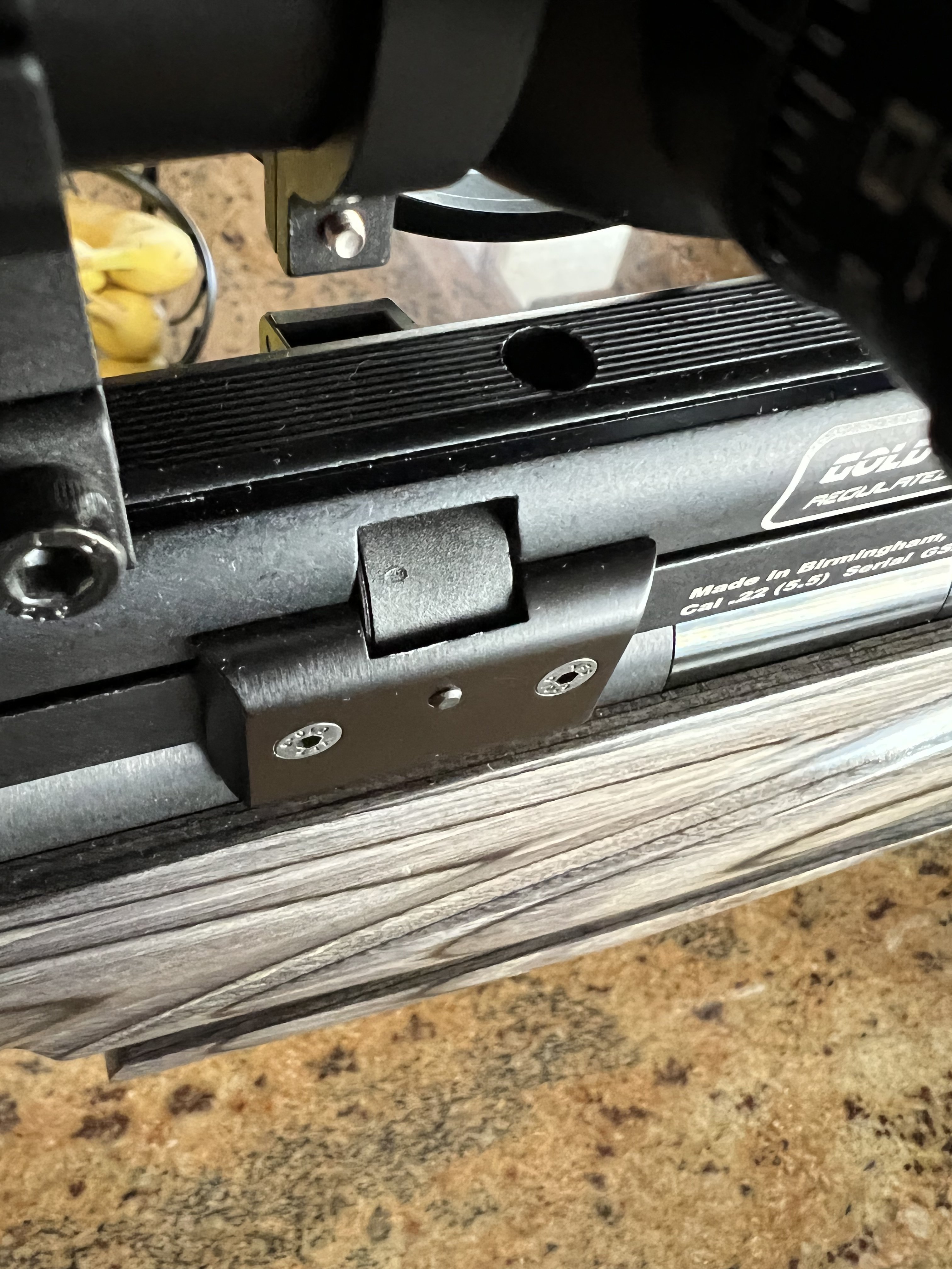

I think the hidden bolt you are mentioning is under this front hole. There is a plastic collar that slides back revealing the bolt.
Also, don’t try and force, pull the transfer port out. It is held in by the mag release.
I love the bsa guns but they are not the most straight forward design. Once you know them they are easy.
