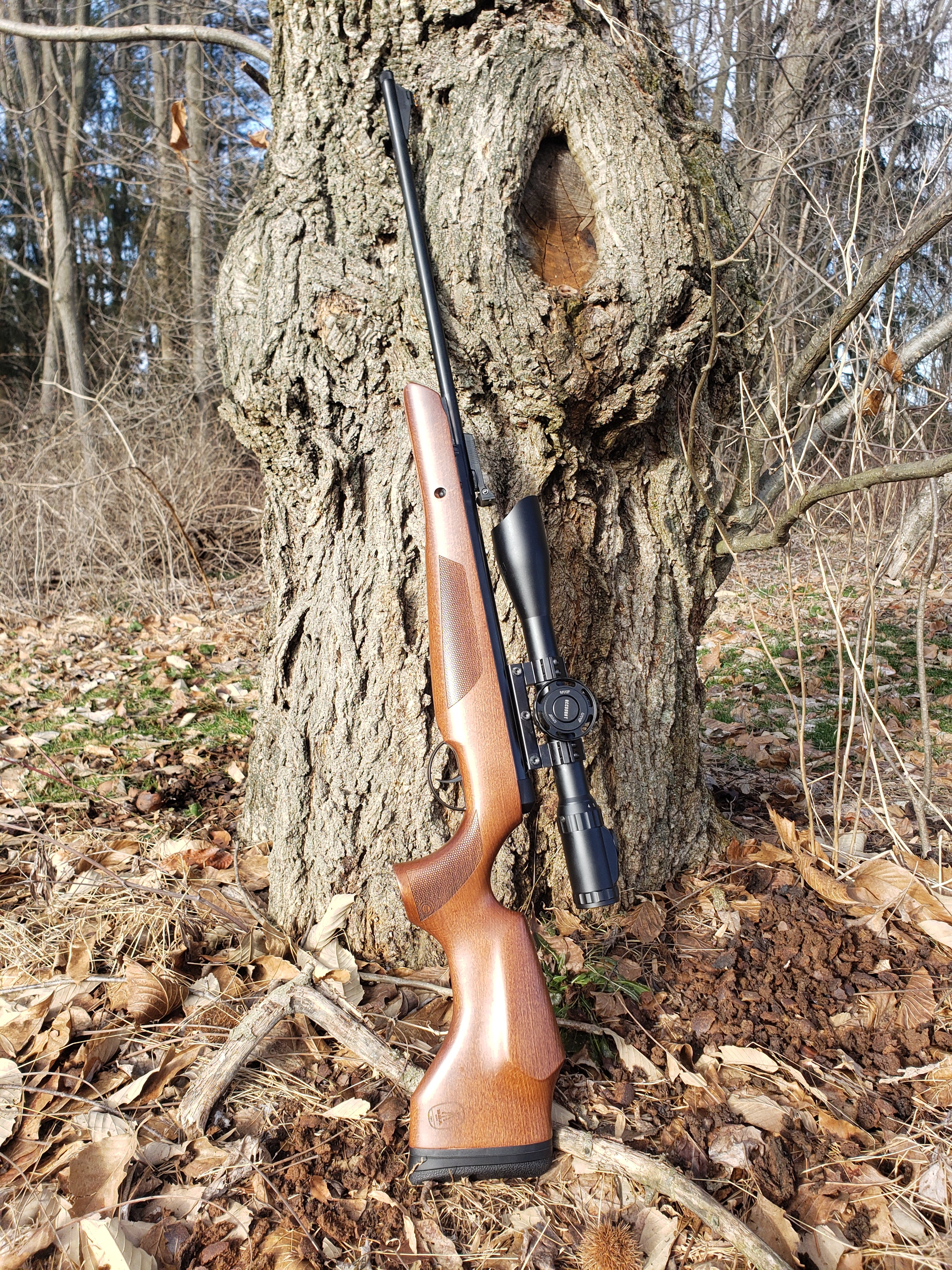

Got my .177 Meteor Super in this morning and have about 50 shots through it. I can't imagine anything is going to change so here are my unasked for thoughts and opinions on this gun.

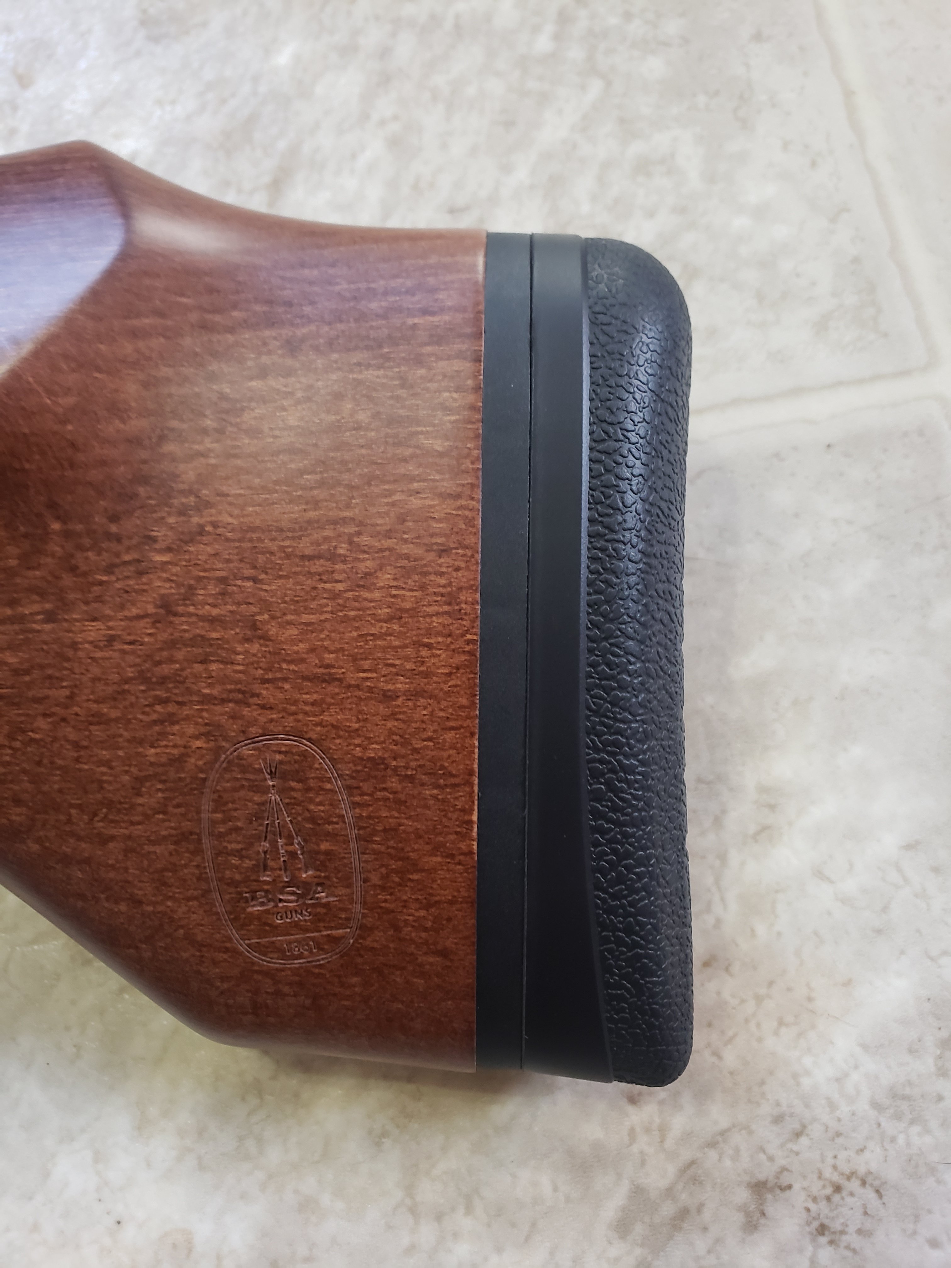

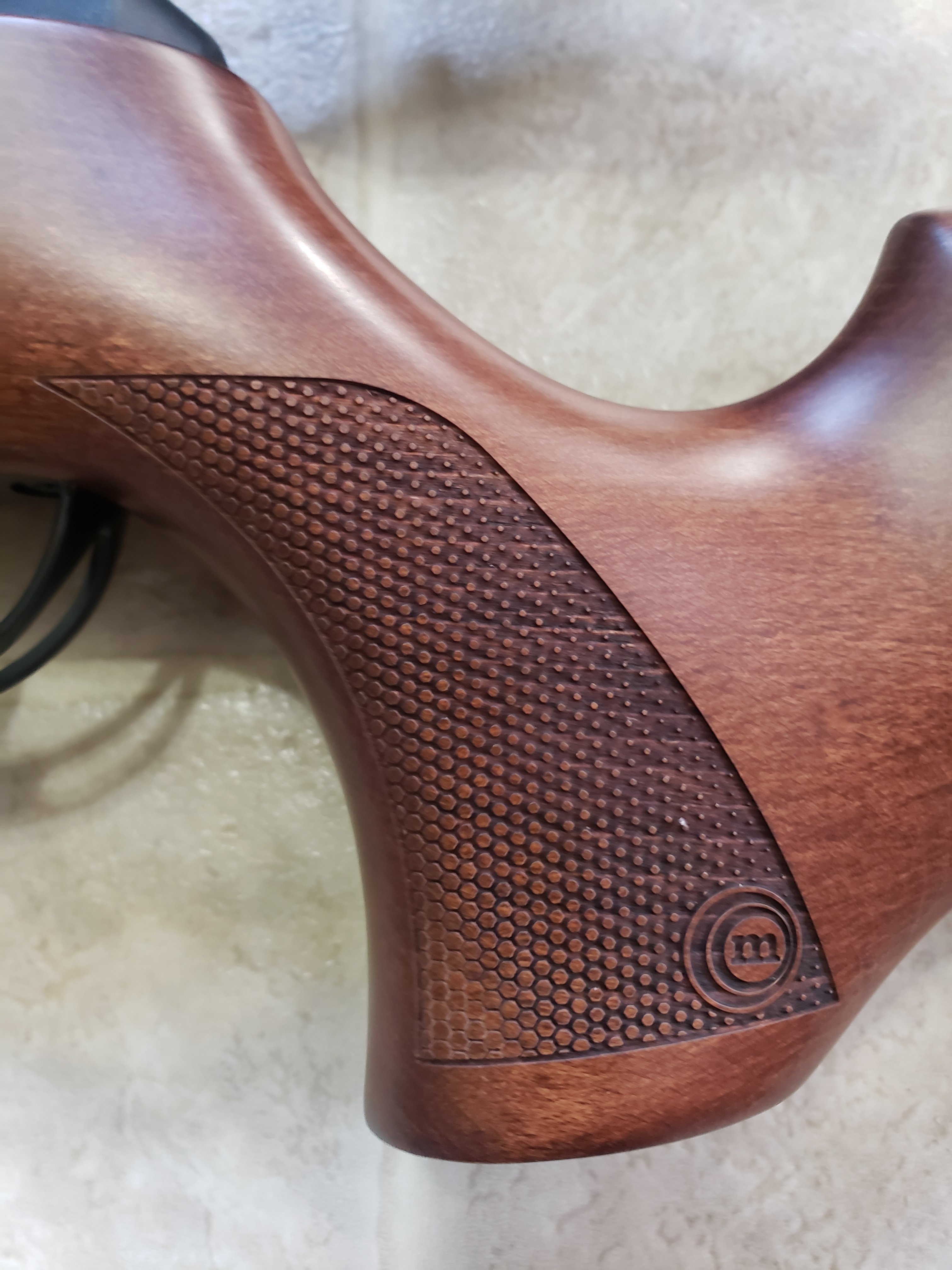

Stock: Looks darn good but that comb just isn't great for iron use. I had to crane my neck forward and down to get a decent sight picture. For scope use though it is fantastic. My head falls right into place and I'm ready to go instantly. Zero complaints in that department. The butt pad is soft and grips my shoulder well. If really does feel great to shoulder this gun.

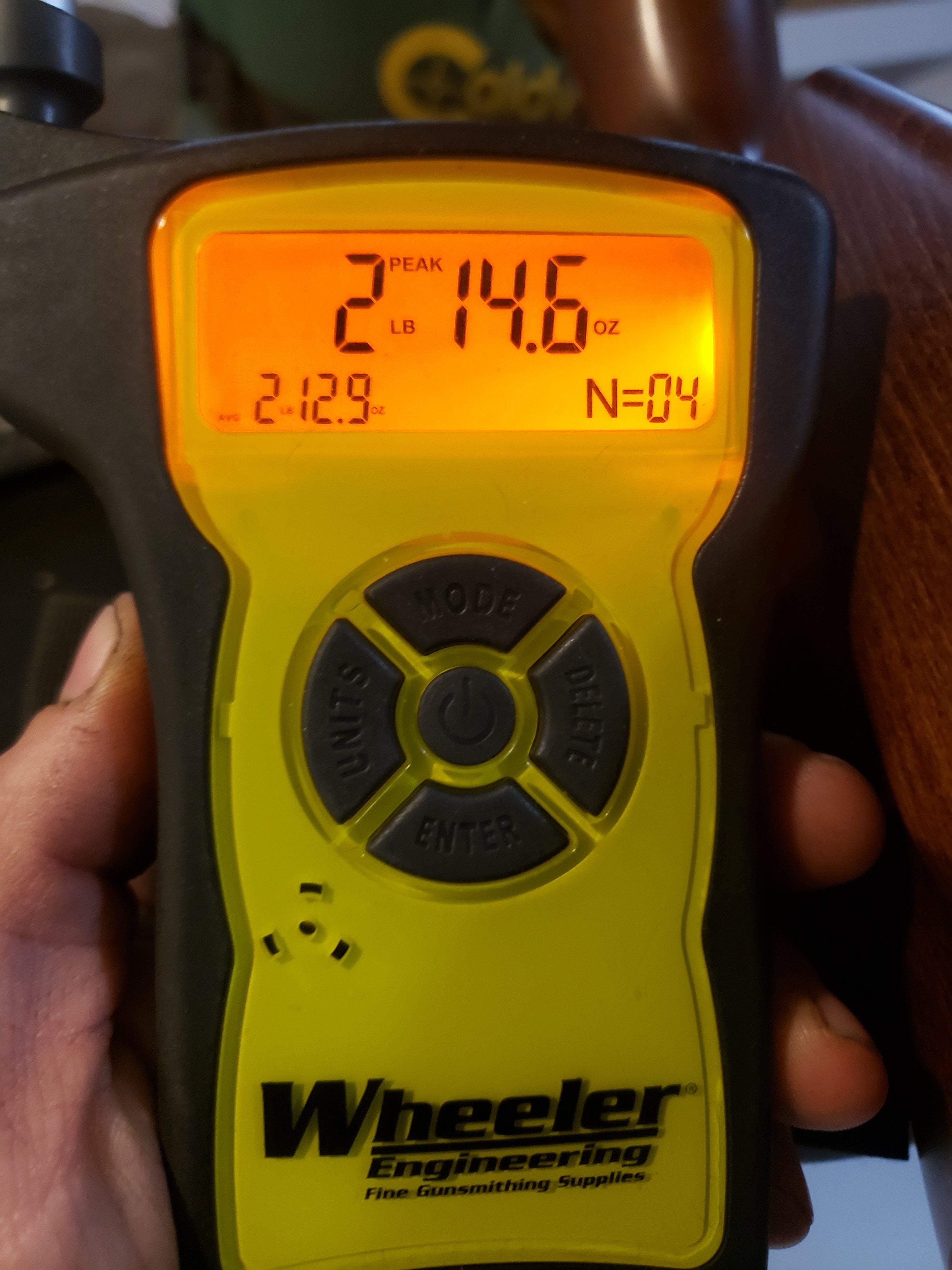

Trigger: Suprisingly not terrible. I do want to say I like it better than the Terrus trigger but I need time with it still. Its absolutely no Rekord but I don't think anyone was expecting it to be. I didn't use a scale but I'll put it somewhere around 3lbs. There is a very light "first stage" take up followed by a solid wall. Theres a bit of creep before tripping but it really isn't terrible. Its a hunting trigger through and through but nothing to write home about.
EDIT: NOTES TO ADD TO TRIGGER PULL
Trigger pull weights (5 pulls):
2lbs 11.5oz
2lbs 14.2oz
2lbs 13.8oz
2lbs 12.4oz
2lbs 14.6oz
Trigger pull weight is on the heavier side but it is pretty consistent which I am happy about. Like I stated before, it is certainly no Rekord but still plenty usable.

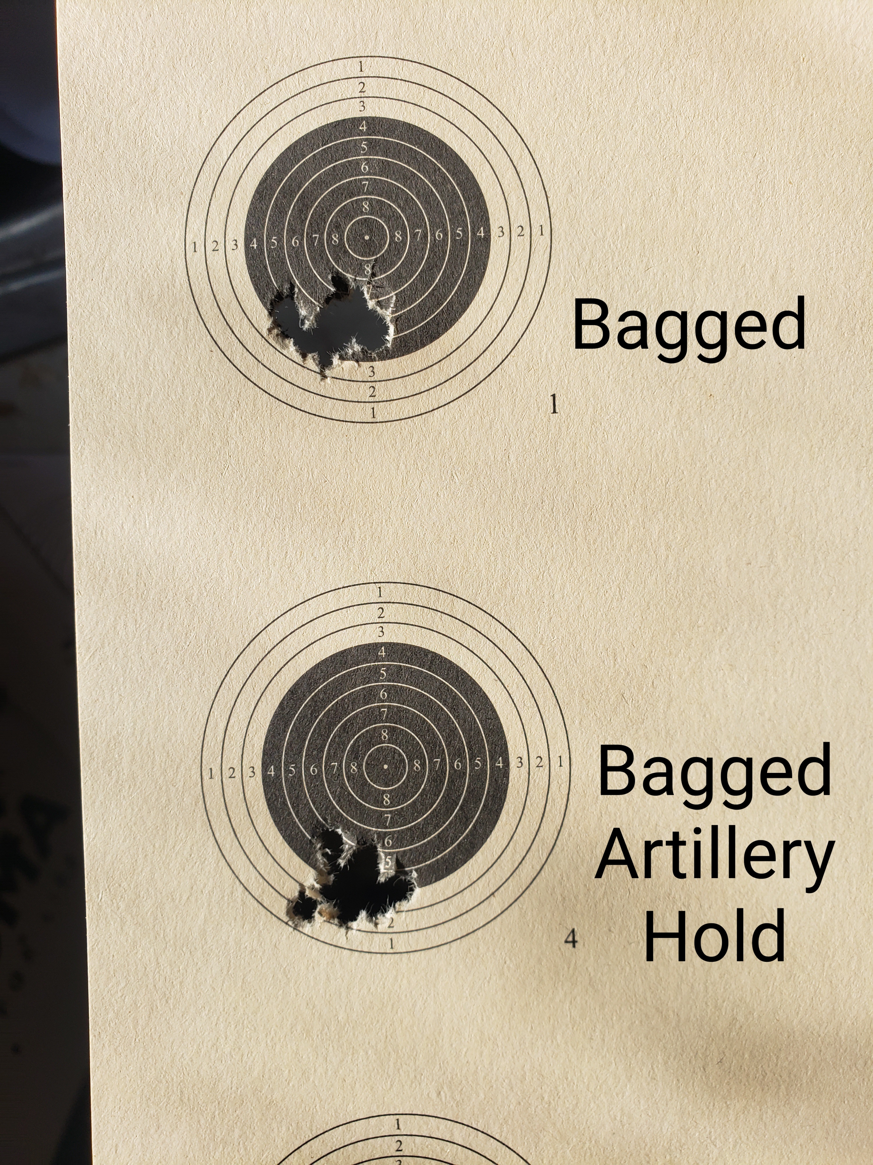

Shot Cycle and Recoil: Its quick but the recoil is fairly tame. I dont hate it at all but time will tell here too. I did find the gun to be a tad jumpy but getting my hand between the gun and front bag completely fixed that issue. Suprisingly the jumpiness didn't affect the group sized too much.

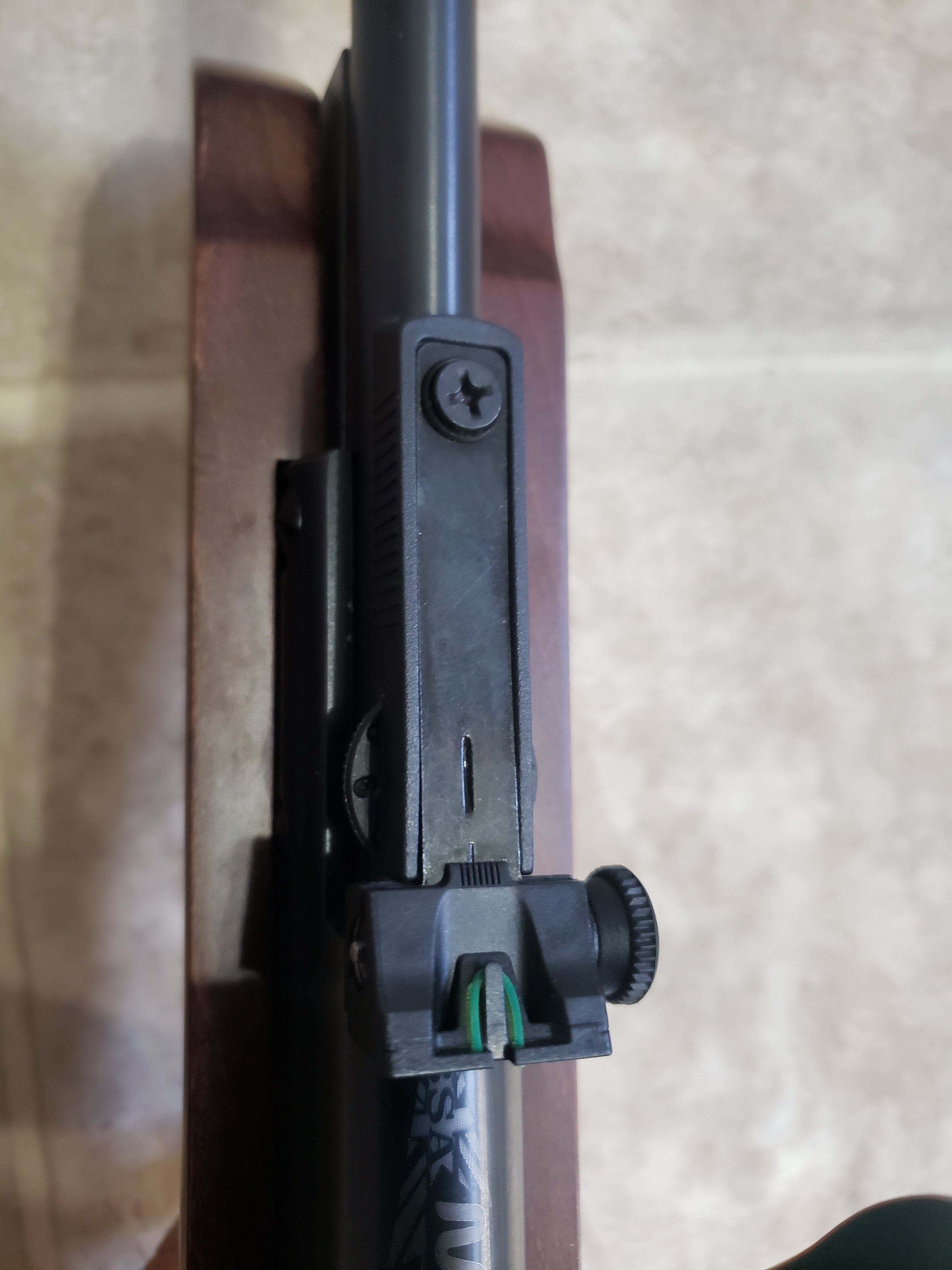

Iron sights, trigger and safely are all a big turn off. They are incredibly cheap plastic which have no place on a gun with a $350 ($499 retail?) price tag. The rear sight is held on by a Phillips head screw. I don't know about any of you guys but I hate Phillips head screws. They just scream "good enough" and "costs were cut" when I see them on a gun.

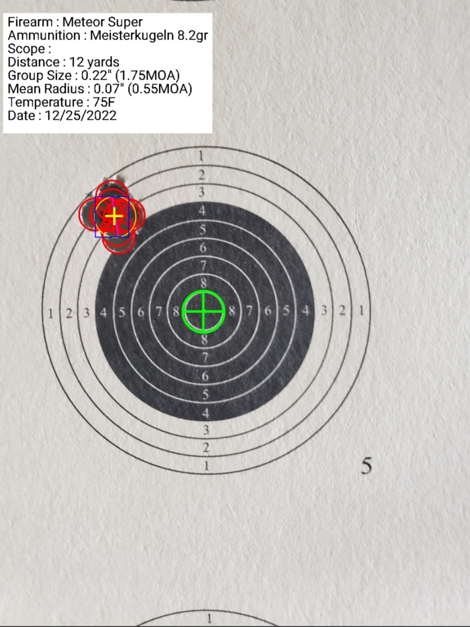

Accuracy: I am happy with the accuracy so far. I did not shoot this gun a whole lot but I did put 20 shots on paper at 12yds (10 per group) to see where the gun stands. I used a few different holds through this process and did not find the gun to be particularly hold sensitive which is fantastic on a gun I plan to use for small pests. I fully expect these groups to improve with time as there was a very distinct smell of dieseling throughout the whole process.
Accuracy Update: 10 Shots using 8.2gr Meisterkugeln @ 12yds. These appear to be the clear winner as of now. Hoping the wind dies down soon to see what the gun can do at a more appropriate 30m

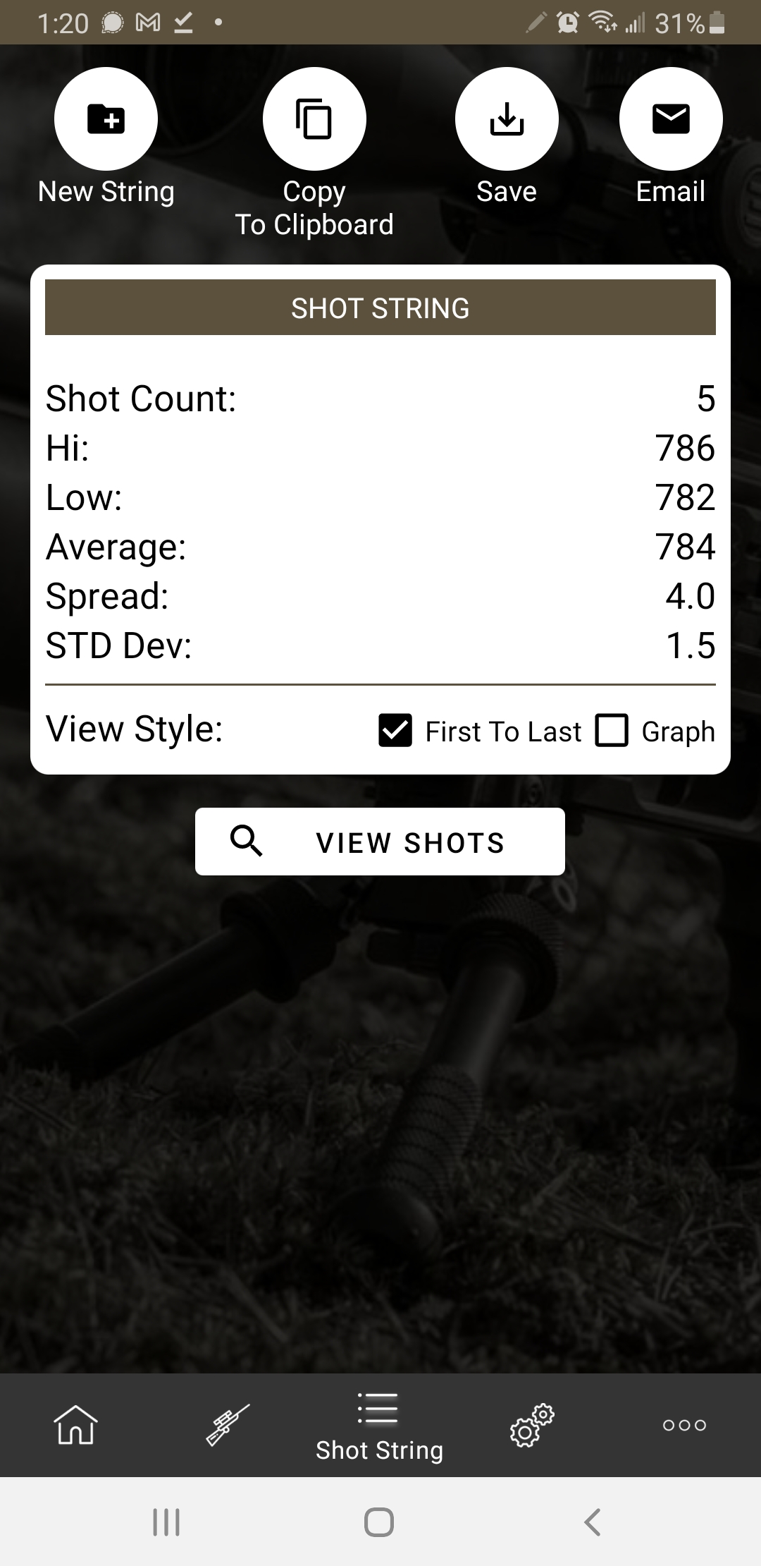

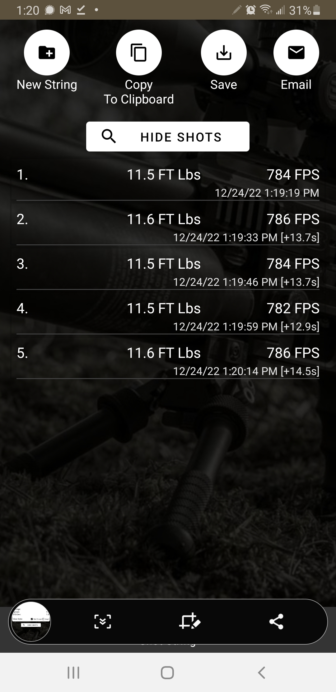

Velocity: 5 shots over the chrono (will test more) show very consistent readings with JSB 8.44gr. ES of 4fps with a SD of 1.5fps. Two thumbs up if that remains consistent. I'll be very happy with 12 and 3 over a 20 shot string though.

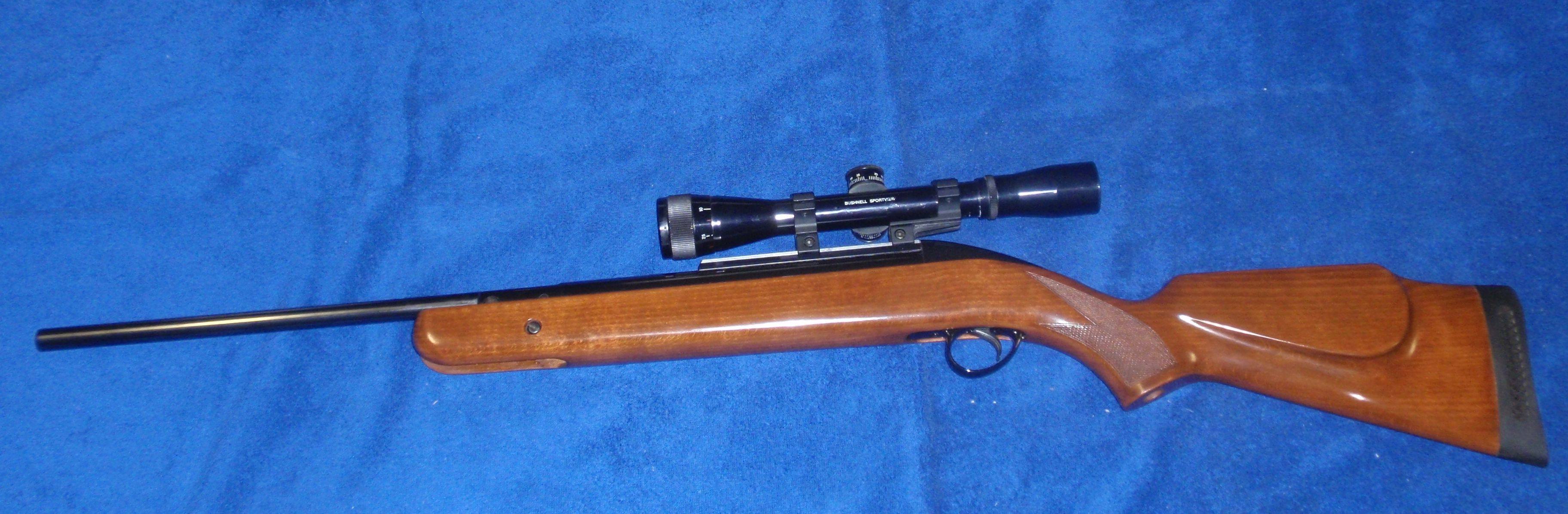

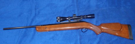

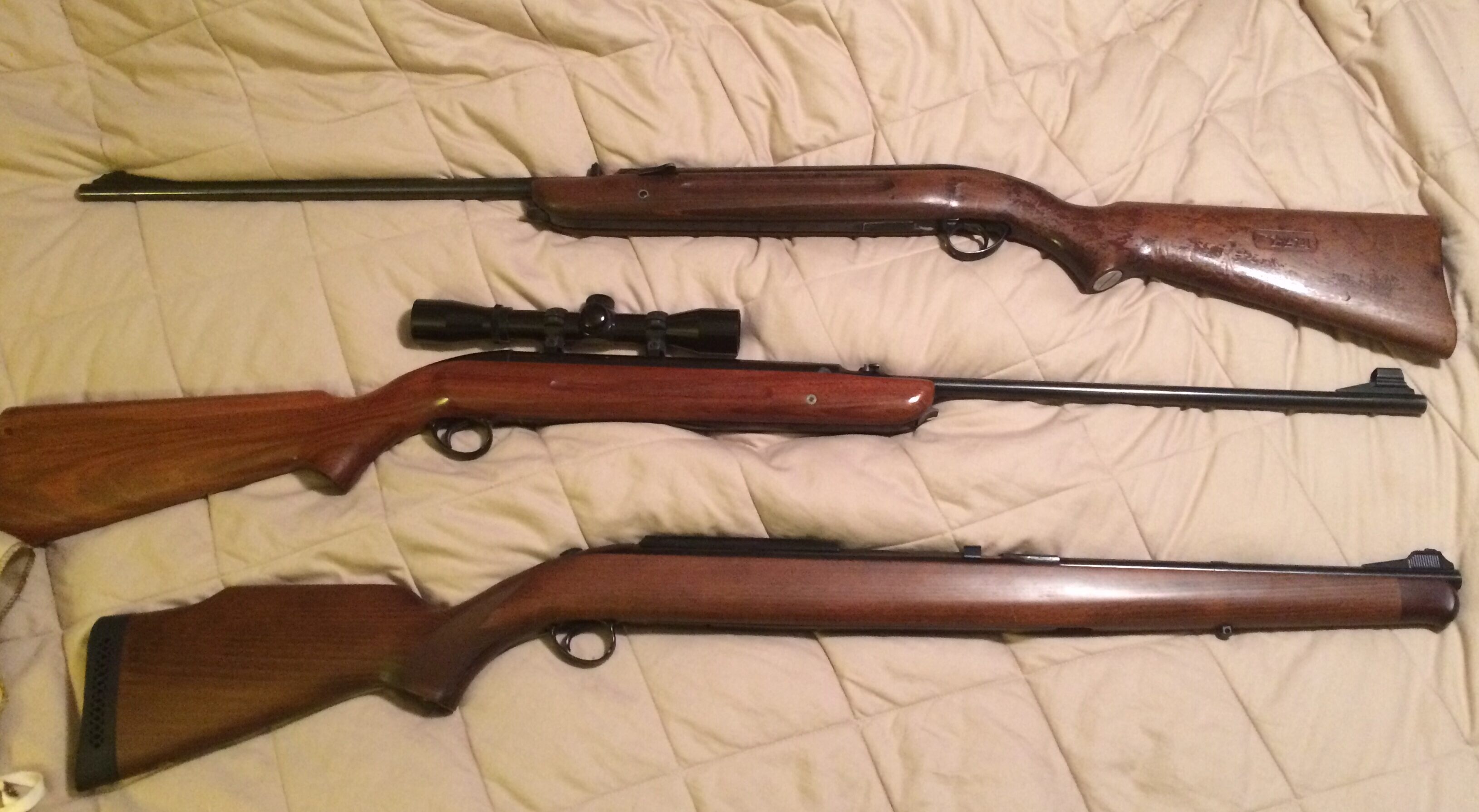

Looks like a half decent gun. Can the trigger be adjusted at all? Doesn't come with twang as the only available option from the factory. But I'm not a fan of artsy stocks. BSA offered more traditional styling that I like.
View attachment 316688View attachment 316689View attachment 316690

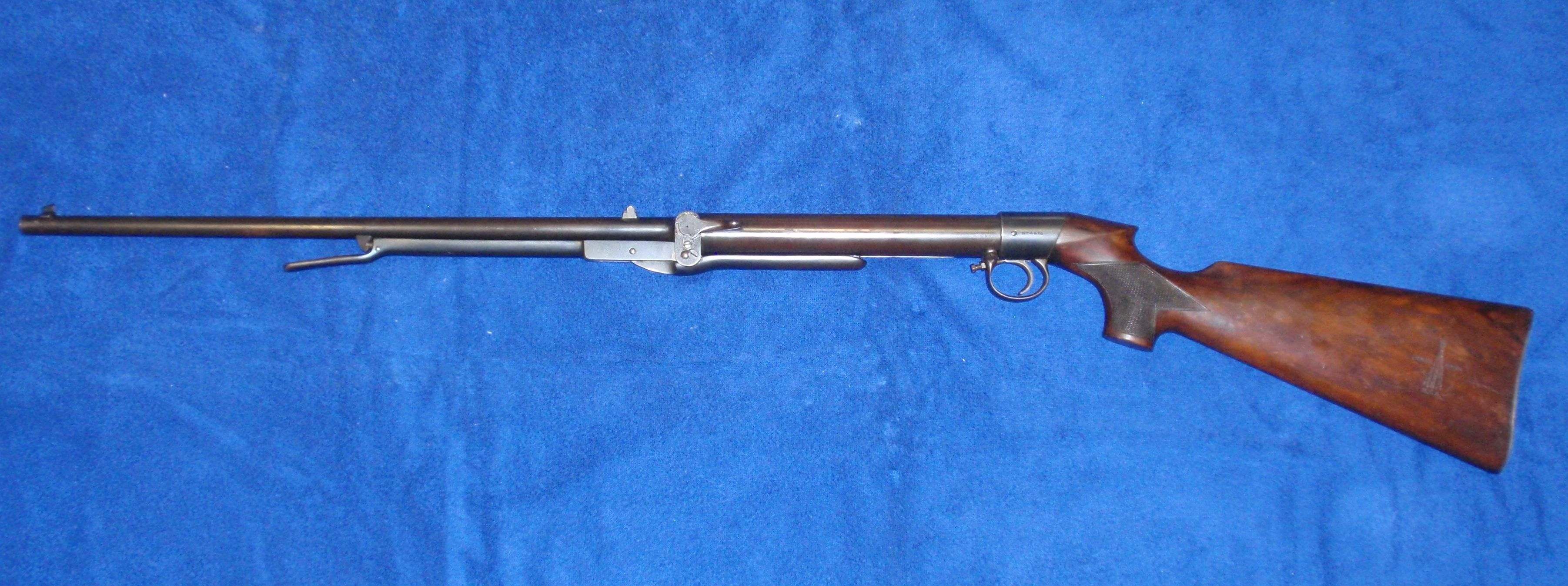

I don't think this was traditional in 1905 though. (1906 model shown "BSA Air Rifle")

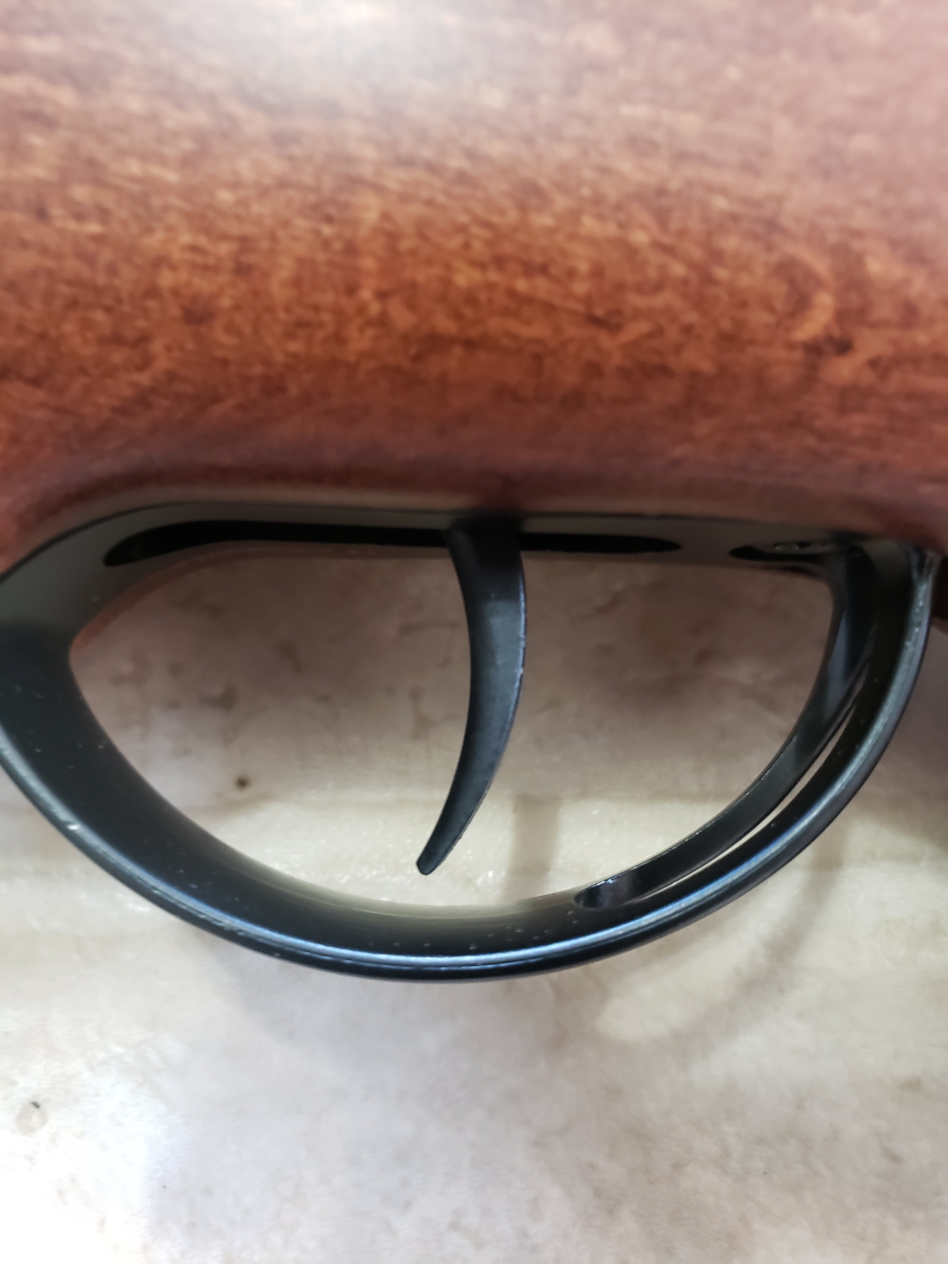

As far as trigger adjustment goes, yes and no? There is a screw behind the trigger blade that seems to shorten the first stage quite a bit but even after several turns outward the trigger pull remains at 2lbs 10oz +/- a couple ounces. It makes the trigger also feel a bit mushier more than anything else.

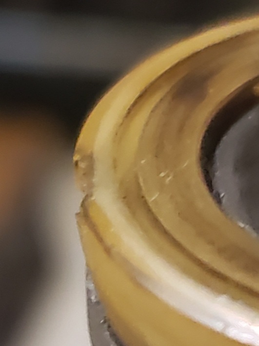

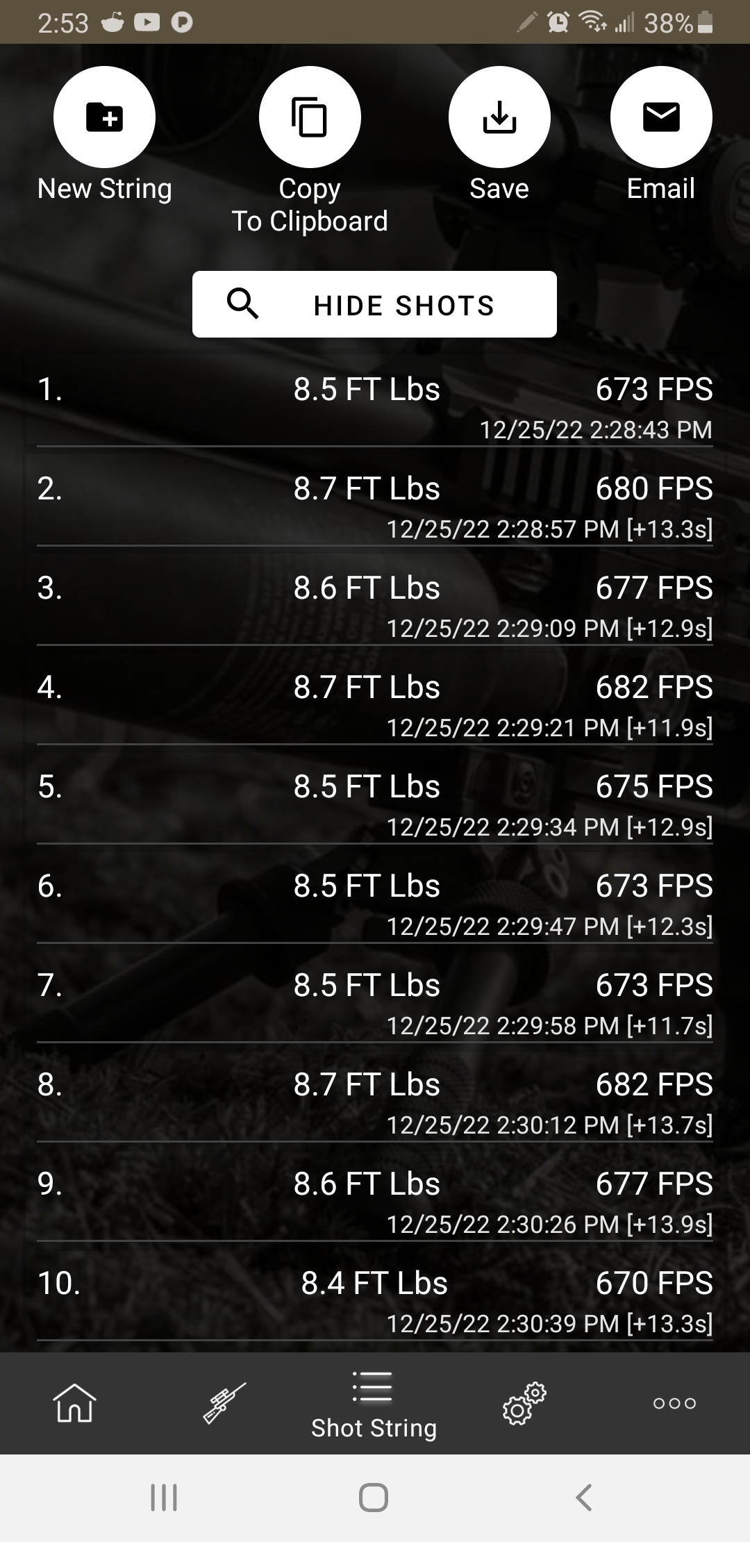

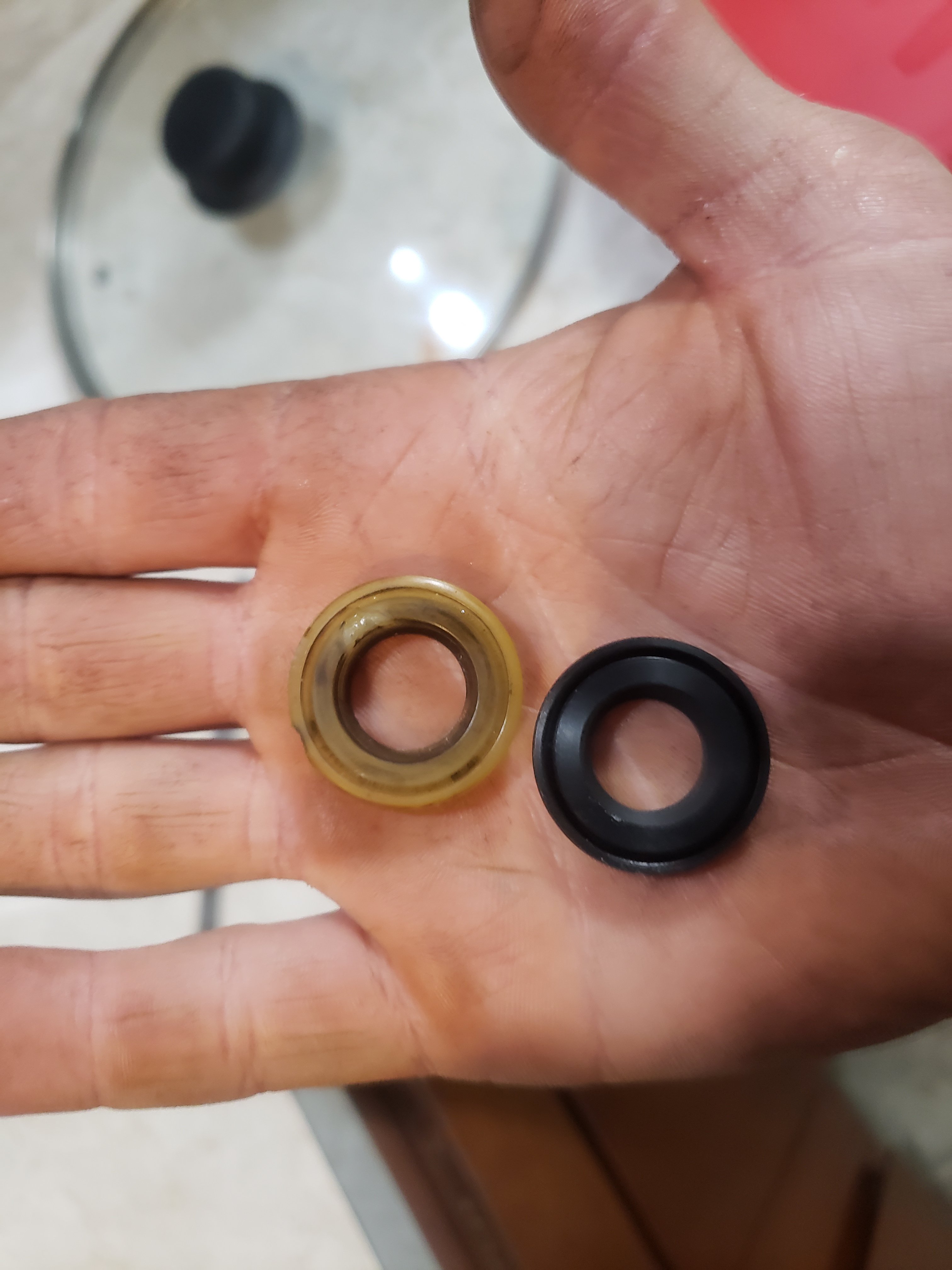

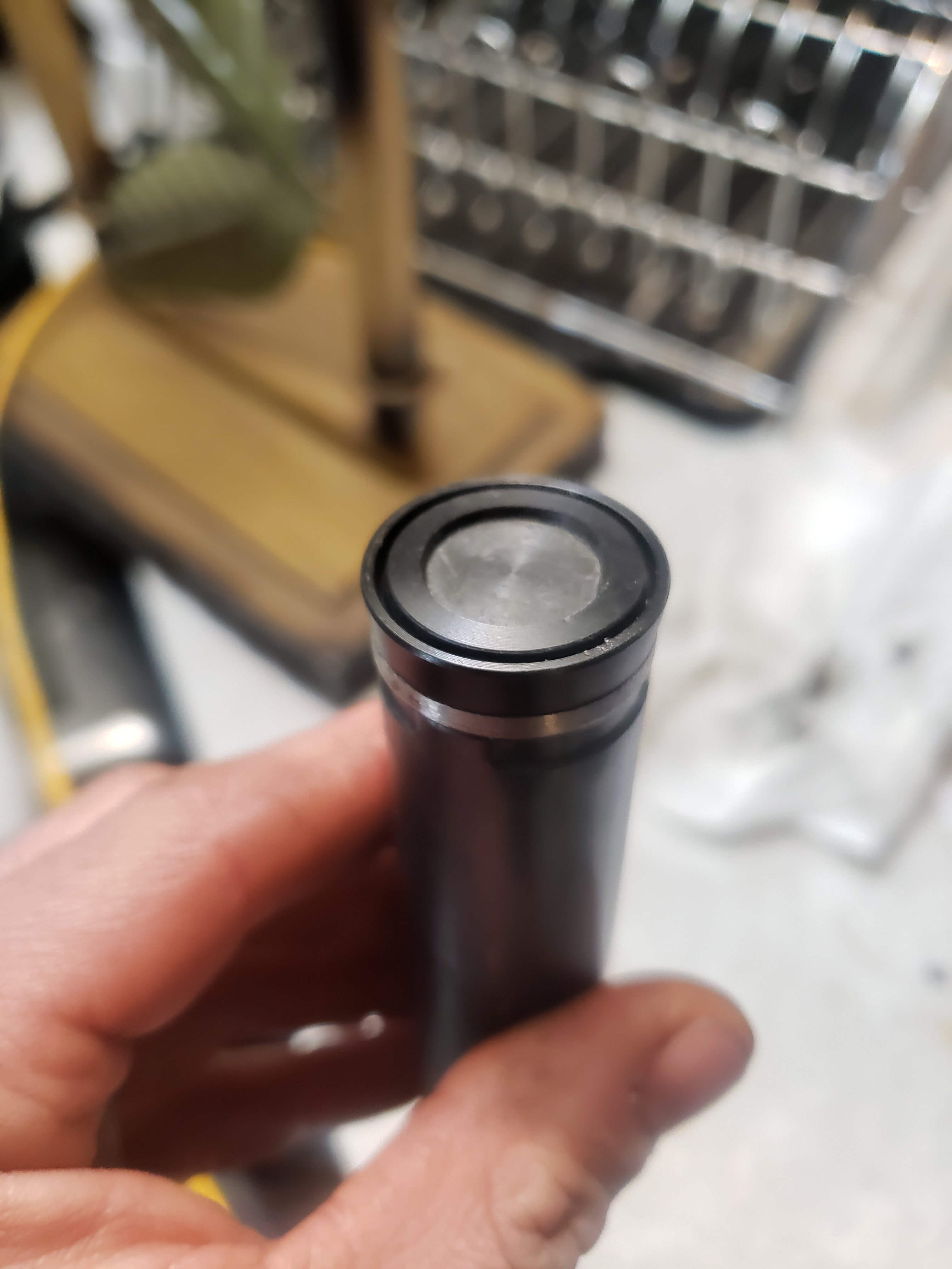

1 full tin in. Still smoking (actually got worse) and then the groups started opening up. It keeps bouncing between shotgun and tight groups at 12yds. Im assuming factory lube keeps slipping past the seal.
Here's the issue though... she's also down 40% of her previous muzzle energy. It passes a tissue test so I'm fairly certain either the piston seal is melted (likely?) or the piston is starting to go already. I'm going to keep shooting and contact AoA on Monday or Tuesday.
