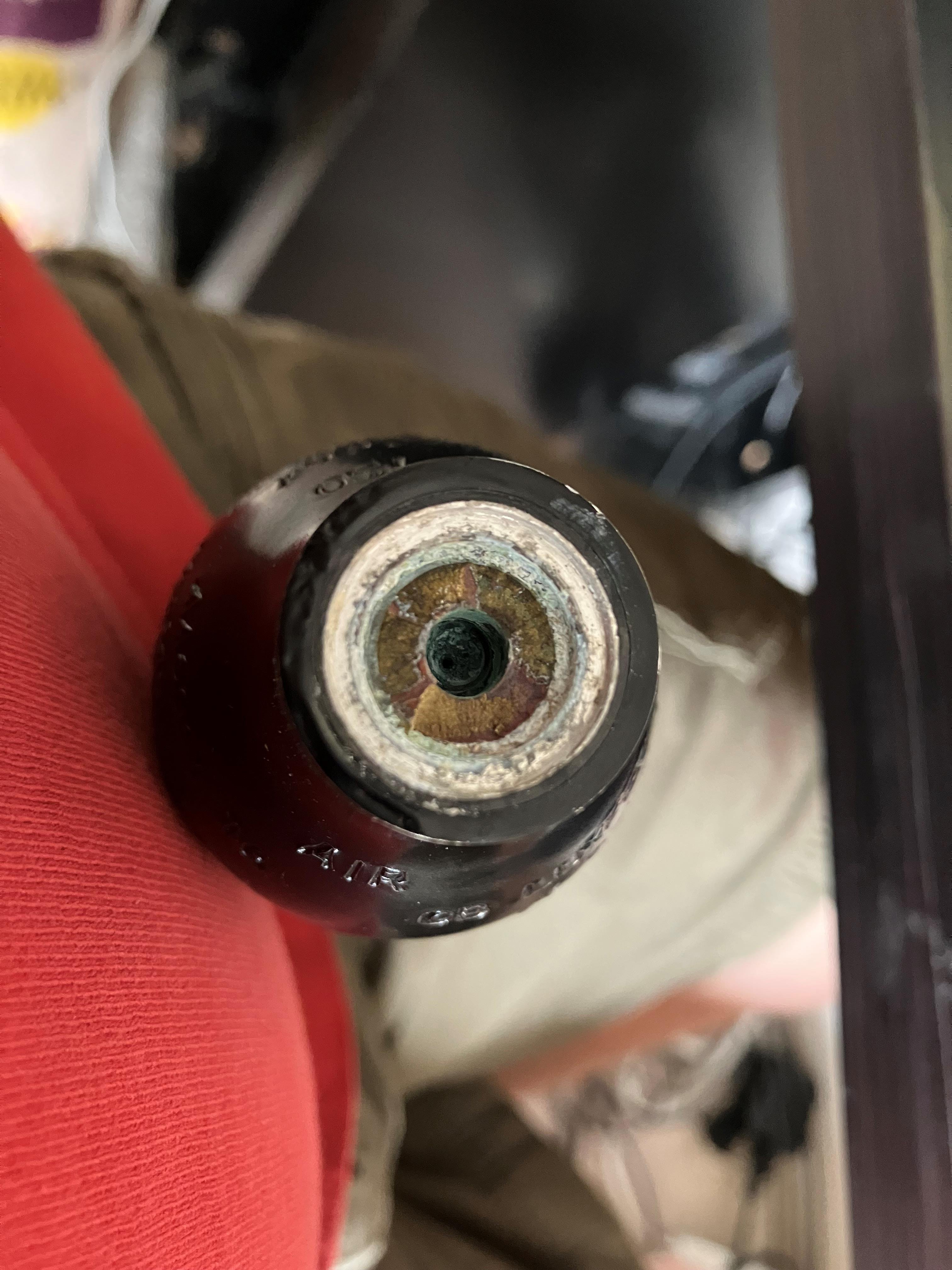

Took off the stock and noticed the buddy bottle was loose, so I tried to unscrew it and lone behold ... it crumbled off the gun?
Apparently, the connection piece between the bottle/gun atrophied and the bottle crumbled off as I unscrewed it?
Hopefully, I can get the broken connecting part out of each ..... regulator section and bottle?

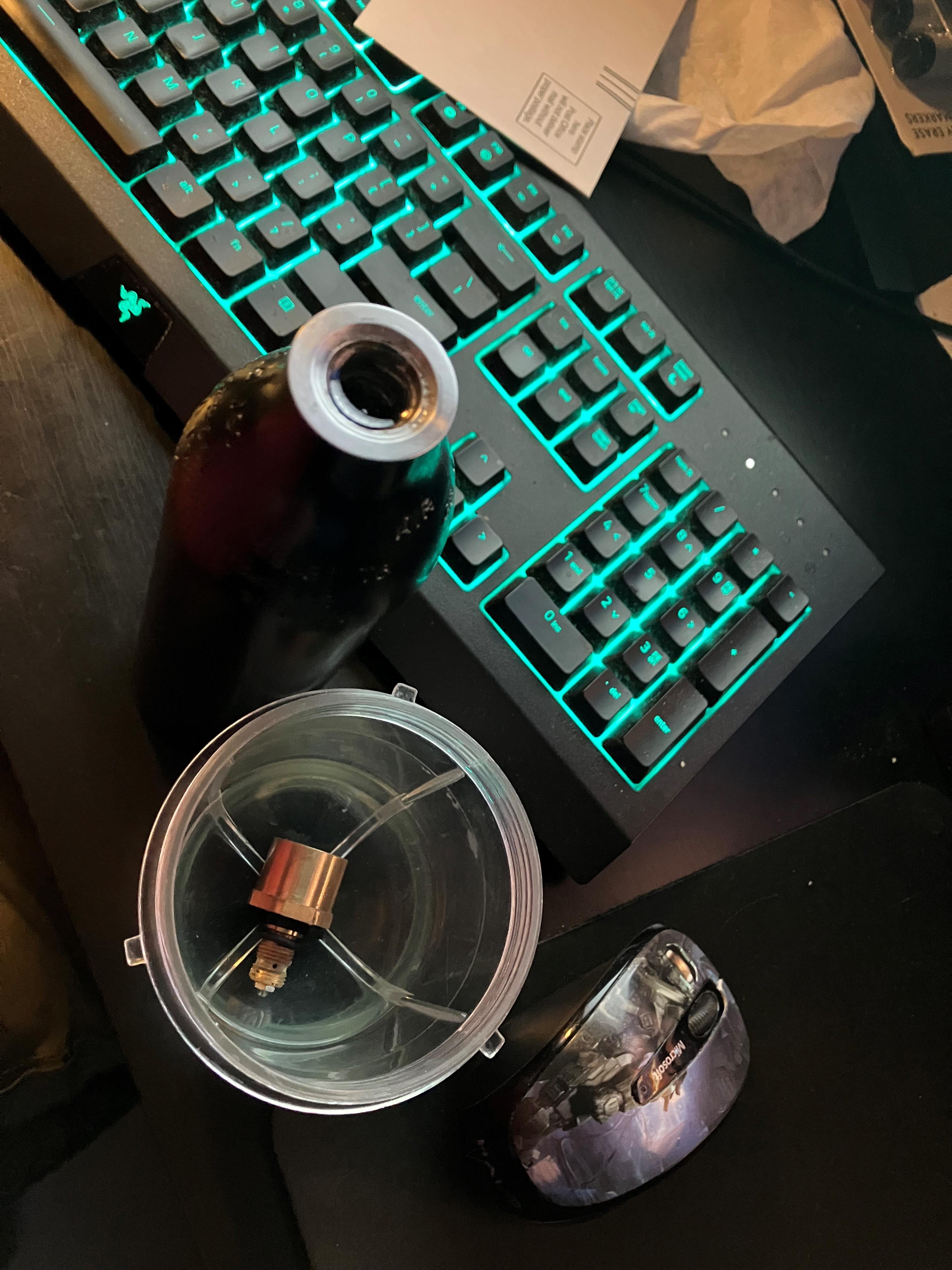

I was able to remove broken, bottle neck from the buddy bottle by Dremeling two slots into it. Used a flat screwdriver in slot, then unscrewed with a crescent wrench torquing my screwdriver. Easy peasy with a little penetrating oil.
Filled bottle/soaking other brass piece in Vinegar overnight. Everything looks fine otherwise.
Condensation from hand pumping must have caused this as I otherwise keep all guns in Perfect condition. Unfortunately, I should have done some basic bottle maintenance years ago:p. Mostly my neglect, but I didn't think the 1/4" brass walls would've rotted/failed given excess moister.
Glad the bottle didn't fill today; that could've been a dangerous situation.
Lastly, everyone who hasn't serviced their bottle in the last few years ..... Please do so for your safety (y) .
