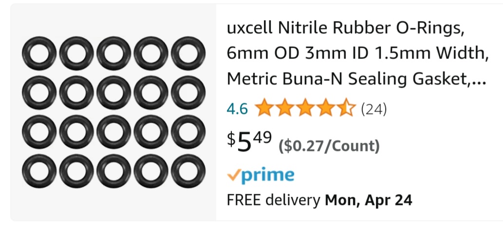

Good afternoon all, A family member has my old BSA R10 in .22 caliber and upon firing the bolt is being thrown open slightly. It appears to be back pressure doing this. There is an O-ring on the pellet probe that looks a little "choppy". This O-ring is clearly visible with the magazine removed and the bolt in the forward position right about where the center of the magazine would sit, as you close the bolt this O-ring then goes into and through the magazine. Can someone tell me what size this O-ring is and a source to get a couple. He really likes the gun and I want to keep his enthusiasm up with it being reliable. Thank You

I'm on a 6 hour ride to Rhode Island....
Got a bit of time so I looked it up.
Viton or Buna-N seem to be the better materials. I read that Buna has slightly better abrasion resistance.
The replacements that I got for my R-10 came in a rebuild kit from UK.
