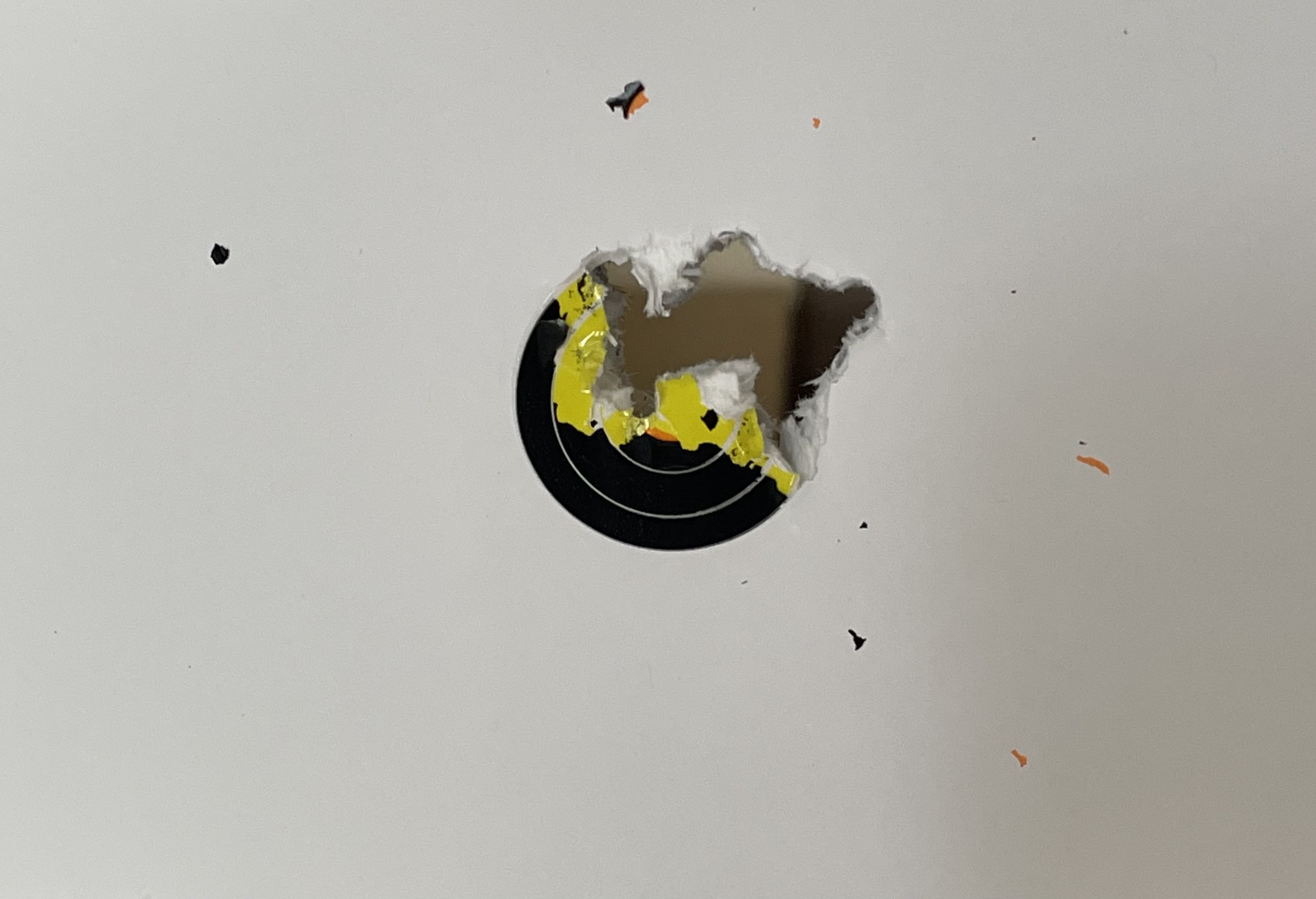

Attached is my group with 30 shots at 25 yards. The target dot is 1 inch.
