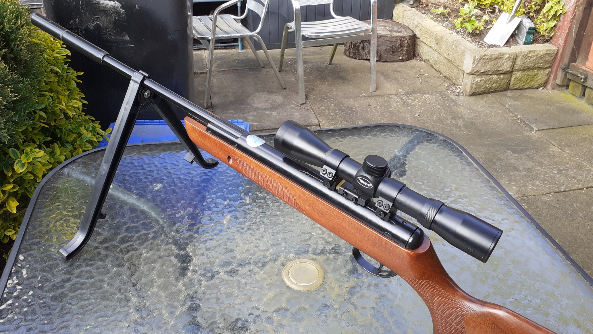

The first picture shows a Mk2
Mk1 has regular 11mm dovetails cut right in the cylinder. IMO that's the one to get. The Maxi grip 14mm rail is an abortion.
The Mk1 is so much easier to work on. I have 2 minty Mk2 177 and .22. Couldn't ever find a decent Mk1.
