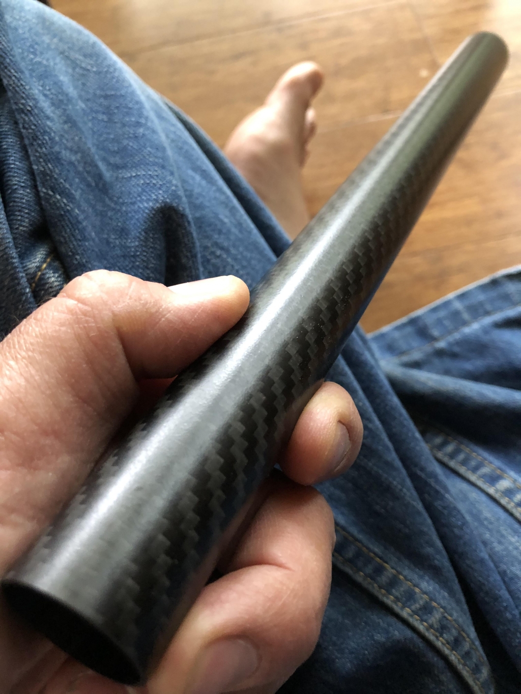

OK. This is a Carbon Fiber tube. Can get from Amazon in different sizes. Make sure you know the internal diameter and external diameter. This is important as you really don't want it larger than the Barrel or the Breech block, will look ugly.

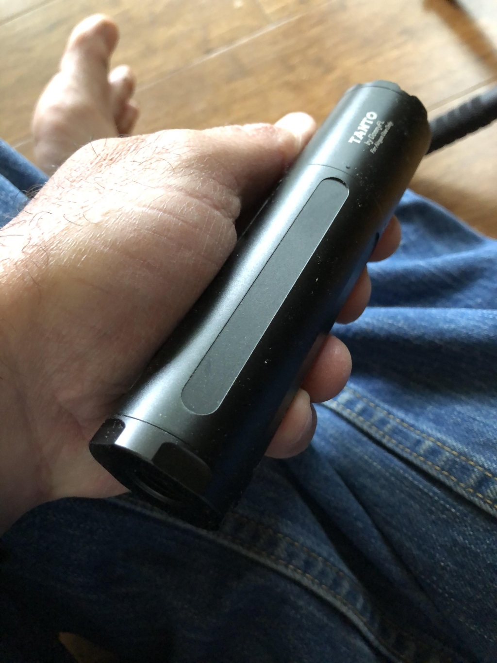

This is a DonnyFL Tanto, the Koi may work too, or a larger diameter one if it doesn't touch the barrel. If you prefer the look, you can go with the cone end cap and give ti a more tapered look.

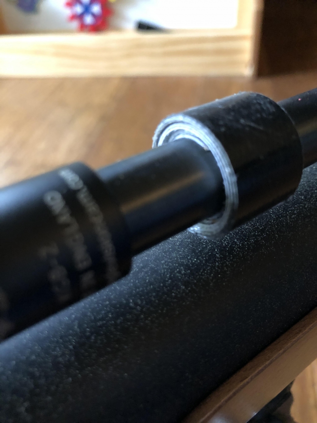

Put a little tape around the barrel near the front, and another near the back.

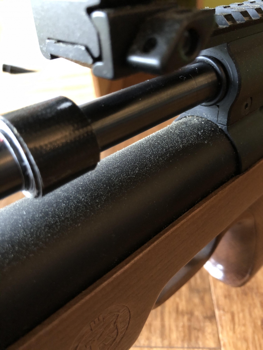

This is the tape near the back and the with of the breech.

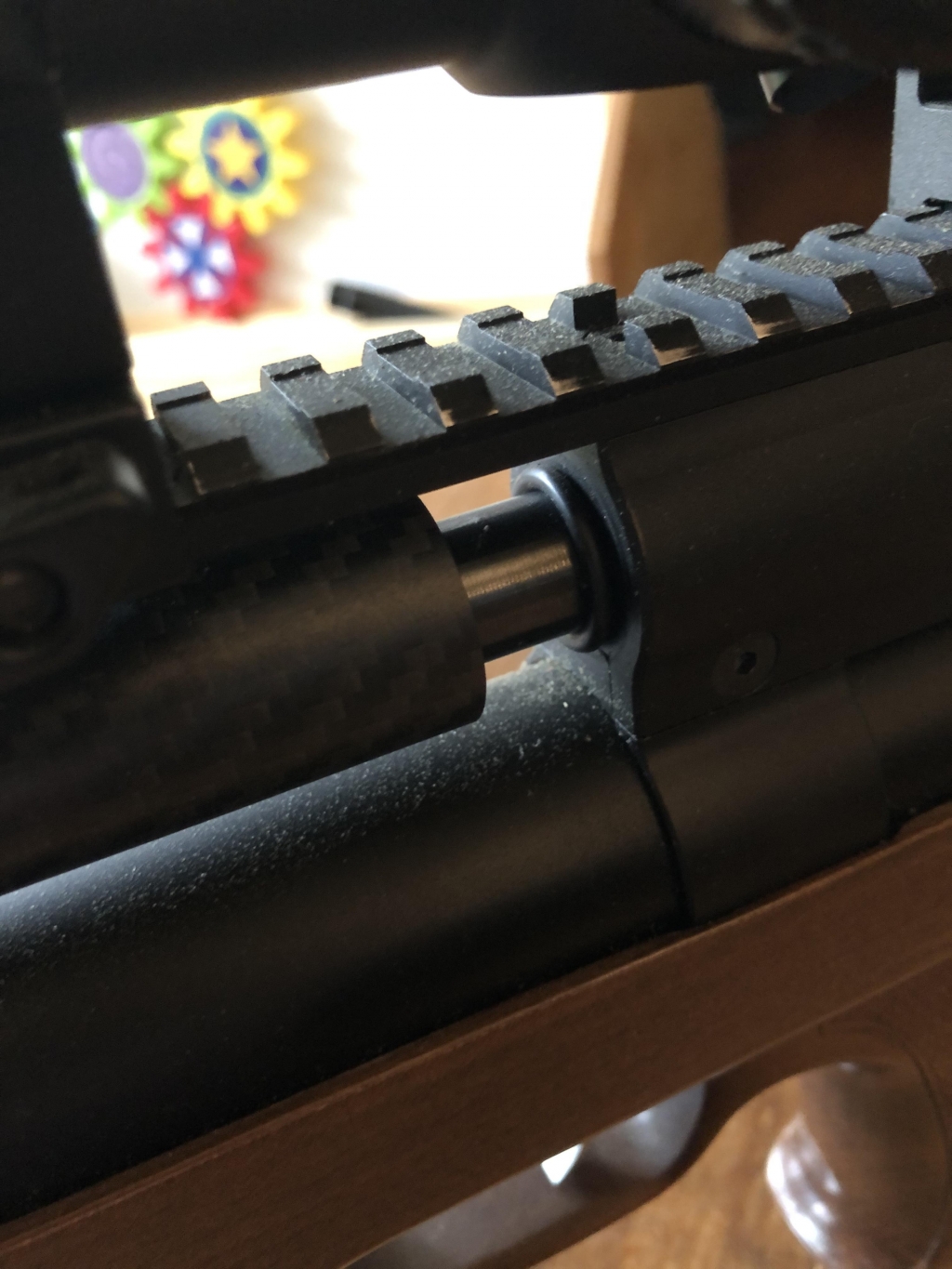

Carbon fiber being installed. You want it to fit almost tight around the tape, not too much. Mines can roll freely.

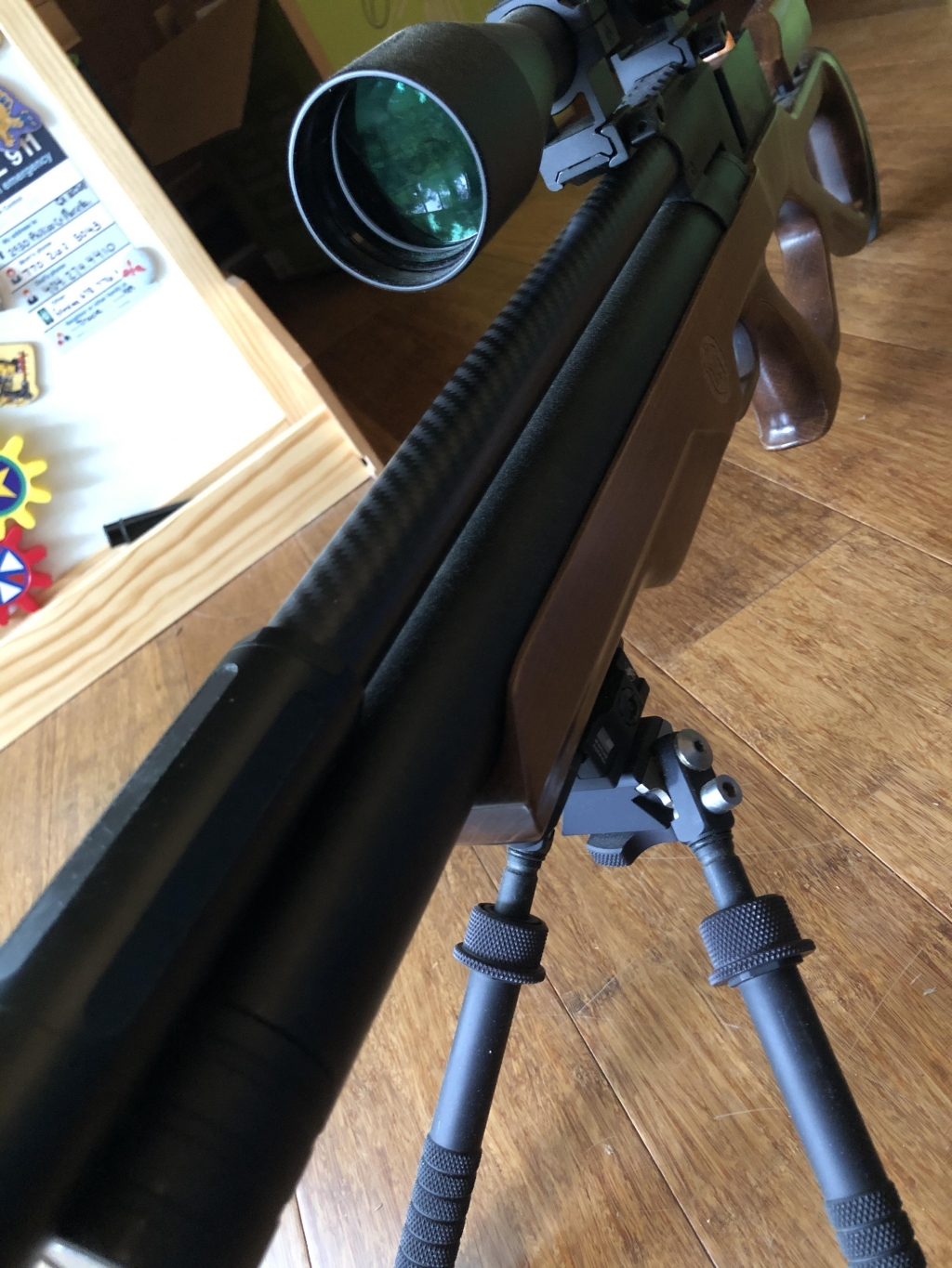

LDC installed, job finished. Pat yourself in back and post it for us to see it.
I originally got this idea from @centercut and just tweaked it to my liking a little. You can do the same. I hope it is of use to you.
