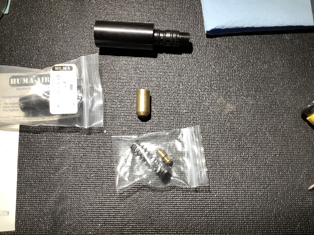

The valve in that img doesnt take you to the valve parts Click on the valve in the link below. Theyre the same valve.
http://www.airgunspares.com/store/category/64/360/BSA/Scorpion%2BSE/
The image above posted Vetmx is the knock off restirctor that needs to be removed. If you don't endeavour to remove it you are just pissing in the wind.
