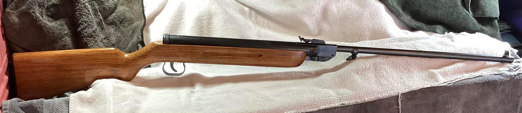

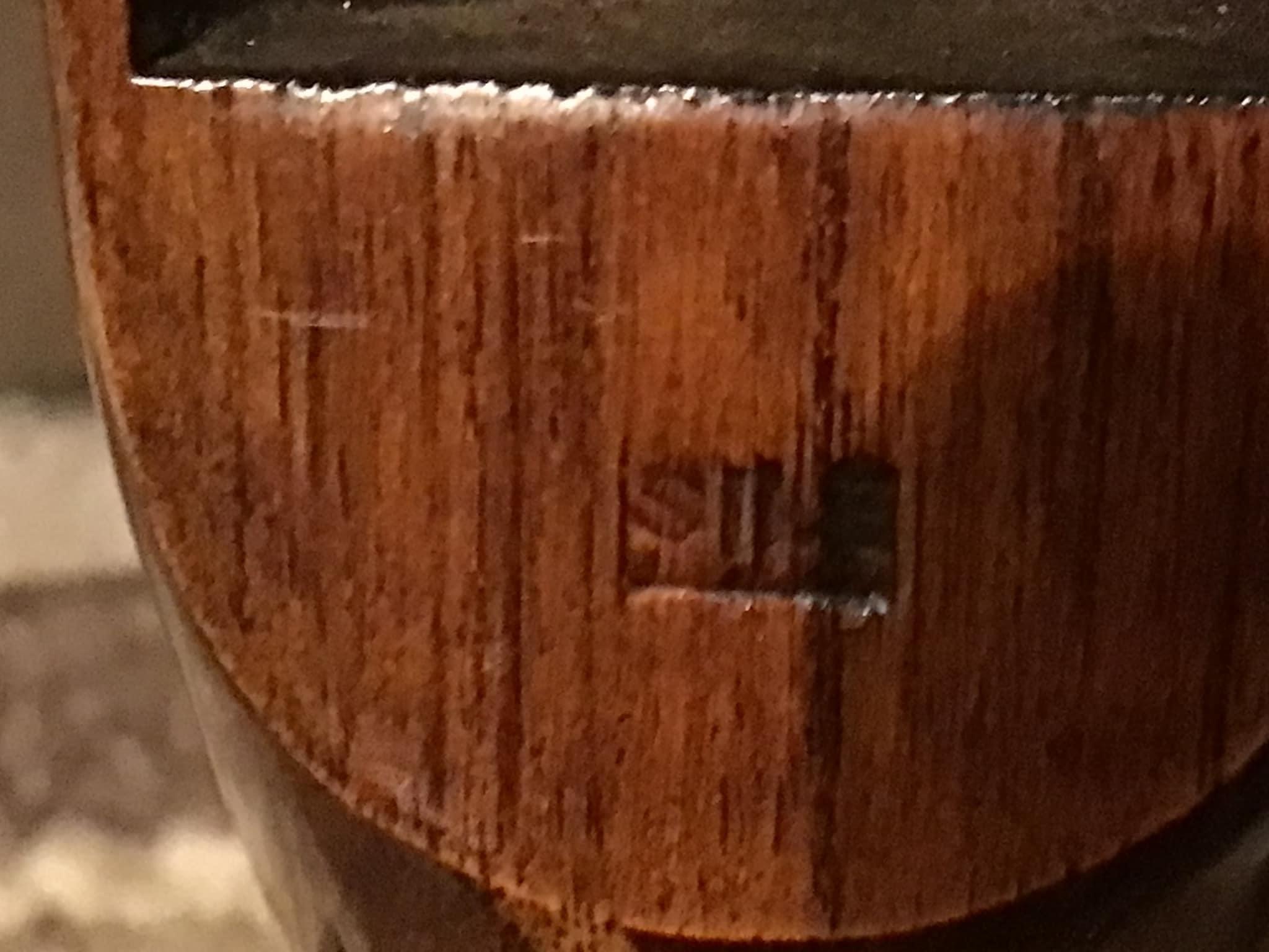

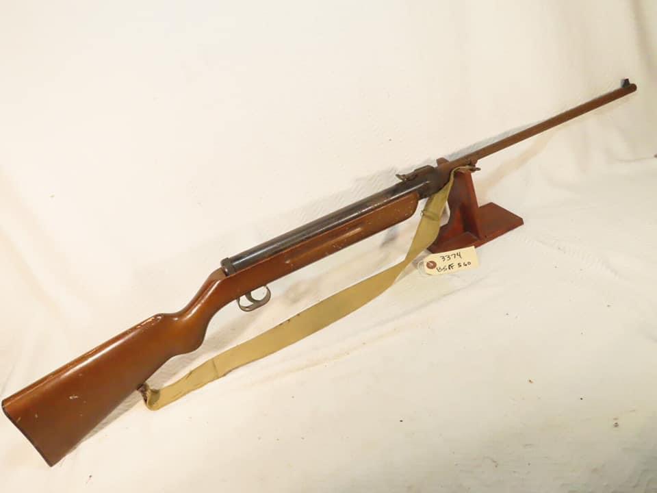

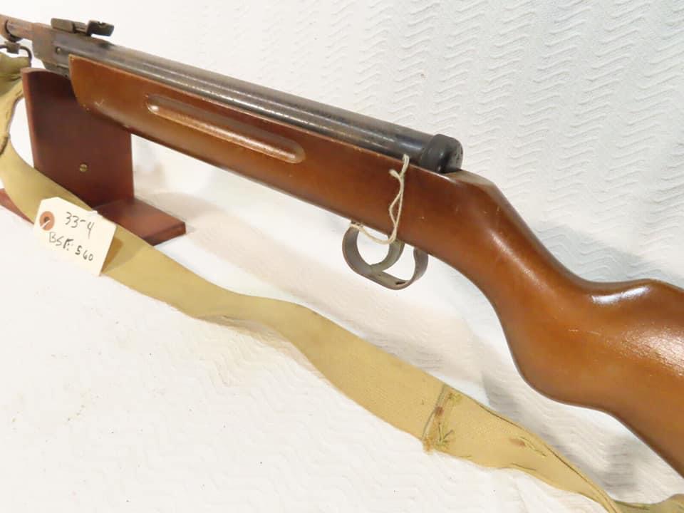

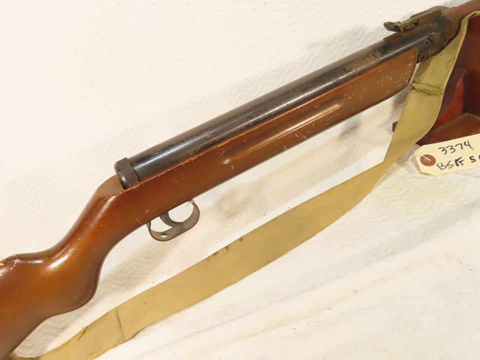

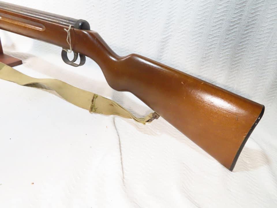

Just won this rifle on eBay. It was the shape of the grip that got my interest. It’s got that old English traditional look. I think it’s walnut which is a nice bonus. From what I read the walnut stock was a deluxe option. Power should be in line with an r7. Perfect for the yard.
Nice! The rounded grip/finger-groove fore end combo is a traditional German style - a favorite of mine, too.
The model 60 is the long-barrel version of the famous BSF 55 carbine. If in good fettle it should shoot significantly harder than an HW 30/R7. The 55 was about the hottest-shooting springer of its day.
Back in BSF's heyday of the 60's and 70's, the 55 and 60 came in a standard version with a slender finger-groove fore end beech stock, and an "N" version (i.e., model 55N and 60N) that had an identically-shaped stock in walnut. The model 70 was the same action with a fancier cheekpiece stock IIRC.

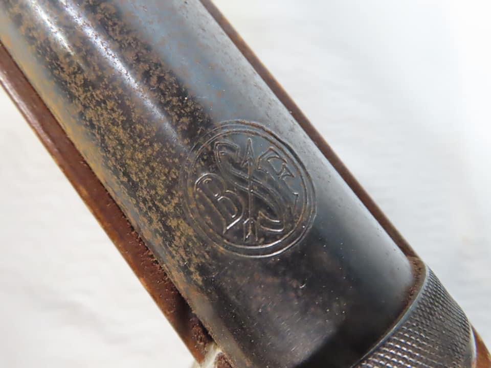

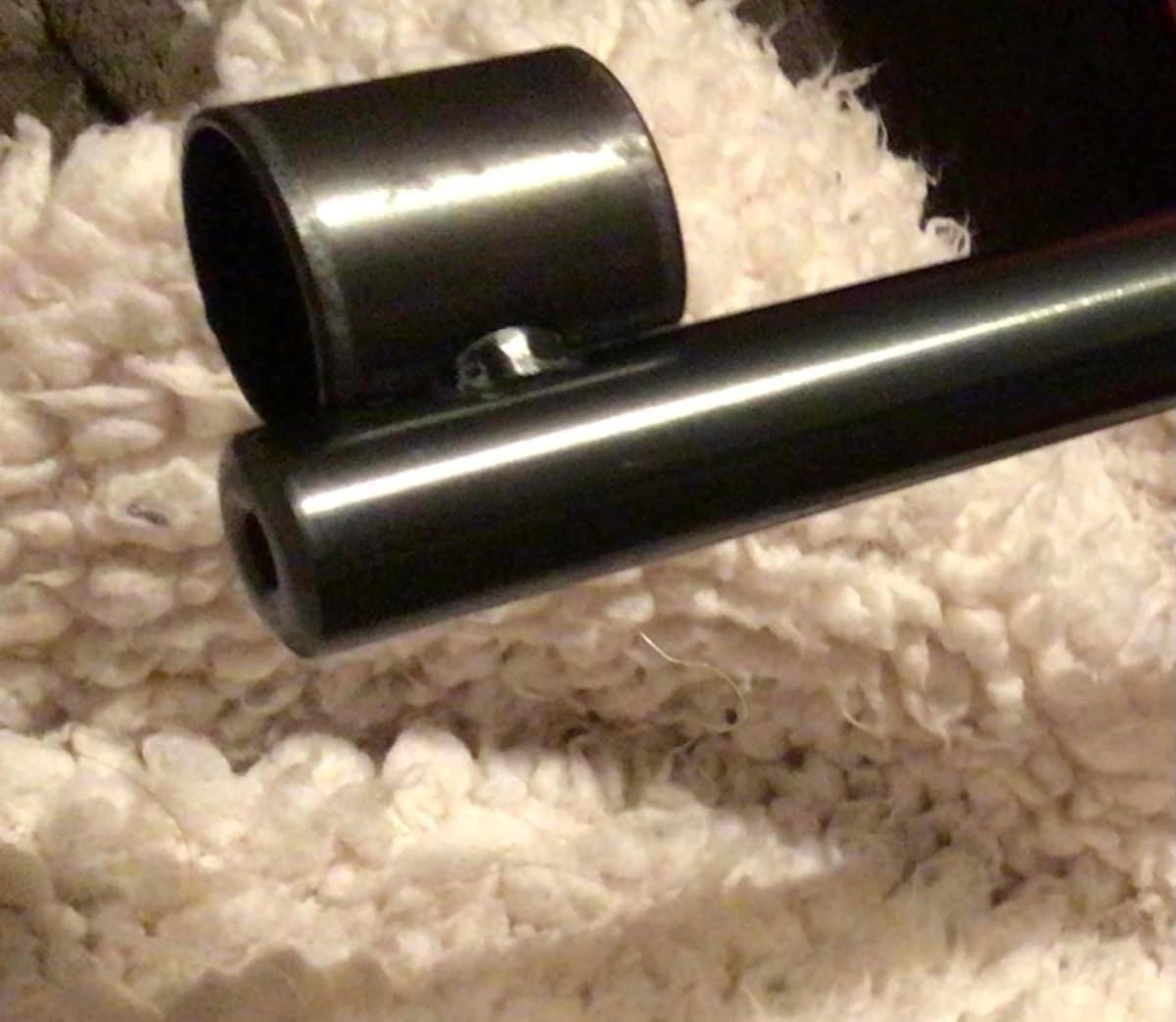

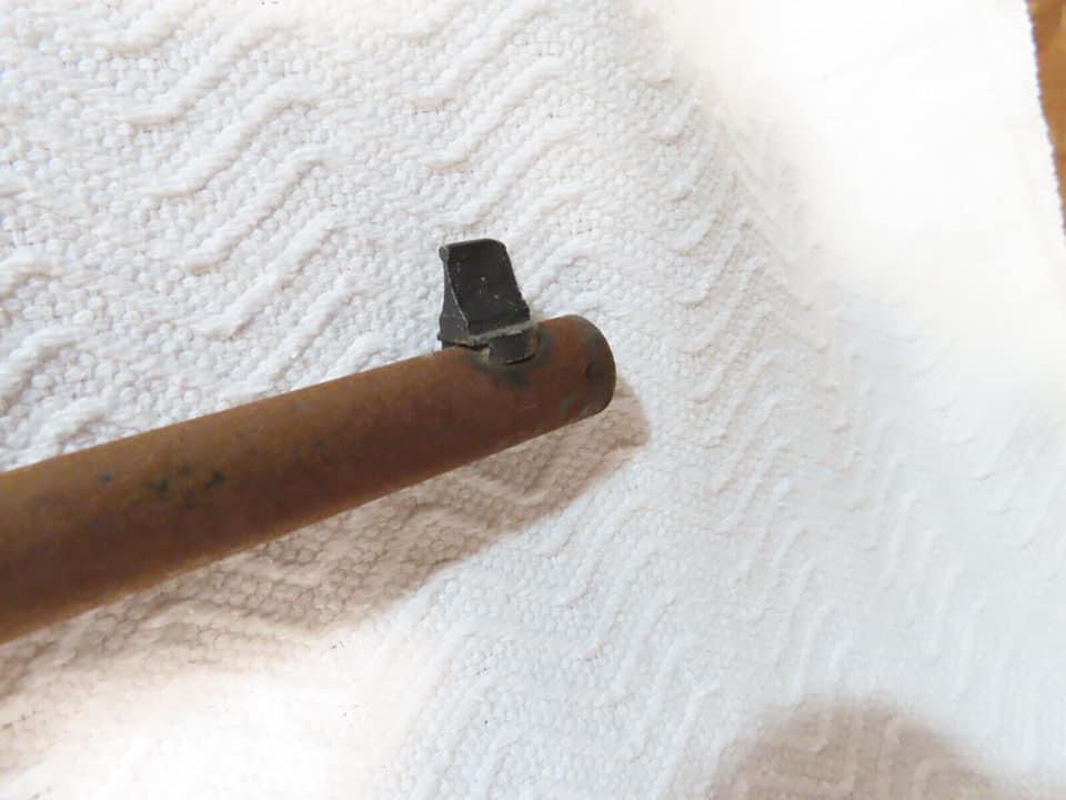

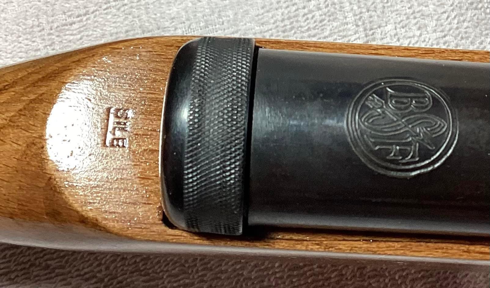

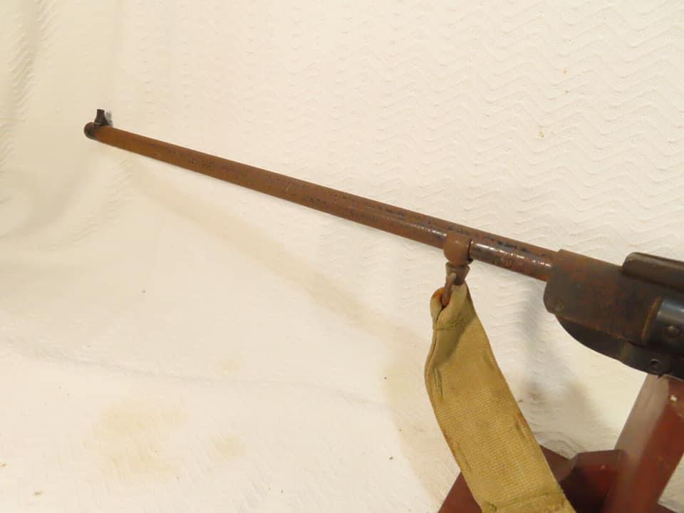

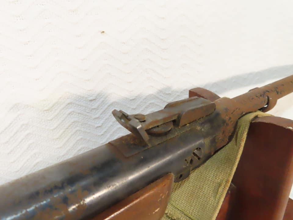

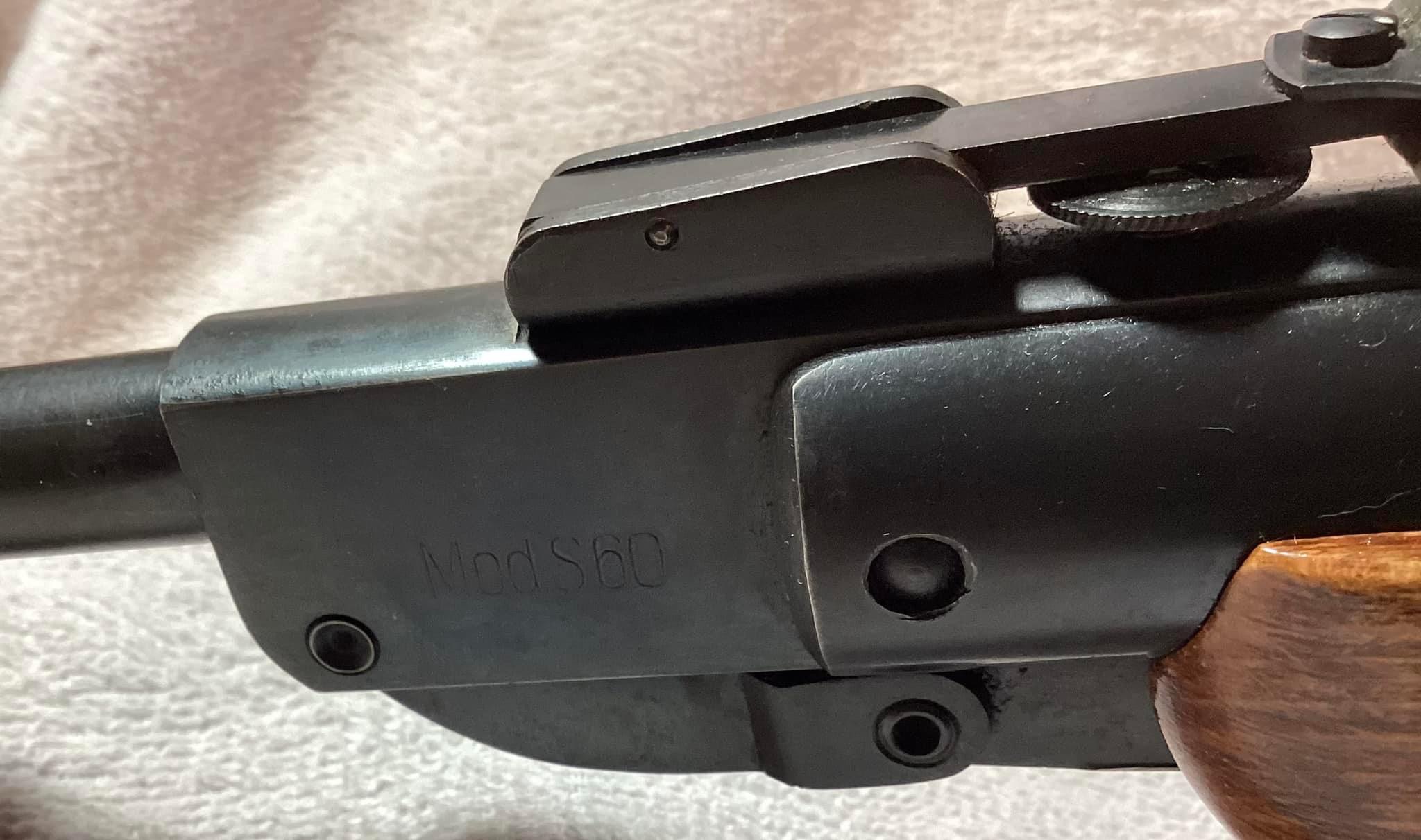

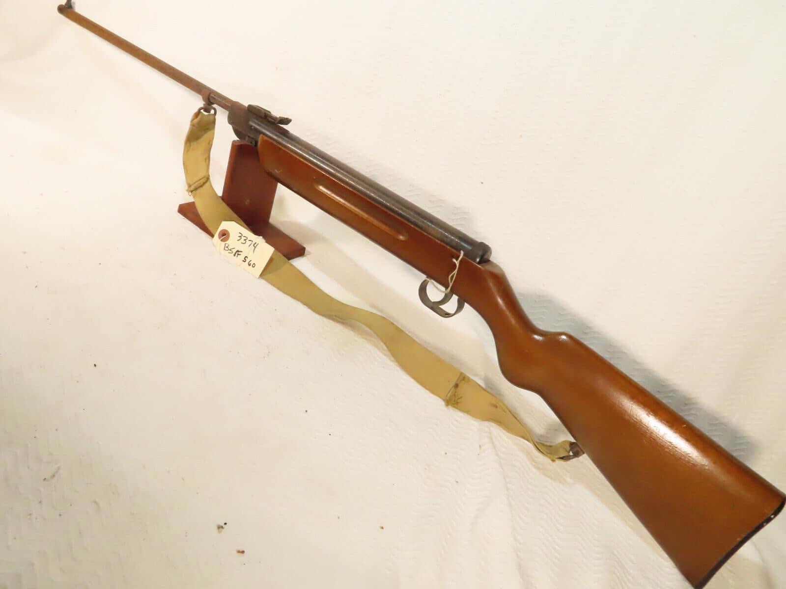

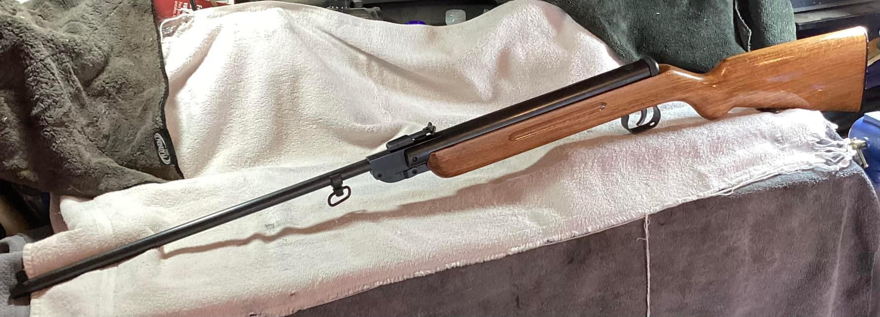

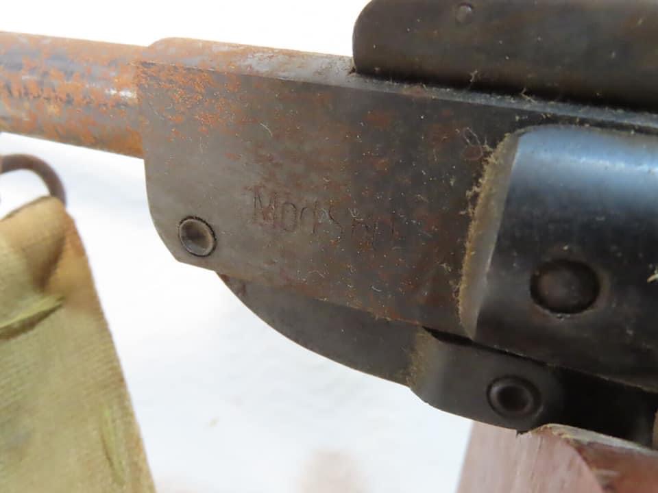

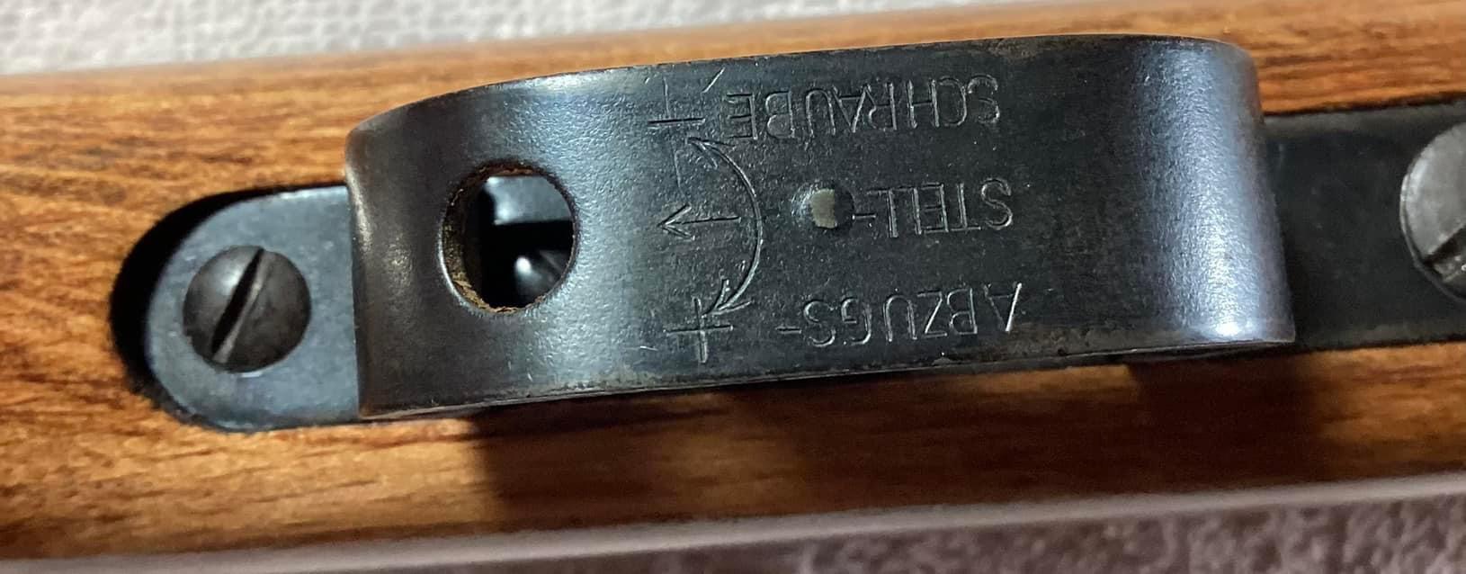

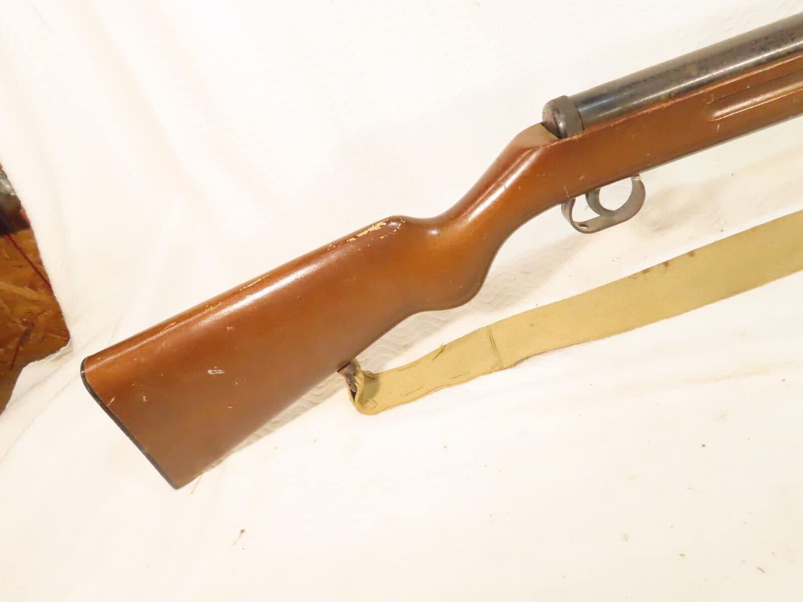

I bought a rusty, non functioning BSF S60 sold by Baker Airguns on one of thier Ebay auctions two years ago. It took about 4 months to recondition it, now it is one of my favorites to shoot along side it’s near twin, my BSF 55N.
attached are before and after pictures of my S60 and a picture of the Air Rifle Monthly that has great information for working on the BSF 55 which is the same as the S60.
Also I would say the power is more on par with a Diane Model 27
Yours looks great and however you decide to go about reconditioning it, you will have a fun rifle to plink around with, enjoy.

Very cool man. If I like the rifle enough I may restore it as well. Did you give it a cold or hot bath? The wood came out nicer than original finish. Looks like tru-oil.
Reactions: c801tfd
The blueing was there for the most part, cleaned it up with 0000 steel wool and light oil, washed it down and touched up with birchwood extra cold blue. Yes the finish is tru-oil, pretty sure that walnut stock would cleanup great.

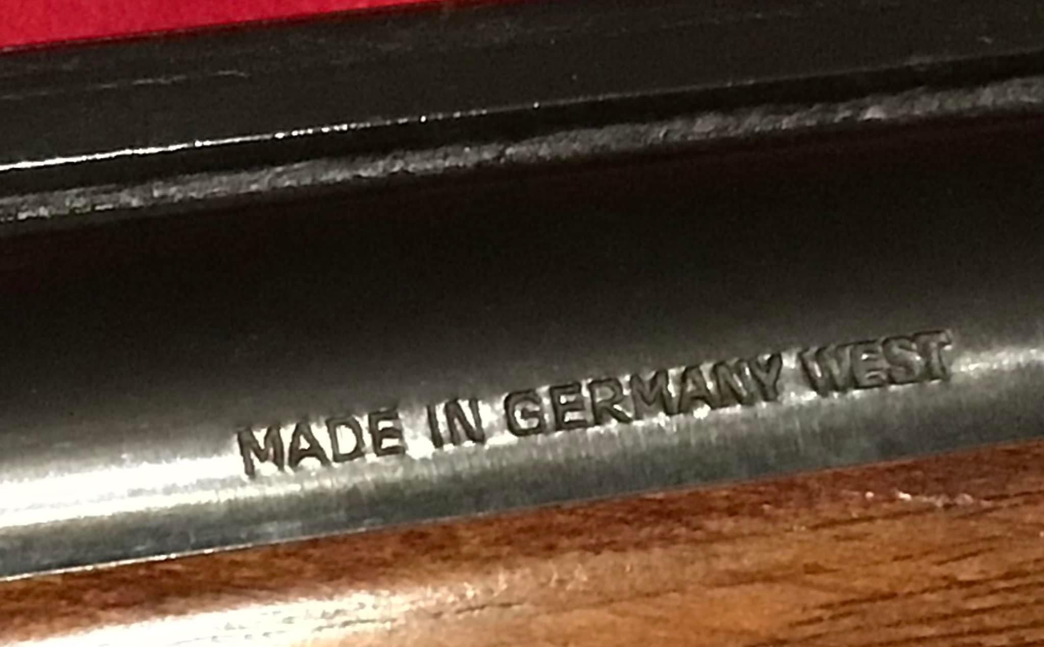

I love these old guns! I like to imagine all the different folks that owned this rifle. Perhaps a farmer buying it to rid the pesky rabbits. Or maybe there was some real life Ralphie that got this rifle on Christmas. If only these rifles could speak.. the stories they would tell. Even the Germany West stamp brings thoughts of a post WW2 Germany and the Cold War tension with East Germany and Eastern Bloc. I even think about the guys who made this rifle. No cnc machines, no fancy tools, just manual machines and precise elbow grease.
