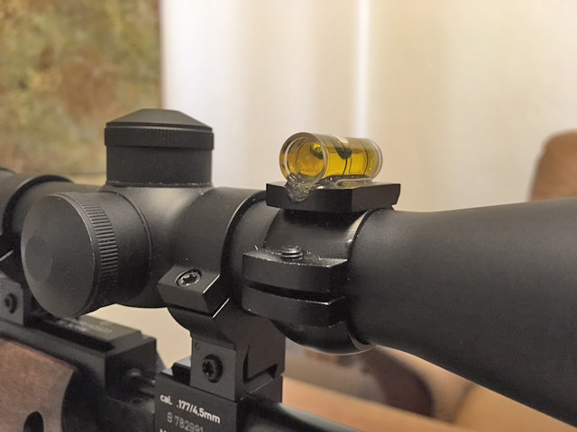

Buble level anti cant device
I just cut the claws off of an old scope ring, grind it flat, and epoxy on a bubble vial from home depot. Cheap.
