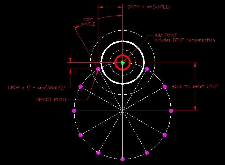

When you cant the gun at all angles, you form a circular impact pattern. The pattern is formed by plotting the following XY coordinates for various cant angles:
X = drop x sin(angle)
Y = drop x (1-cos(angle))
Bottom line - mount the scope at whatever height suits you. Cant the gun as little as possible.
I give broekzwans credit for making the attempt. And the confidence in his work. But a young engineering student (been there) still has things to learn (actually, we all do). Mechanical engineers often need to account for gravity in their work. Not so sure about electrical engineers.
Here's how it is, simplified, graphically (from a semi-retired, professional, mechanical engineer - me):
All canted impacts will lie on the circle of radius=DROP. With the 12 O'clock position of the circle at the aim point.
