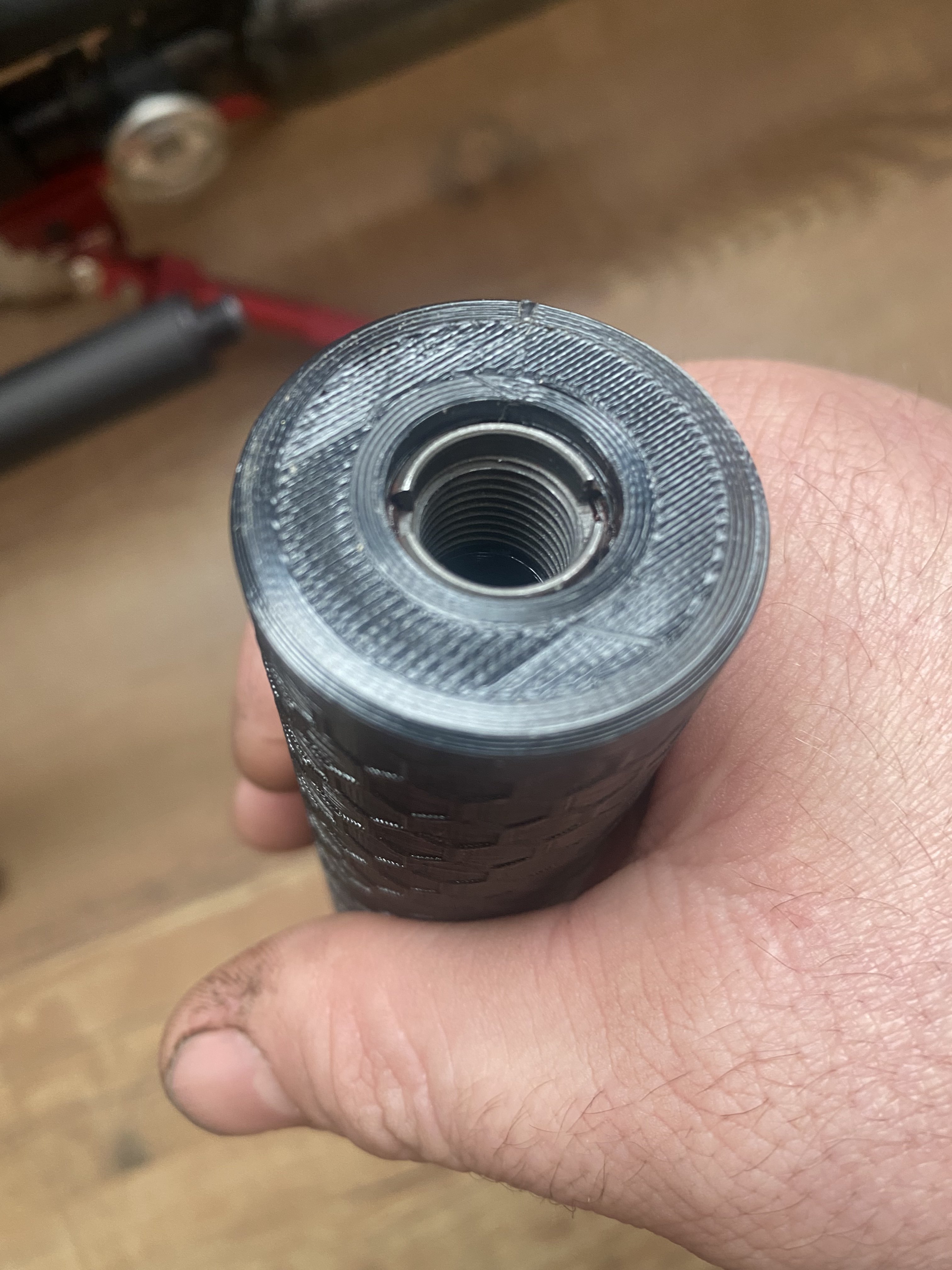

Caveat first that I am not experienced with 3D printing. I would imagine the best way to thread would be to tap a hole created as part of the printing. I don't know how smooth 3D printing can be but threads need to be really smooth.Definitely not an insert. If I had to guess, I would say printed, and it doesn’t appear to be chased with a tap as there would probably be hair like shavings.
That one you made for me last summer is still threading on and off fine with no issues with the printed threads.That makes sense. I have not observed the helicoil inserts to be any more durable than well printed threads. The biggest issue is whether you cross thread them. It is easier to make that mistake with printed threads.
If you are careful in your handling one is as good as the other, although some will argue with that, I suppose.
Put a tiny bit of silicon oil on it from time to time. Should hold up until the day that it failsThat one you made for me last summer is still threading on and off fine with no issues with the printed threads.

DO NOT, REPEAT DO NOT put silicon oil on anodized metal, you WILL NOT have any metal left when you're done. The stuff reacts with the anodizing, I darn neared screwed up one of my barrels doing that. Honestly, I'm trying to find out where this silicon oil thing came from. N70 o-rings are fine with something like Mobile 1, yeah, keep it out of the high pressure areas but beyond that I love the stuff on anything that requires lubrication. I've even tried it in the barrels of my pew pew's and it even stops some fouling, a touch more pressure and heat in them.Put a tiny bit of silicon oil on it from time to time. Should hold up until the day that it fails![]()
You are saying that silicon oil which we use on springers (and have for years) and PCP guns (all over inside the actions) will eat up the metal? I've never had that experience, please provide evidence for this so that we can mitigate the problems we have caused to our rifles? Mind you, I'm not being a smart ass here. I've never seen what you are describing and would appreciate more information about this phenomenon.DO NOT, REPEAT DO NOT put silicon oil on anodized metal, you WILL NOT have any metal left when you're done. The stuff reacts with the anodizing, I darn neared screwed up one of my barrels doing that. Honestly, I'm trying to find out where this silicon oil thing came from. N70 o-rings are fine with something like Mobile 1, yeah, keep it out of the high pressure areas but beyond that I love the stuff on anything that requires lubrication. I've even tried it in the barrels of my pew pew's and it even stops some fouling, a touch more pressure and heat in them.
Technically not me, another member of the forum posted this and it's true, it chewed the S out of my barrel threads. I'm a huge fan, as I said of Mobile one or even Tri-flow but I cannot attest to how it works on o-rings.You are saying that silicon oil which we use on springers (and have for years) and PCP guns (all over inside the actions) will eat up the metal? I've never had that experience, please provide evidence for this so that we can mitigate the problems we have caused to our rifles? Mind you, I'm not being a smart ass here. I've never seen what you are describing and would appreciate more information about this phenomenon.
