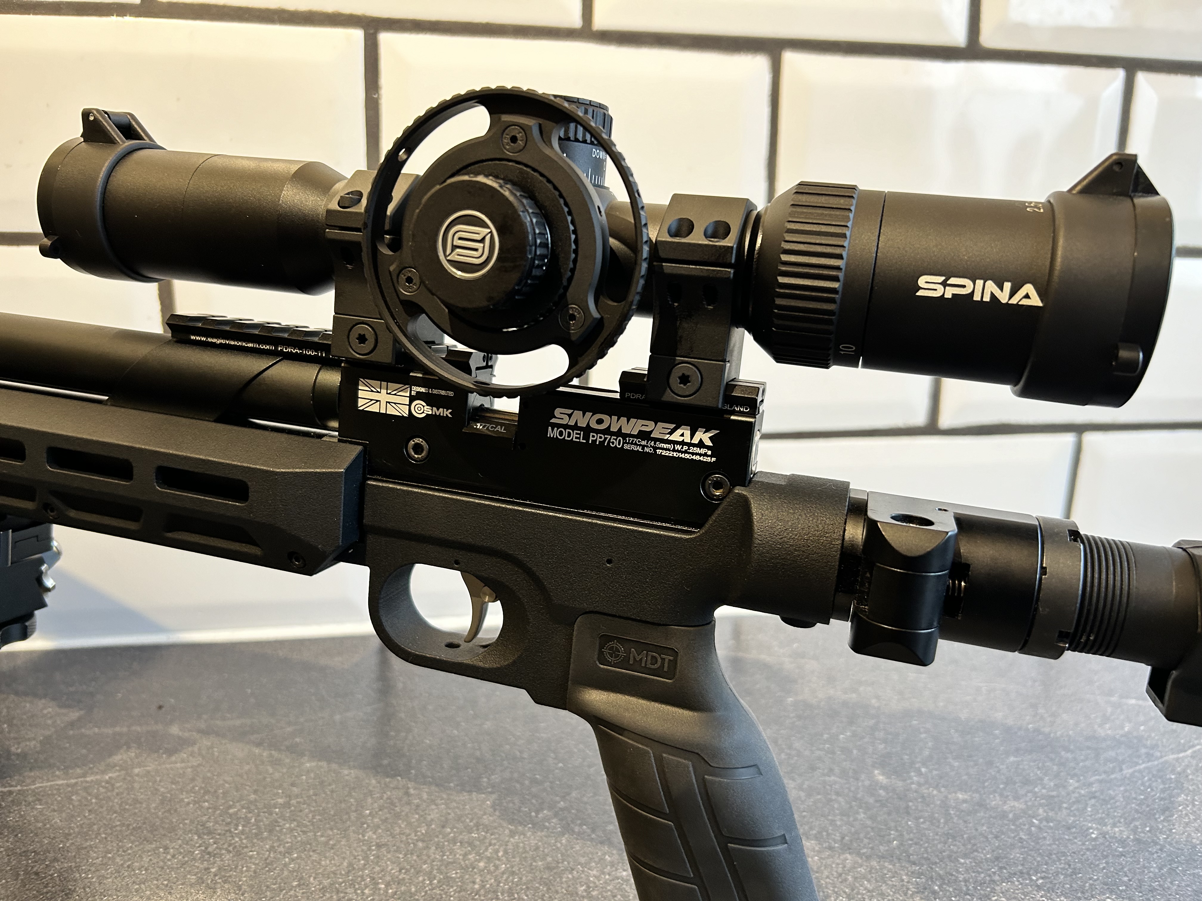

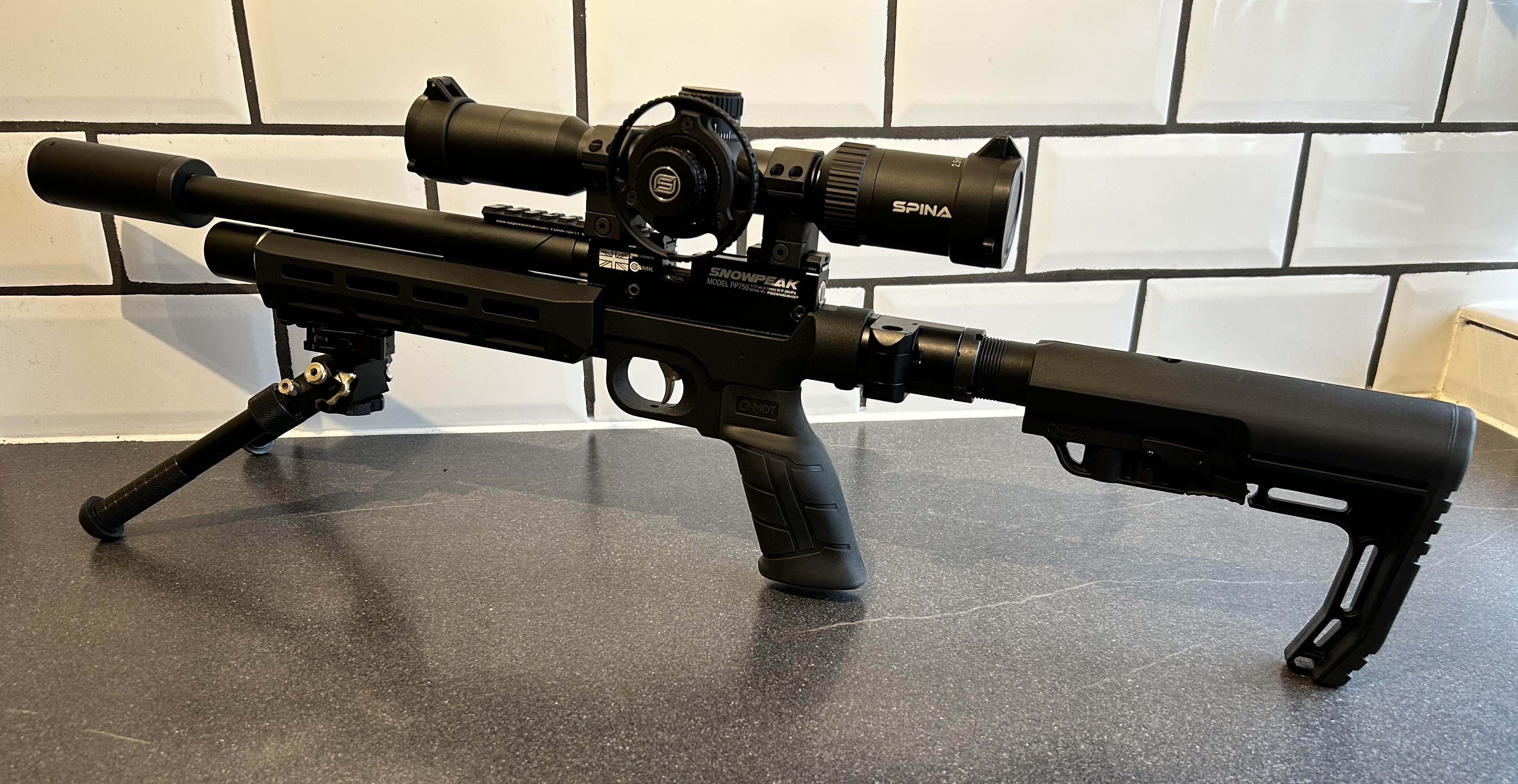

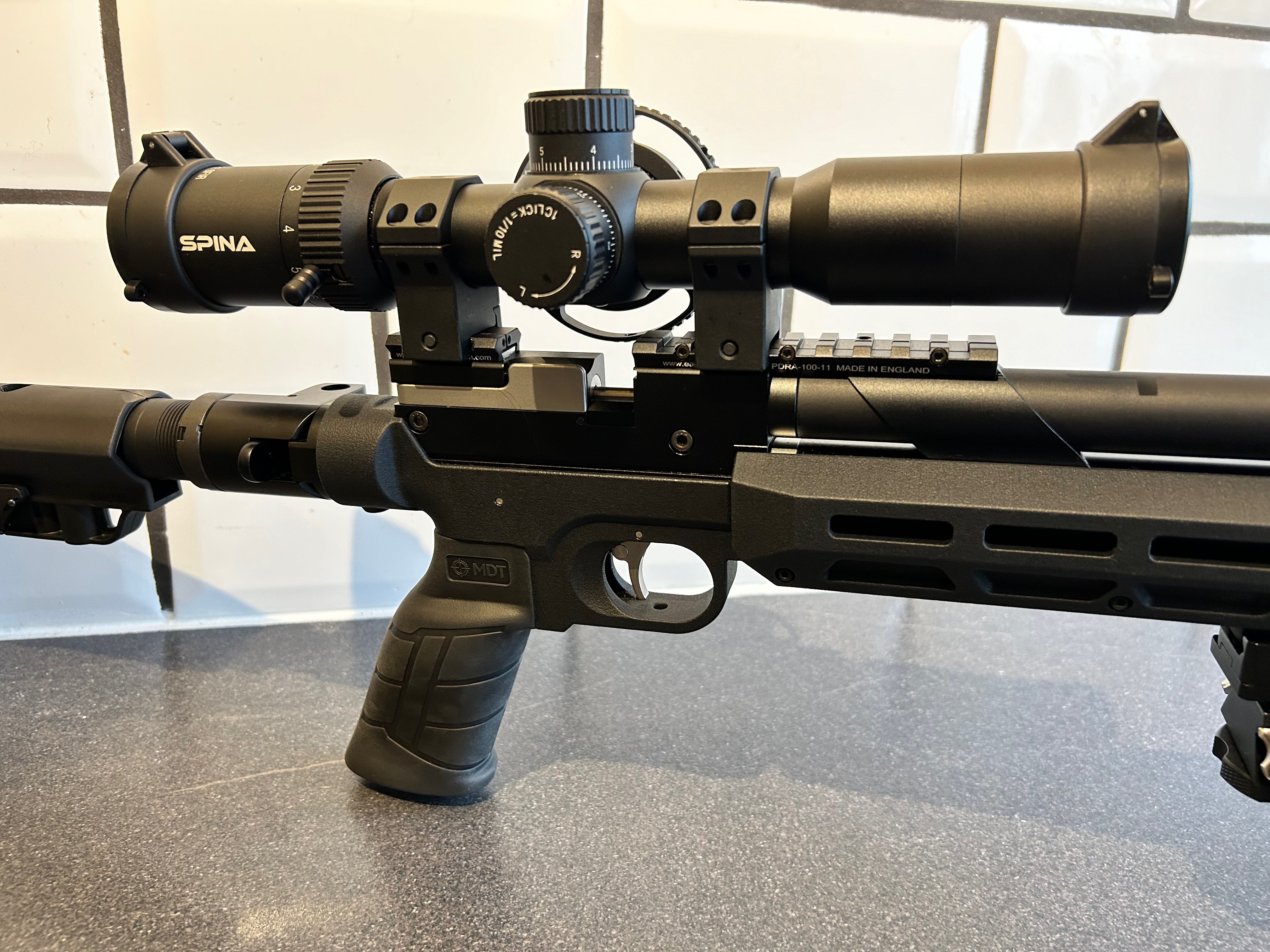

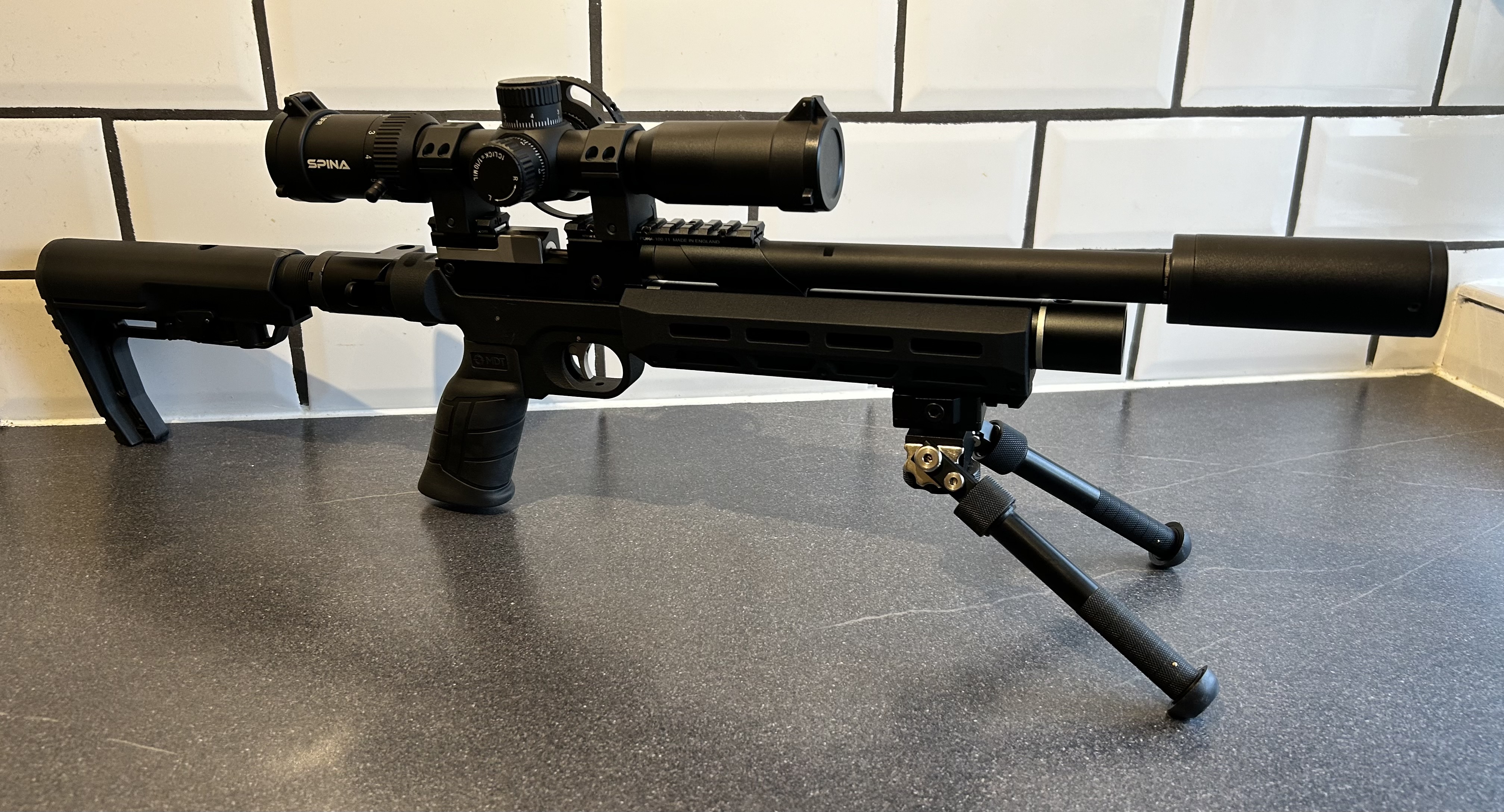

I built a Buck Rail PP750 about a year ago, I sold to help play for my Vulcan 3 and regretted it ever since, so I’ve built another, im calling it the ‘Evo BR PP750’ love how Buck Rail now also print the hand guard in sintered nylon like the grip frame, it’s a massive improvement over the original.
I’ve also fitted a FX folding stock adaptor, it’s a big upgrade over the UTG one Terry was selling, zero movement when locked out. Lane Regulators had a sale so I’ve picked up one of their regs ready for re-seal and tune up 👍
Also she’s sporting a Spina 2.5-10x32 scope with Element XT mounts and a sweet little Blade Baby Fat Boy moderator

The Lane reg arrived today. It’s all back together, the reg is set at 90bar, 2.4mm TP, 9mm x 1mm x 55mm stainless steel hammer spring and its bang on the money, this was the same I ran in the og one, so no need to mess about and now the cocking and trigger are much lighter and smoother with the new hammer spring 👍
