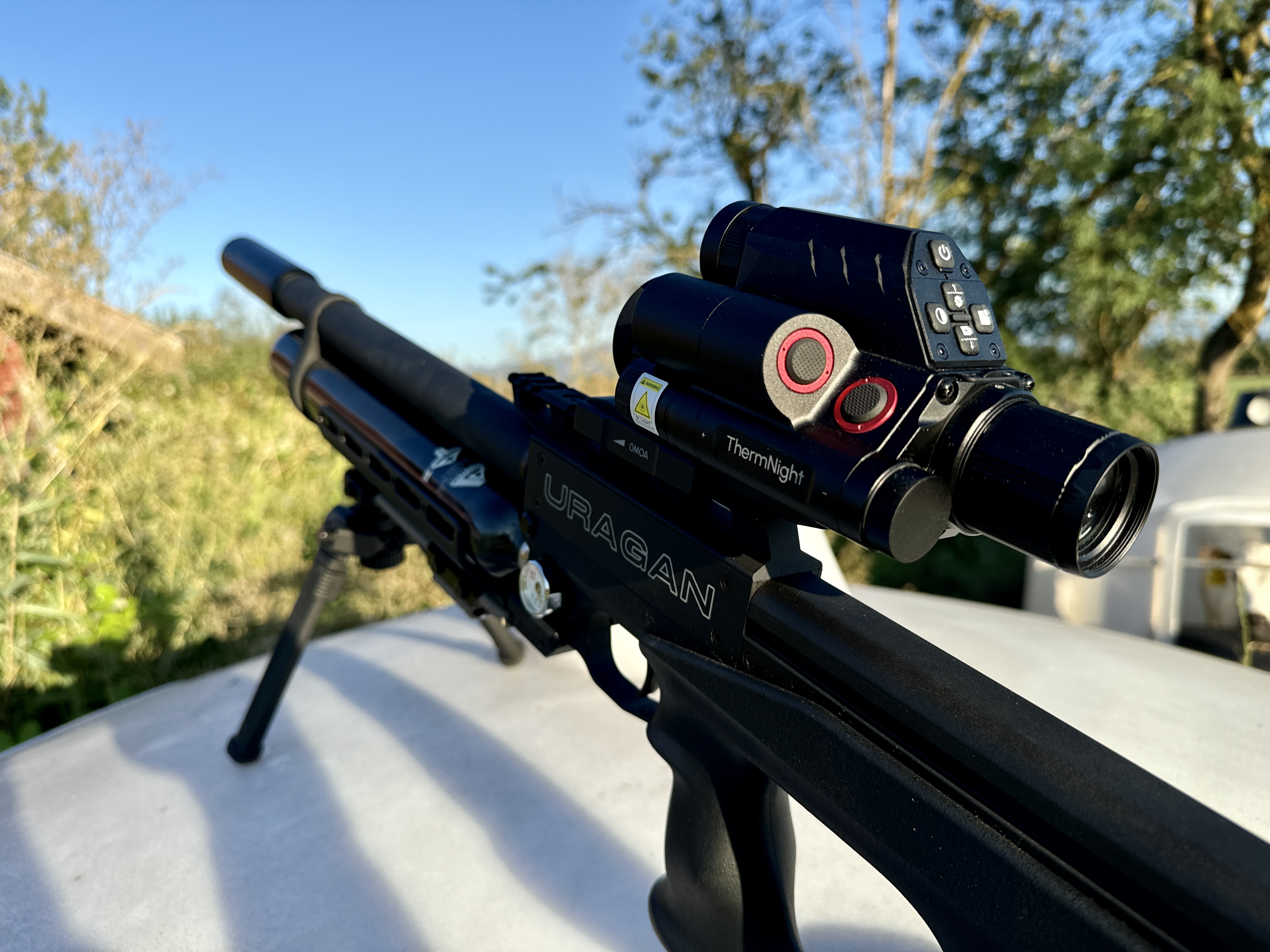

Barrel band didn’t necessarily make my Uragan “more accurate”… but it certainly helped with consistency of accuracy and eliminated POI shifts across a broader range of holds/rests.
If there’s enough space between bottle/tube and barrel/shroud, then free-floating is better. But, if there’s intermittent contact between the two due to design of gun, then a barrel band can help.
Kind of like forend bedding on a PB.
