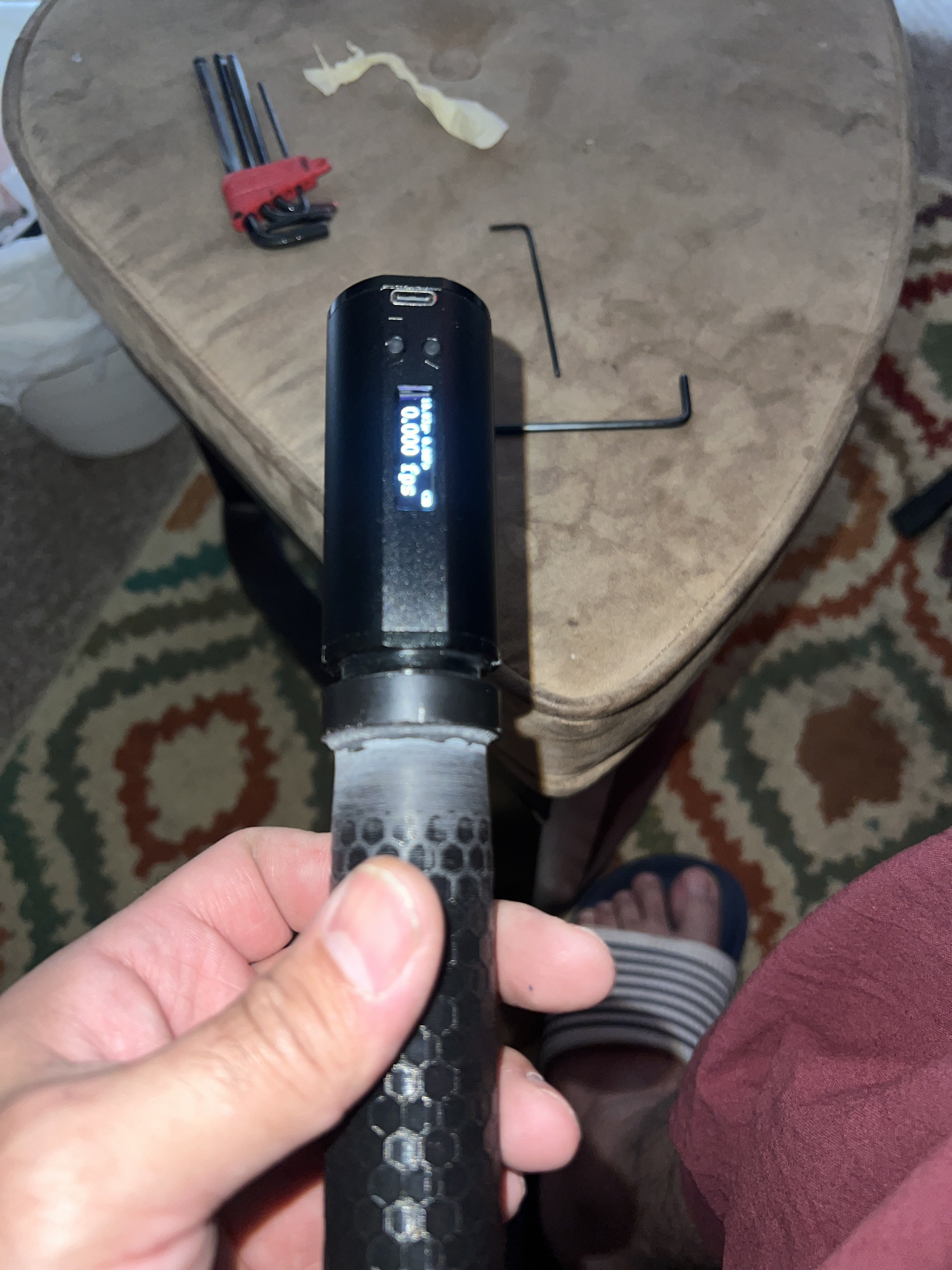

Ok guys after some long and hard thinking and few failed tries,
today I came up with this idea and decided to give it a go,
I was fed up with Orcair chrono stupid loud by itself but I love the form factor,
and was unable to figure out how to integrate this pocket chrono with a suppressor,
well I finally achieved it and wanted to share with u guys if any of u want use it urself,

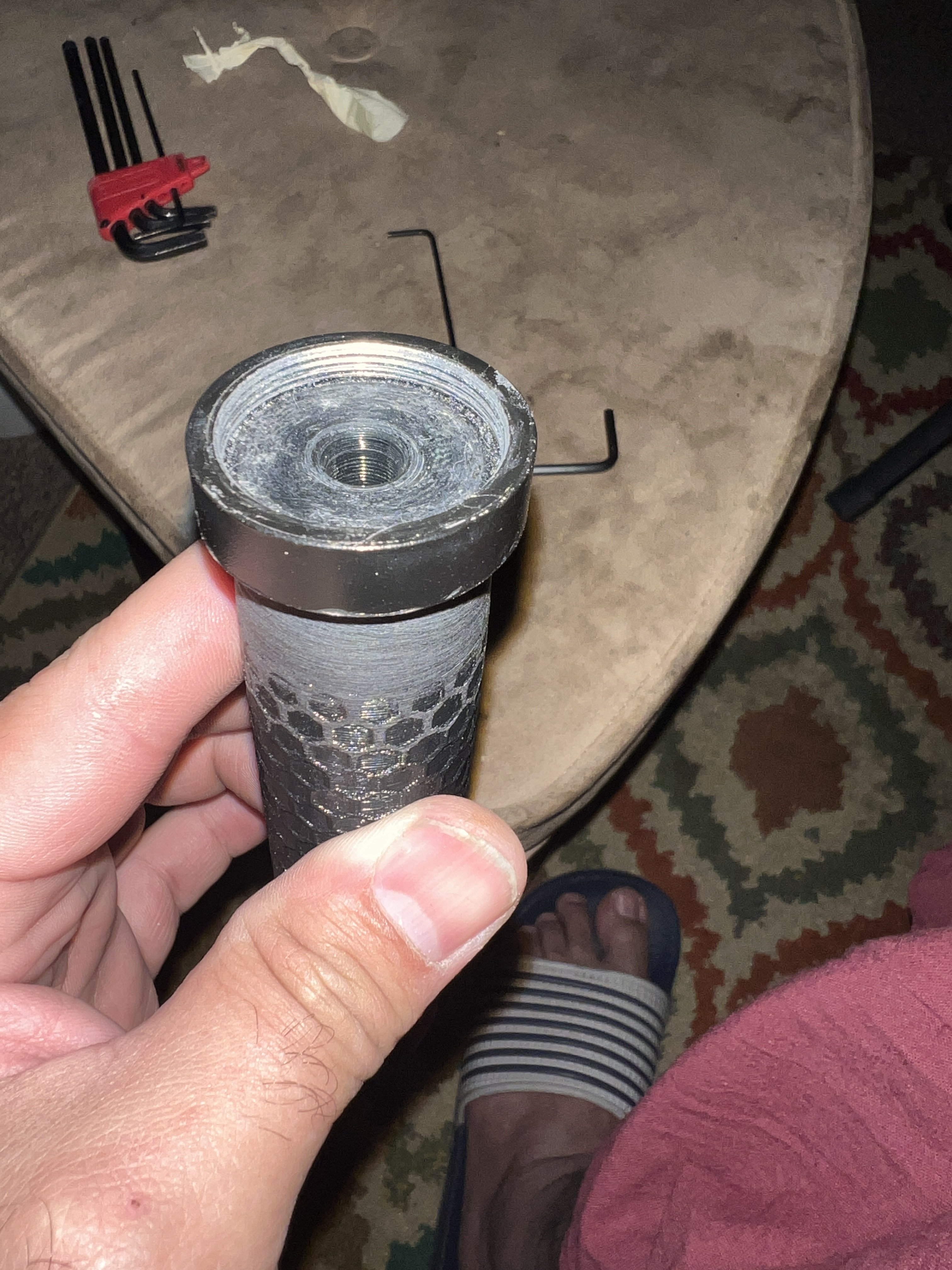

sanded the buck rail 3d suppressor untill I was able to make the outer end sit inside the adjustable collar of Orcair chrono about 1/4 depth of the collar and did use a vernier caliper to make sure that all the sides of suppressor are aligned and then I super glued it and let it dry for a day,

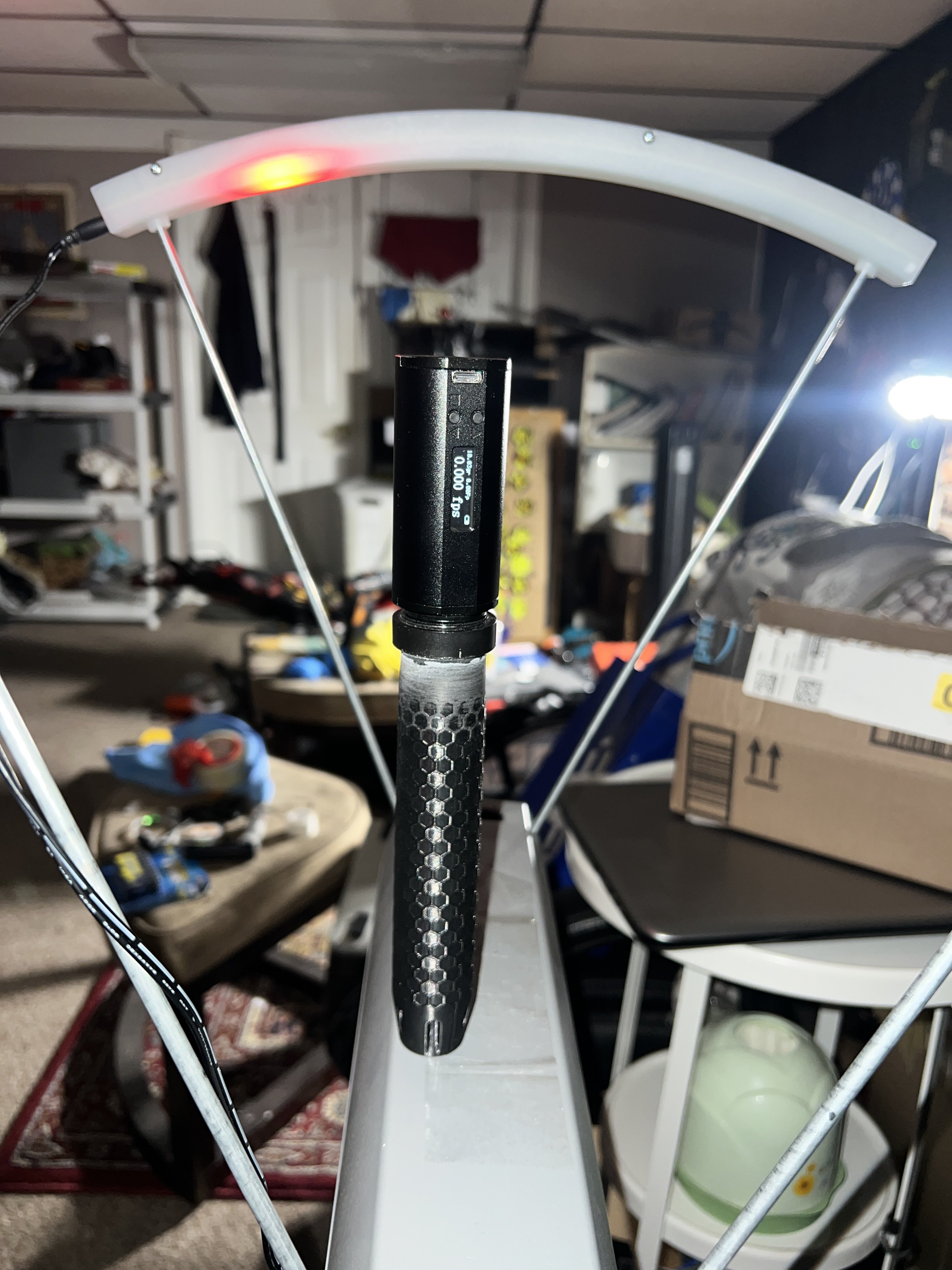

and then I tested it just now and compared the reading with dlx pro chrono and it works flawless.
i can sleep better now.
