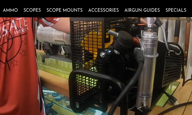

I have a Daystate LC-110 from AOA dated 2019. I have 17 hours on it. All my research shows it's a Coltri MC-3 EM LC. It is a 3-stage and fits your price range. Mine has a molded 110/120V plug to it; it's a normal phase, common, ground 3 prong plug similar to a molex computer power plug. I have it plugged into a 20 amp circuit but it's the same NEMA type as a household 15 amp receptacle. If you're having to do custom wiring might as well do 220/240V. This is strange to me... anyone got more details on this 110/120V and 30A requirement?
This must be something new. My motor plate says 14.5A @ 60Hz/110V at 1680 RPM.
I have been very happy with my LC-110 for filling my 90cu-in Ninja bottle.
Even in their video it's just a standard household plug, same as mine, in the LC-110:
