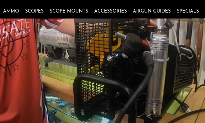

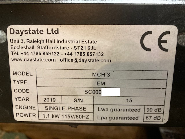

Talked to AOA regarding Daystate compressor with RV plug, it's a MCH3. It's a modified version of the 220v version and they can only get it to work with the 110v 30amp rv plug for the US market. That's why it's on sale because the saving will go to an electrician to install the specialized plug. I got quoted $400 from a non licenced electrician but a licenced one won't touch it.

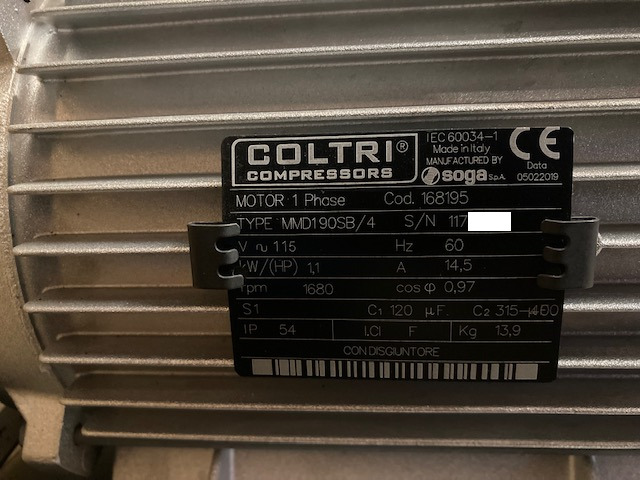

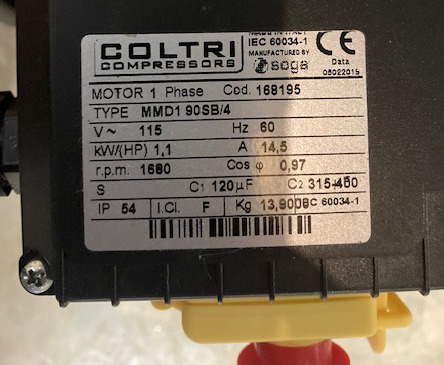

This makes little sense to me. Here's my motor plate and control box ratings, 14.5 amp, which is in spec with NEC 14ga 15A 120V. I'm running it on a 20A circuit for the surge current.
I can't understand why a 30A plug end is required. Surely the motor and control box which house the run capacitors are wired for phase, common, and ground? The Daystate plate shows 1.1kW or 1,100W which is well under 15A of current draw.
If the current draw and wiring are the same why not just replace the plug end?
