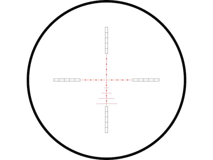

I just wish they had a cleaner reticle, I am not the biggest fan of christmas trees lmao

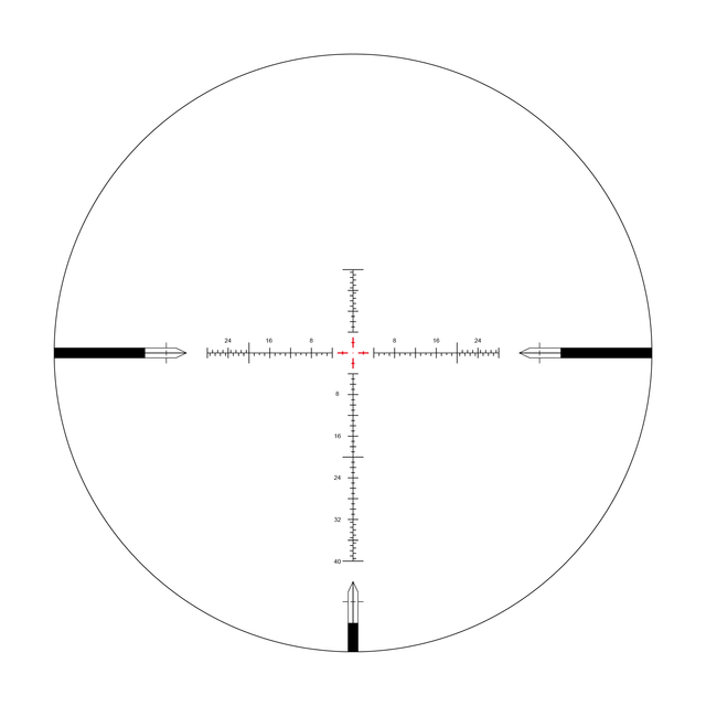

My Arken EPL4 does not have a Christmas Tree reticle. Mine look like this with ELD Japanese glass:

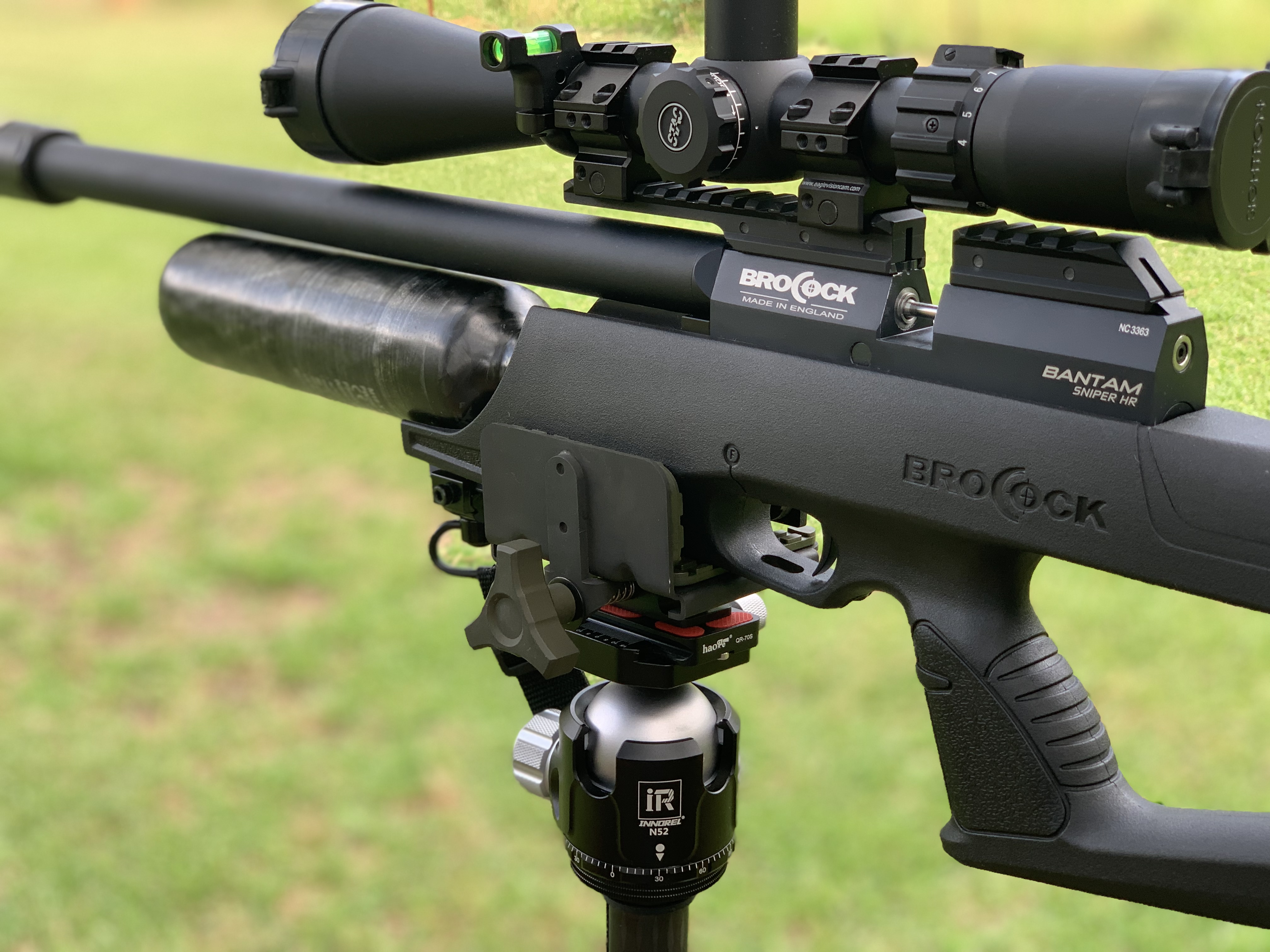

In the same $400+ price range I also really like the clarity and quality of my Hawke
Airmax Compact Air Gun Scope 30mm Tube 3-12x 40mm​
