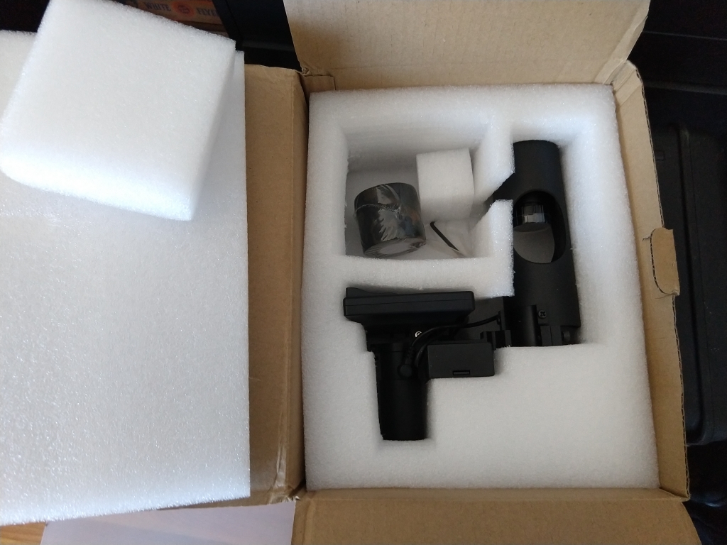

The packaging on this new version was MUCH more professional than on the original. Lots of custom cut foam, so robust even a 3rd grader couldn't break it although I've heard nothing is beyond the abilities of the postal service. (I had UPS put a 45 degree bend in a cold hammer forged steel barrel once, still don't know how they actually managed it) And what a bonus, the box was thoroughly waterproofed with the finest in yellow Chinese packing tape. :p
It is worth noting that there was no chingrish manual to suffer through, no manual of any kind in fact. This has never slowed me down before, after all why should a manufacturer know anything about their own product, but for those who like to hallucinate while staring at the pressed and processed carcasses of dead trees this might be considered a negative. Just something to keep in mind.

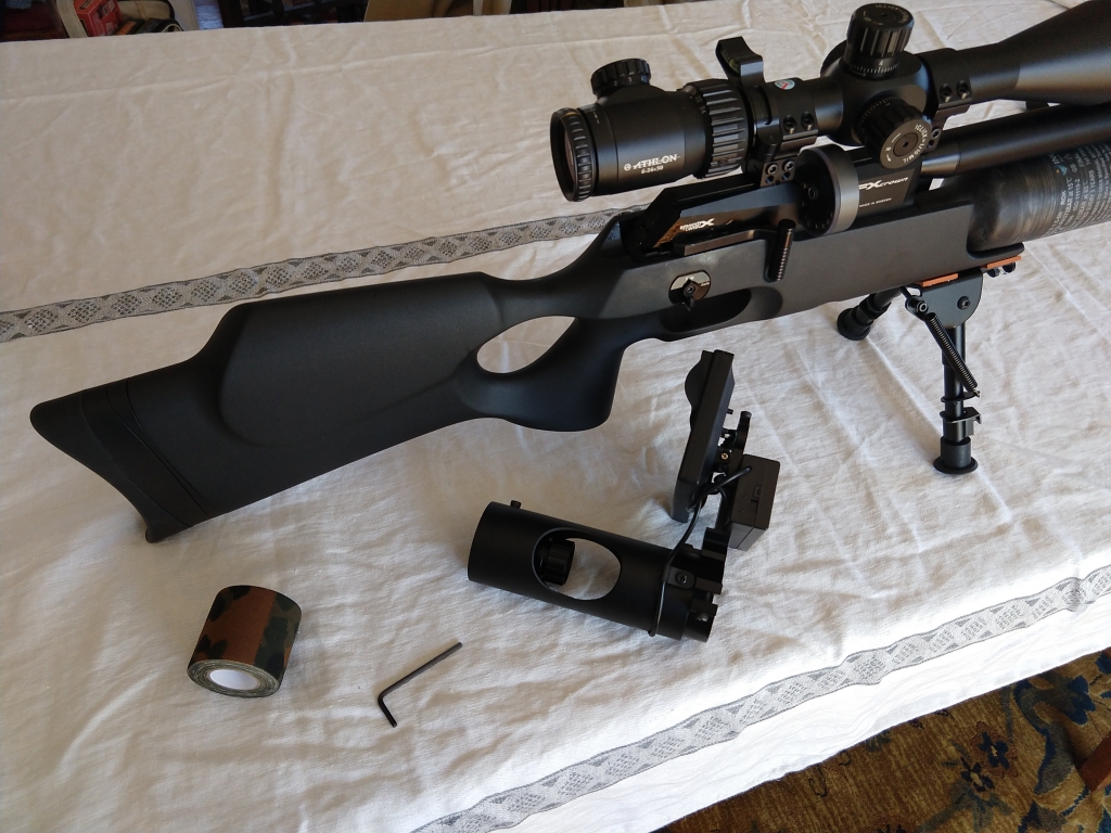

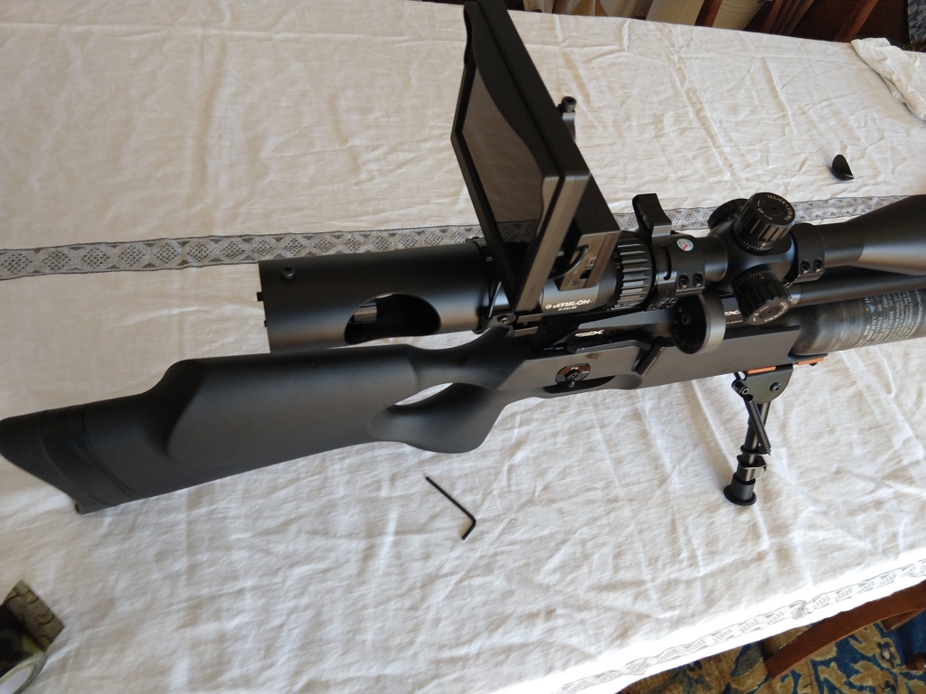

Mounting for the first time took only a few minutes, but there was one hitch: the Athlon Argos I run has a fatter ocular ring than the tube beyond it, which caused the camera to tilt as I tightened the clamp. The fix was easy: with the included fabric tape, I simply built up a small “shim” on the top of the mount to fill the gap, and held it aligned as I gently tightened. For those worried about aluminum-on-aluminum marring, you could put the tape all around the inside of the mount as well.
From there I popped in two 18650s. This is one thing which I was never thrilled about on the original unit, and they appear not to have changed on this one: the battery box is TIGHT. If you think you're going to fit fat-wrapped protected 18650s in here you've got another thing coming. I put in some sanyo unprotected cells I had kicking around. The battery box appears to want unprotected button top cells, for what it is worth. I pulled the (now included) lens cap off the camera, clicked the unit on, and focused it on the reticle with the scope's front-cap closed and the reticle illuminated at its lowest setting. Done, ready to go.
There are a couple other little things about this unit worth noting before I get into performance. First is that the green "tab" seen as the corner is a pull for the screen cover. Because I want to avoid scratching my screen, I just leave it on as a screen protector. Heck one has even been hanging out for years on my original unit. The IR illuminator connects at the side, and has its own on-off switch which is nice. It appears to have a ramping feature, which is also nice. I don't care though, because I have every intention of running my own vastly more powerful illuminators. But it is there for those who care. Another thing is that there is a second switch, which is not the power switch, on the back of the unit. This one perplexed me on the original, because one day I couldn't seem to get it to work worth a damn. Turns out it is a day-night setting, the switch allowing you to choose between the two. Cool huh? If your picture is in color, it is because you're on the day setting. ;) There is one more negative I want to point out before we get to the testing portion of the exercise which is that, while the screen does have adjustable brightness settings, I think all of them are too bright for night hunting. I've been meaning to pick up some window tint to put on the screen, but the fact that in years I haven't I guess should tell you either that I procrastinate a lot or that I don't find it to be that much of a nuisance. For what it is worth, I have never in my life found an NV unit which wasn't too bright.

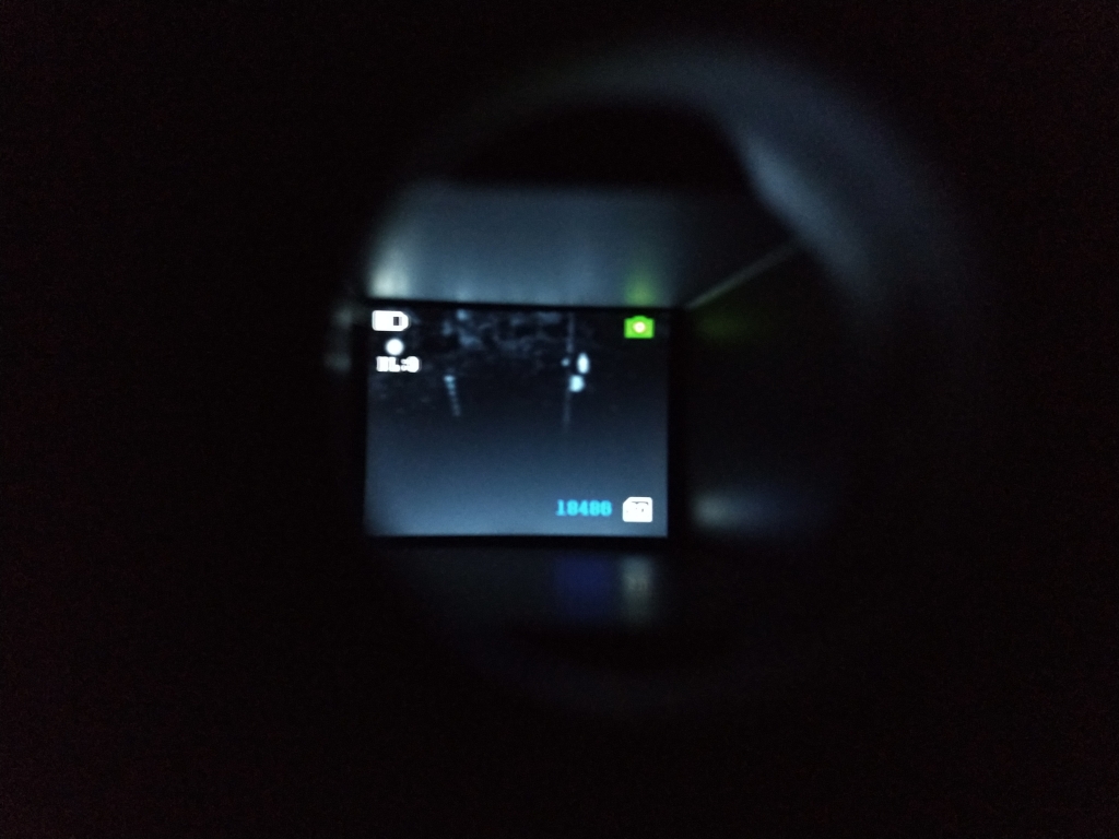

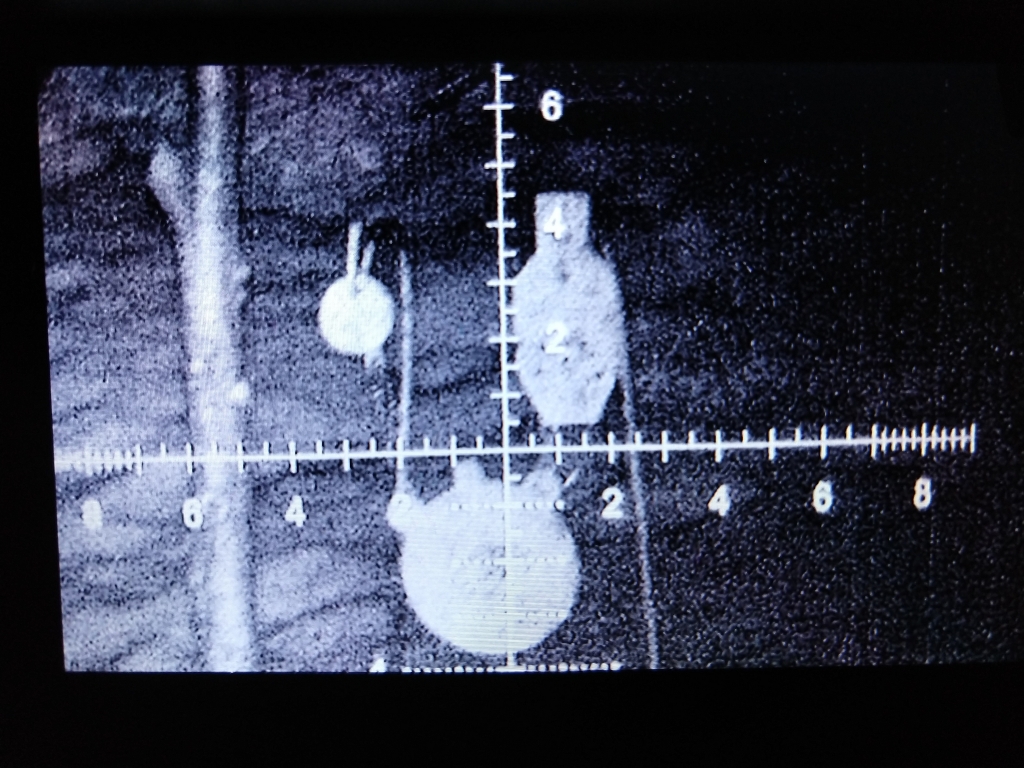

So on the fine evening I picked to do the photography of this unit it was moonless, very clear, there was minimal light pollution, and the stars were bright and crisp. I had my scope, still an Athlon Argos, set to 16x. The target was 100 yards away, and in the middle you can see a bullseye target with a 2” bull in the center, and I believe the top-left hand disc is 3" in diameter. The targets are dingy white from white spraypaint and weather and so on. Please note all of these images are cell-phone pictures of a screen. This creates nasty artifacts, obviously, but also produces less clear images because of the lack of persistence of vision which our eyes have. Basically the unit looks better in person than in photographs.
Without any illuminator turned on, this was the view from the screen. You can see precisely nothing

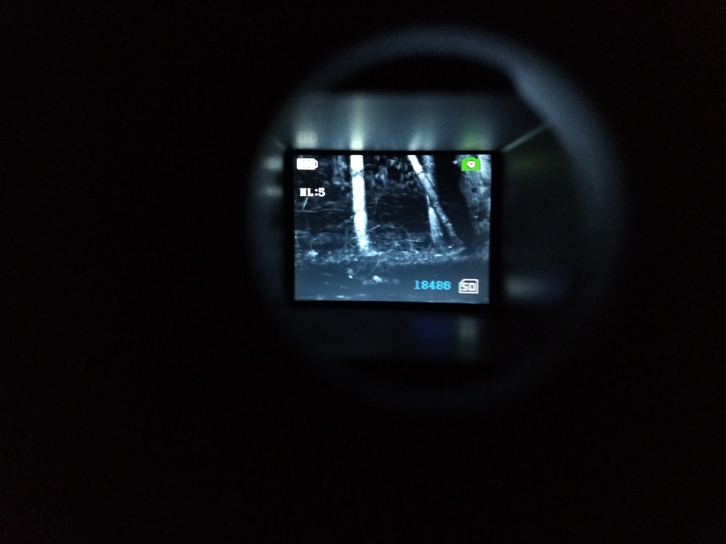

This is with the in-built illuminator IR. The lack of light causes the unit to compensate probably with simulated ISO, causing a more grainy image. Again the lack of persistence of vision makes this look like it has more snow than it appears to in real life. This is 100 yards out though, and you could easily spot and shoot a mouse at this range. not bad for a tiny in-built aspheric with a lens the size of my thumbnail.
Here I clicked on one of my more powerful infrared illuminators. This flashlight is dangerous, because you can't see it but it is likely powerful enough to damage your eyes if you look into it even at a surprisingly long distance. Just something to keep in mind when playing around with IR illuminators, some of them are dangerous in the same way IR lasers are; you can't see them and they trigger no blink reflex. In the image though you can clearly see the grain is smaller, everything is crisper and sharper. Individual blades of last year's grass poking through the snow are clearly defined. While it is a little washed out, due to the interplay between screen and camera, I could clearly see my hits on these targets.

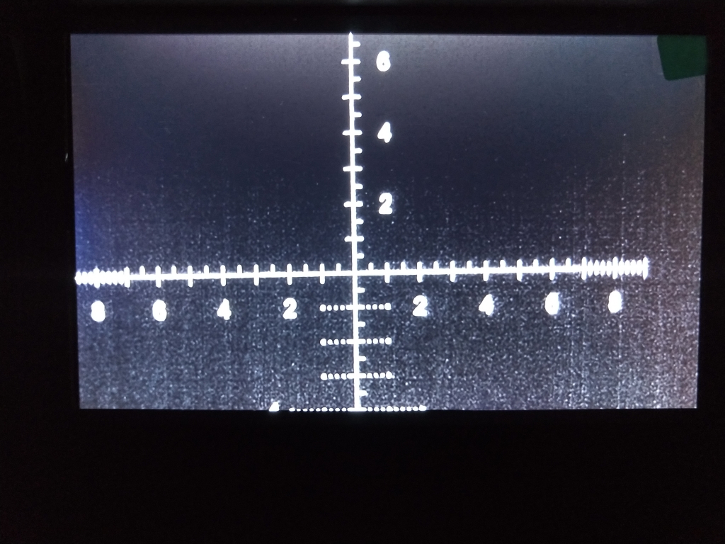

It is hard to show what this unit actually looks like. The screen is higher resolution per unit area than the BestSight screen, and is meant very much to be viewed by a human eye against the eye-cup. What it is not made for is to have someone awkwardly try to aim it at a target with one hand and then hold a camera in space and try to aim that at the screen. So apologies in advance, these pictures do NOT do the unit justice. Test conditions were the same as above, a clear moonless night. With the illuminator off, essentially nothing was visible.

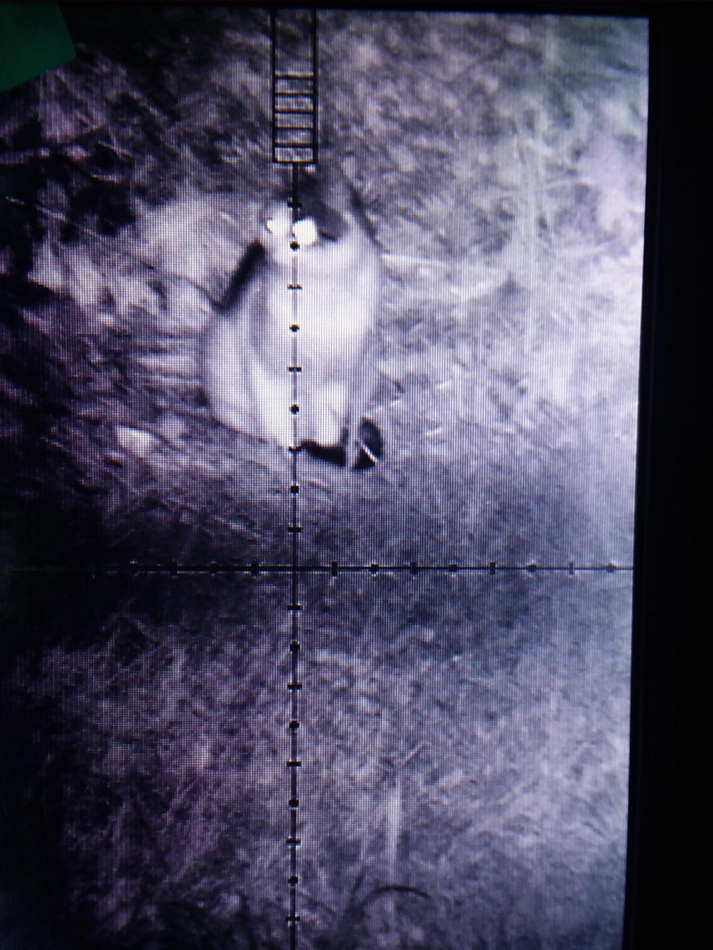

This is 100 yards with the integral illuminator turned up to max. Again on the right hand cluster of targets, you can make out the 3" circle no problem. At this rate of drain, the NV plus its illuminator maxed out, I suspect the life of that single 14500 cell will be relatively short. Voltage sag was evident because as soon as I turned the illuminator down the battery capacity indicator went up. I will say though that at 100 yards, while you could identify deer for example, you'd have a hard time IDing rodents. This just comes down to the magnification of the optics, or lack thereof, but again a 100$ all-included unit isn't a fair comparison to a 100$ unit attached to a couple hundred dollar scope.
This is approximately 30 yards, with the illuminator on a much lower setting than the 100 yard shot. I think this is a much more typical application for the monocular. And at this distance it works well, rodents would be clearly visible.
