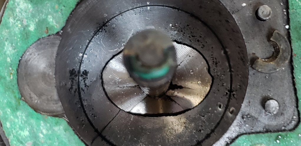

When I used my YH ( genuine version ) the other day, the sound was a bit abnormal. It seems that something is not running smoothly or it is struggling against some load but the symptom disappeared after about half a minute and it worked fine afterwards. I also noticed that the pressure wouldn't build up at all in the first 20 seconds or so and it suddenly jumped up before steadily going to 4500 psi in the usual manner. I have the feeling that it will quit working soon. Can anyone share your thoughts on what might have going wrong ? Can it be the check valve ?
Sadly it was not just an oring, piston rip 😔
