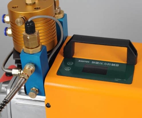

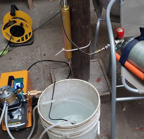

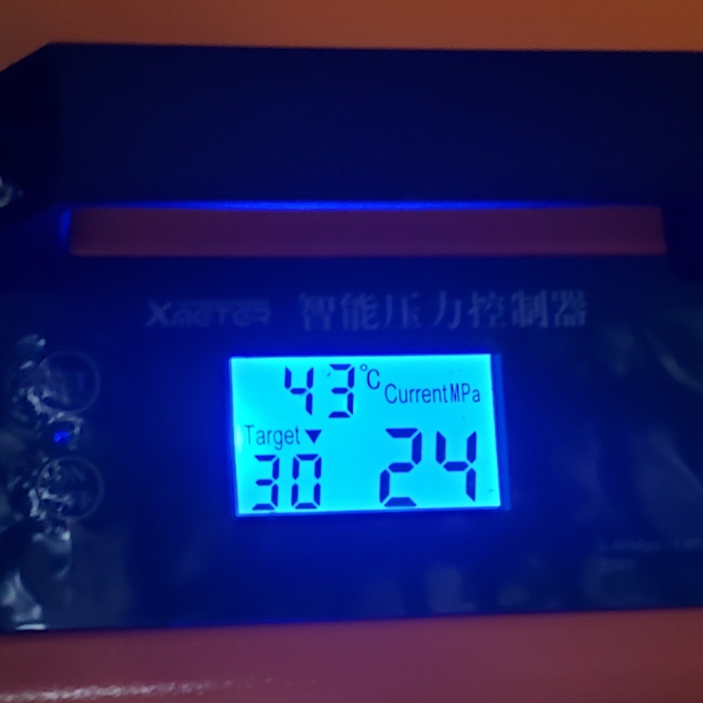

Got a new compressor! looks much better than the YH (but very similar)...first impressions Quieter (a lot), temp stay down on 45 Celcius, digital display (really love that!). Shipping was really fast (10 days) ... total in Chile (for US usually is cheaper) US$380 (I did not pay a dime extra, got lucky no taxes)... so far so good...fill 6.8L SCBA from 190 to 300bar in 15m, 10 minutes pause, and then a 9L SCBA from 180 to 300bar in 30 minutes.
Digital display
Only time will tell...if fails my next purchase will be a Coltri/Daystate
I have had the impression that the Yong Heng type of compressor has already reached the end of its development cycle but it seems that its still evolving. The reduction in noise level is a major improvement. I used to think that its something deep rooted in the design that cannot be changed.

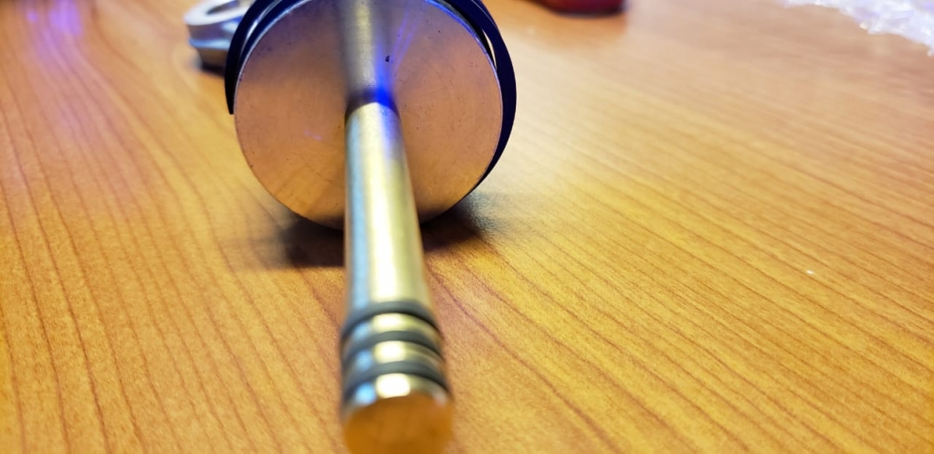

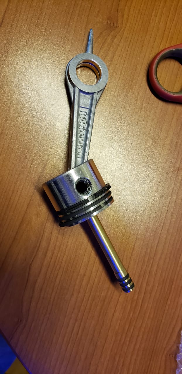

I have recently asked the Yong Heng factory in China regarding the widely reported problem of the first-stage piston cracked after some use. They told me that they are aware of the issue and all compressors coming out from the factory now have got pistons with thicker wall. Make sure that you get the new piston for replacement. My Yong Heng was bought one year ago and they told me that it probably has got the old version piston with thinner wall. I have just ordered a new-version one, costs 4 bucks shipped.
There is no link selling the new piston. I am located in Hong Kong and I contact the Yong Heng factory directly to buy the piston. I am sure sellers on Aliexpress or alike can get it for you guys in US .
I will post some pictures of the new piston which should arrive in a few days.
Great! Mine is only two months old but when I can find one I will get the upgraded unit and install it just to feel safer. I know they can be repaired afterwards but I'm sure it does no good to circulate debris through the system.
I guess for $4 you get just the piston? If so I wonder if the wrist pin has to be pressed in with a combo of cold pin and hot rod?
Thanks for the info.
