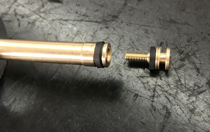

As you all know, the 2nd-stage piston of Yong Heng has got closed piston rings and I have been wondering how they can be put on. I asked the customer service people of Yong Heng today and they send me this picture and video showing how they do it in the factory. Hope you find it useful .
https://www.youtube.com/watch?v=wgg8YouWZfs&feature=youtu.be
I am located in Hong Kong and I have to say the support from Yong Heng at this side of the pond is super. Recently I torn the gasket between the first-stage cylinder and the crank case when taking the compressor apart and I asked Yong Heng whether I can buy a replacement. They sent me two pieces free of charge ! I have to pay for the shipping of course, costs less than 2 bucks and expect to arrive in 2 days :)
