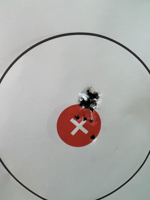

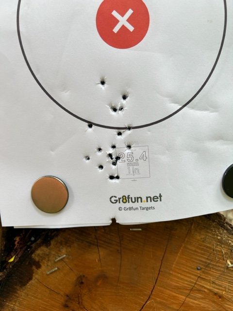

Baffled. 15 yards iron sights: 67F29CF0-BF50-41D6-8FE8-1D09D72A3DE8.jpeg
15 yards new Hawke scope:
I did not adjust the reticle. Other targets are similar. Groups that wander or no group.

Baffled. 15 yards iron sights:View attachment 279892
View attachment 279893View attachment 279894

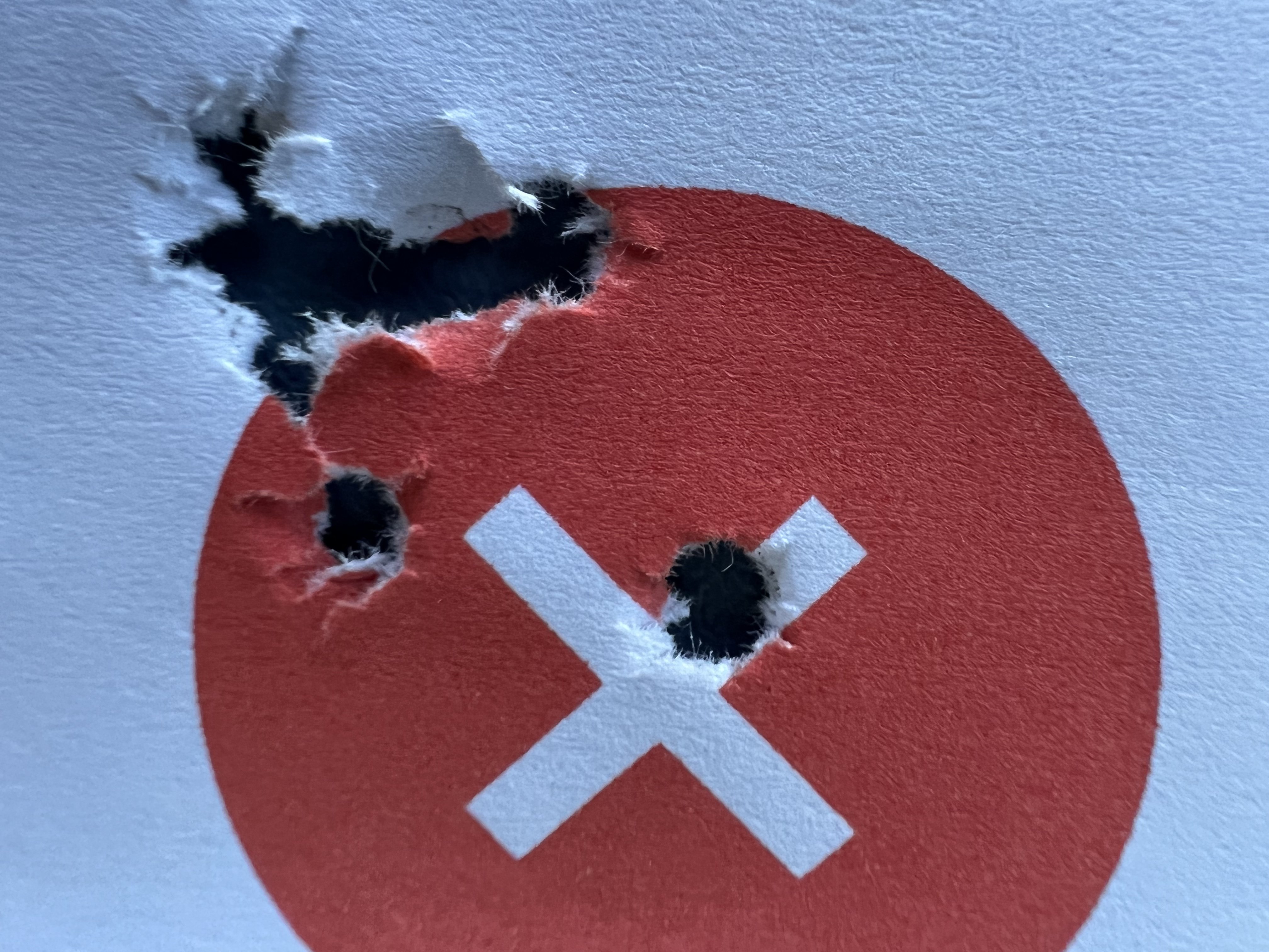

Rifle 2, the borrowed rifle was fired with the included scope and returned a nickel sized 10 shot group.
Rifle 1 results posted further up in the thread. No group.

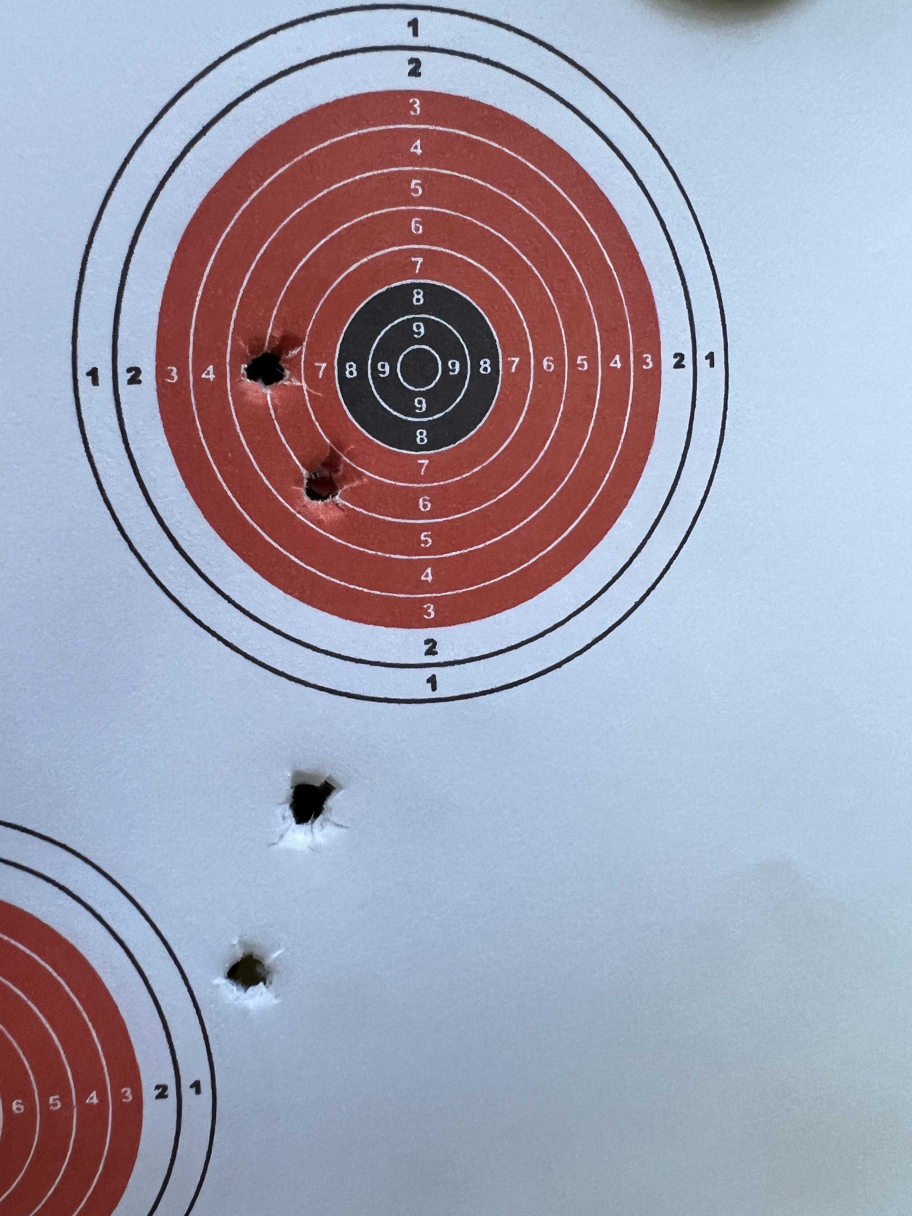

Borrowed rifle (Rifle 2) was affixed with Mount 2 (+10) and Scope 1 (Hawke). 20 shot group:

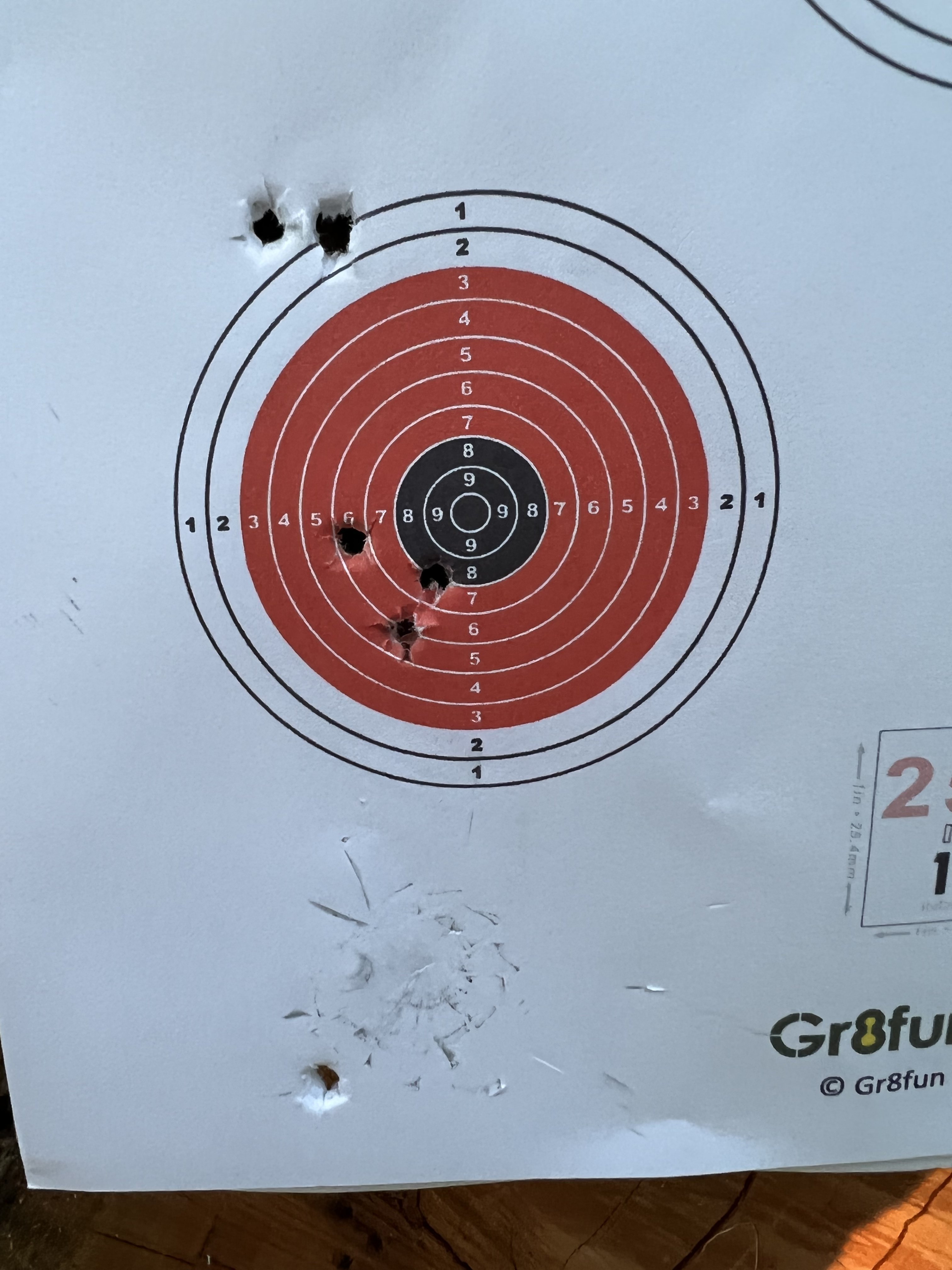

My rifle (Rifle 1) was affixed with Mount 2 (+10) and Scope 2 (Bugbuster). 20 shot group:
After the first ten shots with my rifle I changed the breach seal for a new one provided by Vortek. No improvement for the last ten shots. I also fired the borrowed rifle with my mount and the Bugbuster and it returned a suitable group.. Since both scopes and both mounts returned suitable groups on the borrowed rifle then my rifle is malfunctioning. What is my next step?
