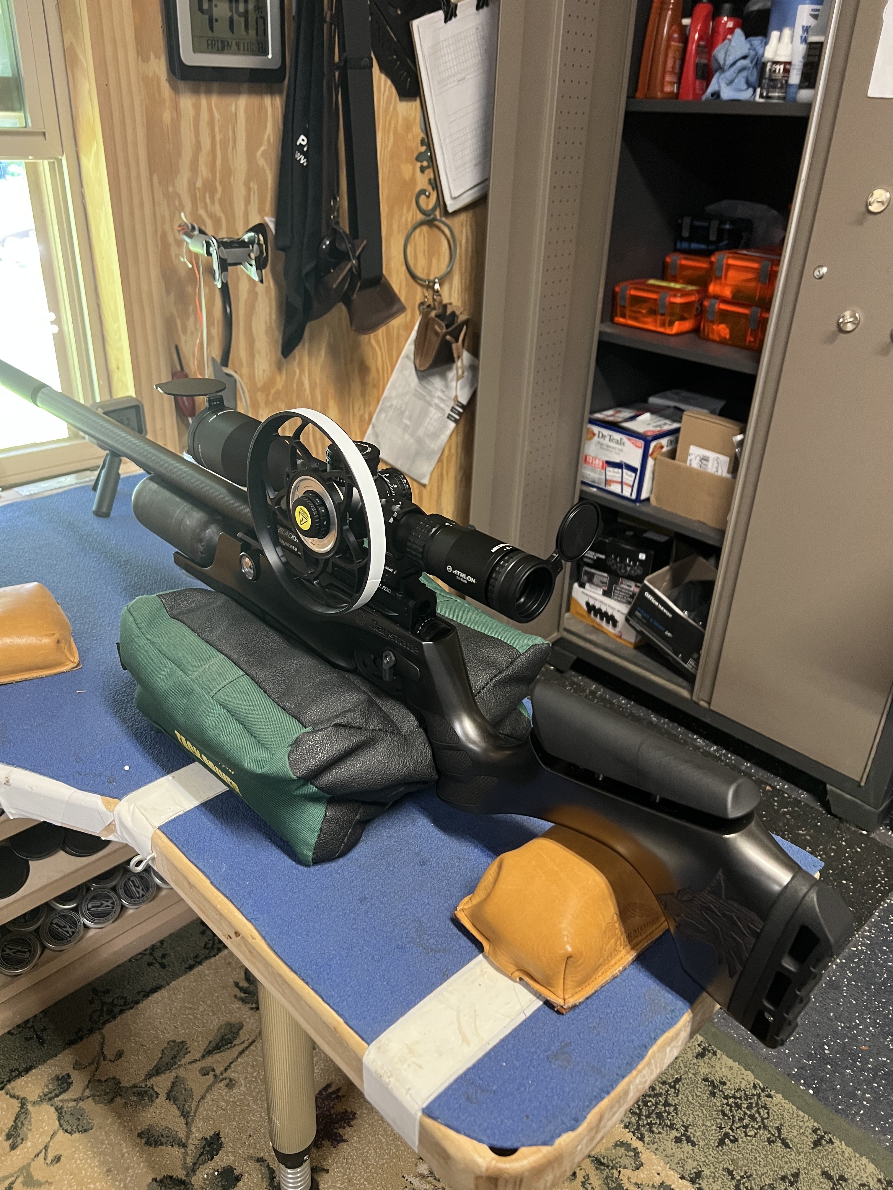

The first thing i noticed at 3:30 a.m. this morning, during some initial setup, was just how light this PCP was.
AOA put a 300 CC btl on it per request to keep the weight down.
With the Athlon scope and wheel shown, the all in weight is 10 lbs 3 ounces. which includes a PRS single shot loader and a PRS M-Lok to UIT adapter.

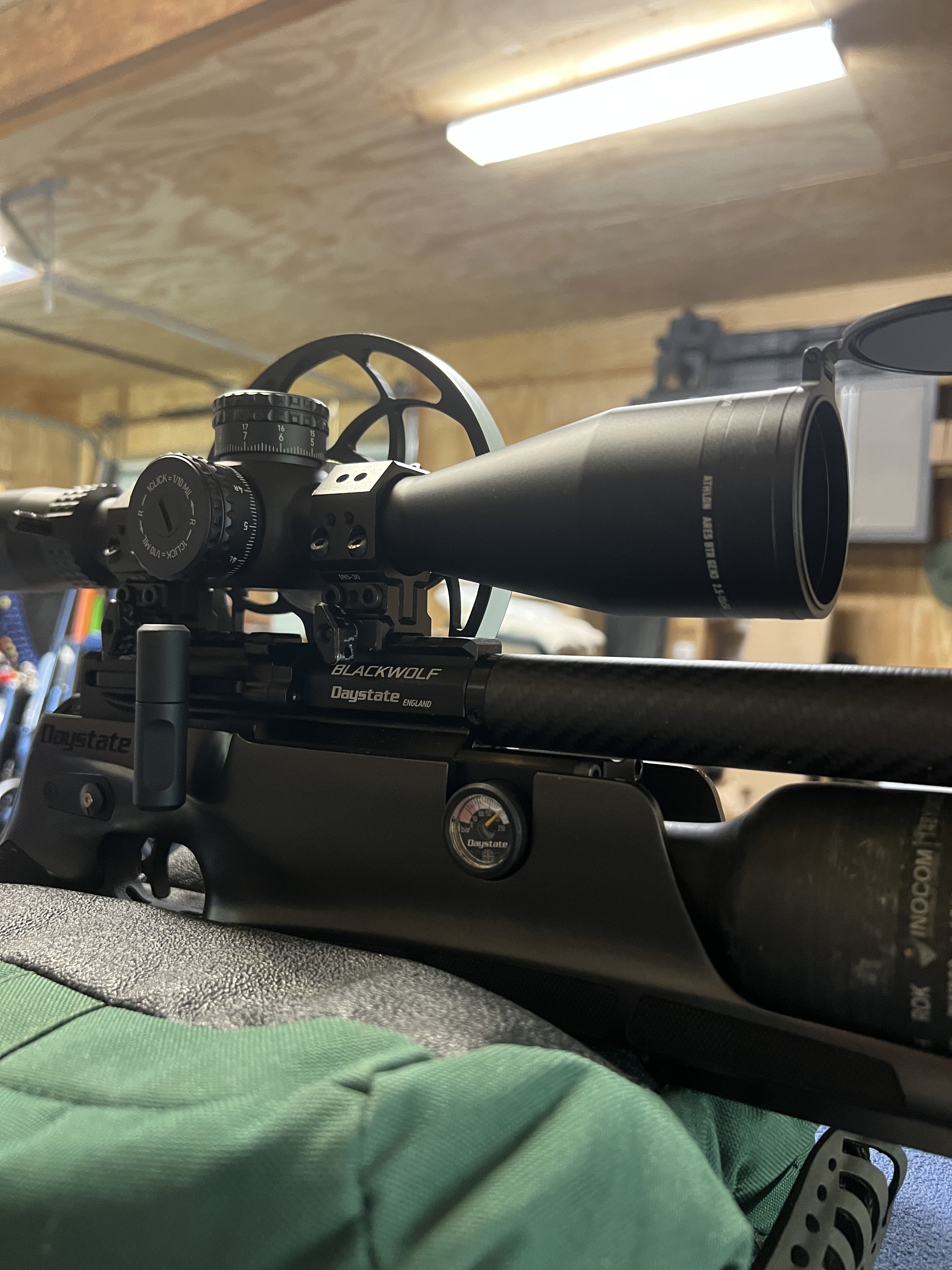

The second thing i noticed was: you better use medium, or better yet, HIGH scope rings.
I initially tried my ol “slam the scope down as close to the barrel as you can, using low mount rings. No worky, the 50 mm bell on the Athlon Ares BTR Gen3 HD 2.5-15x50 using low rings the bell was probably going to touch once the pic rings were tightend up. I ended up temporarily using some Eagle Vision 30mm inf adjust rings i had laying around and they worked fine.

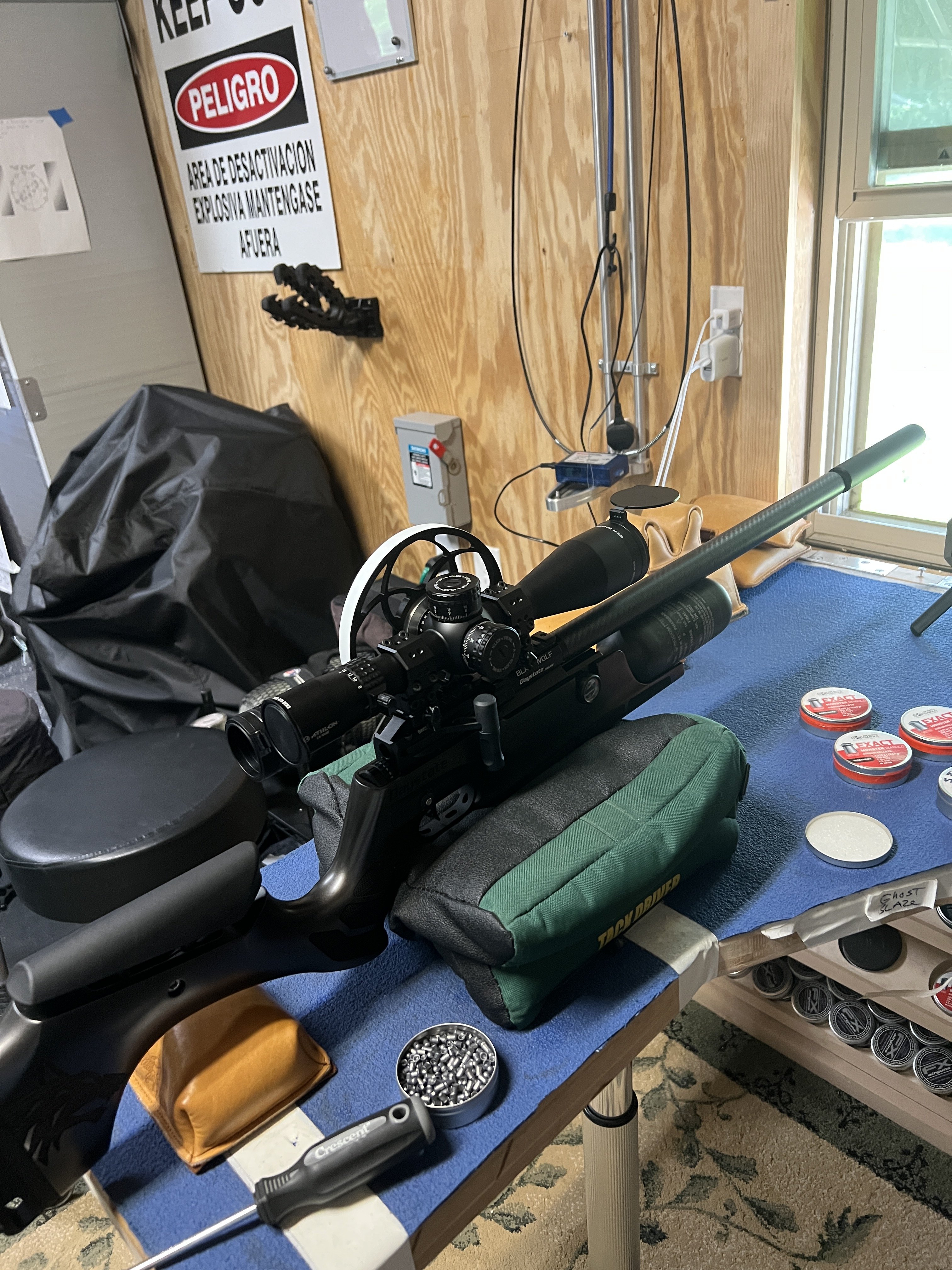

So we’ve tried 3 different scopes on this BW. The Athlon mentioned above and then the Sightron S-Tac which has a much thicker reticle and brought the weight down to 9 lb 6 ounces. we also tried a Athlon Heras 6-24x56 at 10 lb 3 ounces.
of note:
not all picatinny mounting surfaces are machined and created equally.
lesson learned-I took a scope off a ghost monorail and thought I could drop it right in the BW pic rail, seemed like a fit but when I started to tighten the rings to the rail something was affecting pellet probe / feed cycling.
I ended up having to loosen the scope in the ring mounts completely before tightening the scope rings to the picatinny rail to prevent something from tweaking the BW pellet feed?
Odd, but glad I discovered how tight the tolerances were before snugging it down to spec.
