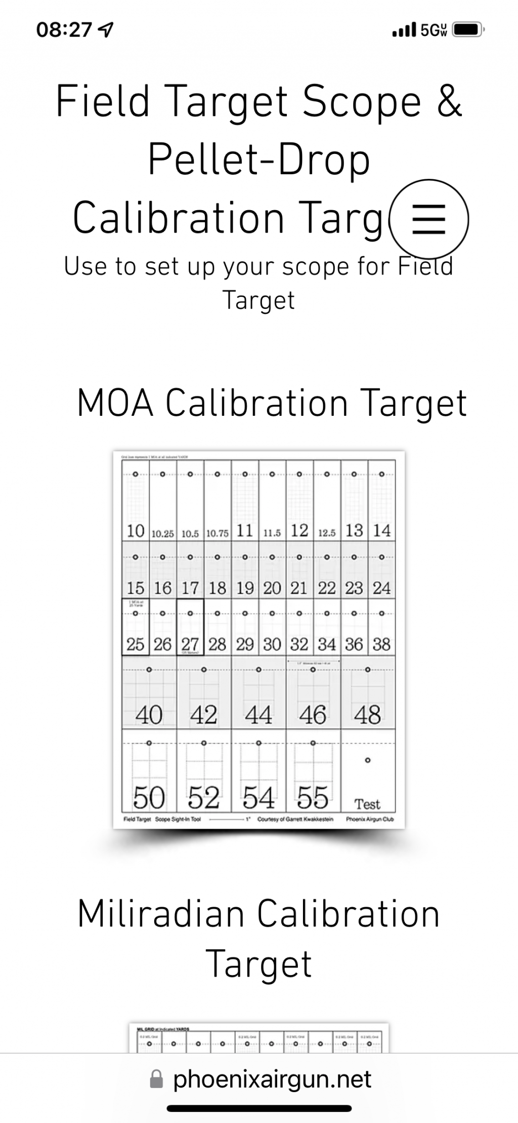

One of the best way to see your dope verified is by using this holdover target we have posted on our website. There are two types, Mil and Moa grids. Each will help you visualize your clicks or holdover based off the pellet drop for ea distance. Hope this helps.
Garrett
https://www.phoenixairgun.net/targets
